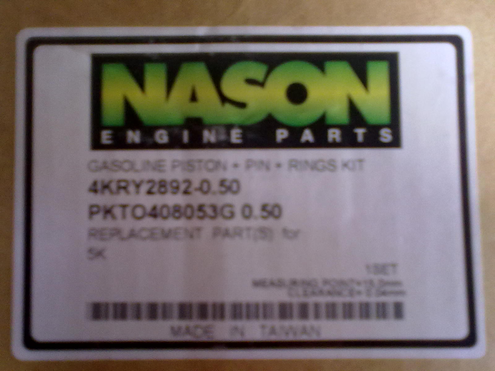

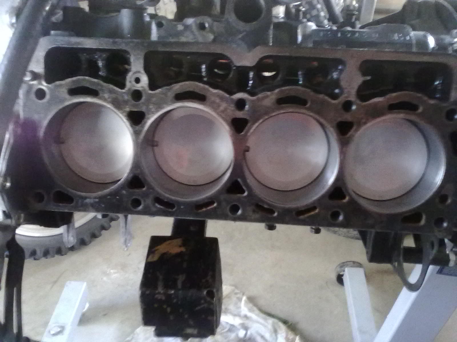

The luck was on my side today with the pistons and gasket coming in early. Got some Penrite 20w60 and coolant while I was there. Something differenct though, the guys I went through for some reason couldn't get the ACL's at 0.020 over, but they got some i've never heard of...Nason! WAH POW!!!
Some kind of Taiwanese product. I wasn't so sure to begin with, so I asked the questions while I was there. We had the vernier and the ACL product guide out. They came up spot on. At first I thought they'd got the 'wong' size. They had .50 stamped in the top. Der-fred! That's metric!
For anyone interested to know they do appear to be an equal product without a real weight, metal composition or dish volume comparison (not necessarily superior, yet). Only visual difference I could see was that these pistons don't appear to have polished finish.

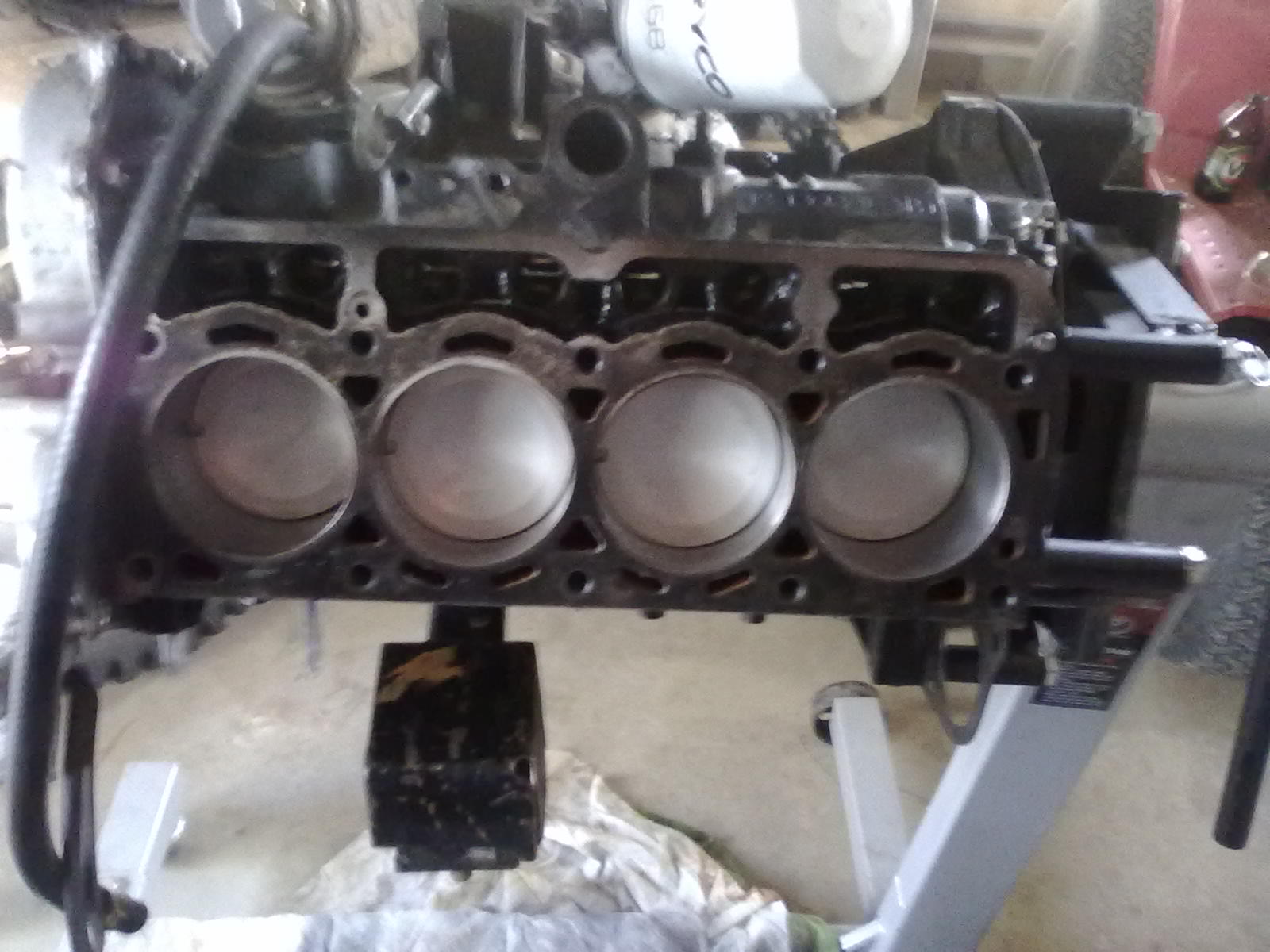

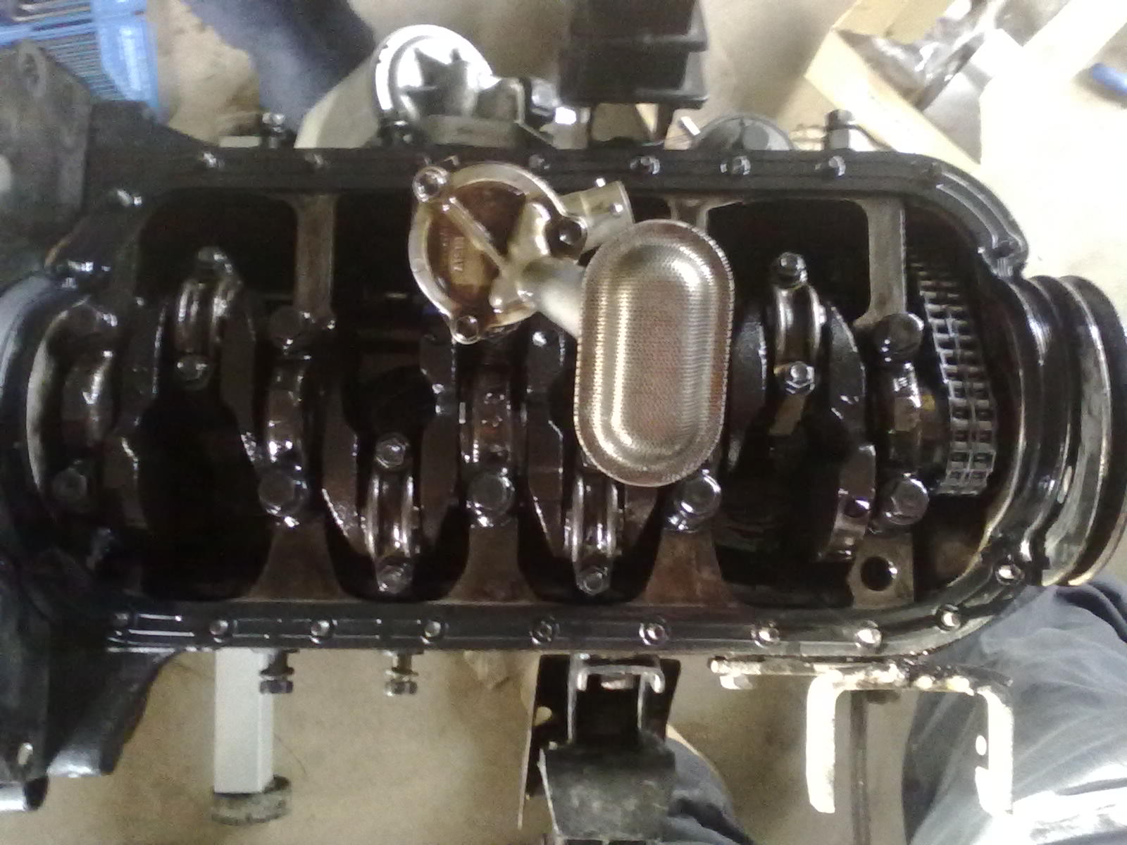

The day ends with the bottom end back in and re-torqued. It's my birthday tomorrow, so I want to take this thing for a drive....
post-8643-0-15108300-1312537128_thumb.jpgpost-8643-0-72918800-1312537169_thumb.jpgpost-8643-0-49657900-1312537184_thumb.jpgpost-8643-0-02453600-1312537197_thumb.jpg
Edited by GJM85

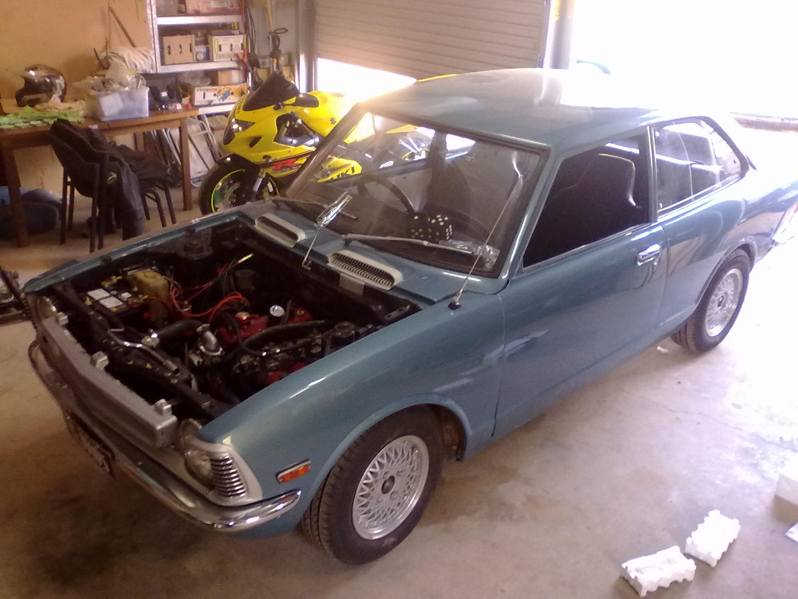

We got the whole thing back together and in yesterday. Still got problems... it's gotta go for a tune now. We've done all we can. It must be the carbies now. I think the fuel mixture is way to far out on all cylinders which is why I can't get it to run right.... I set the timing to 12 degrees and it starts first kick and it has spark on all cylinders, but you can remove the plug lead of a cylinder and it doesn't change its tone... Cranking pressure is between 160-170psi on all cylinders. There is an exaust leak at the extractors on cylinder 2 and 3 that I can't close up. Frustrating shit.....
Got the JVC stereo in. Sounds good with just the 6x9's.

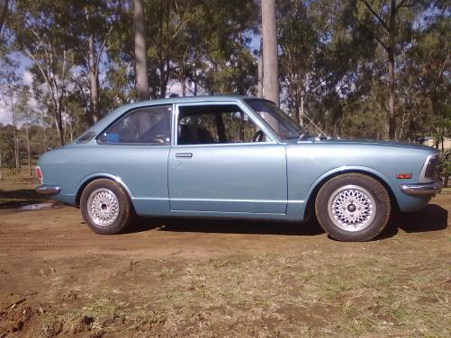

Looking good Gav, keen to see this on the road soon and cruising :dance:
fantastic colur choice you ran with, the car really pulls it off

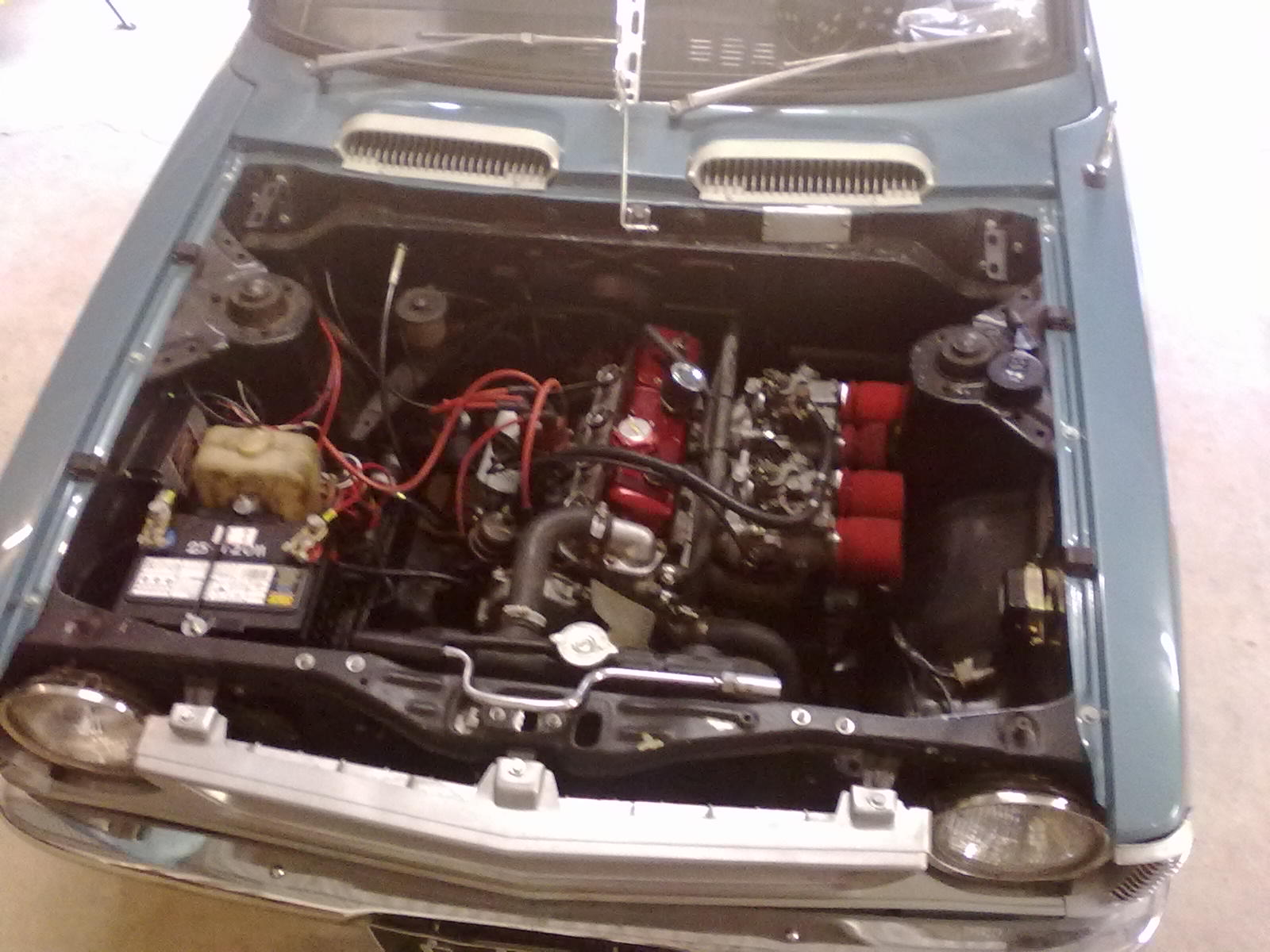

Today I decided to take the sidedrafts off and see what the go it. I hate the lack of room around that damn manifold, as it took me over an hour to get the carbies and the manifold undone with my big fumbling mits. Once they were off I held them level and twisted open the throttle to see how much fuel they were squirting. Cylinder 1 - moderate, 2 - heaps, 3 - nothing, 4 - nothing.... no wonder it was running like dogs balls on chop day.
I put the old 3k carb and bigport manifold back on and fire it up.... no more exaust leak, no idle unless i held the throttle open a few millmeters. Nowhere near enough fuel or air but at least I know the ignition works and its running on all cylinders. WOO HOO!
I need this on the road now because my piece of shit ashtray broke down so it's sitting in dad's front yard gathering dust. So f@$k the sidedrafts for now! Since i've got the bp manifold and an adapter plate already i'm moving on to a 2 barrel weber. If you have a good one jetted to a 1.6L, gimme gimme gimme!!!!

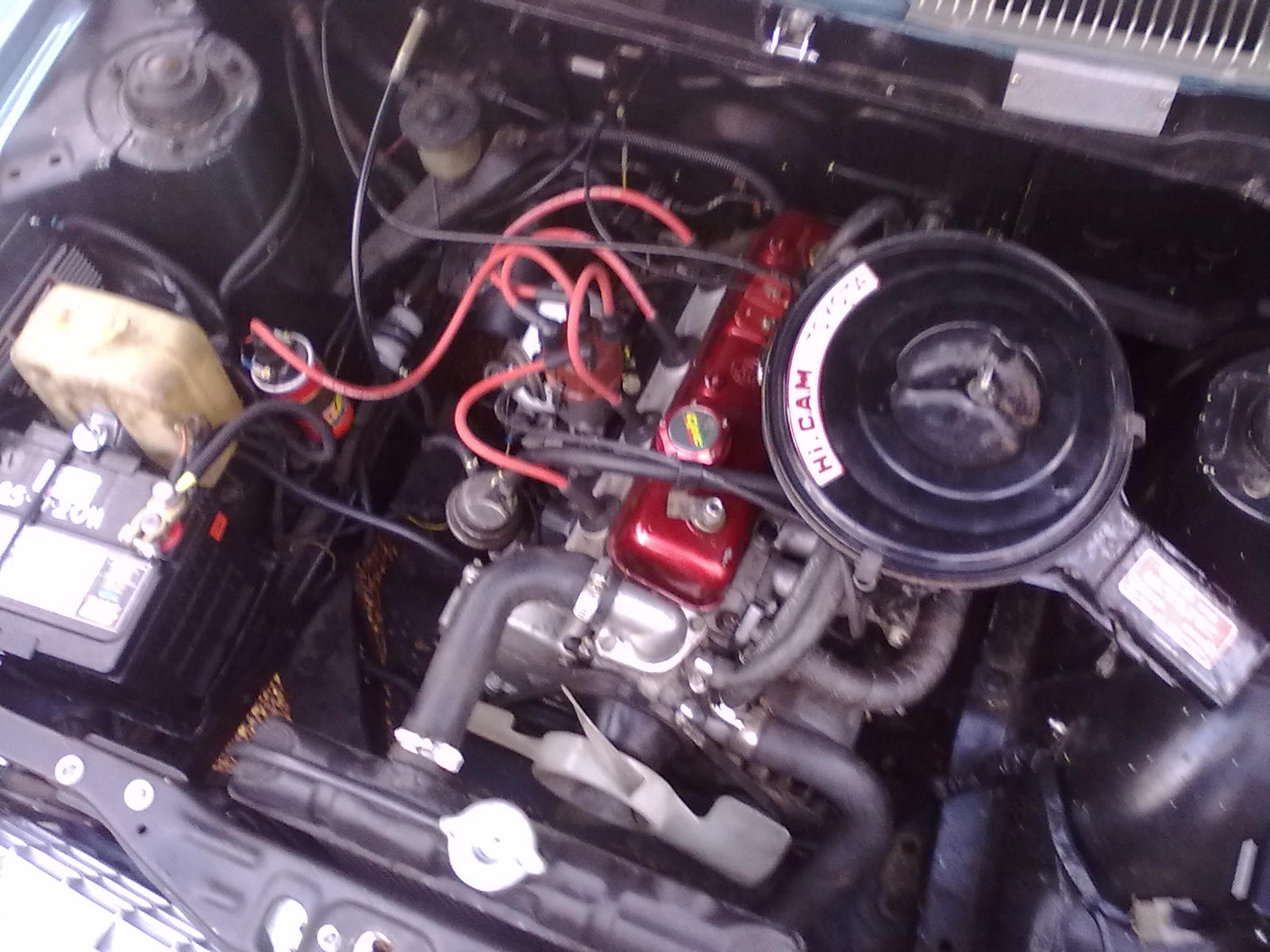

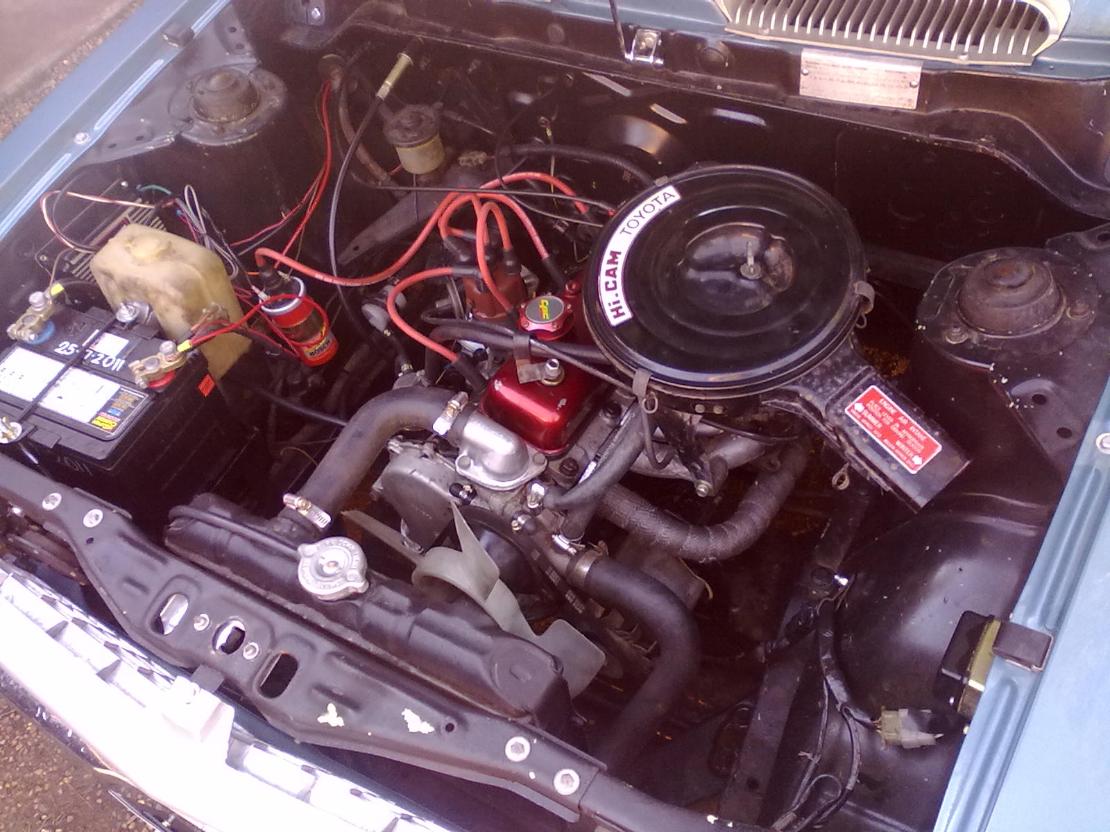

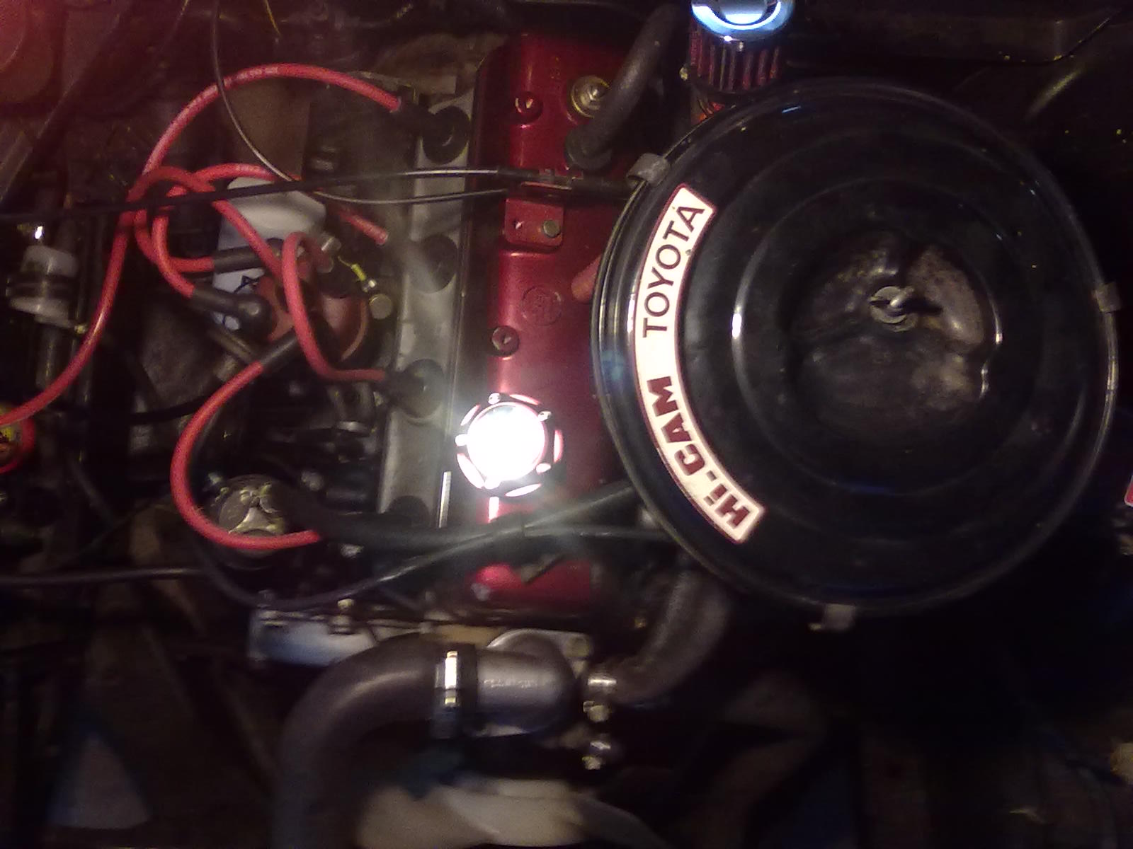

I haven't had any luck getting hands on a weber so I picked up a rebuild kit for the 3k carb and have proceeded to try and make it work. While I was down south I stopped at Bogabilla and found a hi-cam air box at the bummy wreckers there from an '84 ke70. Say hello to my Hi-Cam 5k. :yes:

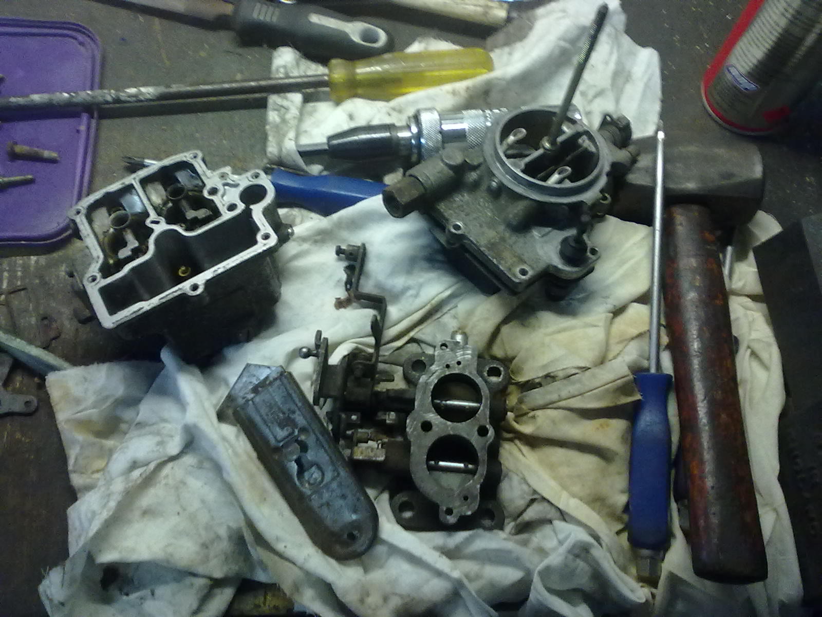

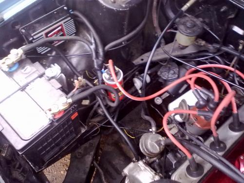

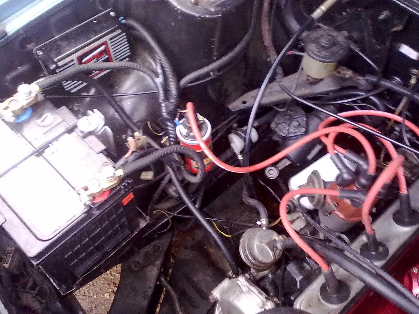

Cleaned up the wiring for the Streetfire with solder,heat shrink and conduit. Spent another 4 hours f@$king around with the 3k carby. We put replaced the primary jet. From 102 to 152(4k secondary jet) and the secondary stayed as a 163. To much fuel for the shit house amount of air this carby can pass. So much vacuum it actually sucks fuel out of the bowl. Runs well until you put load on the motor... frustrating!
Somebody give me a weber!!!
Before
After
post-8643-0-76227100-1314525750_thumb.jpgpost-8643-0-58644500-1314526048_thumb.jpgpost-8643-0-75393900-1314526353_thumb.jpgpost-8643-0-22441300-1314526391_thumb.jpg

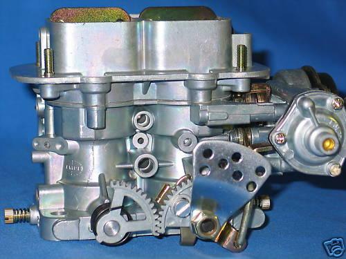

Since no ones got a 32/36 for me I'm forking out for a synchronous 38/38 Sports. Done with it.
Which weber series is best for my needs?
