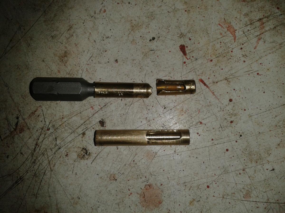

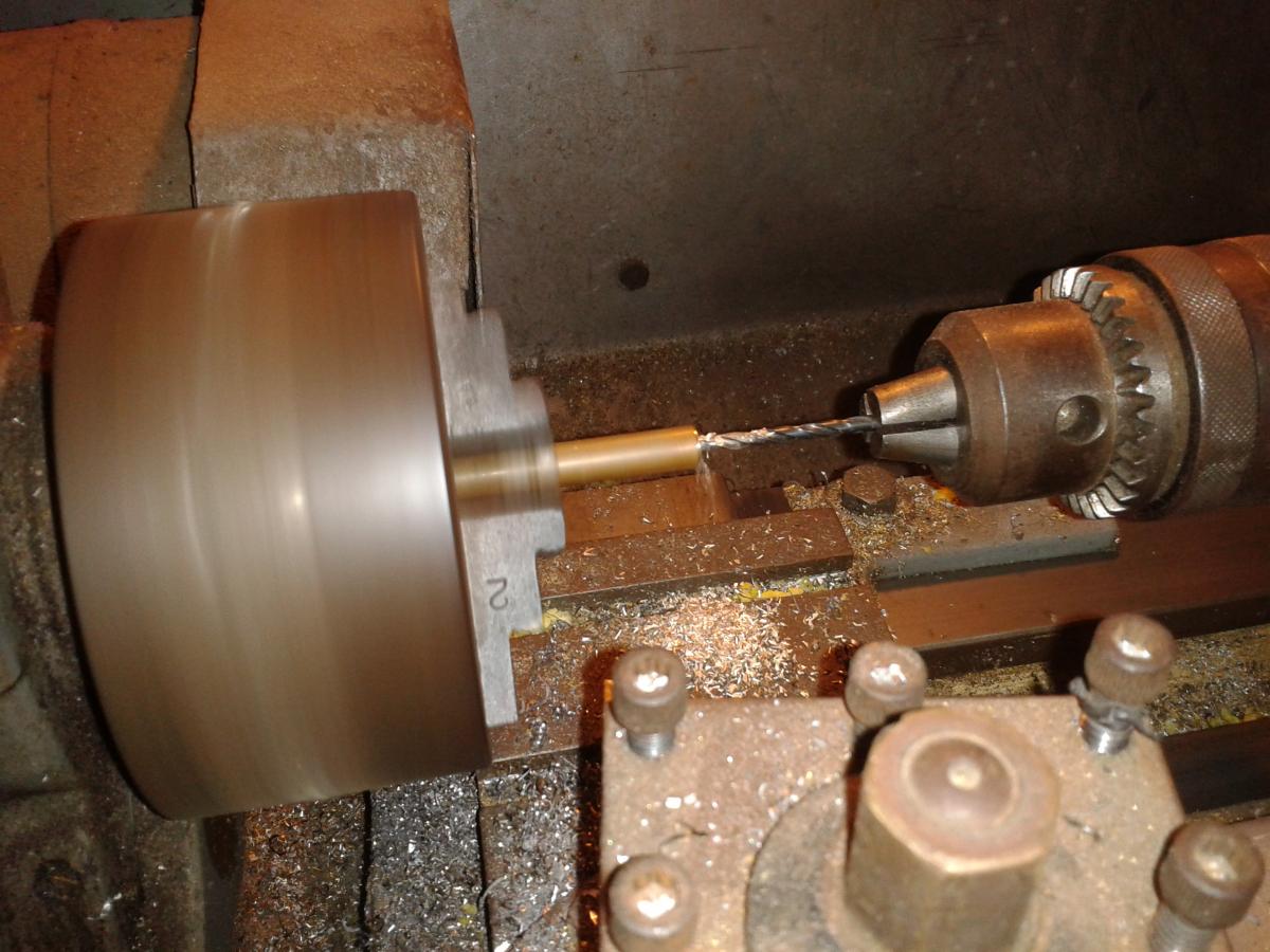

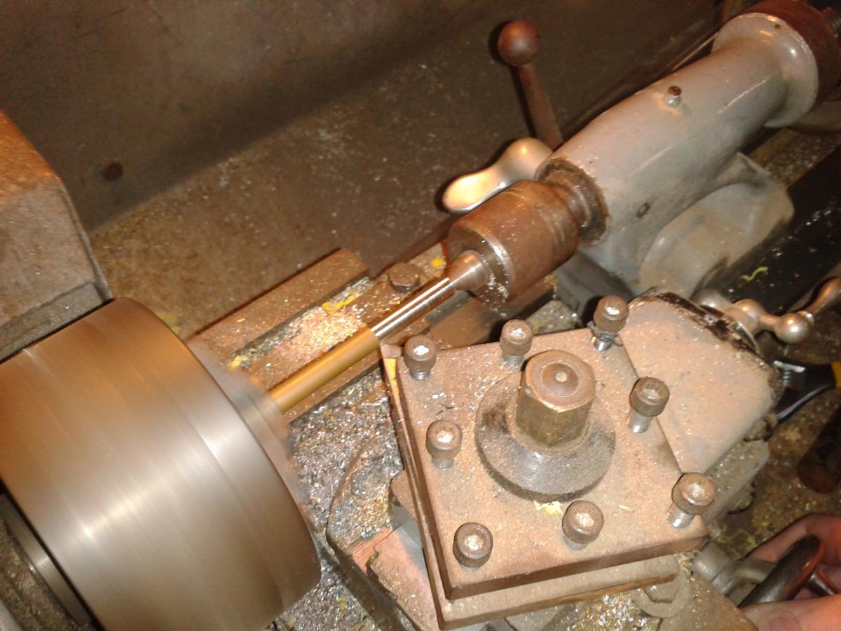

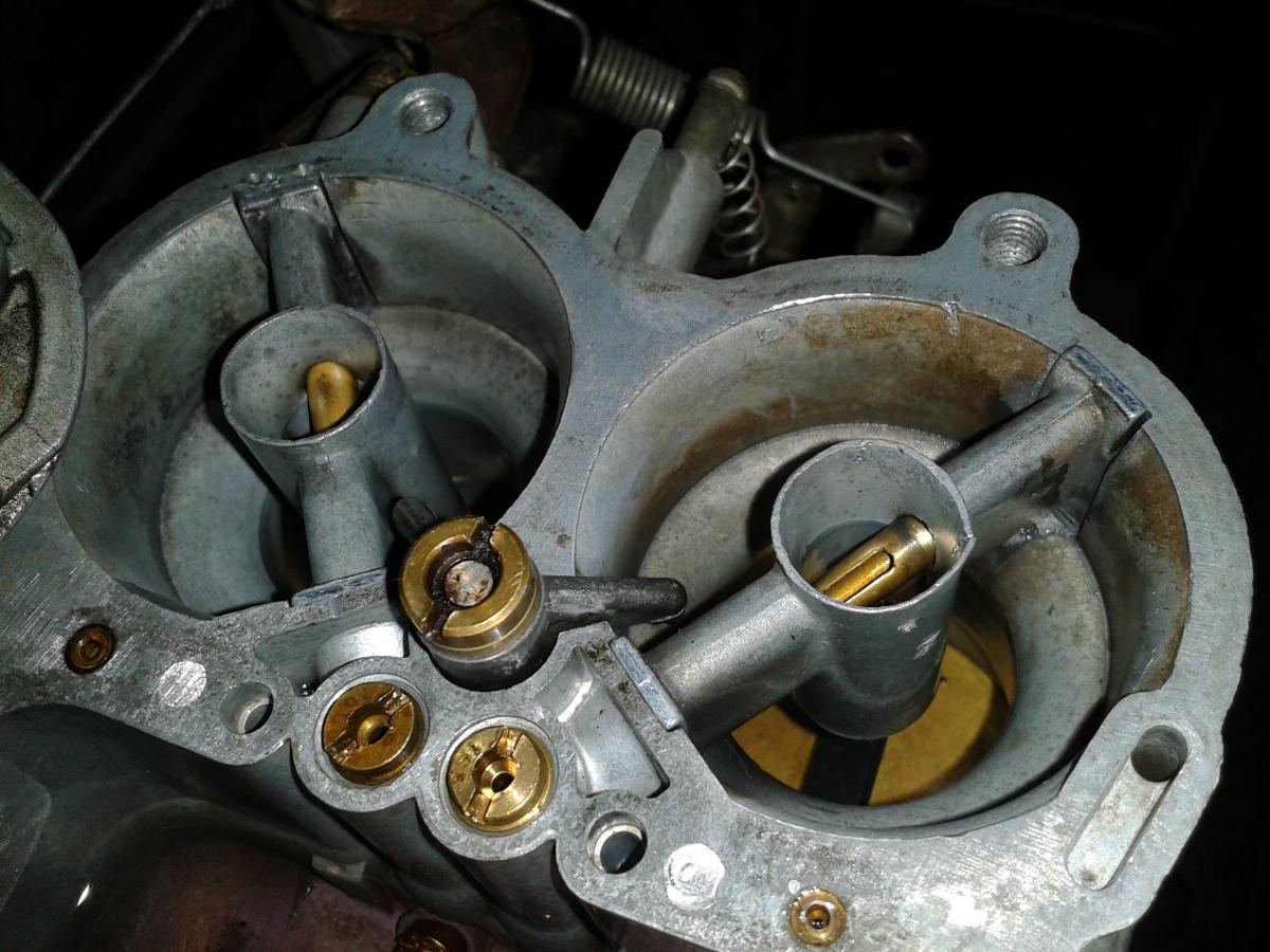

Some how the brass fuel delivery tube inside the secondary auxillary venturi keeps vibrating around to face the wrong way.
I superglued it back the right way but that only lasted a week. So this time I tried to flare the end of it and press it back in. The punch became stuck so I heated it up and it broke when i tried to get it off. Not suprising.
Had to fix it. Nicbro's skills should not be under estimated.
Awesome.

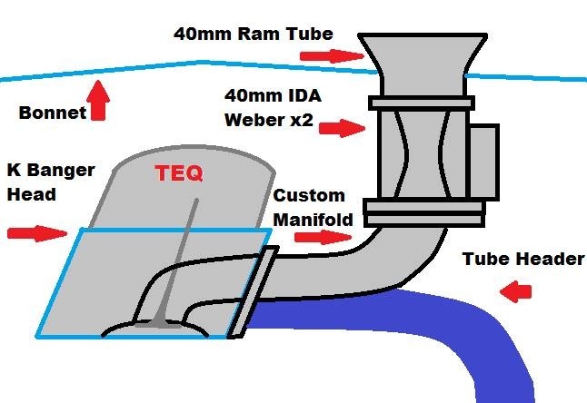

Interesting. I thought this one through not long ago when finding some 36mm IDF's in a Upullit. Passed on them because I didn't want to chop the bonnet. It would have been tight, even in a '70.
You can also buy phenolic spacers to suit those Webers on ebay, with varying heights which is interesting. I like the idea of recycling though, nice!
Edited by snot35
An air velocity &/or a pressure probe would be interesting.. The carb inlets need still air really, so exposed trumpets must suffer according to which way the wind blows, what speed, when they get pressurised or have the air sucking them backwards...
It would look stunning tho'.
Yeah your right about the wind causing a vacuum drawing backwards on the carbs. I've been looking at to many matchbox cars.
Some type of reverse scoop would likely be in order ____/ y / y /y / y___
I don't know, Gav its something that would take a lot of testing. It surprises me when people fit a backwards-facing scoop to get air from the high-pressure area in front of the screen. To me that means you must have the bonnet sealed to a plate under the trumpets or air will flow OUT that scoop from the radiator.
Its the sort of thing that sports car racers love, building a one-off special that they can spend years and years tinkering around with. The whole cold-air box on The Girl's KE70 could do with more refinement when I have a few months free, it can always be improved. Certainly that leaned the rear carb from air pressure building up in the back of the airbox. You could extend your sex toy and semi-seal it around the air cleaner...
Besides you wouldn't want to cut into that lovely bonnet!

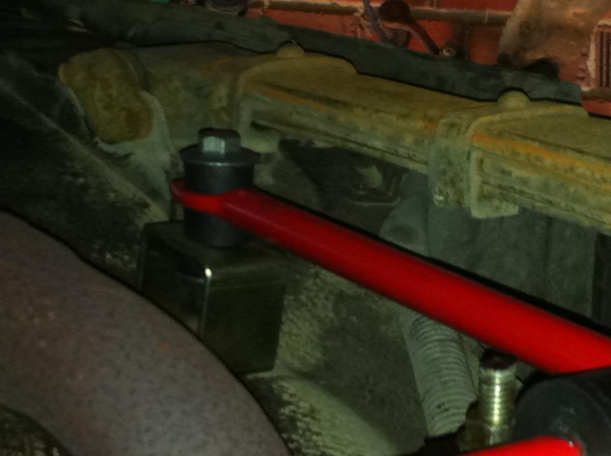

I'd highly recommend a rear bar, made a massive difference to the 11. Handles a little better than the 1600, and that's with that wizzbang front end in it you saw(I really should update that thread).

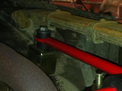

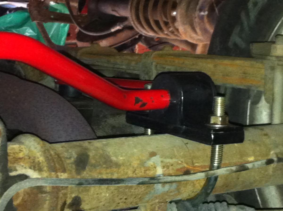

Check out "signature stabilizer bars". Pretty sure their contact details are in driftfreak's beams ke10 thread(sorry haven't figured out how to link from the new Android)
How did you mount up the rear bar in the 11 stu? I was looking at using the 55 rear sway bar when I put the diff in but could see no good way to mount it to the floor. Tommy's ke11 seems to have got it nutted.
There is also a substantial plate under the seat to spread the load of the link pin mounts.

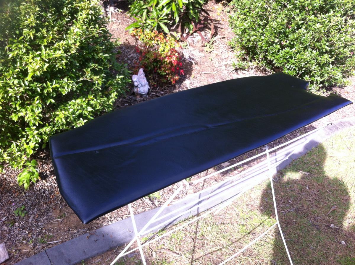

Made a new vinyl parcel shelf this arvo. The carpeted one perished within 3 months.
Free white, 10mm backed vinyl, because its creased. Stapler and some good quality vinyl paint. I've got a few metres so I'm going to do the door cards soon as well
