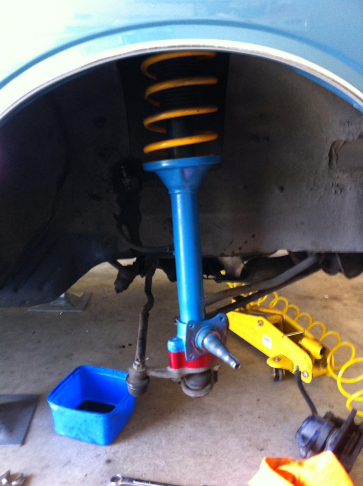

Front end is all done. Back up about 40mm for now. Should drop down another 10mm or so once it settles.
The cars geometry is back where it should be. No more brake shudder.
Just more stable all round. Cost me 850$ to lower it the way it was and it cost almost as much to bring it back up.
Also picked up a set of reset springs for the rear. Reversed eyes and an extra flipped leaf. I'm not sure how low from standard they will be. Any ideas?
post-8643-0-52252400-1416634551_thumb.jpgpost-8643-0-36066600-1416634666_thumb.jpgpost-8643-0-94363500-1416634711_thumb.jpg
The other struts will be up for sale if you know anyone interested.
Shortened strut leg, resleaved, Boge VW Golf mk1 short stroke inserts, bump stops and dust covers. I have receipts. Will lower a ke20 front end about 60mm
