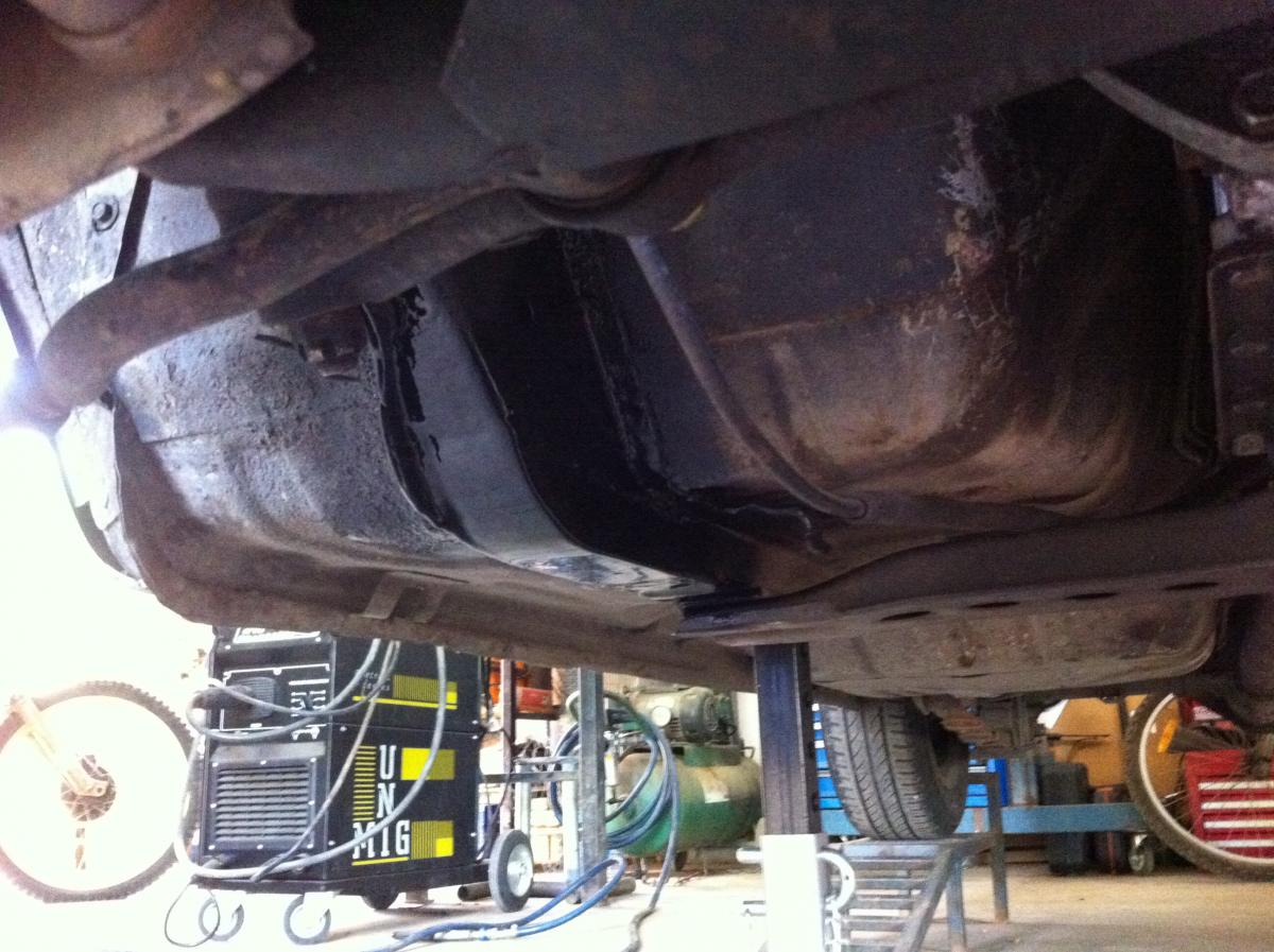

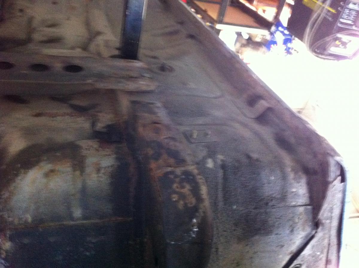

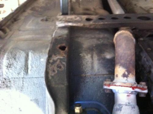

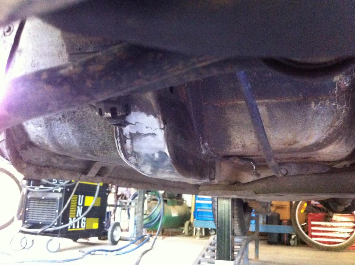

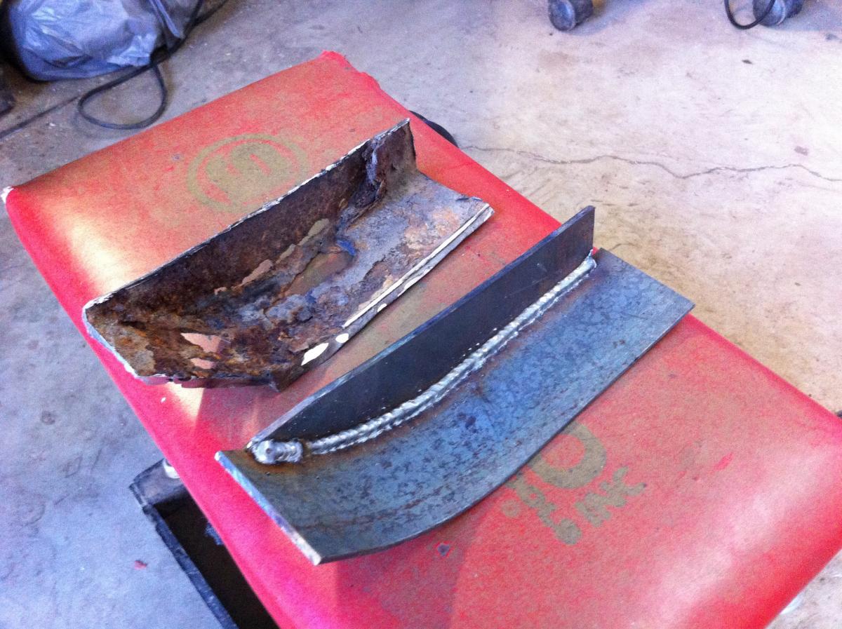

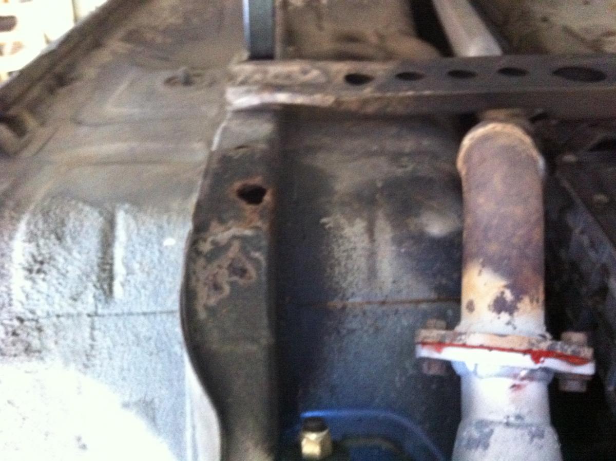

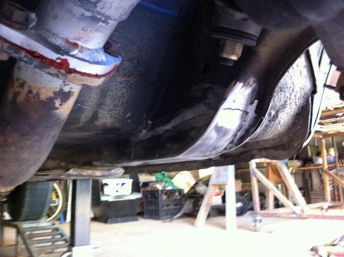

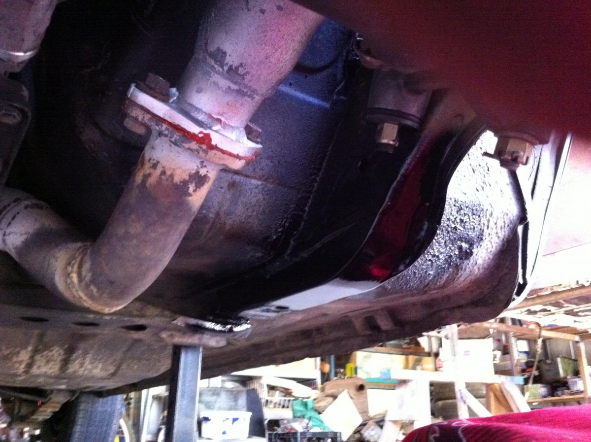

So this spells the end of the structural rust. Thanks again to my brother Nic for his fab fab skills.

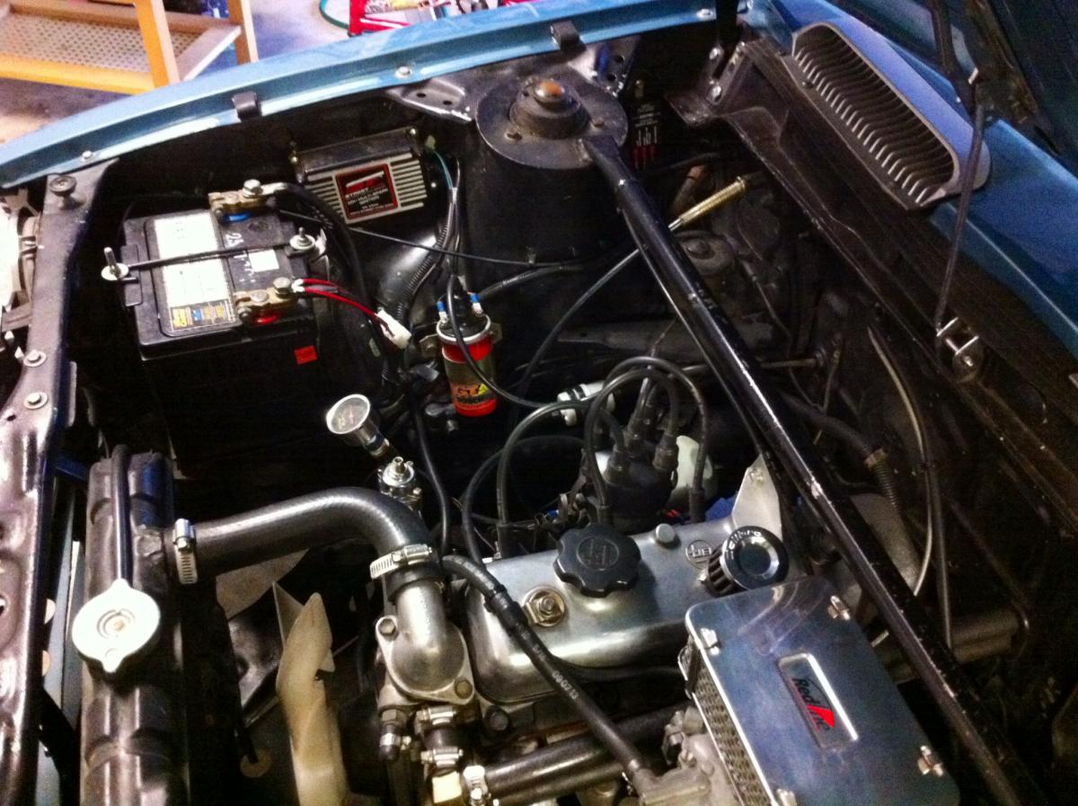

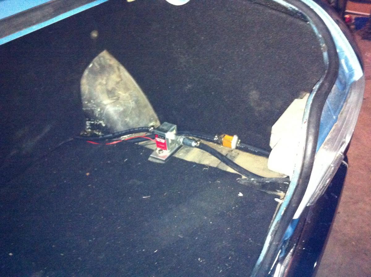

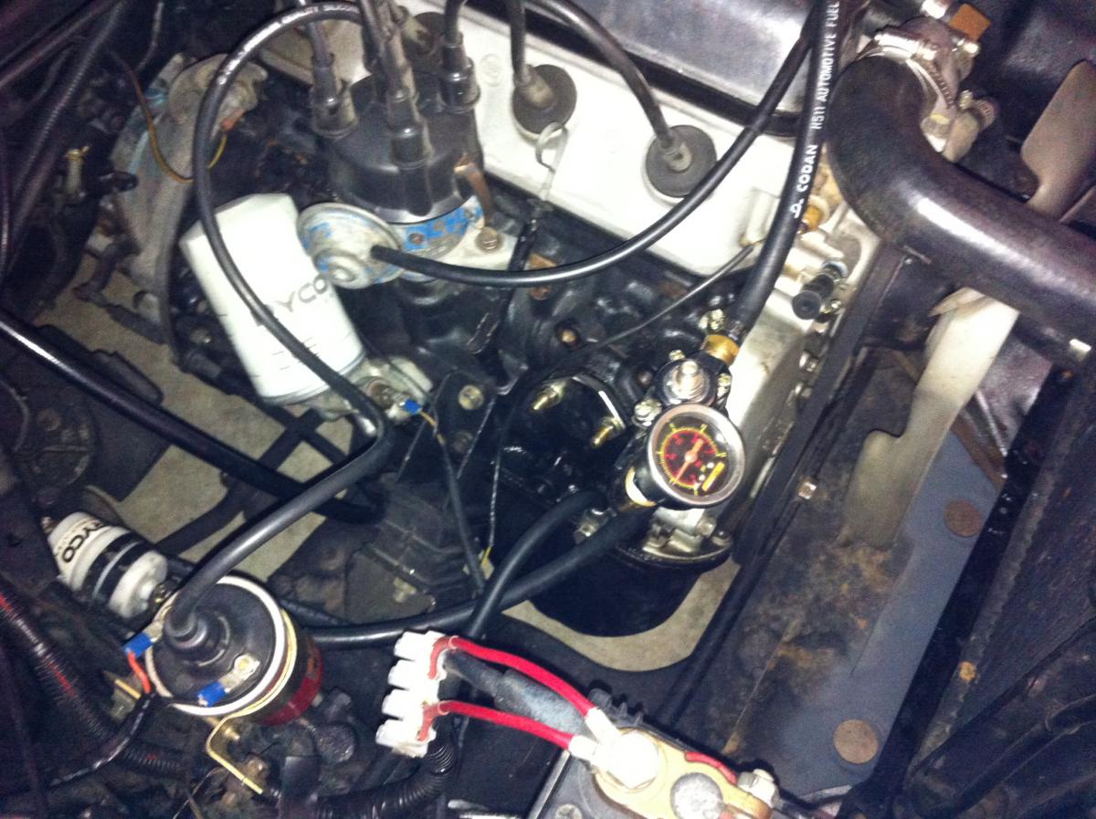

Installed a Facet solid state pump this arvo. The mechanical pump was a never ending oil leak so it had to go.
So its 132L/ph @ 4-7psi pump, 5/16 fuel lines throughout, Holley red regulator and an Aeroflow pressure gauge. Drawing through 2 filters and pushing through 1, I can get just shy of 6 psi at the reg so it does quite well.

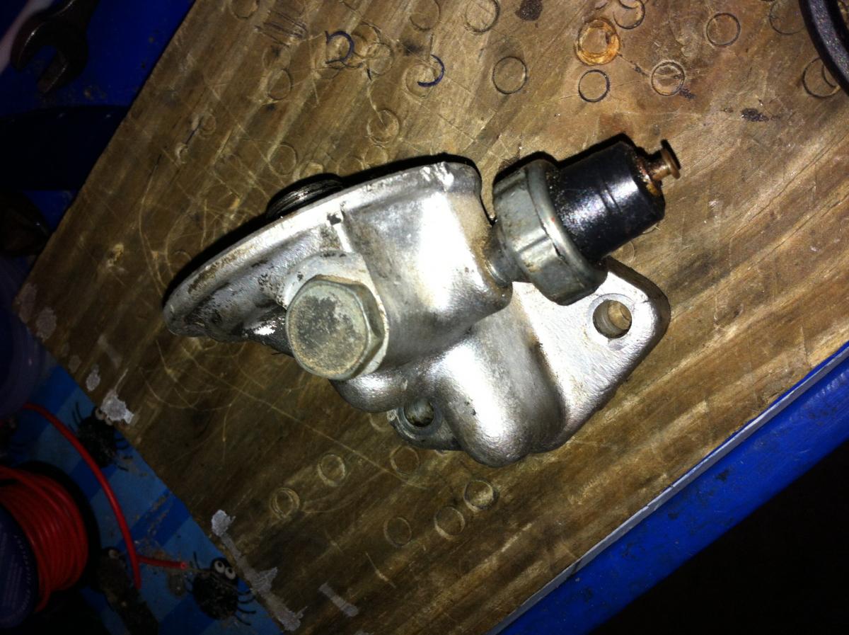

I haven't wire it up yet but I'll run it off a relay until I can get an oil pressure switch. Luckily I have this little gem. An oil pick up with an extra hole.
Edited by GJM85
Turns out that extra hole is a pressure relief valve.
So that ain't gonna work...
Surely you could just setup a relay off the existing light sender. Pretty sure it pulls the light to ground so you should be able to wire the negative of the relay trigger to it without any interference to the light. You'll just have to wire the pump power off 87a as the relay will end up normally open.
Only problem I can foresee is starting. If its only say for a little while then there should be enough fuel in the bowl to get you started, build oil pressure and activate the pump. If the car sits for long enough to evaporate all fuel from the bowl then you would need some sort of bypass prime switch/button.
Alternatively, just run a t piece in the stock sender hole.

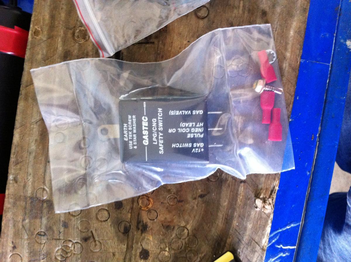

Alternatively you can use an LPG safety switch. I've used them before for carb stuff. The ones I've used will prime off the ignition switch and then run the pump after it receives a tach signal off the coil.
http://www.ebay.com.au/itm/331102163645
Something like this.
The LPG certainly looks like the easiest option.
Thanks guys!
Structural rust is one thing. This car has rust blooms coming out everywhere now. A mere 4 years since the rebuild. I'm not game to touch it. I reckon there's about 3mm of high fill over the whole body.

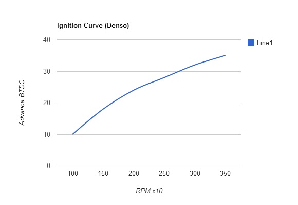

Today I mapped the ignition curve of my Bosch distributor. I'll be putting in the Tighe 104 25/65 .423" cam I have soon and I'm looking at re-graphing the distributor. From the information I've gathered its already pretty close to what is required.

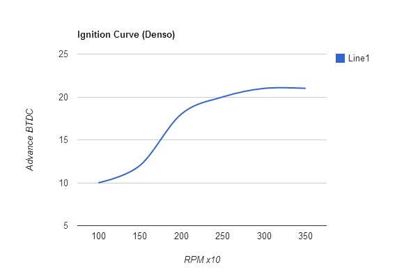

Today I mapped the ignition curve of my Denso distributor. The brass bushes on the centrifugal weights are a bit warn out. This causes the weights to move out immediately upon rotation despite how much I play with the spring post. I guessed there'd a small loss of advance as a result, which actually shows in the graph.
According to the manual, this distributor should have 15 degrees of mechanical advance with an initial setting of 8 btdc. I use 10 on my engine. So it should have 25 degrees btdc when 'all in'.

A bit late, but I'll vouch for the LPG switch, I run one on Blue Thing & it hasn't missed a beat. It has a one second prime time, maybe the three second model would work better.
I read that the LPG switch triggers off a number pulses from the coil. A ten pulse trigger wouldn't take long to prime with an msd ignition due to the multi-spark feature.
  • 4 weeks later...
So I got the Gastec LPG switch. Ninja fitment!
It primes for about 3 seconds when the ignition switches to 'ON'. The fires up almost immediately when the ignition hits 'START'.
The fuel pump cuts out again when the coil stops unloading no matter which way I kill the engine,
Thanks for pointing me in the right direction Stu!
No probs mate. Bay is looking tidy👍
