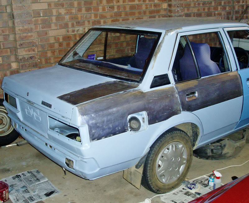

if your repairing rust holes (properly), it is best to cut out 3 times the size of the rust hole itself.
Yeh i think i might just get it done by a palmel beater and then ill paint it myself
Do all the bog-work yourself, brush some undercoat on, sand it back, brush some more on, sand it back...
Sand down a door or two and the bonnet then take them down to your spraypainter to undercoat, take it home and sand it back.
When you have a smooth undercoat over the whole car take it to a spray shop and have them topcoat it.
Cost me $800 for spraypainting all of one side plus the top surfaces in two-pack blue. Looks better than new!
I should have done the passenger's side but I cbf at the time! I took it back to steel to get rid of rust spiders under the paint.
its not hard to repair the rust yourself properly, all you need is time, metal to cut out and shape, and the only hard bit, access to a welder.
