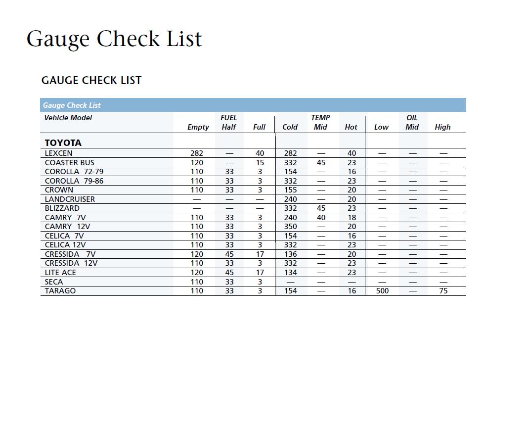

i got the specs somewhere, let me find em!
temp senders with the same resistance but from other car..

The dude hooked up a device (multimeter?) to the female wire that normally hooks onto the sender, and then turned on my car and watched my cars temp gauge as he checked it against his device. He then said the sender needed to be a resistance pretty much exactly as what's listed above (332 cold, 23 hot) and got me the right sender to suit. (turned out to need a 16x1.5 thread after all... :bash:)

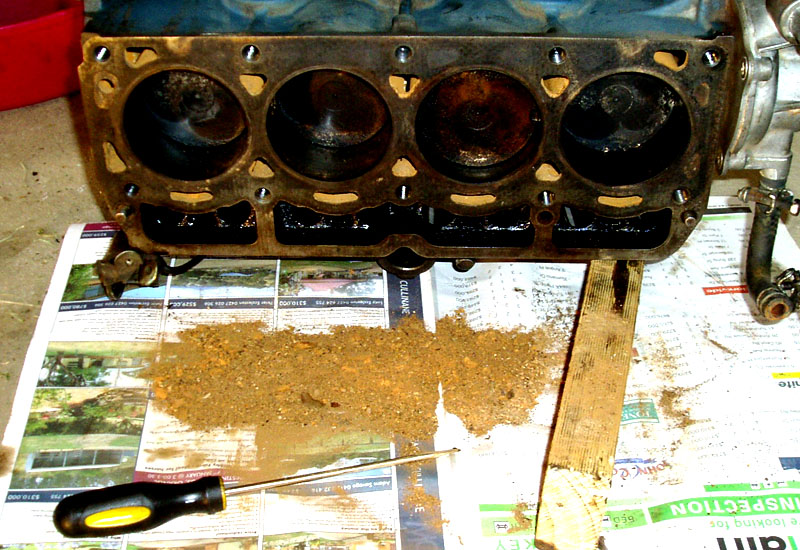

You're better to hose the block out when you take the water pump off I think.
The bigger the hole and the more flow you can get the better, but it still won't move the rust. I used a srewdriver and wire on the block when I had it out.
