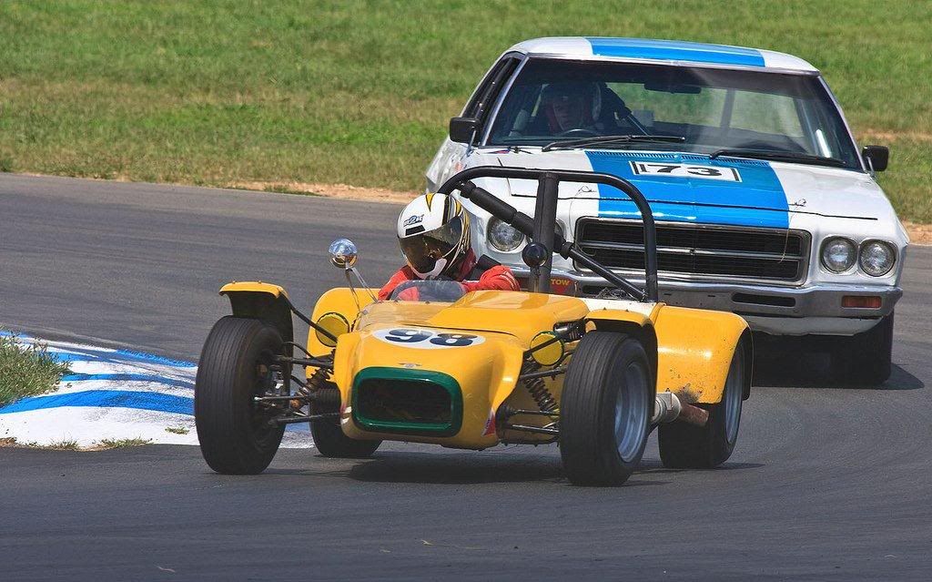

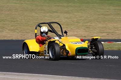

]Hey guys,
I have an historic sports race car - a 69 clubman with a 1k series corolla engine. The car has a new race engine ready to be picked up & fitted, but I want to upgrade the dizzy. The current engine has the standard dizzy, and although it is adequate, the new engine will have 35% more power - up from 55hp to 85hp, and as the engine will be revving between 7800 - 8300, I am after a dizzy that will be more suited for motor sport.
I am pretty much new to the corolla scene - well, doing the work myself that is, and would like some info on better brand dizzy's for circuit racing. Bare in mind its a K series single cam, 1066cc out to 1098cc and not a twincam engine like most modern clubbies run.
If anyone can offer some advice, it would be appreciated. Also, I am in Sydneys west, so the closer to home the better for pick up.
I will try & post up a pic or 2 of the old girl.
Ta. Brad[
