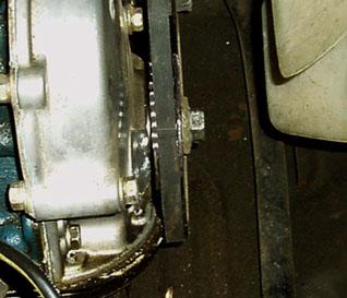

Hi Jackbyo, Great job and very informative, but I'd like to add 2 points of interest, 1. The easiest way to find top dead centre #1 cyl is to remove tappett cover , check no#4 tappetts, turn engine till tappetts are rocking, timing mark on pulley should be lining up with 0. engine is now firing #1
#2 point . Set timing marks on pulley to desired advance e.g. 10deg. reomove coild lead from distributor with ignition on move dist. till spark from coil lead to engine block. tighten dist. & by moving rotor should still spark to block. engine is now firing on desired advance. Cheers, Lou
Hi Jackbyo, great job and very informative but if I may I'd like to add a couple of pointers. #1. the easiest way to find top dead centre (TDC) #1 is to remove the tappett cover, turn the engine till the tappetts are rocking on #4, the timing mark on the pulley should be lined up with the 0 is now firing on #1
#2. On the front pulley line up with the 0 the desired advance e.g. 10 deg. Turn ignition on with dist loose remove coil lead from dist cap & by just moving dist either way coil lead should spark to block. Tighten dist and rock rotor either way & it should spark to block. Motor is now firing at the desired advance. This is a reasonably accurate way if you don't have a timing light. Cheers Lou

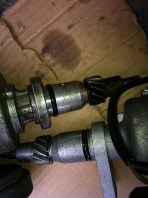

4k dizzy fit onto the electronic unit?
No, completely different I'm afraid Twinky.

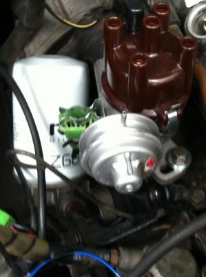

I recently wired up a 4K electronic distributor and external ignitor. Anyone doing this conversion make sure you don't mount your ignitor too close to your coil as it messes with your tachometer and gives it an incorrect reading. I'm guessing the magnetic field from the ignitor or something effects the current(or voltage?) in the wire that connects the coil to the tachometer. I really couldn't figure it out, I just know that mounting it too close stuffs it up, which was a huge pain in the butt when I had to rewire it all to move the ignitor away.
Edited by rianwest
^ Also keen to know, I just used a 'T' piece to split the vacuum line to both ports. In the pics there are two vacuum lines to the electronic distributor, the stock setup only has one vacuum line, where do I run the second vacuum line from, and which port should it correspond to on the vacuum advance?
Edited by rianwest
