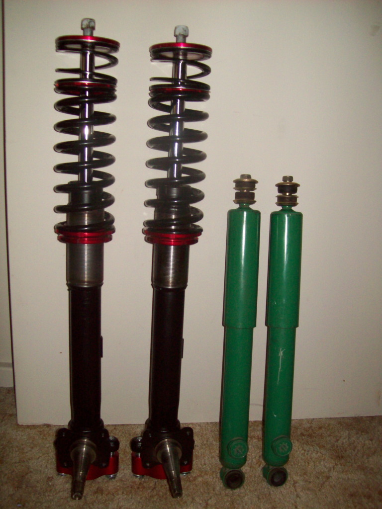

November 17, 201016 yr Author comment_482766 Would a set of these help my handling on the old rolla???? Of course ill have trouble putting them in and they will cost me but meh ill get to that hurdle later and i can always save while i do body work :wink: :hmm: Report
