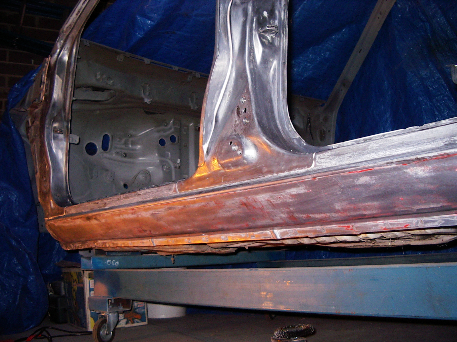

Gave the drivers sill area a quick sand up, then into the Metal Mend it was.

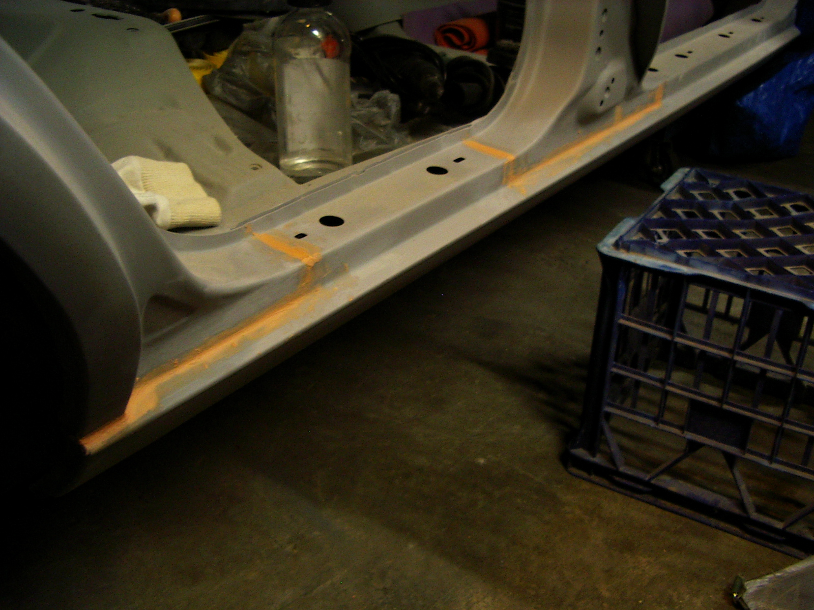

Got into the bog as well ;)
And the front jack point.

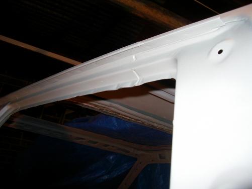

Gave the dash/bottom of windscreen a grind.
Then a hit of rust converter & wash off.
Then another grind up, wash with w&gr.
While the rust converter was doing its thing, I gave this a scuff up & another hit of MetalMend.
After it cured, it received another scuff up, a hit of bog & when that cured, just a quick hit of primer over the bare metal to look after it until I get back.

Sanded back the MetalMend on the drivers side jack points & gave them a light skim of bog to be able to bring them up nice & flat, plus filled a few low points I felt while sanding.
Also sanded back all the spot welds I'd bogged along the seam, it's way too involved getting it all dead flat so I'm going with smooth :lol:

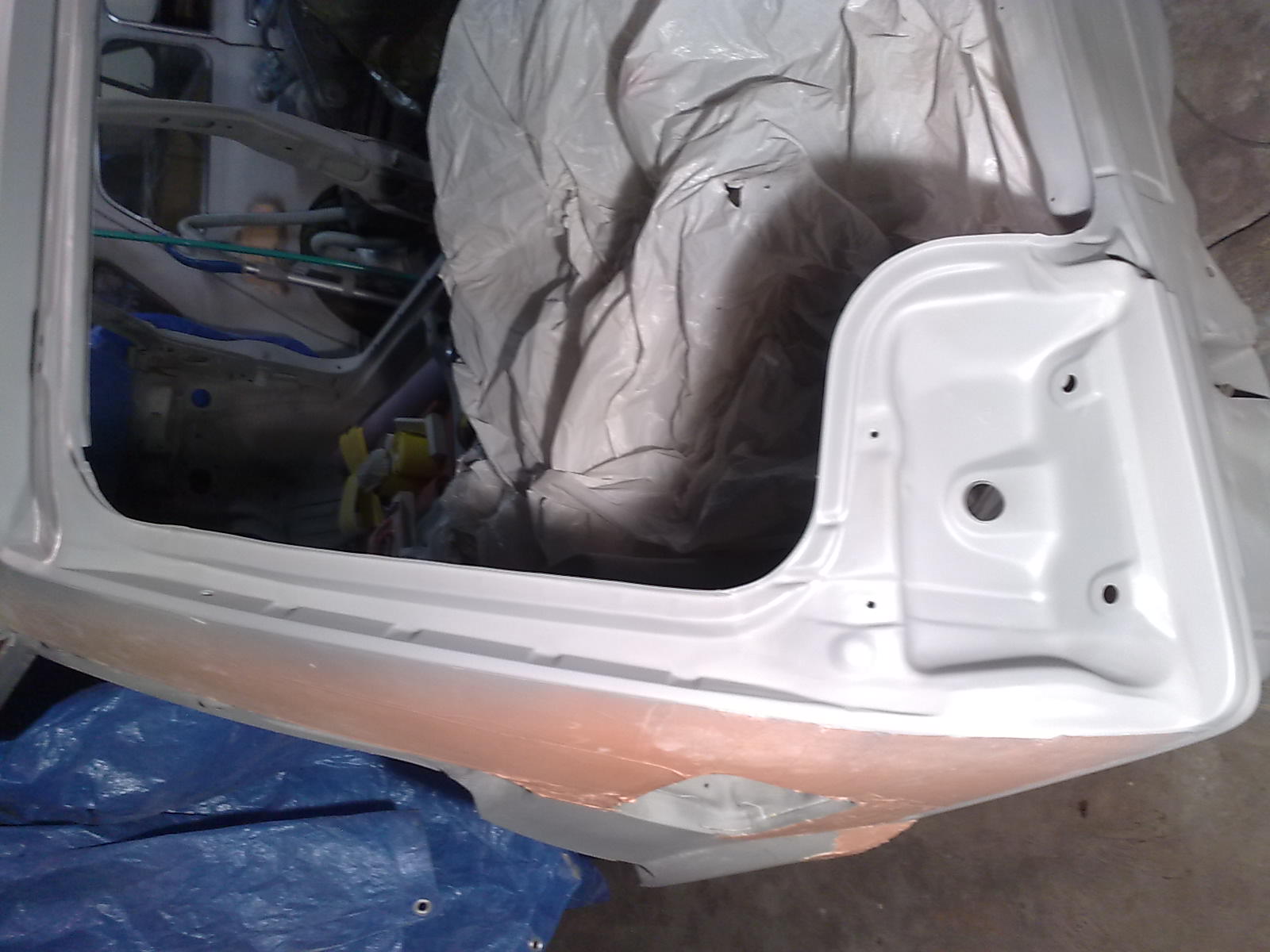

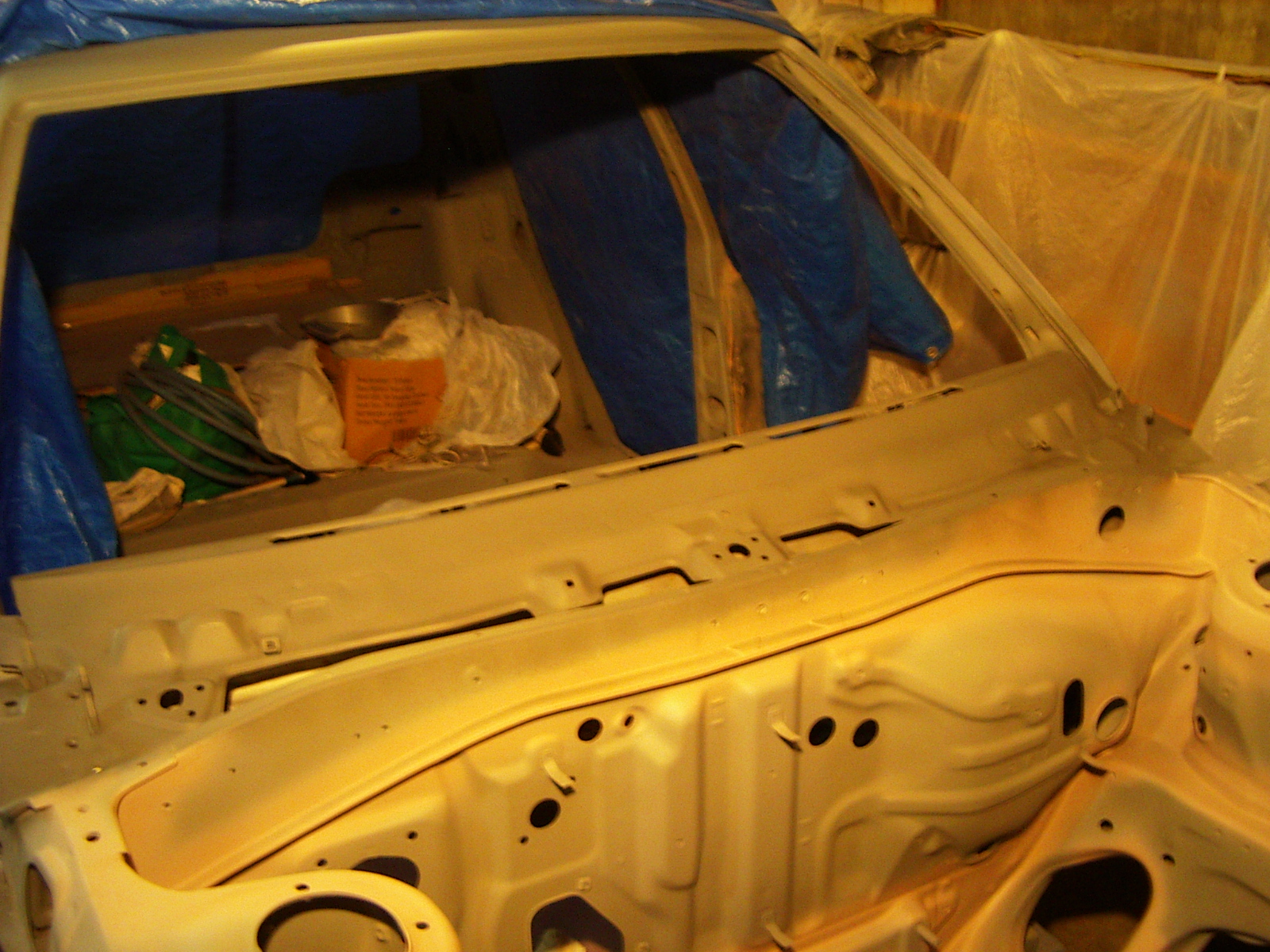

I finally got the remaining passenger side area stripped.
Rust convertered.
Wire brushed & washed again.
Primer.

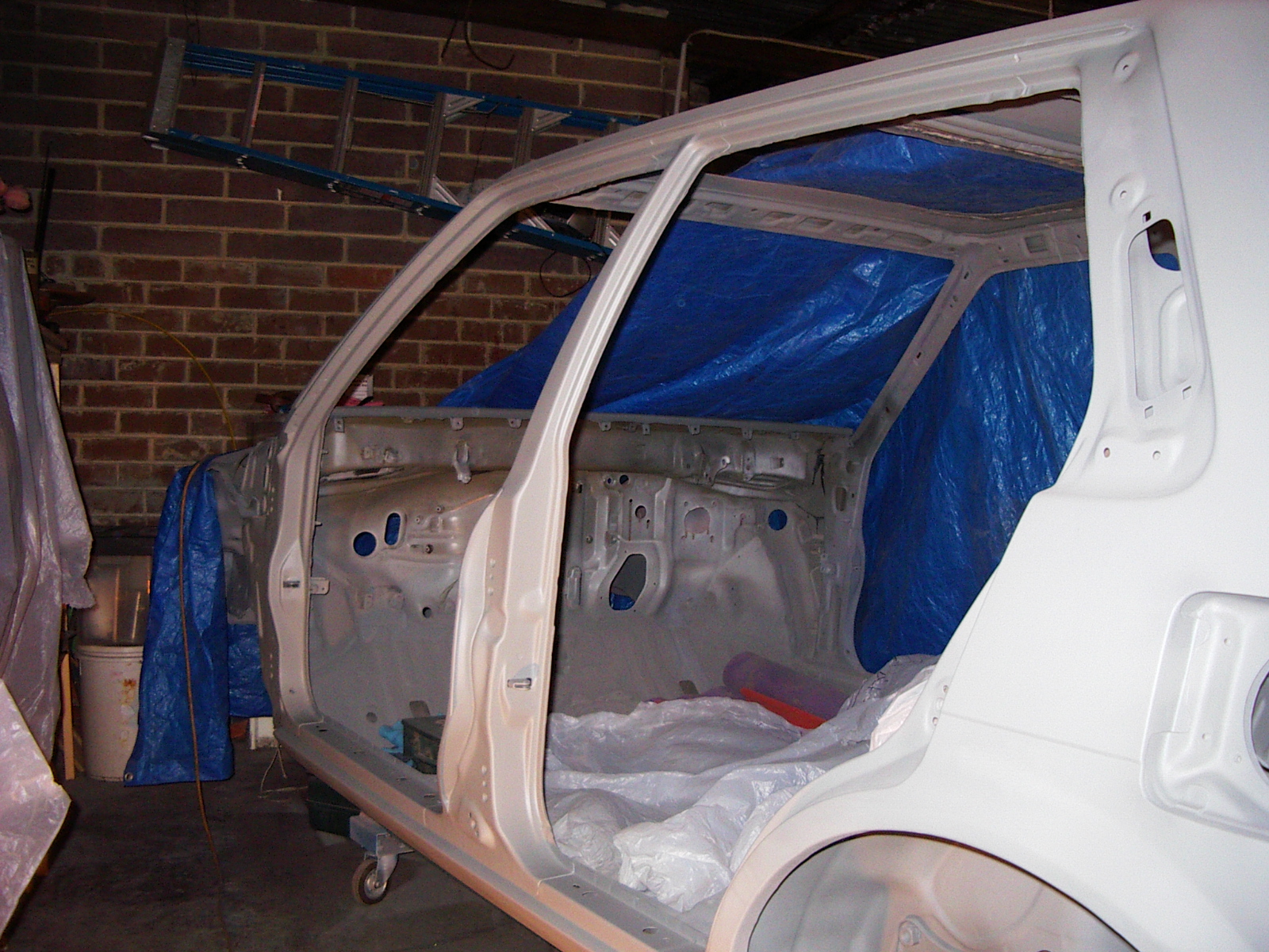

A massive photo dump...yeah, but glad to to have gotten this far :D
Am at the point I'd hoped to be at 6 months ago :lol: But...

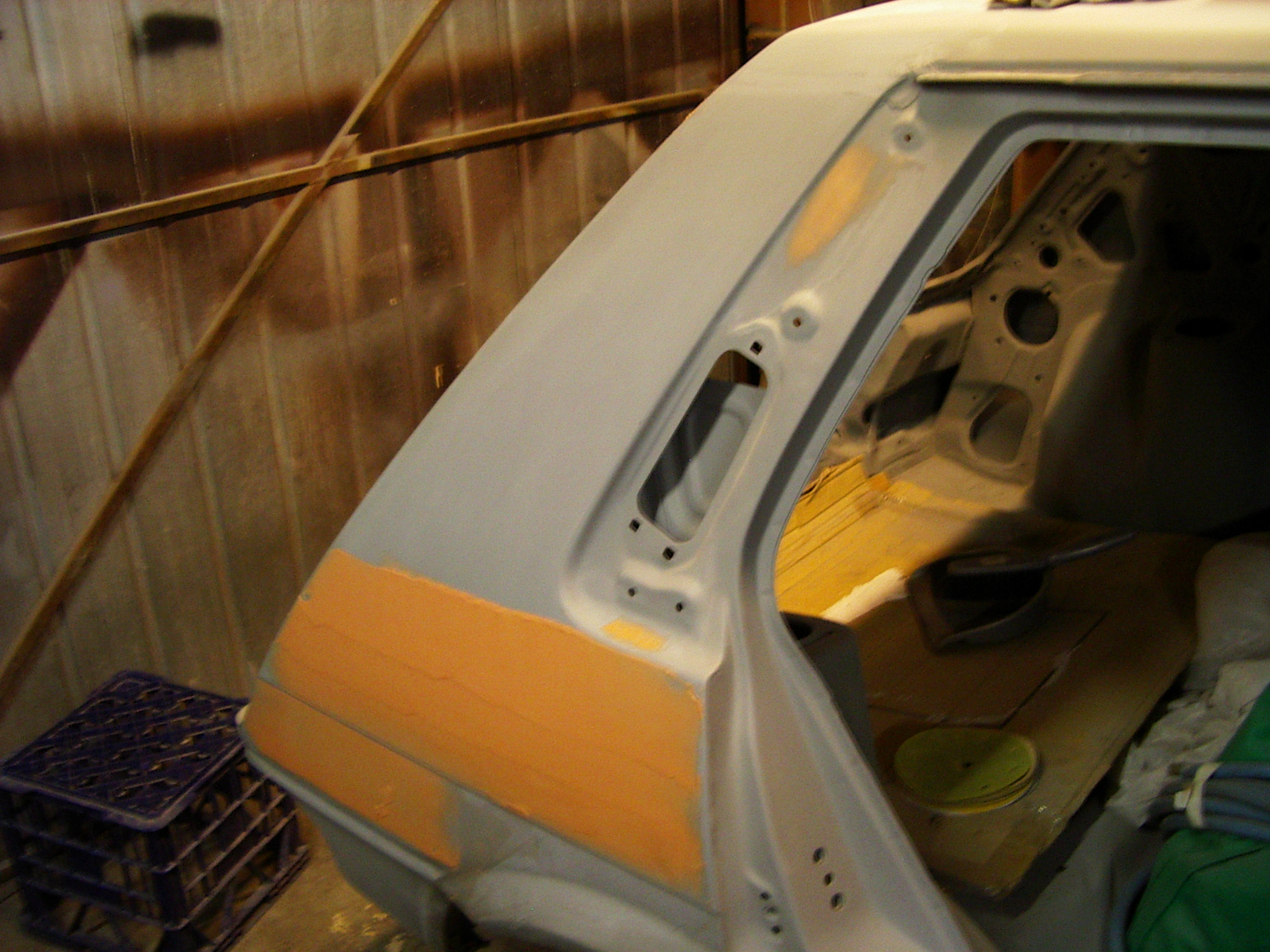

Someone let me near the bog again... :lol:
Touch-up some areas I wasnt happy with.
I forgot the camera again, making do with the dodgy camera phone. :P
Again, let loose with the bog after a scuff up & a wash.
Let the hard blocking begin!

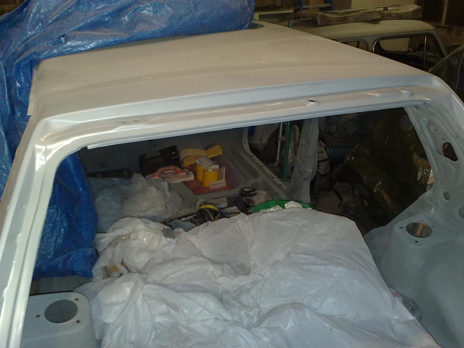

A couple of touch ups.
Done & dusted.
I have the feeling that I've done this before... :hmm:

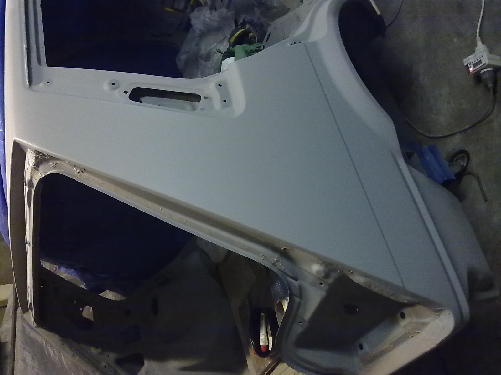

First coat of primer.
A few coats later.
One side down! :D

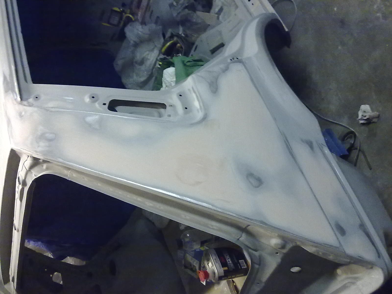

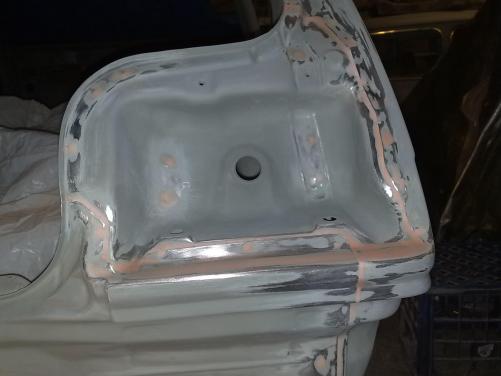

Scuff, wash & more bog! :)
While that's curing, spot-fill some pinholes & some scratches from where I was careless. ;)
First round of sanding, shaped with coarse grit sandpaper.
After second round of sanding, with a finer grit sandpaper.

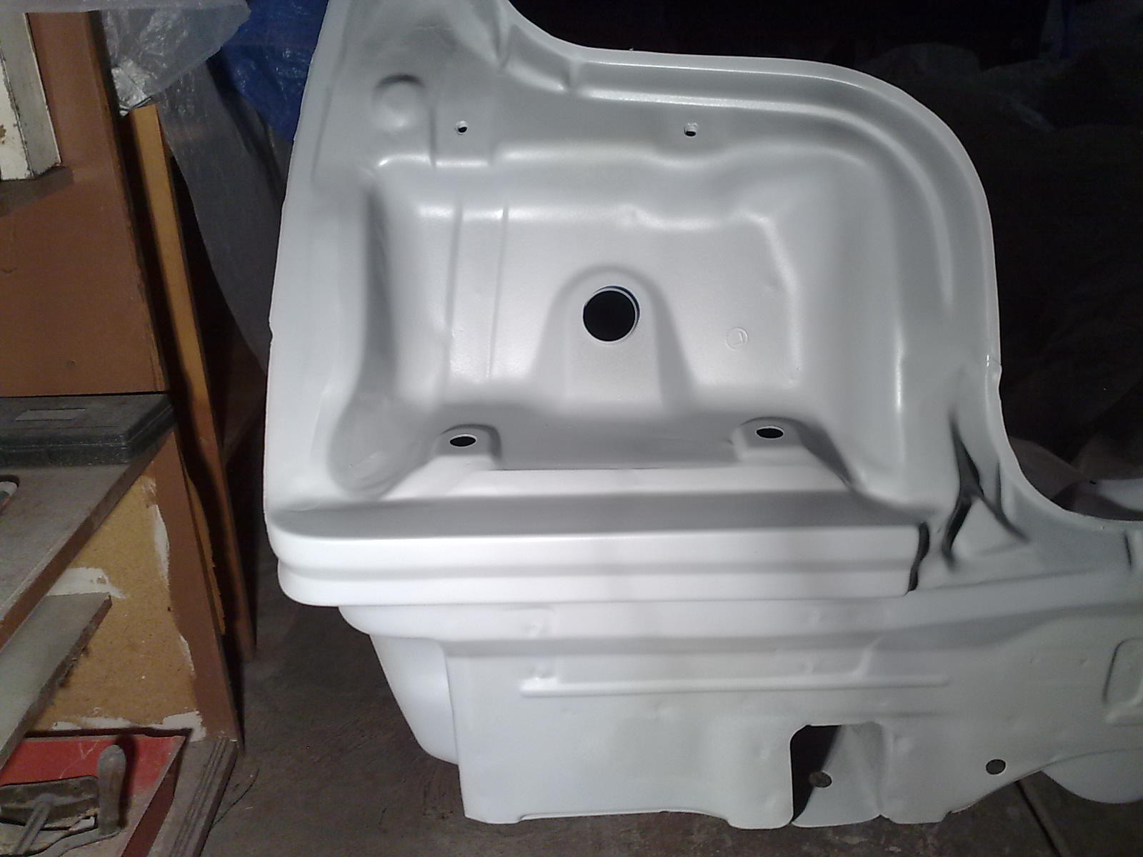

Ooh ooh, we have primer! :D
We also have some spray putty on the bits that needed a little more meat, just for good measure!
