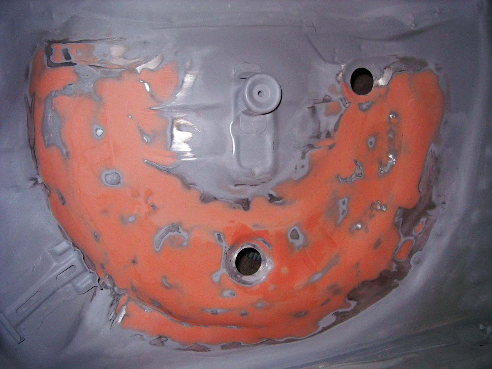

Mmm very nice bog work ;) Looks to me as if there is a little too much hardener because it's so orange.
Thanks mate! :y: :hmm: You could be right about the hardener, it was freezing cold the night I applied it so I may have been a bit enthusiastic with it. It didnt look THAT intense in real life, could just be the camera that emphasises it :( Sanded up okay, will keep an eye on things when doing the roof! :yes:

One colour bog now...
Now different colour, same bog :yes:
Ahh who cares, we have primer!

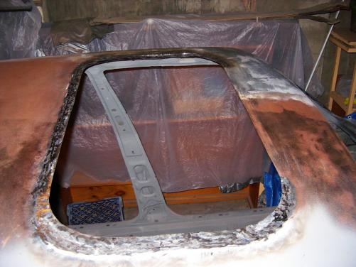

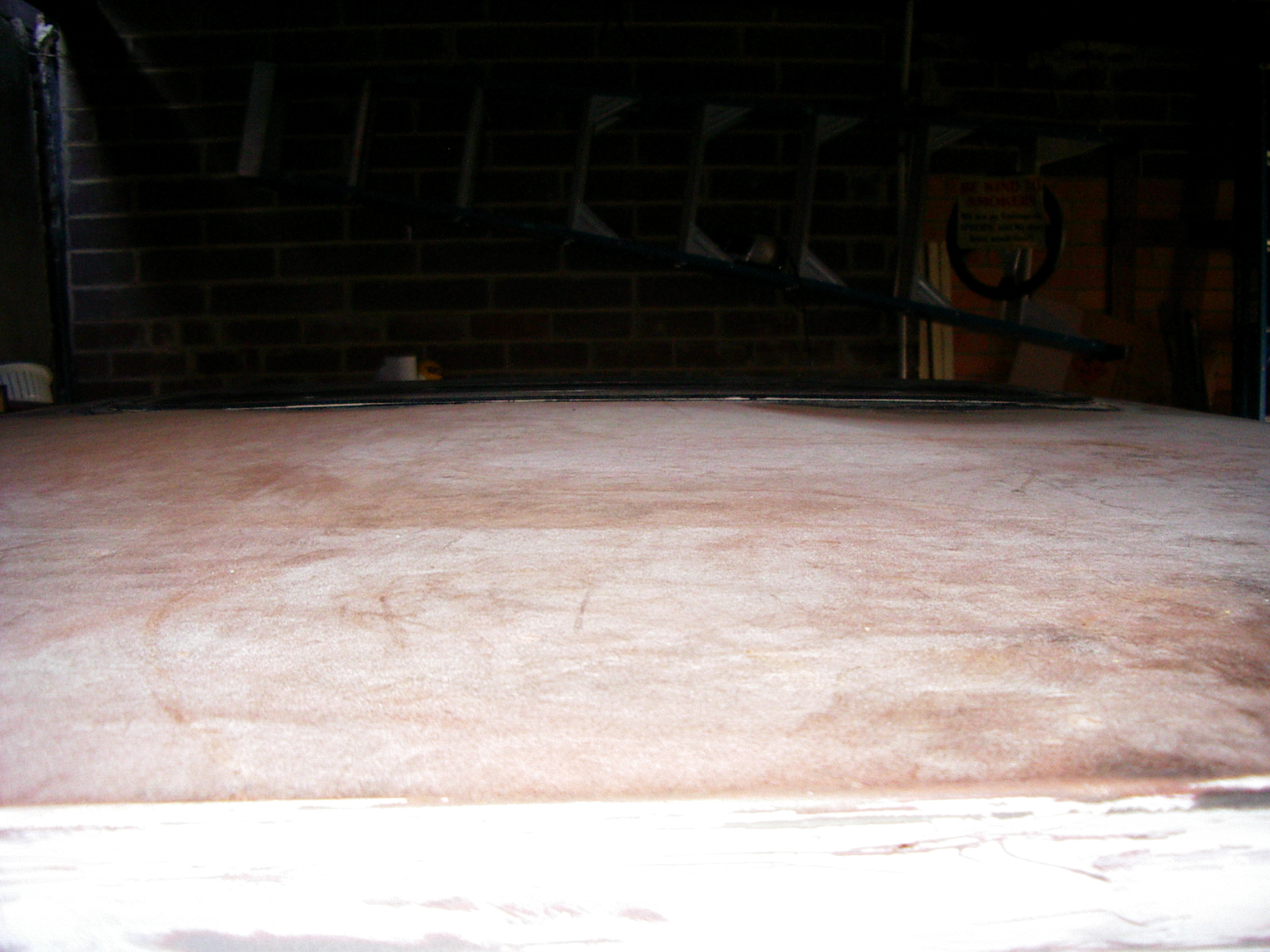

Hey, you know how I love doing things in the exact order I orginally planned? :no2: Well I lasted about 10 minutes on my back sanding the outside of the wheel tub when I decided to get stuck into the sunroof area instead :laff: My thinking there was that I could sand the bog anytime, where I could only grind & bash things with hammers up until a certain time of night :)

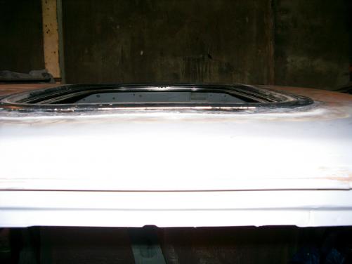

This is the first test fit of the sunroof frame...bugger me if it didnt just drop right in! No grind-hole-to-fit, no slop in the hole & generally straight :blinks: :blinks: :blinks:
Oh yeah, some 'tweaking' needed here!
and here..
And here.
Inside view, the reason I filled the hole to move the sunroof forward is it made the release handle easier to grab from the drivers seat. Also had concerns about the handle fouling on the roof croos-beam if moved backwards :)

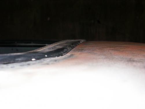

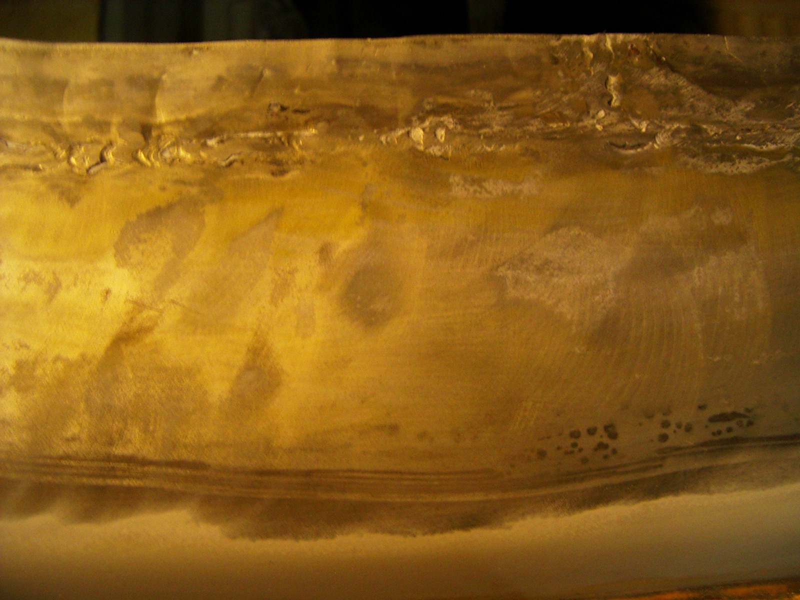

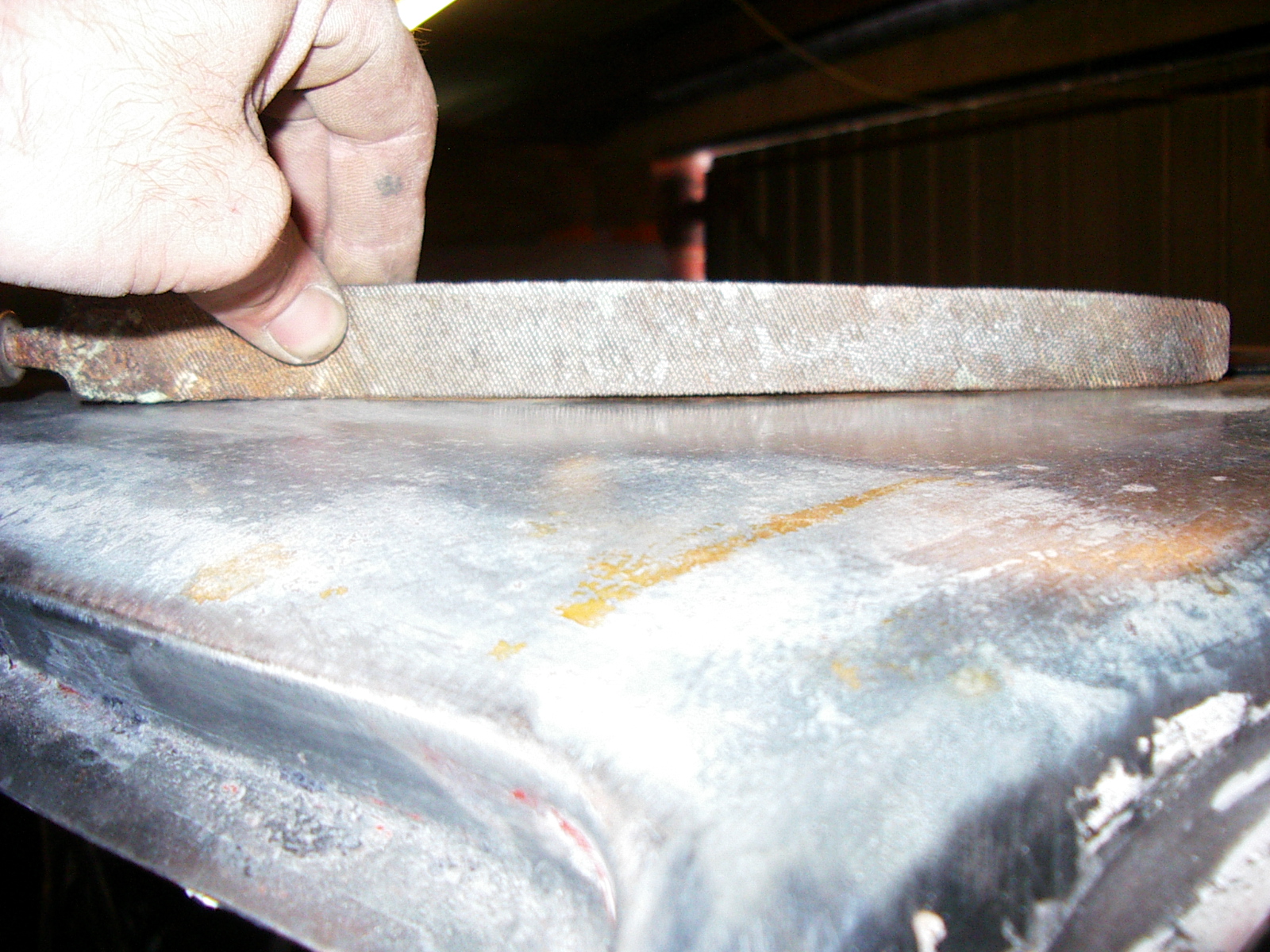

There's something soothing about banging things with a hammer when you've had a sketchy week...Results of Round 1.
I missed this?
Gonna need some more lovin'.
Edited by carbonboy
After Round 2 I'm wondering if I'm just making things worse? :hmm:
Sit back & have a think about things...
This is what I'm dealing with...
A new plan of attack is born...

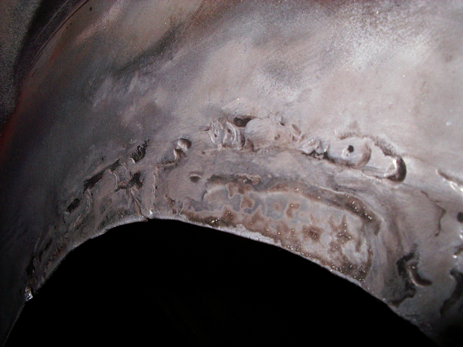

Ground the welds back with grinding disc, then took a coarse brush to it, followed by fine brush on a drill for the hard to get at places. Now giving it a hit of rust converter :)
Bubbly goodness.
While that was doing its magic, I blocked back the MetalMend fill near the rear passenger wheel arch.
Mmmm, no more rust! :D
Oh yeah, when grinding metal, either keep your bloody hands out of the way or wear gloves. I have a fresh reminder that recently ground metal is hot... :bash: :bash:
Wet rag wash, metho wash, looking much better.

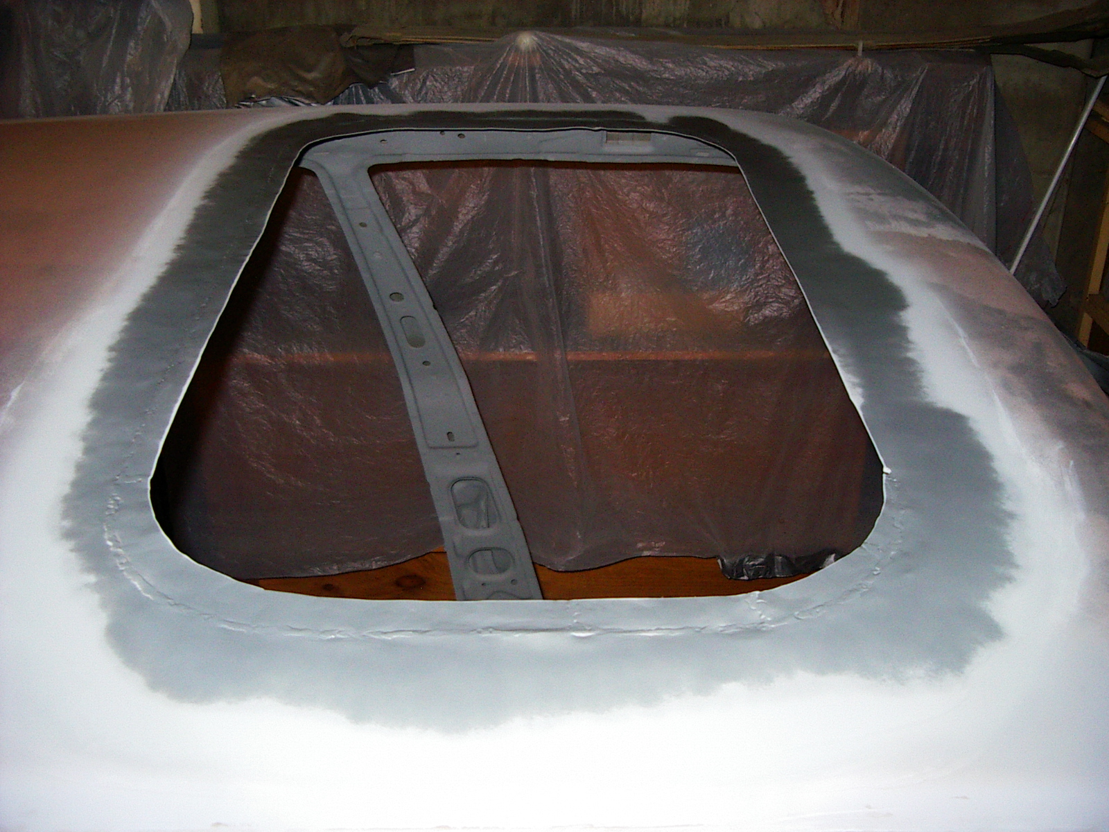

Spot near passenger wheel arch washed down & primered.
Wire brush the whole kit & caboodle, wash down & primer!!

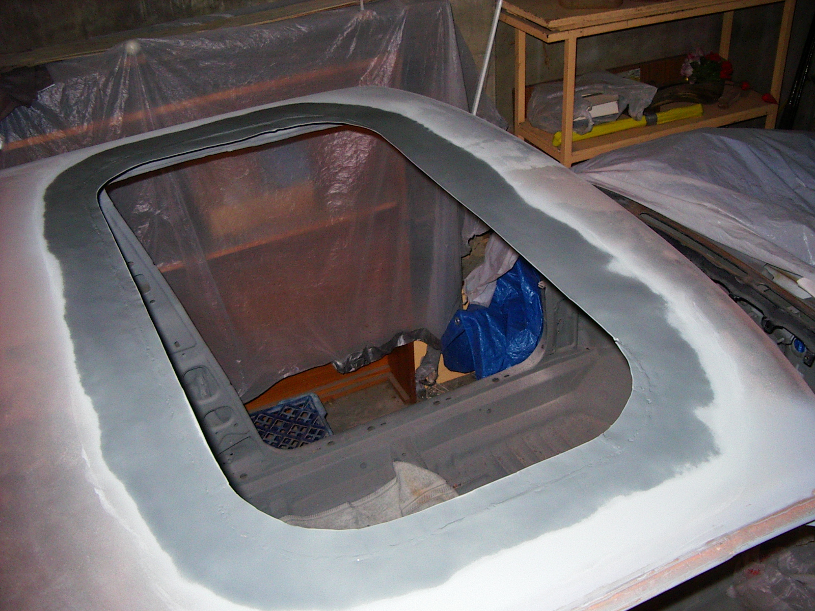

As you can tell, there's still some more 'tweaking' needed but I feel better with some primer on it as it may be another day or three before I can get back to it :( Will just sand & prime again :yes:
