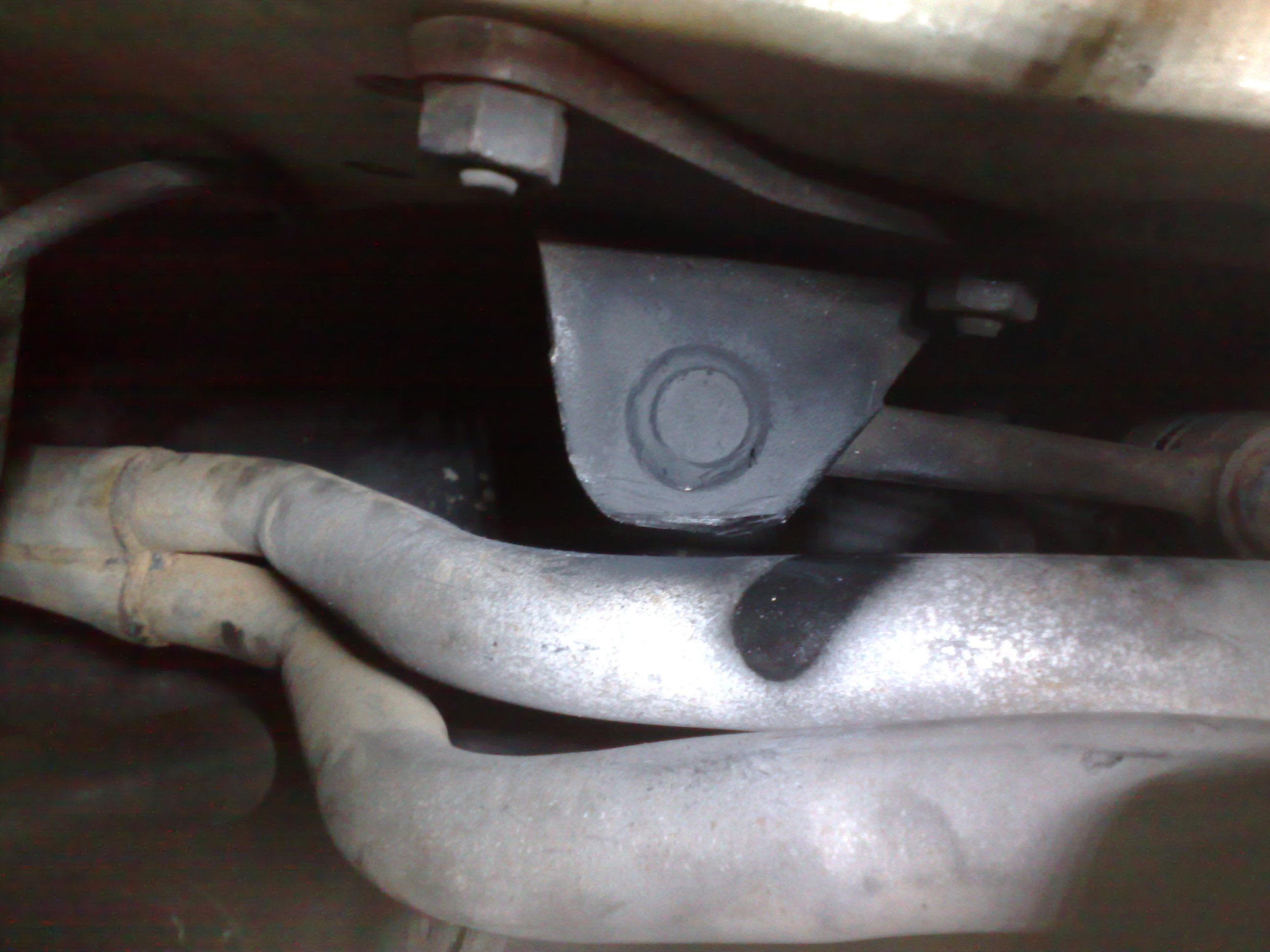

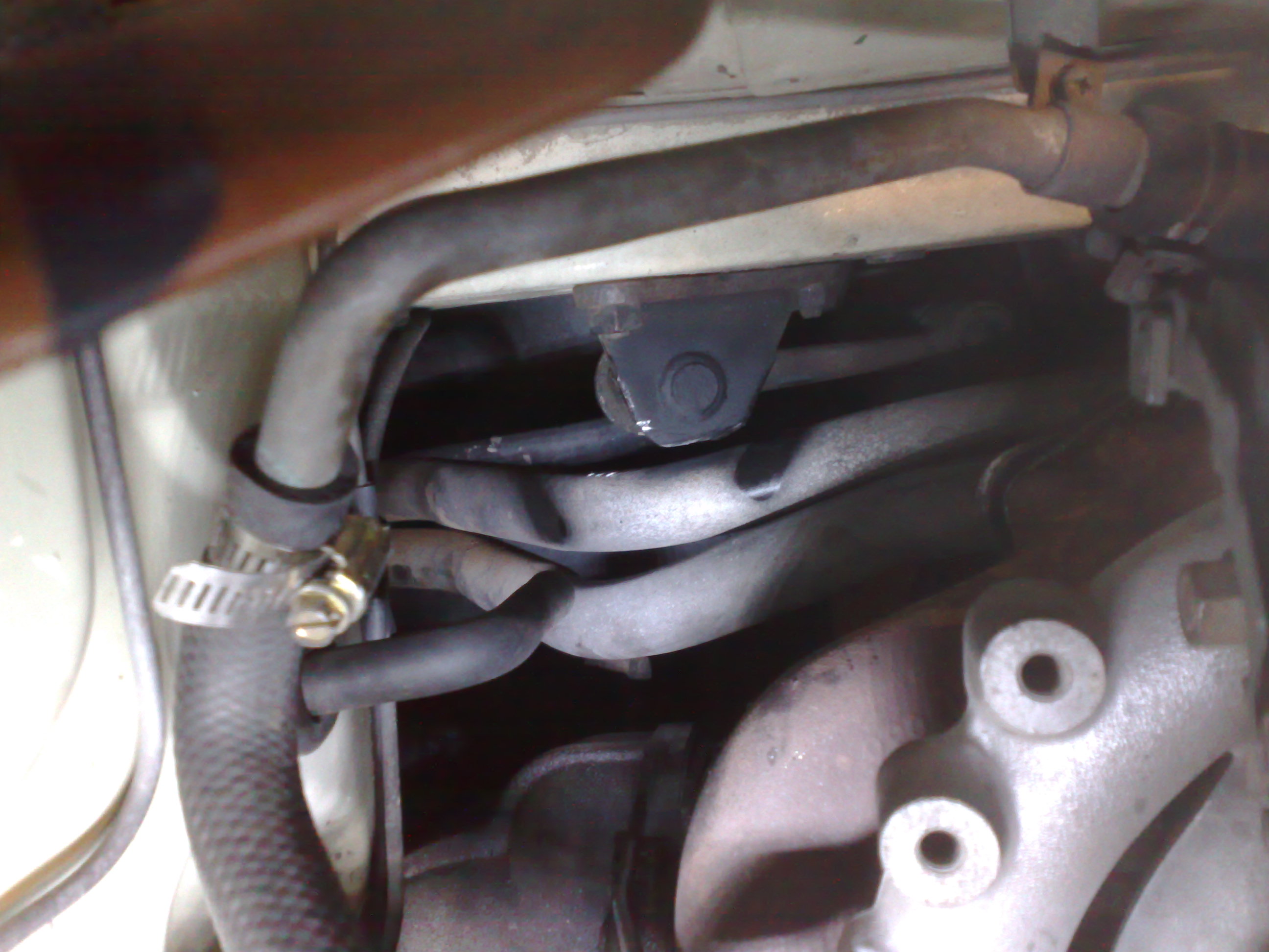

i'd love boost, but the head was built soley na and if running 7cc pistons ill have something like 11.5:1 compression! i have to pull my finger out and get the valve springs sussed so i can decide what cam. once ive got the cam spec sorted i'l have to really pull my finger out, get rwc, rego, pull the motor out, sus the dish on the pistons and start spending some hard earned, its difficult at the moment so comeon everyone buy my shit!!! i need to know if the 4k motors ran a sandwich style intake/exhaust manifold setup and if it ran a straight 4-1 exhaust manifold with the 3 bolt triangle styled exhaust pipe. i bought a 5k in a ke70 and the original exhaust cleared easy for the rack and pinion. on the ke35 it rubs on the idler arm so I'm thinking of a clean cut and welding some flex pipe to the original exhaust so i can get the damn thing rego'd.

i had the same problem on my 55 with the idler arm touching the exhaust, get the grinder in there and cut a little tab off
