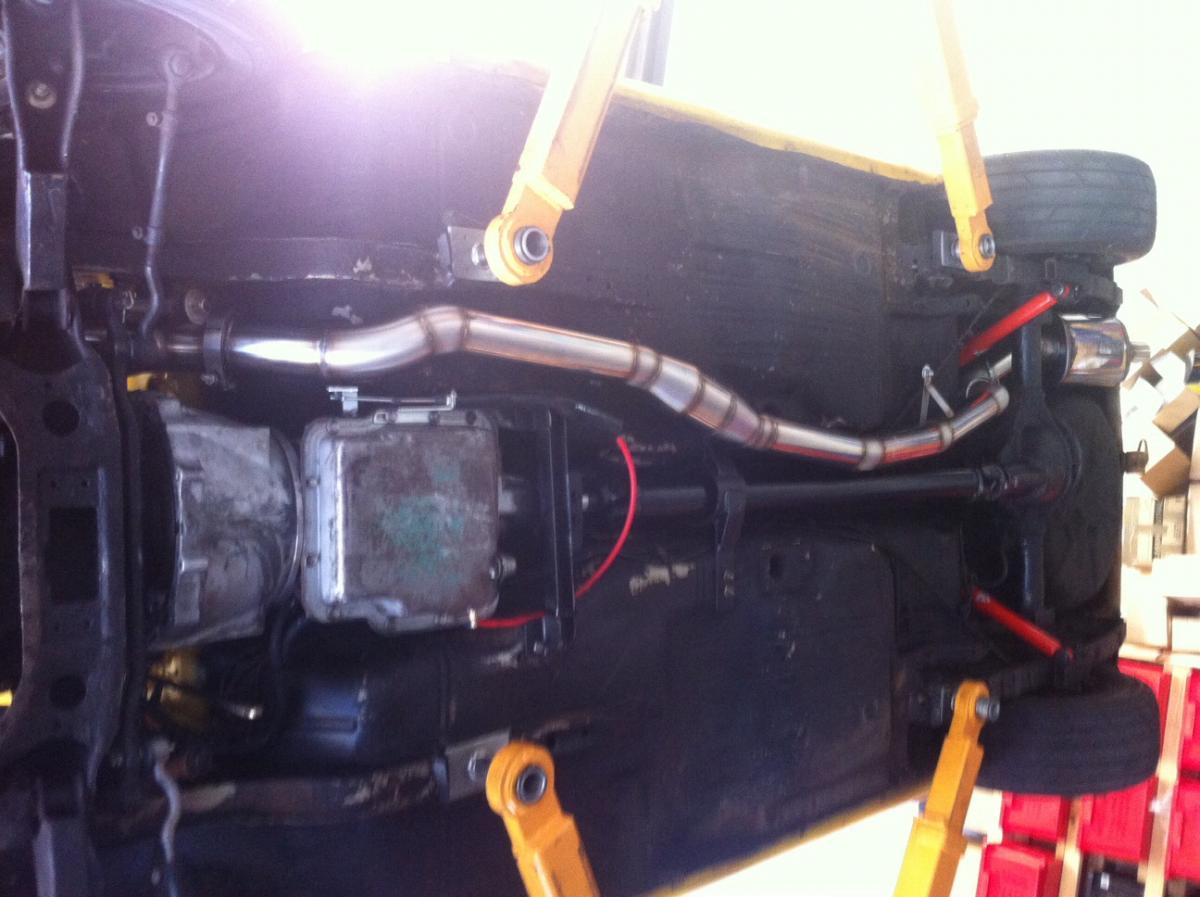

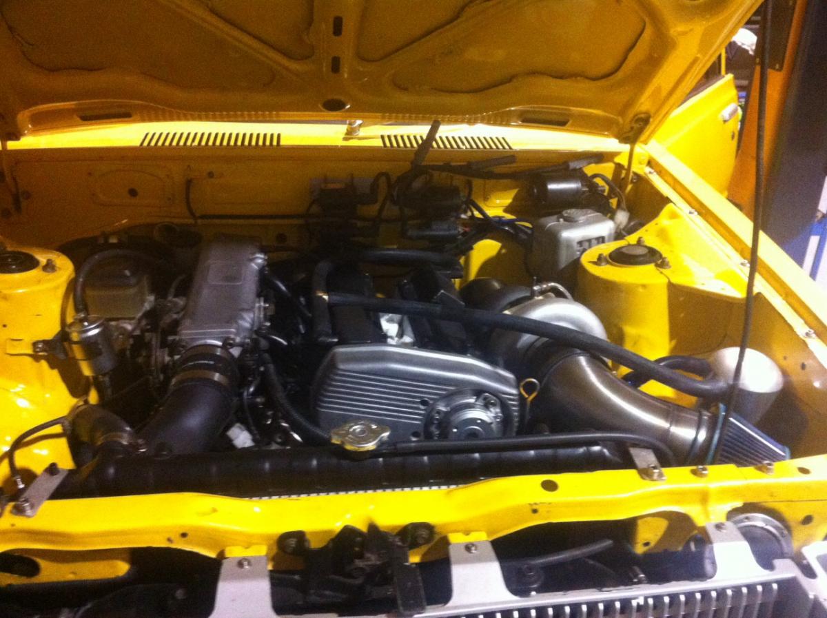

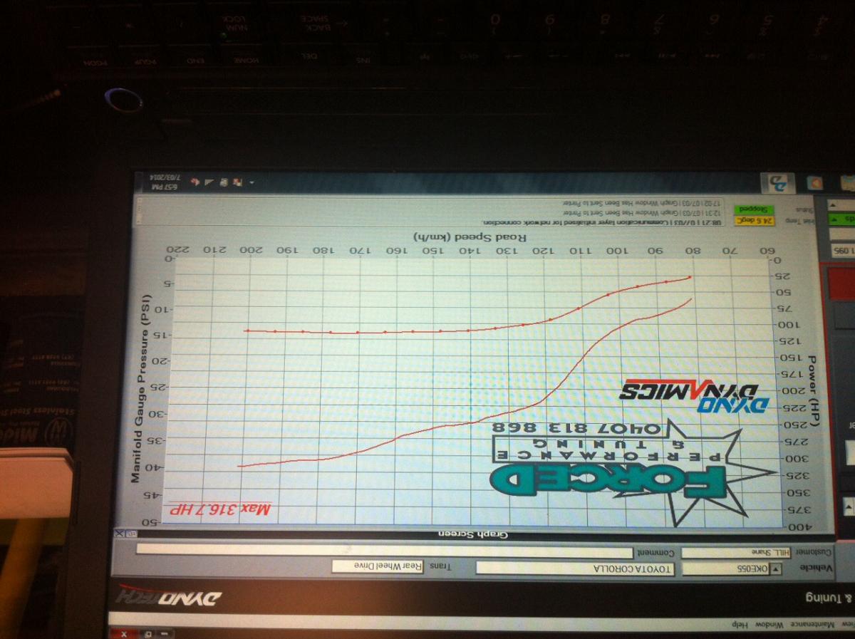

Had a busy week this week got the Rolla up to Goleby's Parts/ Forced Performance to put in my new built motor and new parts.
Put my 6 boost manifold and turbo on and everything fits so well. Got a full stainless exhaust made.
Had a few small issues like cams that didn't clear the motor so head needed a bit of machining to fit. But it's all in and running now and I'm getting very excited about what the future holds for the old girl.
Have a few more gauges and stuff to wire up but all should be done this weekend and I can start enjoying her a bit.
She hit the rollers this afternoon for a quick tune. Made 265hp on 10 psi and 315 on 14 psi so I'm excited to see what some real boost will put down.
Sorry about the upside down dyno graph can't figure out how to spin it on my ipad......

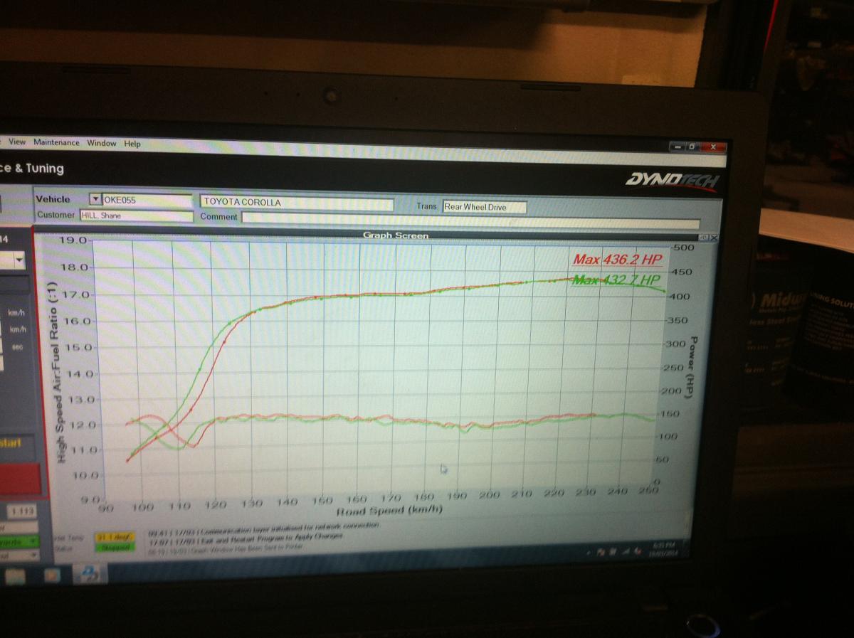

More boost netted nice results
23psi

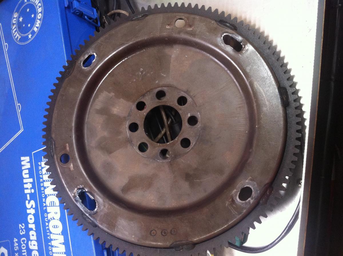

Destroyed a flex plate so while the box and converter was out to get repaired it's getting modified for a extra 500 rpm stall will have it back Monday so I'm hoping everything is still good for Wednesday night. Heaps of mates heading down racing as we have a public holiday here on Thursday.
No it was the converter that caused the issue it wasn't machined right in the centre originally and caused preloading on the flex plate causing the converter bolts loose. Which caused the the damage, it is fixed now just getting modified to stall higher as I felt it was just a little to low. It will climb up on to boost but takes 5-10 seconds as it's close to being big enough. Another 500rpm will make it just less stress on everything and make it faster to stall it up

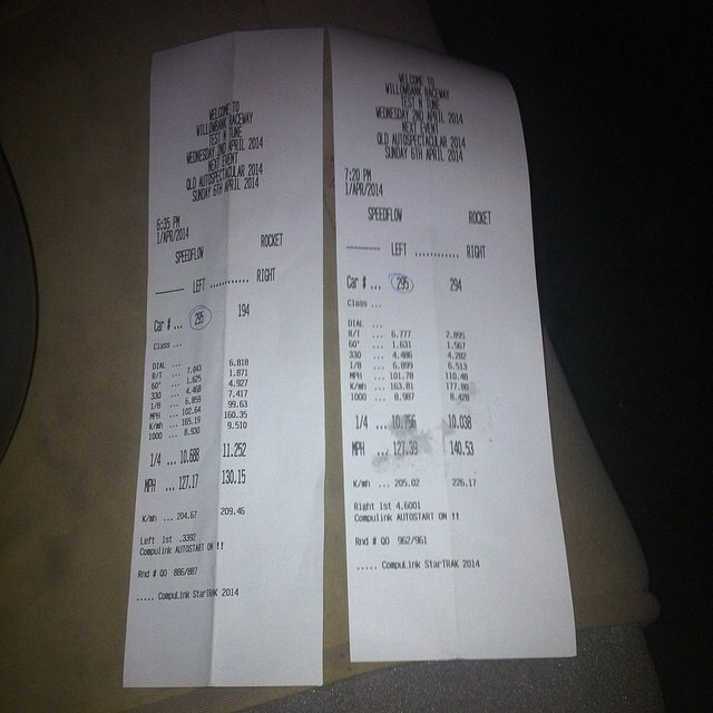

Race time tomorrow night getting keen, diff gears have been changed to 3.89's it picks up a lot better than the 3.45's so will have to see how it goes.
Got 2 runs in before I had converter bolt issues again....... Drove the car down (120kms approx) first run 10.65@127 blowing the breather fitting off my cam cover and spewing oil onto the track and my dump pipe from 3/4. Track that fixed I then followed it up with a 10.75@127. Seemed to be geared just right first shift light of 4 came on both runs as I was crossing the line and I can still lift the revs 800rpm yet if needed. Added bonus was Sleepercorty managed to run into the nines and drove the 250km round trip. I'll throw some videos up tomorrow night when I get a chance
