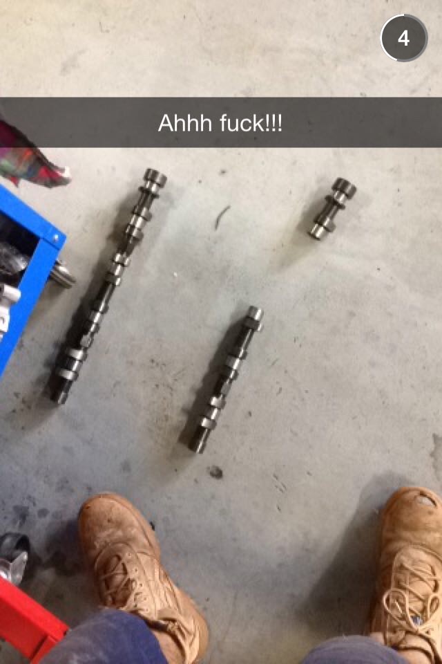

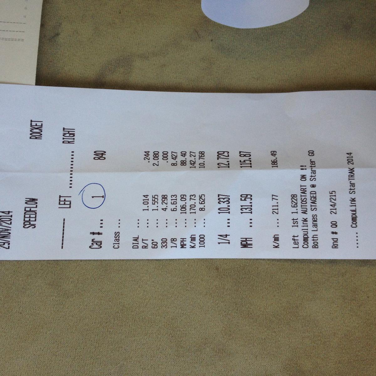

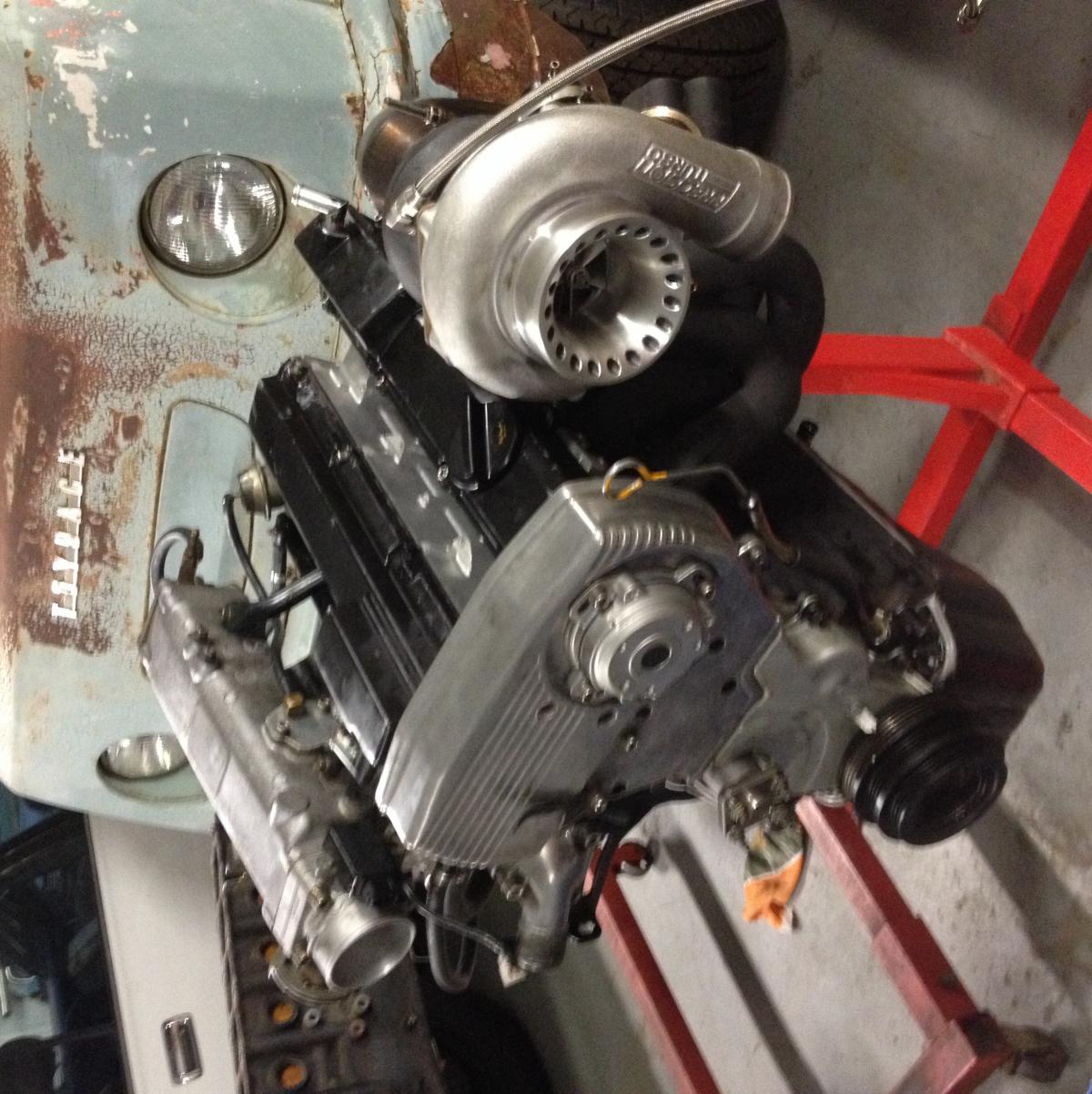

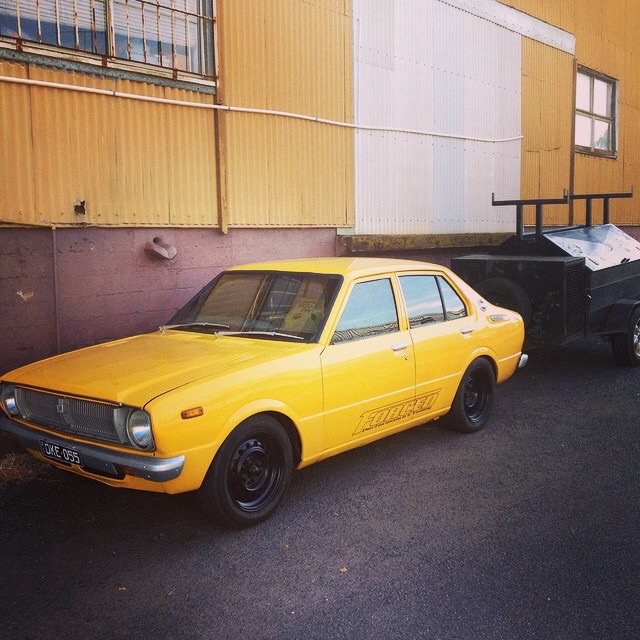

Haven't updated this thread for a while. After a unlucky Jambo (snapped a gudgeon pin and and smashed a fairly fresh motor in style from half track wrecking my motor and forcing me to start a fresh again. I competed this weekend in qld drag week after putting a new motor in the ol girl on Friday last week. After issues with broken cams, oil pumps and all the other problems That just kept popping up. But I got it done and drove her from Toowoomba to warwick and race there Friday running a nice 6.6 with a solid 60' on a less than idea track. The next day (today)I made the trip to willowbank and Ran a PB 10.33 and was told to call it a night. All of this was done towing a trailer to and from the tracks.
Excellent performance from a 1.8L full weight street car.... plus, towing a trailer to and from the track.
23 psi ? Camtech 270 regrinds ? ..snapped while installing the caps ?

Only 22 psi and they were the Camtech cams that were in my last motor it snapped tightening the caps down but looking at the break it was broken for some time as there was darker and lighter areas in the snap, it was also the same piston that the piston and head have a sudden high rpm kissing fest so that might of contributed to it.
Ah, so the cams were already weakened.

Yeah a gain of 4mph on my previous best which was in the colder months and at higher boost so this new motor is looking promising!
A street car that tows a trailer, then runs a 10 = ultimate respect
Fresh motor a little more comp then the last one
