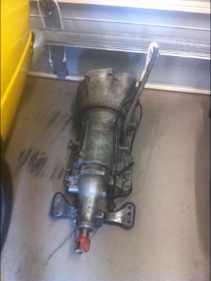

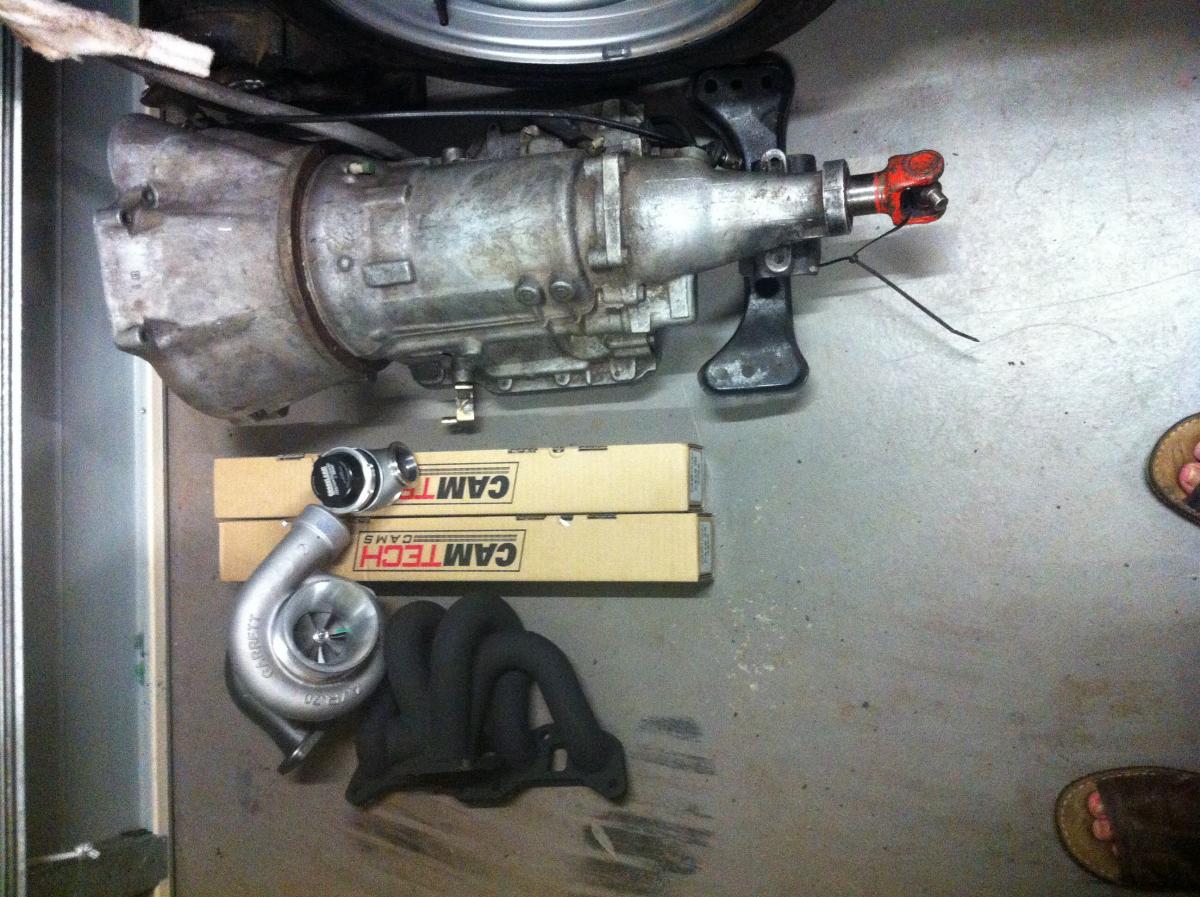

Picked up a little early Chrissy present for myself yesterday, a fully built trimatic,bellhousing adapter and a dominator 5500 converter. Time to step it up a bit and go fast. Early in the new year I'll get it fitted along with some cams and maybe a new computer/dash
Some more early Christmas presents, had to take advantage of some cheap Goleby's Parts items and bought a new turbo, sexy 6Boost manifold,external gate (45mm or some shit like that) and a set of 270deg Cams

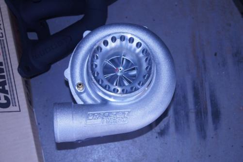

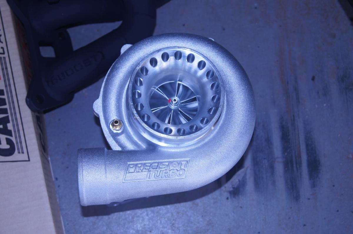

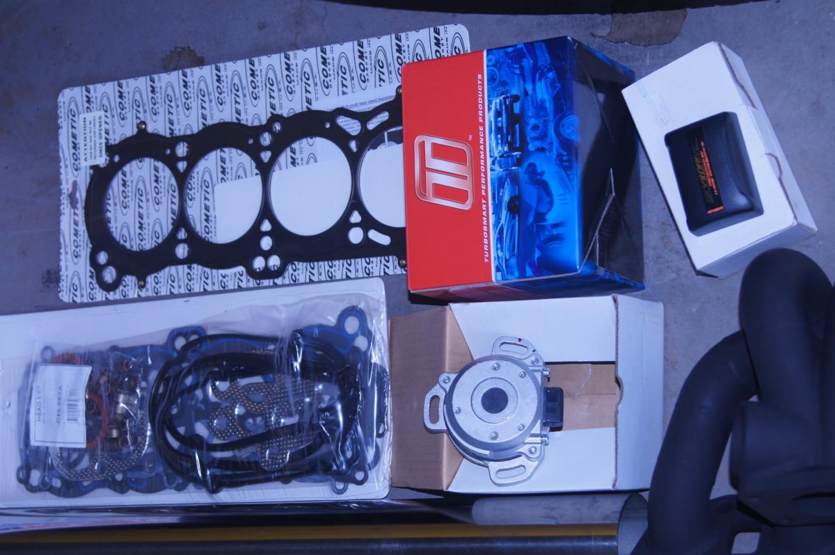

Changing a lot of things on the rolla, getting ready for Queensland Drag Week changed my mind on the garret turbo and bought a Precision 5558 instead chose a .48 rear housing in the hope of getting good response. Dropped a block off at JHH early this week to get modified and machined.

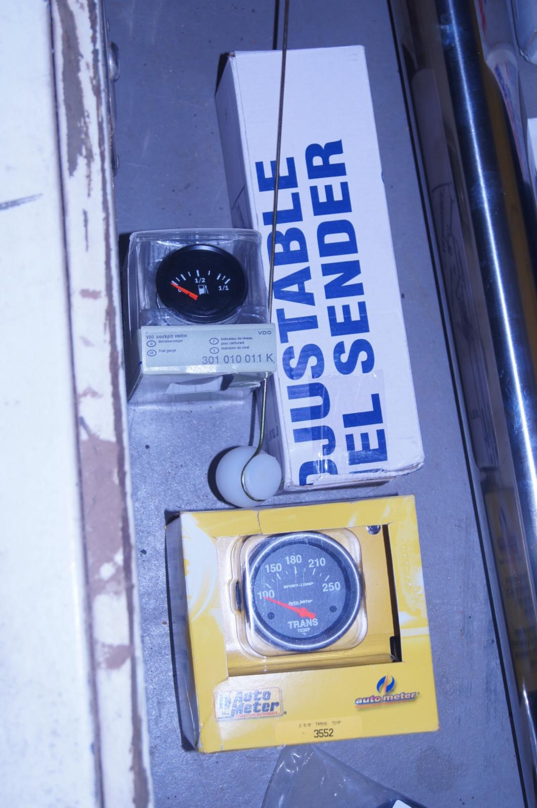

Got myself some new gauges a new wideband, trans temp and a fuel lvl gauge as mine has been playing up.

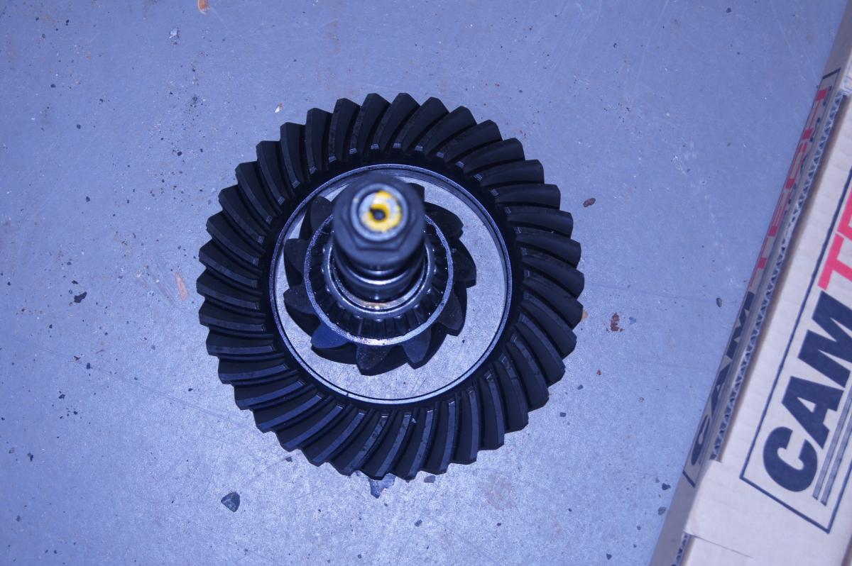

A new set of diff gears (3.45) as I previously was crossing the line over the quarter on the limiter (8000rpm) in 4th(1:1 ratio) and my trimatics top gear is the same.

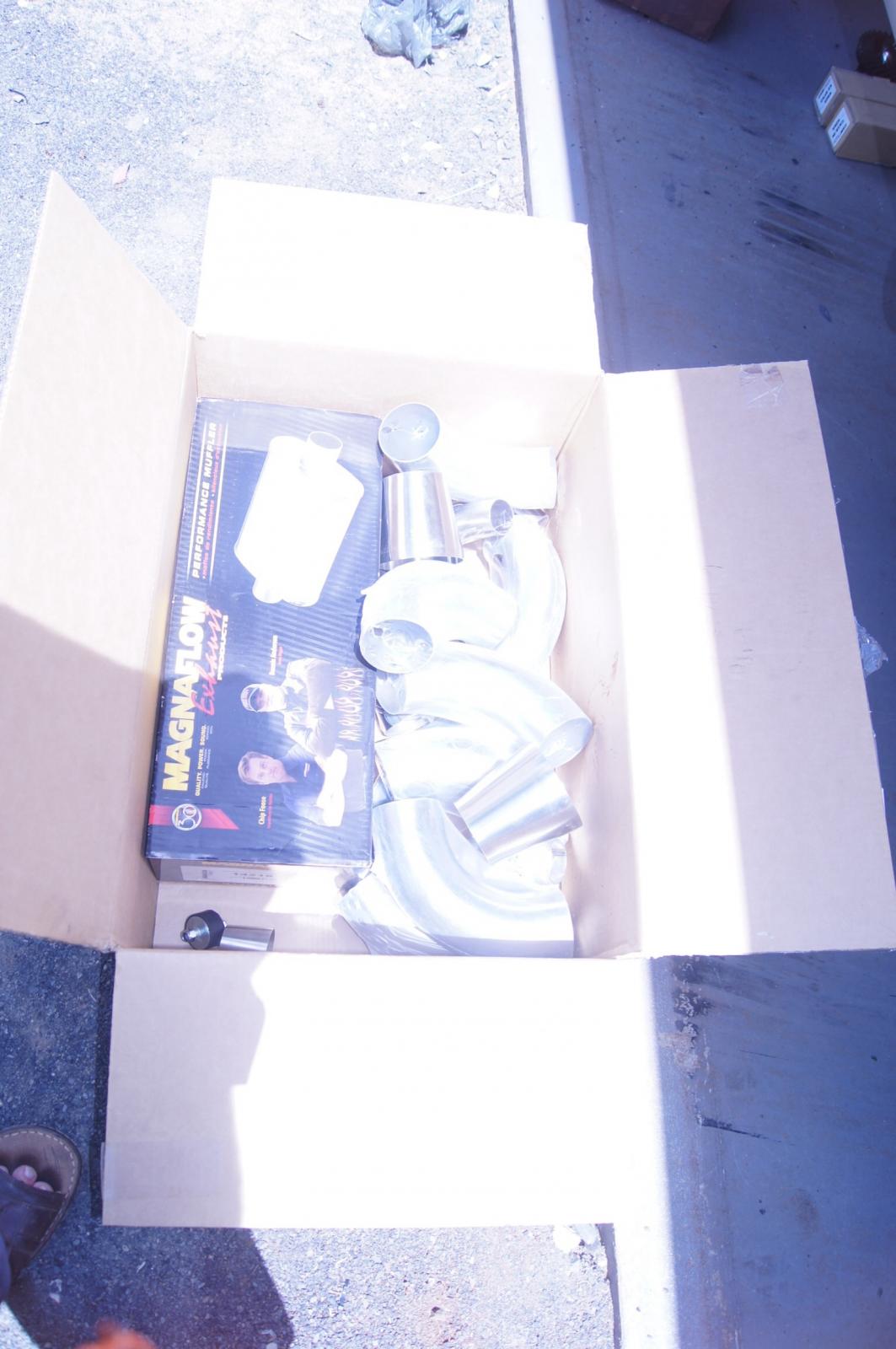

All the parts to build a new 3" stainless exhaust and plumb back the wastegate and vband couplings

I'm currently pulling the diff out to get the gears changed and servicing the brakes while I wait for my short motor to be finished.

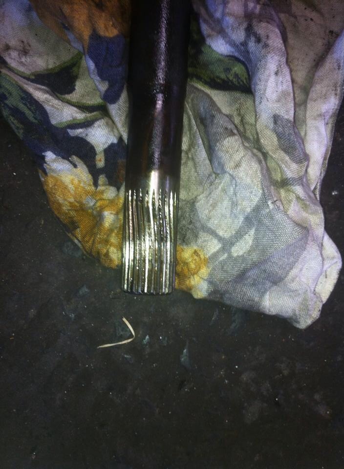

Just got my diff back from the mechanics that installed the diff gears. It needed an overhaul as all the bearings looked a bit crap and he found this!!!!! So I'm currently tracking down a new axle to get machined then ill order my tail shaft this week starting to feel like I'm getting somewhere
I have my tailshaft from the 30 Two Door if you might be interested, i can measure it,
Unless you are after a more robust unit of course
I'll just get one made, thanks for the offer though want to make it beefy
hey mate, get a billet axle for it, cut axles are not real strong. being an r31 diff you should (hopefully) have one factory axle and one that is a cut and re-spline. You should be ok with the factory one, but at least replace the cut down one with billet with your amount of powers. Call altra nine in caboolture he is really good, approx 400-500 for one axle i think. He also does tailshafts, full cro-mo whatever you want.
Yeah was just talking to a mate this morning about going billet. yes 1 factory 1 cut
