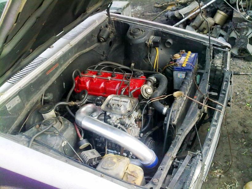

you probably can't find much or any info because they have already been proven to make plenty of power with a turbo setup. Otherwise will need to make a bracket for the charger, custom intake piping, setup the carby for it and jet and tune it or buy efi stuff, probably cheaper to go turbo?? or just go 4agze.

Putting a turbo or supercharger on an engine not already fitted with one is probably going to be the same amount of work irregardless. You're best bet is to look at some of the build threads for people who have 'charged' their K motors. The building of brackets, plumbing, setup of carb/efi etc is all going to be pretty similar to what you would need to do with a 3T.
Either way, it's a reasonable size job if you're reasonably mechanically inclined. If you're not then do a lot of research first and maybe think about finding someone that can help.

what you are talking about is custom conversion, 3ts never came out with turbo or supercharger, so the reliability and success of the work will come down to the person who is doing the work, ie you.
The blokes in Puerto Rico are getting like 8sec 1/4 mile times on turbo 3tc's.....they must do good workmanship.
i think t18drifts you need to broaden your researching, forget about the 3tc for a good 2 weeks worth of research, and figure out what is generally required for turbo/supercharger conversions on an n/a engine.....then when you have a good understanding on how it works, refine your research to 3tc related stuff.
