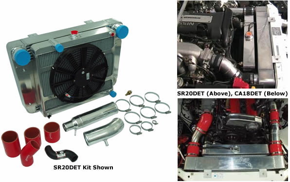

I had (still have) a Predator/PWR cooler and radiator setup that pulled everything inboard but the thing was cumbersome to make work for something sold as "bolt on". I got tired of trying to make it work with my cooling system so I went back to a conventional setup but with a smaller and lighter intercooler. It'd have to be half the weight of the old one which had cast aluminium pipes coming off the intercooler so at least something was achieved.
Predator setup looks like this:
Probably suit a drag car better with the radiator/cooler sizes. Just ended up going in the "bad idea" pile.

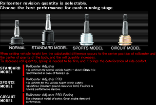

garbage 'roll center adjusters' that don't change the pivot and just push the control arm away.
PLEASE explain some more on your comment?
my 55 has around 3 degrees of neg camber. 2 inch lower and falcon springs. LCA are dead flat. it tends to understeer into hard corners but stays on track. i was under the impression that its caused from flat lca's and putting rca will push down the control arm and fix the geometry?
Moving the control arm alone wont do anything. The invisible geometry (line between outer and inner pivot points of the control arm) is exactly the same and all you've achieved is changing the angle of the control arm. You might solve bump steer doing this but the roll center wont change. You need to move the pivot itself further away vertically. Most of the Toyota RCA blocks work perfectly fine. The problem is with the Nissans because you can't just insert a block. The steering knuckle and spindle are one unit, so you need to increase the shaft length of the balljoint.
Exhibit A:
The first 2 are exactly the same, you're just moving the control arm away and the pivot stays in the same spot. #3 might have a slight shaft length increase but #4 is the only one that's going to work properly.
Alternatively you can get radical, cutting and welding the knuckle itself. Bit iffy in my mind though.
I'm not a suspension engineer but that's the way I understand it.
