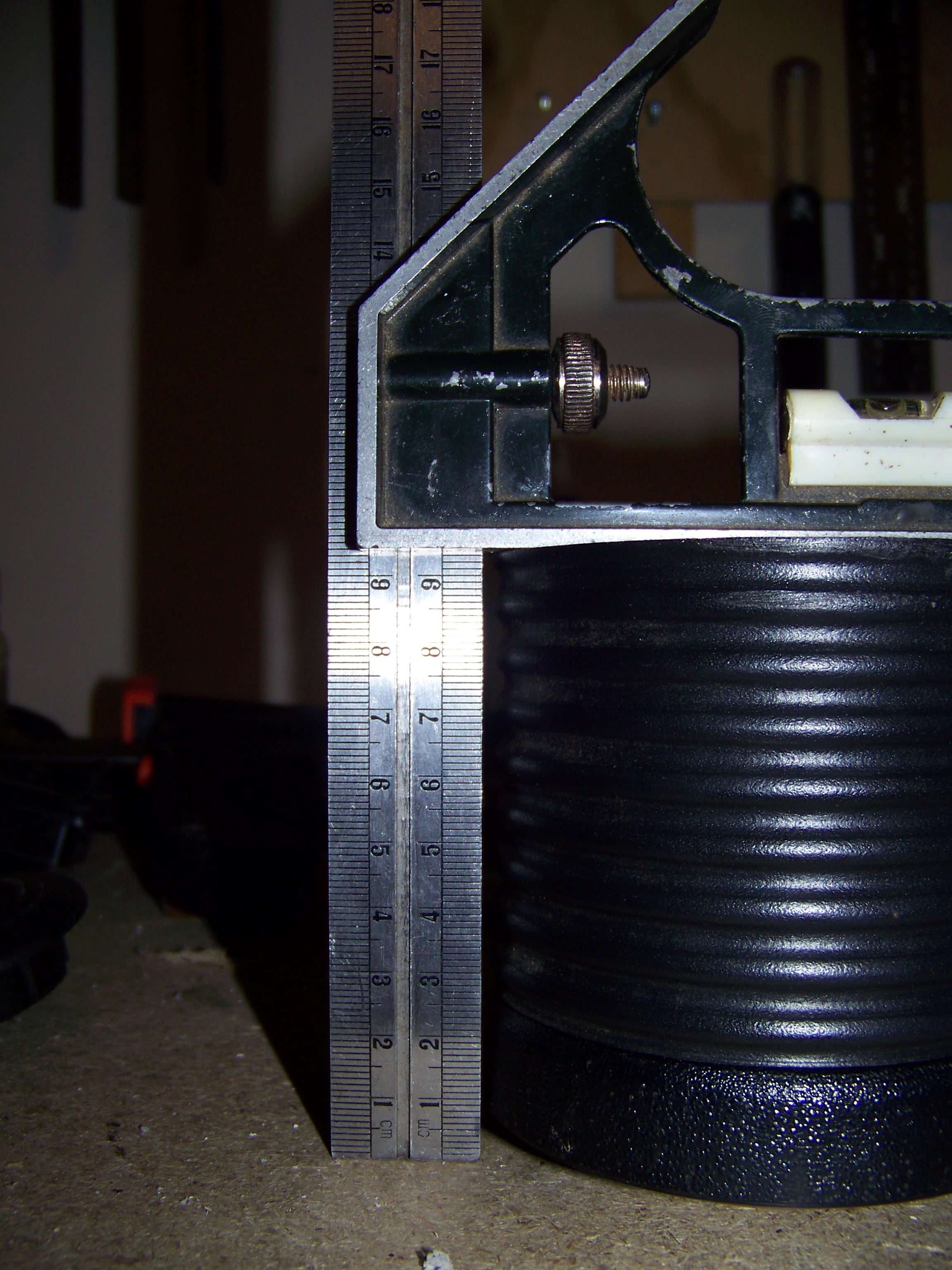

August 12, 201115 yr comment_546220 Had this one in my old ae82 - 95mm Also was using it in the ke30 at one stage but it was a touch too long. Not sure on the length of the one i'm using now, not going to go measure it as its late and cold outside but i can say is that it came from the t-18 i once had years ago. Report
