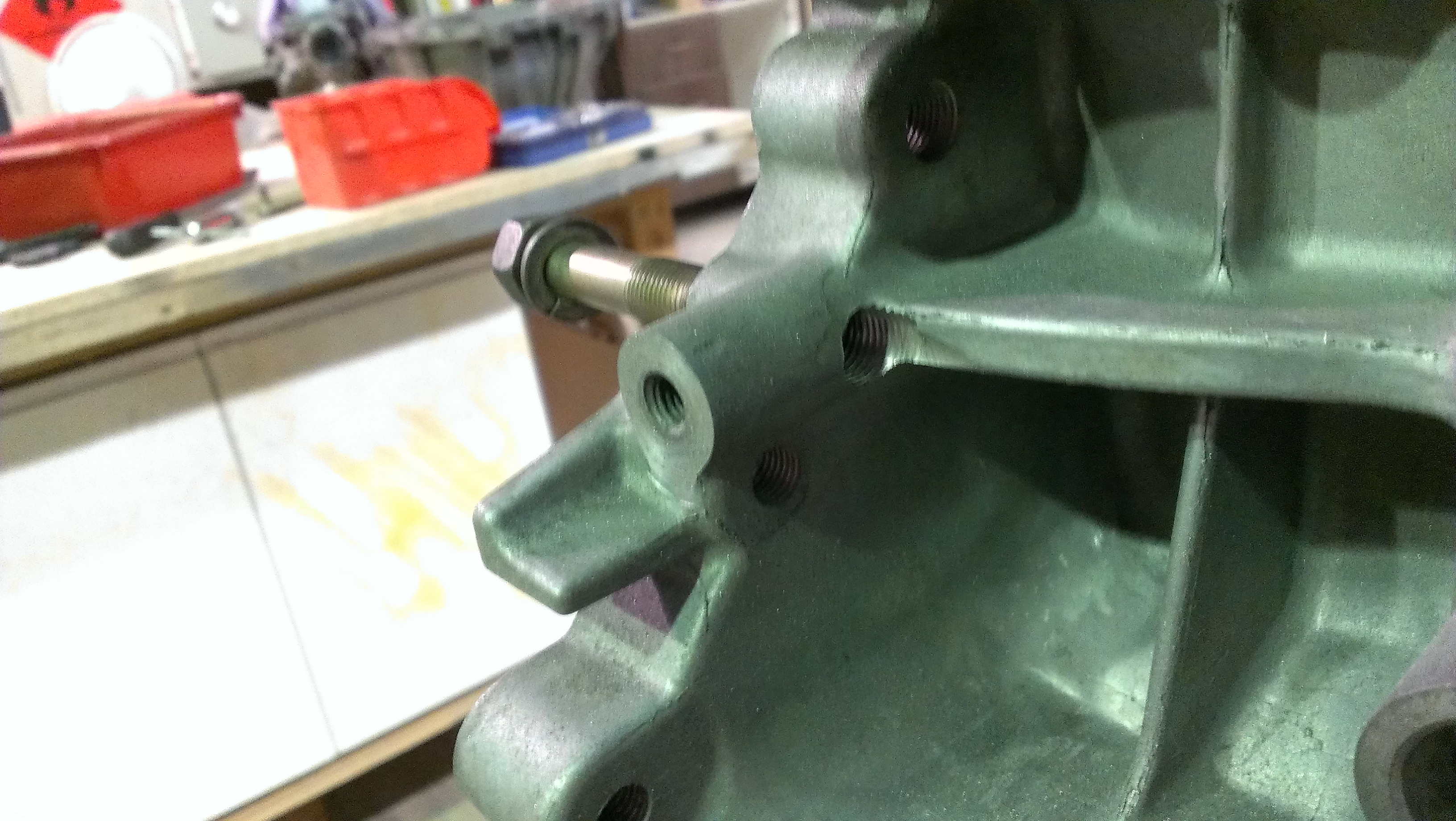

Yeah thanks Jake, Id appreciate it if you could ask, I can't see how it would cause a problem having now done it, the flange plate for the pipe that comes from higher up on the motor actually had a thread tapped into the hole aswell as the studs, so deleting it is even simpler than making a cover plate ala 20v rwd setup. Silly me went and made a plate from 1/4 inch aluminium plate then noticed that it wasnt required, haha.
So the other connection to the cooler warmer is just a threaded barb the next size up from the upper one. Luckily I had the right tapered brass barbs lying around in the shed so I fitted them up.
Next was removing the cooler warmer itself, which was as simple as one 10mm nut and stud, and the 30mm centre spigot that holds it in.
I guess its really the same as the 5s that went before it, and most people remove those cooler warmers on them without issue, so hopefully its all good.
