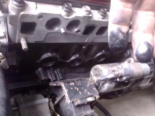

OK, I think what he is saying is re do the compression test in the fashion that he described earlier. He seems to think that one of the carbs is affecting the test, which in my experience is entirely plausible. If you're not sure, take it somewhere to get help.
You could dump a heap of cash to rebuild, but if you whack the same carbs on you could well have the exact same problem. It might take you a little while, but learn to trouble shoot this stuff now. Once learnt, it's never unlearnt :)

ahh one more thing um i don't know if it means anything but when i hold the choke the carb for 3 and 4 it starts reving up and running nicely
and on the carb for 1 and 2 if i open the choke well it chokes and wants to die
that means 3/4 carbs are running lean
swap 3/4 carby to 1/2?
righto i think that could work depending if i can change the throttle to either side of each carb ahhh man fff so anoyed
don't f@$k with the carbies until you get the compression problem sorted.
you will only need to rectify things again afterwards...
yeh I'm not doing that cbf remounting and shit
Mate, stop talking and hoping it will fix it's self.
Bite the bullet and take the head off, sounds like a burnt out valve!!!
i also notice on the carb for 3 and 4 on the chrome filter back plate there is brownish black schorch marks
I second that- burnt inlet valves.
Evan's right however, swapping carbs will take the whole 'carb' question out of it. You could do the same compression test with the carbs swapped & see. In theory they don't make any difference, but you might have loose venturis in the rear carb or the throttle might not be opening fully. If it makes no difference you've already started stripping the head....
Oh- Also, you should hear the valves leaking with the hose in your ear, the carbs will never sound the same. You could listen during the cranking compression test and hear it too.
