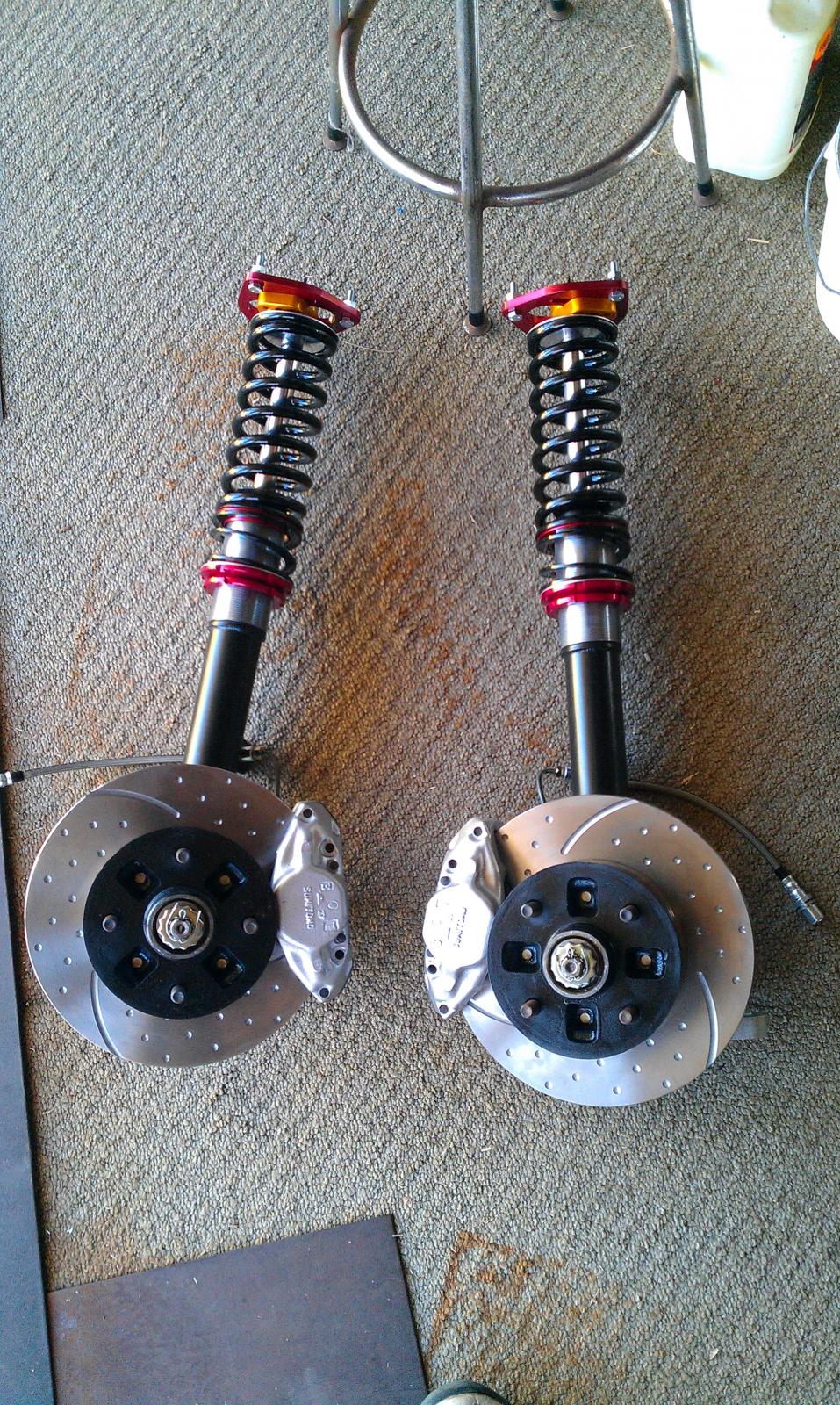

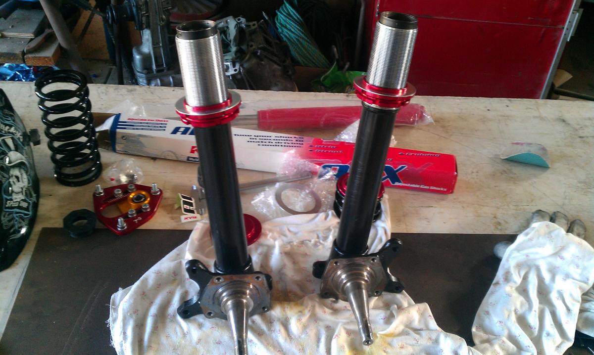

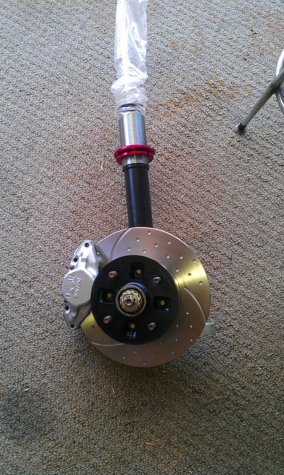

Evan, the gland nuts that came with my kyb sw20 shocks are correct for my struts, everyone told me that I needed r31's as well but these are correct, I don't know if the rt132 struts have a different thread to the xt130, but I doubt it, everything else is the same. All you need is a peice of round aluminum 45mm long and it should go together.
