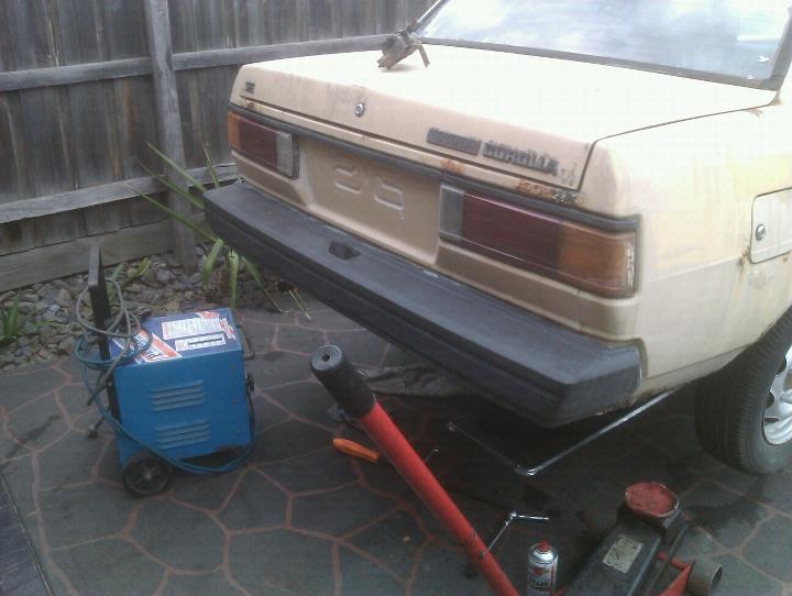

I bought a diff drum to drum for $140, put a TRD 1 and a 1/2 way LSD centre in it $500, $20 for new oil, a bit of welding to weld the diff to my car (from 4 link to the leaf suspension of the KE25) and hey presto!
Custom build an adjustable panhard rod (KE25's don't have one) for about $100 (including nylothane bushes).
So less than $800 for a conversion AND a very tight TRD centre.
