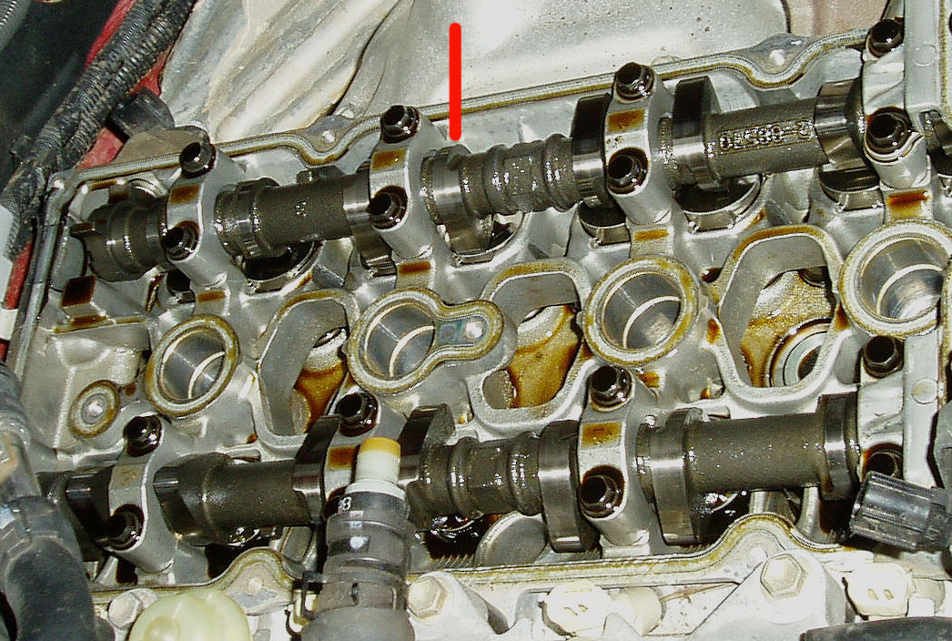

October 19, 201115 yr comment_561372 OK, I own a 1999 Toyota Altezza with a 3S-GE Beams motor, had it since 2001 its done 120,000km and I changed the cam belt/idlers/water pump a couple of years back. It has never given a moments trouble. <--- a nice red one! My wife took the daughter back to Uni a few months ago, some 500km each way, and when she came back she parked the car in the driveway. I got in later to put it in the garage and it didn't instantly start, so I just rolled it down the drive and shut the door. It has never started since. She said it was running fine all day and gave no indication of something different. It cranks fast, with a smell of unburnt fuel and occasionally fires a cylinder. So new plugs went in and I started looking for failed sensors etc. I checked all the common ones, injectors, cam & crank position sensors, TPS, APS, coils (coil over plugs), temp sensor, VVTi solenoids and a few others. All I could read were resistances, and in no case were there any zeros, all sensors have full circuits. OBD1 is fitted, the engine check light flashes at a constant rate with no codes. Other lights (traction control light) have codes, but in theory shouldn't. So the computer knows something is wrong, but it doesn't know what. That's why I spent a couple of weeks on the electrics. A mate had a set of coils spare so I ran those against mine, same result. I took the tappet cover off & checked tappet clearances, inlets around 9thou, exhaust 11-12thou. We put a compression gauge over it.... 100, 100 30, 30psi.... oil didn't make a difference. So- Its trying to run on two 100psi cylinders, which is why it cranks fast and fires occasionally. Before I pull the head off, what suggestions are there of what could be wrong? *head gasket- only if it is burnt between 3 & 4, pumps air from one to the other without a whistling noise and doesn't affect oil or water, or give a backfire when cranking. ...and it somehow leaks out of 1 and 2. *rings- only if they suddenly collapsed badly enough to give 30psi cranking without a rattle or a knock. *valves- only if they are running stock tappet gaps. I've thought long and hard about a VVTi fault bending valves but I can't see how it can. I expect a bent valve to alter the tappet gap, but maybe they are suddenly burned to nothing... *blocked inlet manifold- only if 'something' got in there and anyway it still sucks hard if you put your hand over it. I'm going to buy a fitting for a leakdown test tomorrow, but really, unless there is some stunning explanation that means I don't have to take the head off, the leakdown test is a waste of time. Any of those reasons for collapsed compression means 'take the head off'... Any bright ideas? I would really really hate to spend a bundle of money, lots of time and aggravation, and run the risk of screwing something up only to find it wasn't under the head!! Edited October 19, 201115 yr by altezzaclub Report
October 19, 201115 yr comment_561373 i would even back the valve adjustment right off and then check the compression. 30psi doesnt seam right at ALL! edit - if you look at 3 and 4 adjustment screws, are they further down than the adjusters? EDIT EDIT - give the valve a couple of taps with a hammer then check compression again. could be a peice of junk holding the valve open. don't do anything further untill you report back with your findings sell the beams to a ke70 owner and get a worked 4k in the altezza! :lol: Edited October 19, 201115 yr by Evan G Report

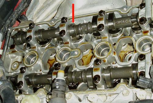

October 19, 201115 yr Author comment_561399 sell the beams to a ke70 owner and get a worked 4k in the altezza! haha! Swap the motors between the blue car and the red car you mean! Cams run straight on top of mirror-finish 'top-hat' followers, not even any shims. Setting tappets means reading them, removing cams, selecting the right thickness top hat and reassembling ti... I'd hate to have to pay a Toyota technician to do it! You can see reflection under the marked lobe, and the way they cut the heel of the cams to half the lobe width. Report
