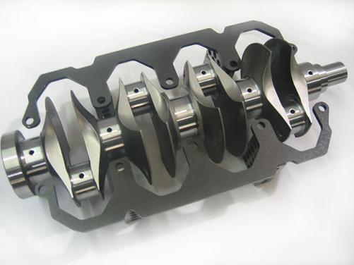

I'm interested why one would bother with this in a car though. Bikes are hard coupled (ignoring cush drives) from the gearbox to the single driving wheel, so they are susceptible to torque pulses breaking traction.
Bikes revving at 12000rpm will also get much higher pulse forces than a 7000rpm car, although this is offset by likely lighter pistons. (Incidentally, the link above has completely miscalculated crank torque due to piston speed)
A car with even traction to both driving wheels means that the force of each pulse is HALVED at each wheel. Plus friction is a function of mass, so your car being heavier will have a higher friction force to overcome anyway.
In other words, why put all the effort in using a cross plane crank to improve traction when you would be better off spending it on diff and suspension mods to acheive the same thing.
I think if it was gonna be beneficial someone in the car industry would be using it.
Except production costs are likely a lot higher than a flat plane crank, for minimal benefit to the general public. Sport bikes are quite a different market.
The cam isn't to hard find some one who grinds from blanks it's the same for anyone wanting a custom race cam no need for big budget stuff but the crank will need to be custom made there's no worry about the counter weights they just work the same the tricky parts the distributer when I was working out the points positions I found the only way is with a V8 electronic dizzy grinding off the lugs leaving 0 ,270,180,45 if there's real interest ill post the timing positions and cam degrees

The issue (and speaking just for myself) is not a case of a smoother torque curve or any of the gains that my bike attains from such a crank, but purely the sound and originality that would come from such a feat...
I dig this forum and power to KO 10 for an idea that's tickled my fancy since hearing a crossy for the first time, I see the reasoning behind the for and against opinions.
Perhaps a 4age would be the better option, It's just I have a few K's laying around, and money isn't a huge concern...
While this is all hypothetical at the moment, you all can't deny (as much as you all see the 'why would you bother factor') that this wouldn't be awesome, especially being that as far as I'm aware the first Crossy 4 banger car engine, in of all things, an early Rolla...?
Id still rather see you spend the money and put a thousand horsepower through it while retaining handling capabilities and track it. the cost would be similar me thinks...
If it was about costs and achieving ridiculous HP, a 2J or 1U would be the topic of discussion.
Or would you rather see someone have a go at something that hasn't been done yet...?
