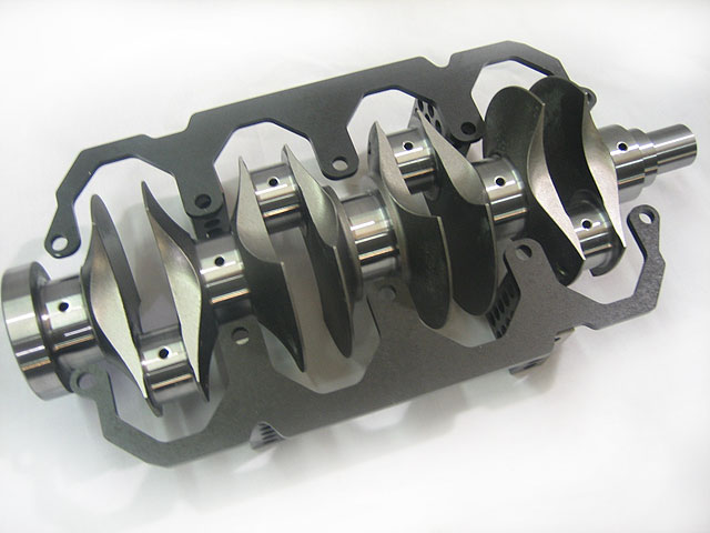

3K Cross Plane Crankshaft
I think, realistically, the only way you'll pull this off is with CAD and CNC. Its not as expensive as you might think, but still way too much money to spend on a K motor.
It would need at a minimum a 4 axis machine. Cut time would be around a day. We have a 4 axis lathe at work that would do it all. Boss said he COULD do it, but really wasn't interested in doing it. What you have to realize is these machines cost atleast 500k+ and they need to earn there money.
What about getting one cast up? A pattern and core box would be around the $600-1000 mark too. That's before casting, heat treating and final journal finishing.
It's by no means new tech. F5000 cars had them in the 70's.
Stu.

Nah- such pessimists!
I mean, how reliable is a 4K crank? How often do they break? Almost never! They are over-engineered and bulletproof, so there is a lot of redundancy built in there. Even if it ran for a year maxed at 6,000rpm its a great proof of concept.
Cost might be something else, there are engineers in Orange that do those sorts of jobs on mining machinery, but I imagine they aren't cheap.
Spool do custom cranks, BAZDA was looking at having custom cranks made to stroke 4As.
At one stage there was talk of all alloy holden 6 blocks for around 5-7k a piece.
The expense is generally in the cad work and the amount of hours it takes to measure and design each individual aspect of the finished product. Actually cutting it is the easy part.
As for welding cranks,
Ford 221 cranks have the snout cut off and replaced (welded on) with a 186 version (holden) to build a 234ci stroked Holden 6...
And they last :)
That said the snout position sees little un suported load, I'm not overly familiar with what you are proposing, but if the area was heated and welded appropriately, and wouldnt see any excessive loading (like the crank snout example) there is no reason it couldnt work
How many of them are cut through the main journals and welded back together though?
Well, funny you should mention that Boss.... I think its the best place to weld them, you would machine both sides to a cone and build them up again to be ground off. That would at least have the bearing spread the load across the join. I'm no welder, so it really depends on what they're made of and what a welding shop reckons.

Getting one cast sounds like the go but i am going to cut and weld one from two using an old block butchered into a jigg and the process i said earlier this might only achive something for the caster to work off in building one properly
Ah- Which block do you reckon?? Are you going to aim for an 80mm bore and 5K pistons on the shortest stroke you can find?
When you start to look around there have been some strange pistons in 4K blocks- a guy used 80mm VW Golf pistons in one.

That is one sexxy crank yes,yes and ah good point,glad you asked about what block bore stroke plus pistons cause i wanted to know what the strongest block is and the shortest stroke of all I'm asuming the 1k would be the shortest stroke so i'll do some serching and get all the specs i can put them on paper gather collect scrounge and borrow as many parts as possible then source the pistons rods so if the crank part wont work at least i can put them to good use and still hava kick arse k motor
The firing order is UNeven so there is a greater breake in power, dirt track use this to there advantage
when the wheel starts spinning they loose speed and no body wants that. The breake gives the rider or driver greater control over when he wants it to let go there is a fine line and you may not be able to notice but the clock dos'nt lie only time and experimentation will tell and high reving race spec 1300+cc is exactly
what i want who would'nt ,I'm thinking late motor X pistons, short light rods, high lift cam, twin 38 makunies, ported,extractors,valve stems ground,bigger valves (if needed they might do fine),bigger v-springs (also only if they need to be) lihtened fly,balanced lightened cross plane crank,shaved head,block machined,elec dizzy,every thing that goes near or through oil rounded what do ya think ??? now can i try to build it
