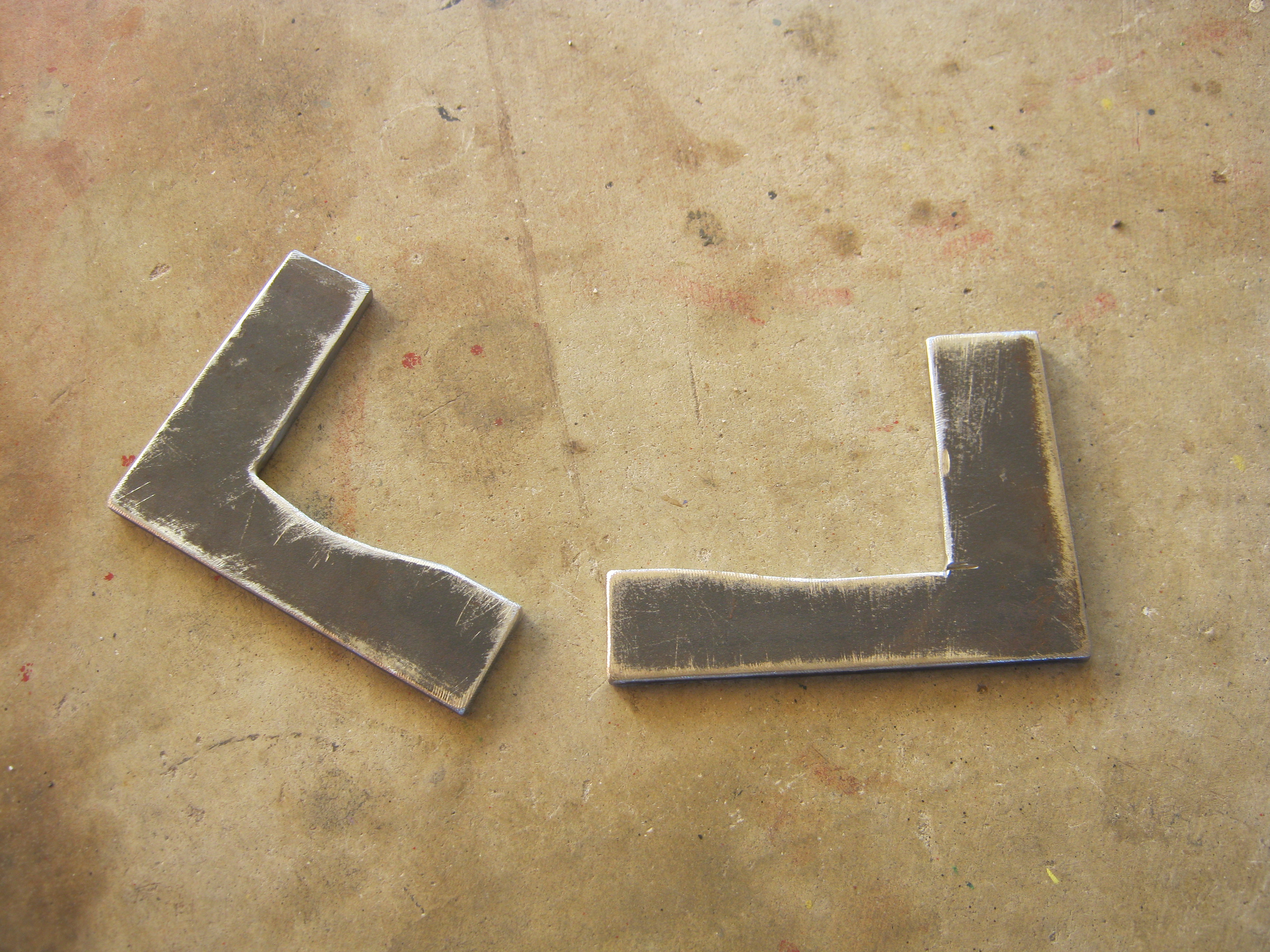

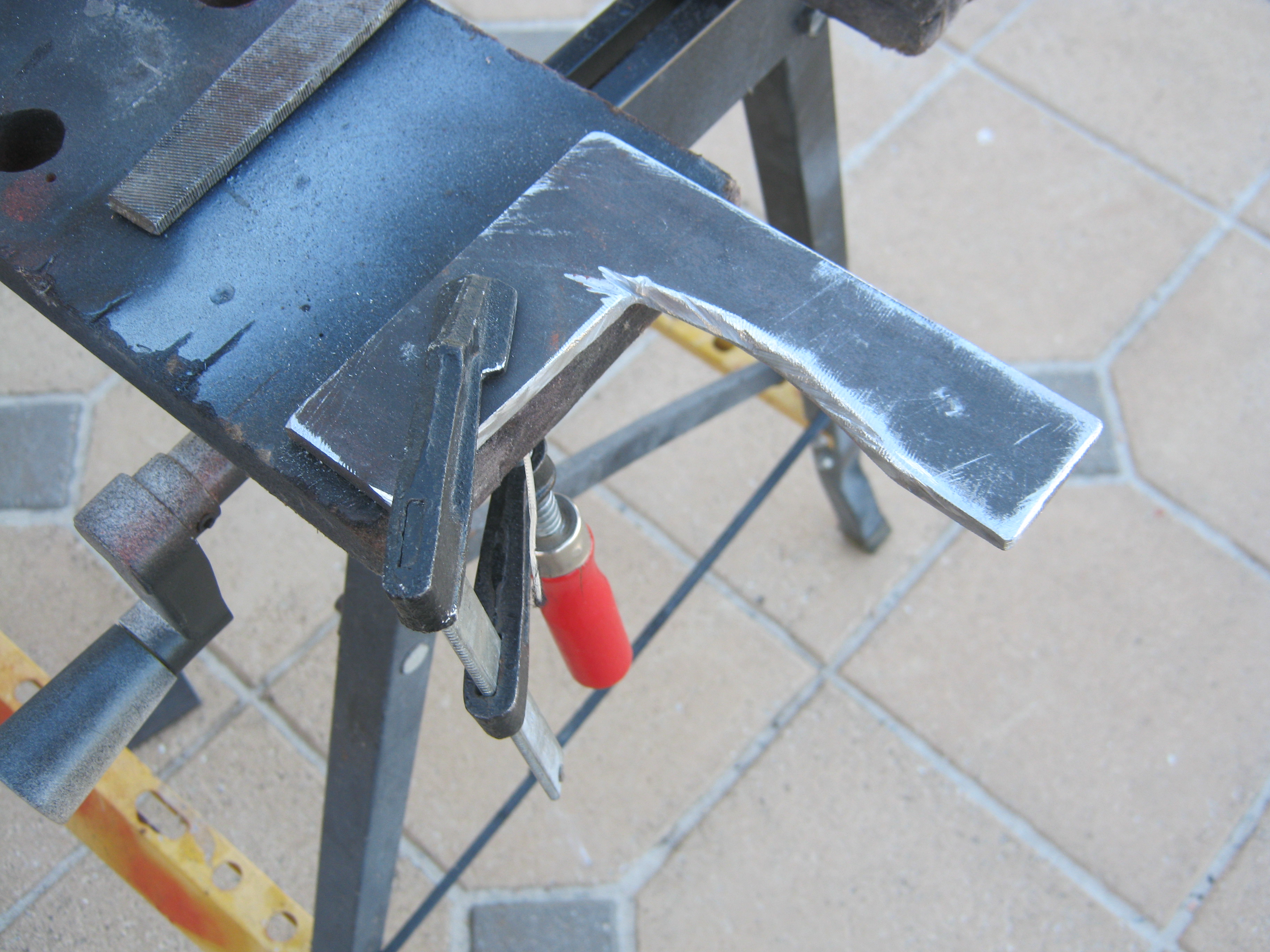

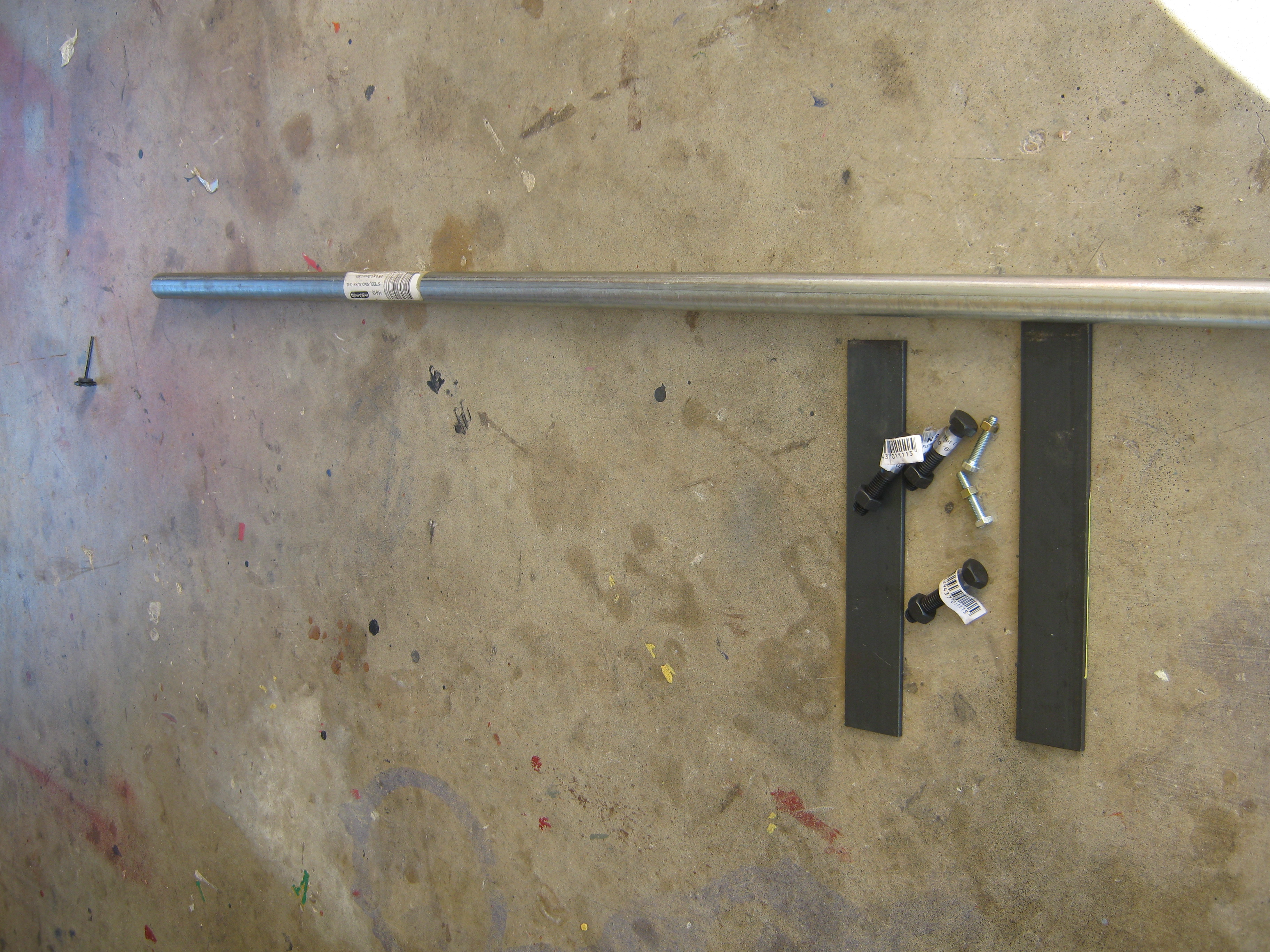

For the past 2 days, me and dad have been making the brackets for our strut brace, its taken ages, but we have to get it perfect. Ofcourse its not done yet, this is just what we've done so far.
It fits! Now just to carve a bit more metal out, so the bolts have more thread and don't get loose.

Are you going to have an adjustable or a preloaded strut brace?
We ran an adjustable on the rally car, the pipe across the car was cut in half & had a left-hand & a right hand thread cut in the ends. We turned a nut on a shaft in the middle and it tried to push the struts apart & then we clamped it up. We could've threaded pipes on the towers and cut threads on the ends of the bar and turned the whole bar, same principle.
A nice one for the Altezza has a slightly flexible square bar across the endgine that attaches to the towers with Allen screws. When you do the screws up they flex the bar and pre-load the towers outwards.
