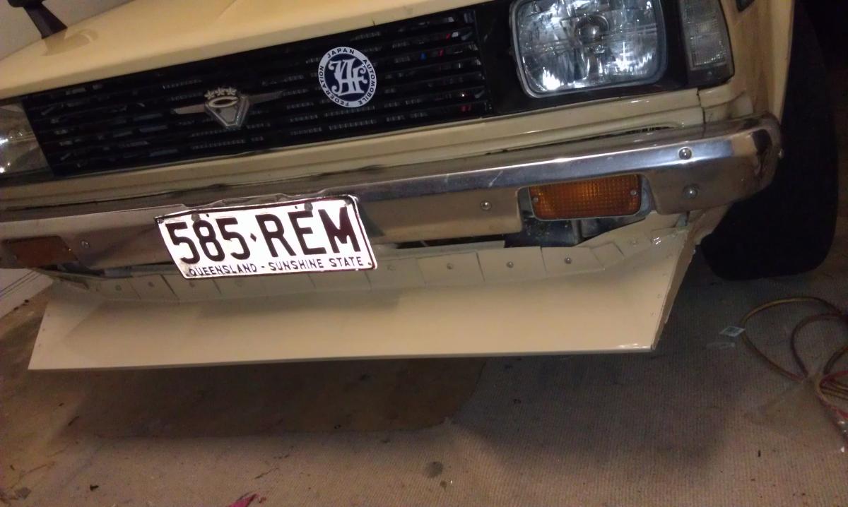

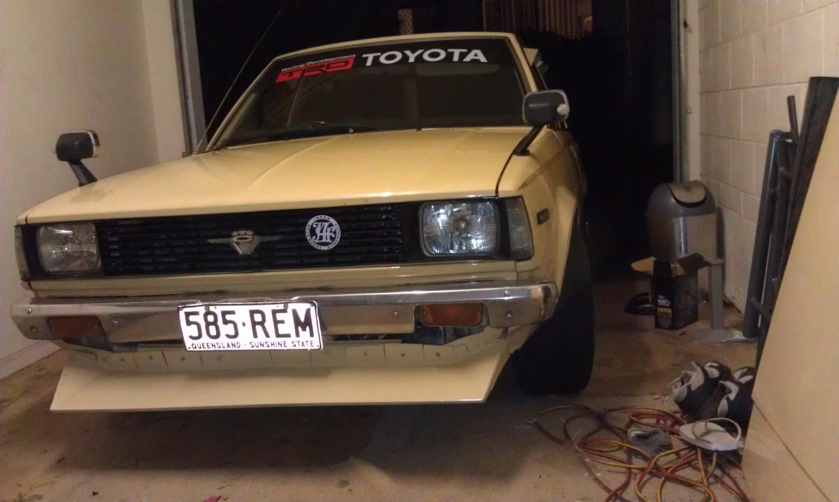

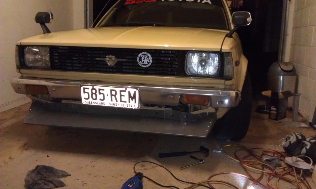

Its a bit shit but fun.

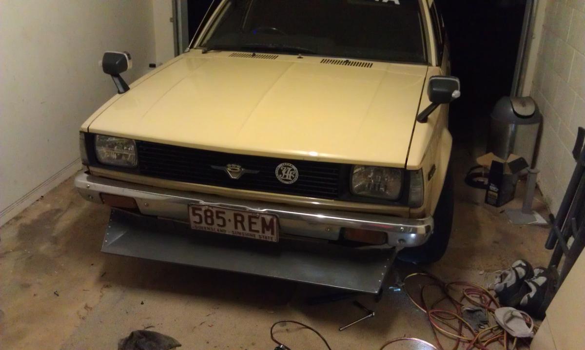

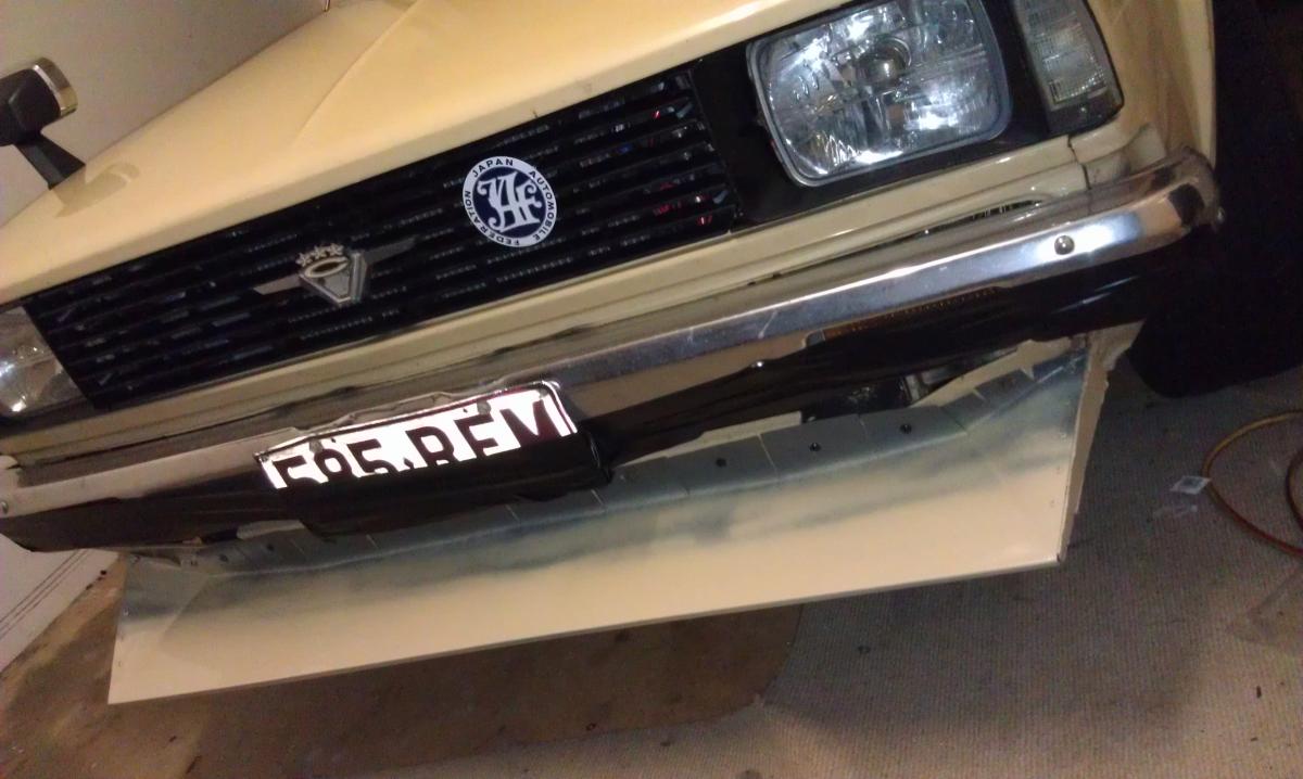

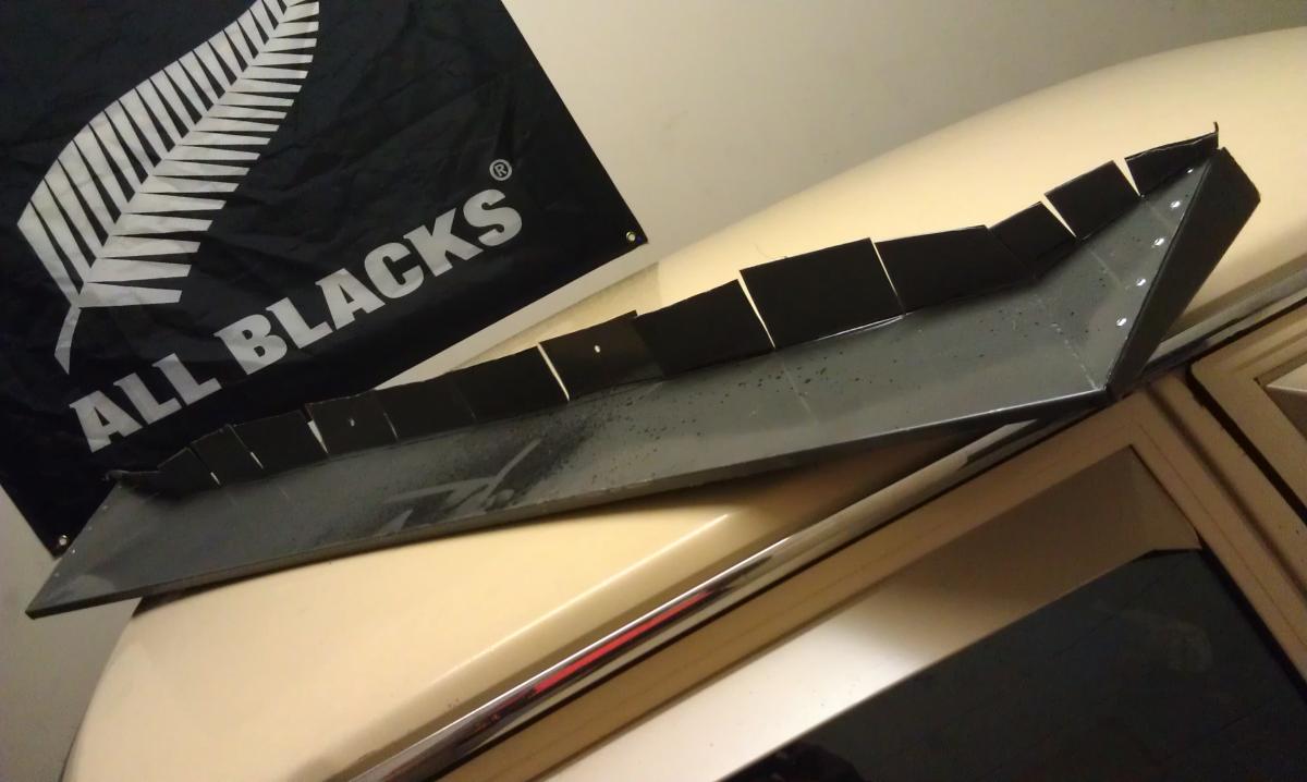

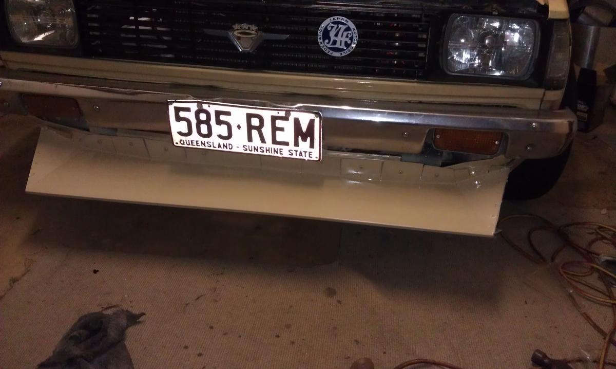

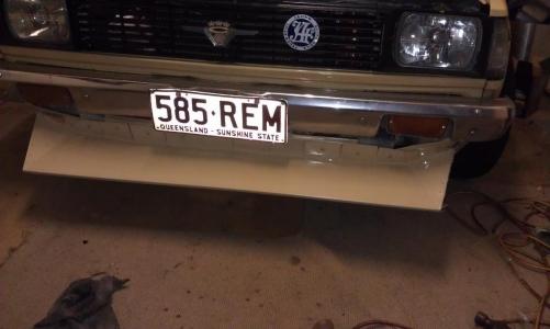

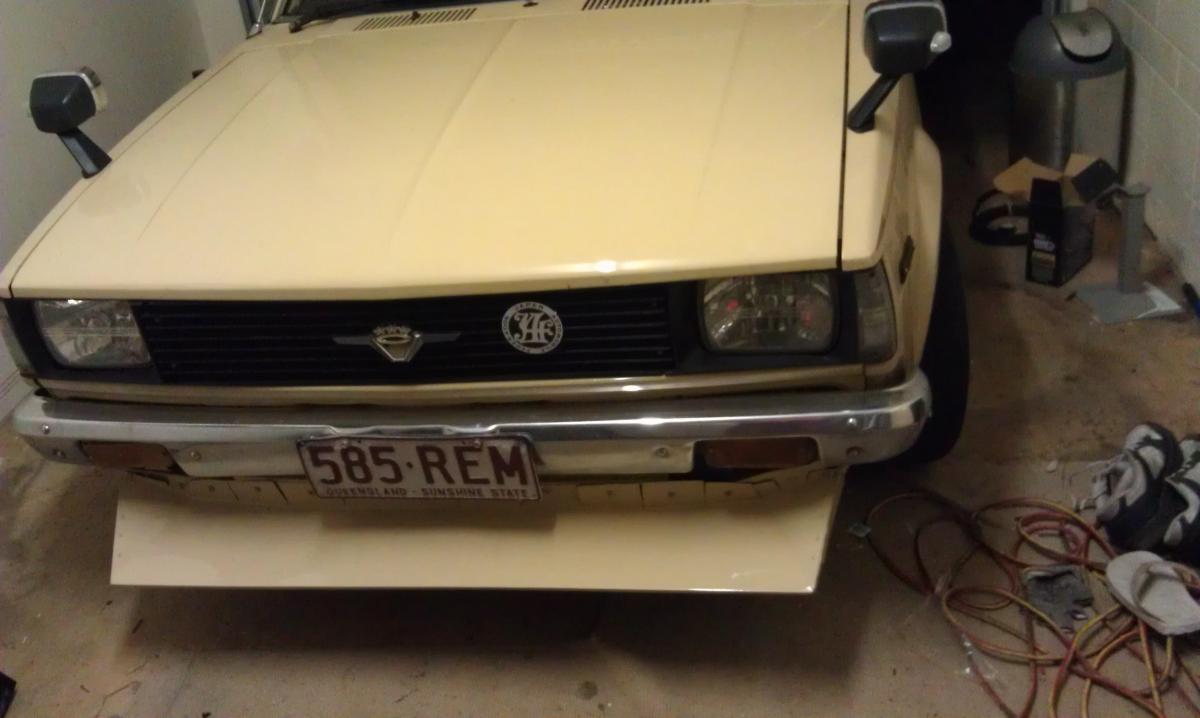

I did this, don't judge it was an idea i did at work
IMAG0541.jpgIMAG0542.jpgIMAG0543.jpgIMAG0547.jpgIMAG0548.jpgIMAG0549.jpgIMAG0550.jpgIMAG0552.jpg
Plus Carbonboy (Luke) gets kudos from nam for the plug cover!
Edited by B.L.Z.BUB
Lol nahhh, it's kind of bozo? I can dig it.
