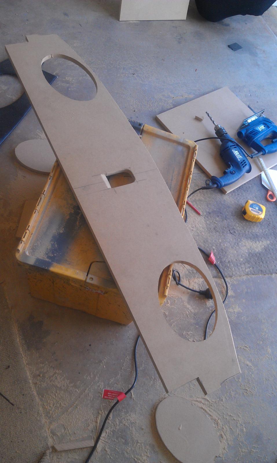

Seeing as I am going to the drive in tomorrow and last time I had some serious rattles from my shitty speaker tray I decided to rectify the problem.
Out came the shitty 5mm plywood temp one I made for Cop Bait, the speakers just sat in there and rattled. Used it as a template. Re-positioned the speaker holes as these holes were out by miles, Cop Bait had the rear tray hacked up so they could fit in the old holes.
Had to cut out a hole for the car seat mount, rounded the front edge so no sharp edges for the belt to rub on.
Ran some industrial sticky foam along the window edge to make a tight fit.
Wrapped and jammed in. Solid 16mm MDF this time.
Made a plug for when there is no car seat.

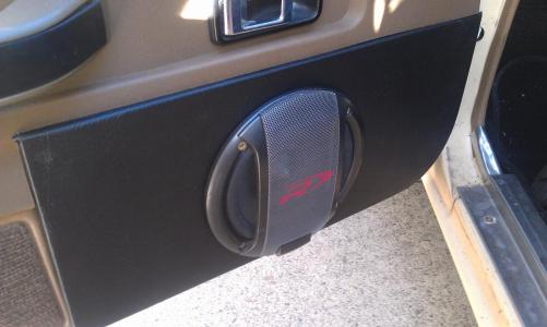

Recovered front speaker mounts too, they were just painted before.
Finished bit hard to see but sounds 100% better
Cleaned up my AMP grounds to try and eliminate the speaker whine but it must be the HU ground. CBF thats enough for today.
Cheers Dave, the front door cards are quite a mess so had to make them like that to cover the hack job by the last owner.
But they kinda worked out well anyway. And mounting the speakers to a solid bit of MDF definitely improves the sound quality.
