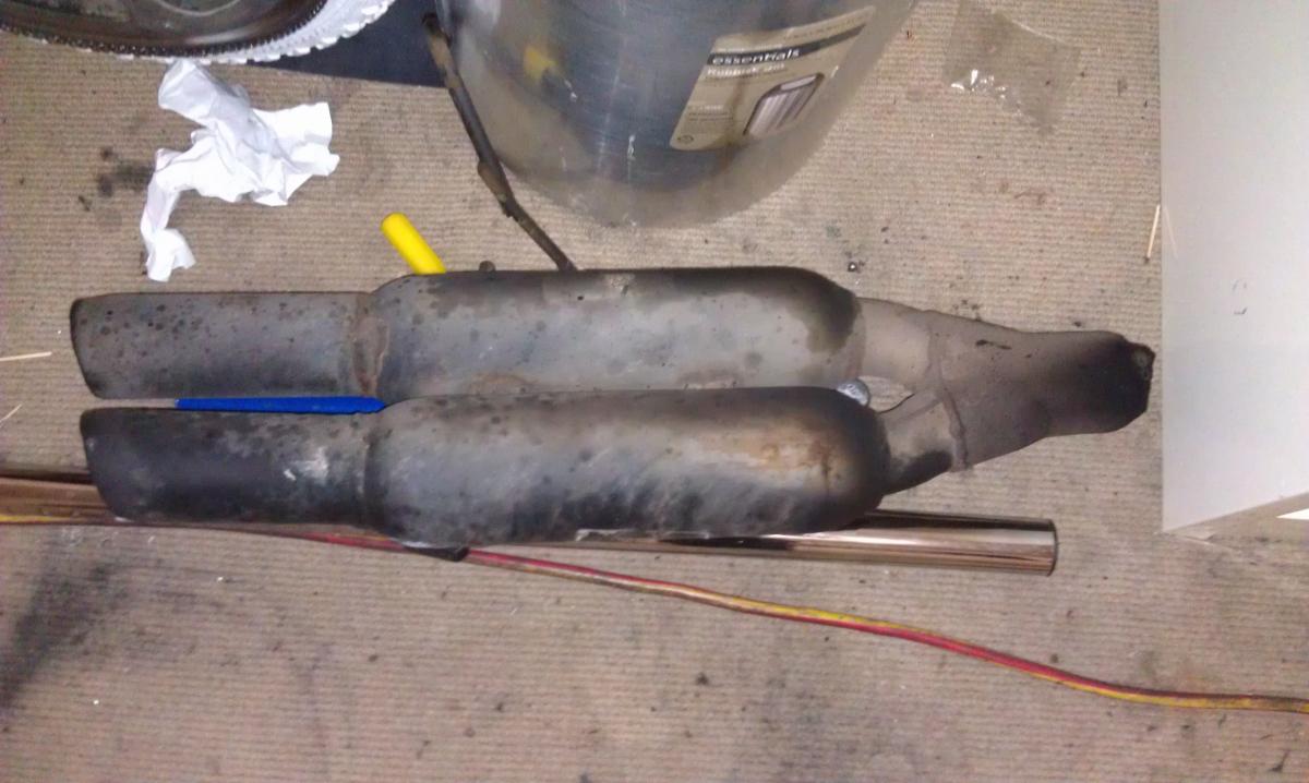

B.L.Z.BUB Posted August 15, 2012 Author Report Posted August 15, 2012 (edited) Ok so this just isnt even funny. I got my center muffler fixed yesterday and was backing in to the garage tonight and heard a loud scrape noise. ALL CAPS RAGE! Me and the muffler guy were even discussing that the weld was a bit ugly. On the plus side, nom nom nom, stainless weather shields. Edited August 15, 2012 by B.L.Z.BUB Quote

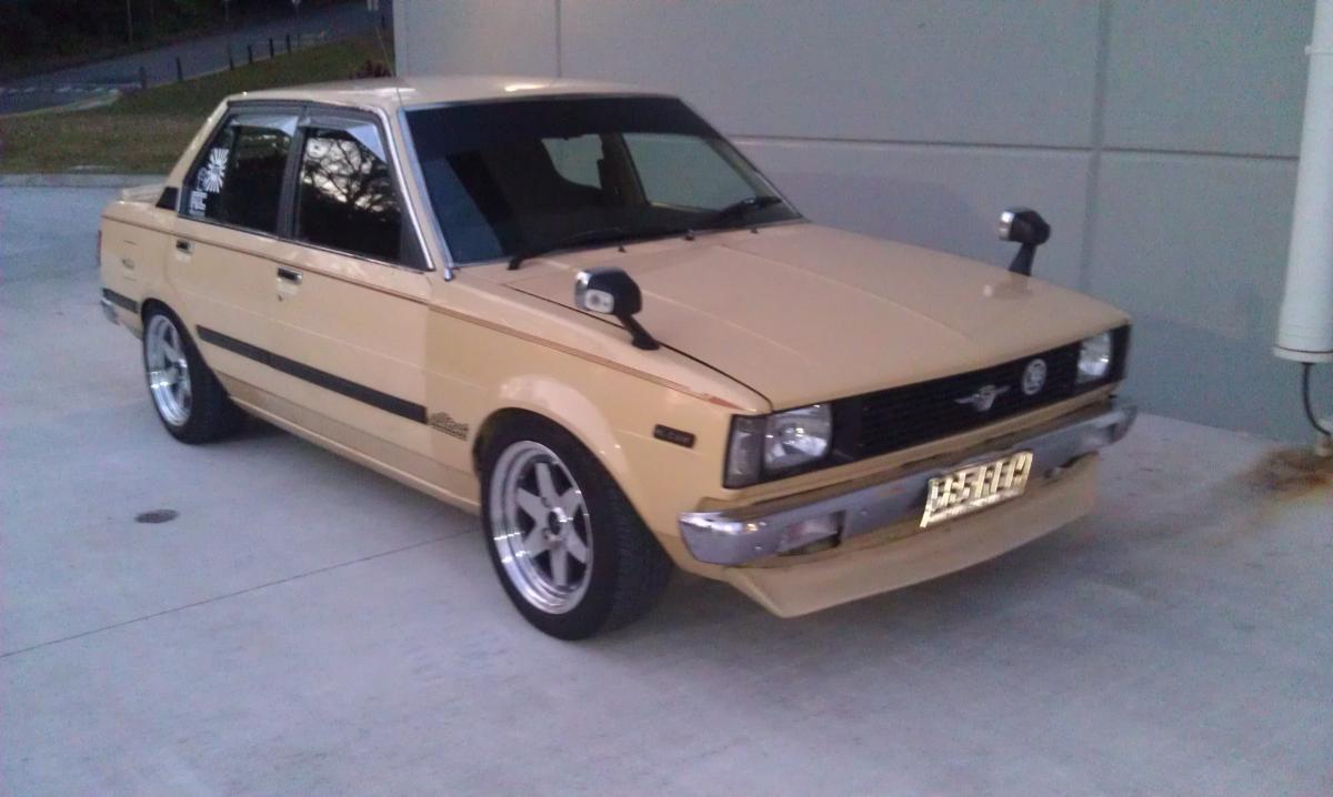

B.L.Z.BUB Posted August 15, 2012 Author Report Posted August 15, 2012 (edited) Need new wheels I think. Edited August 15, 2012 by B.L.Z.BUB Quote
B.L.Z.BUB Posted August 15, 2012 Author Report Posted August 15, 2012 Not a fan of dragway style wheels, or any 4 spokers in general. I want a set of Diamond Racing Steelies. Quote
