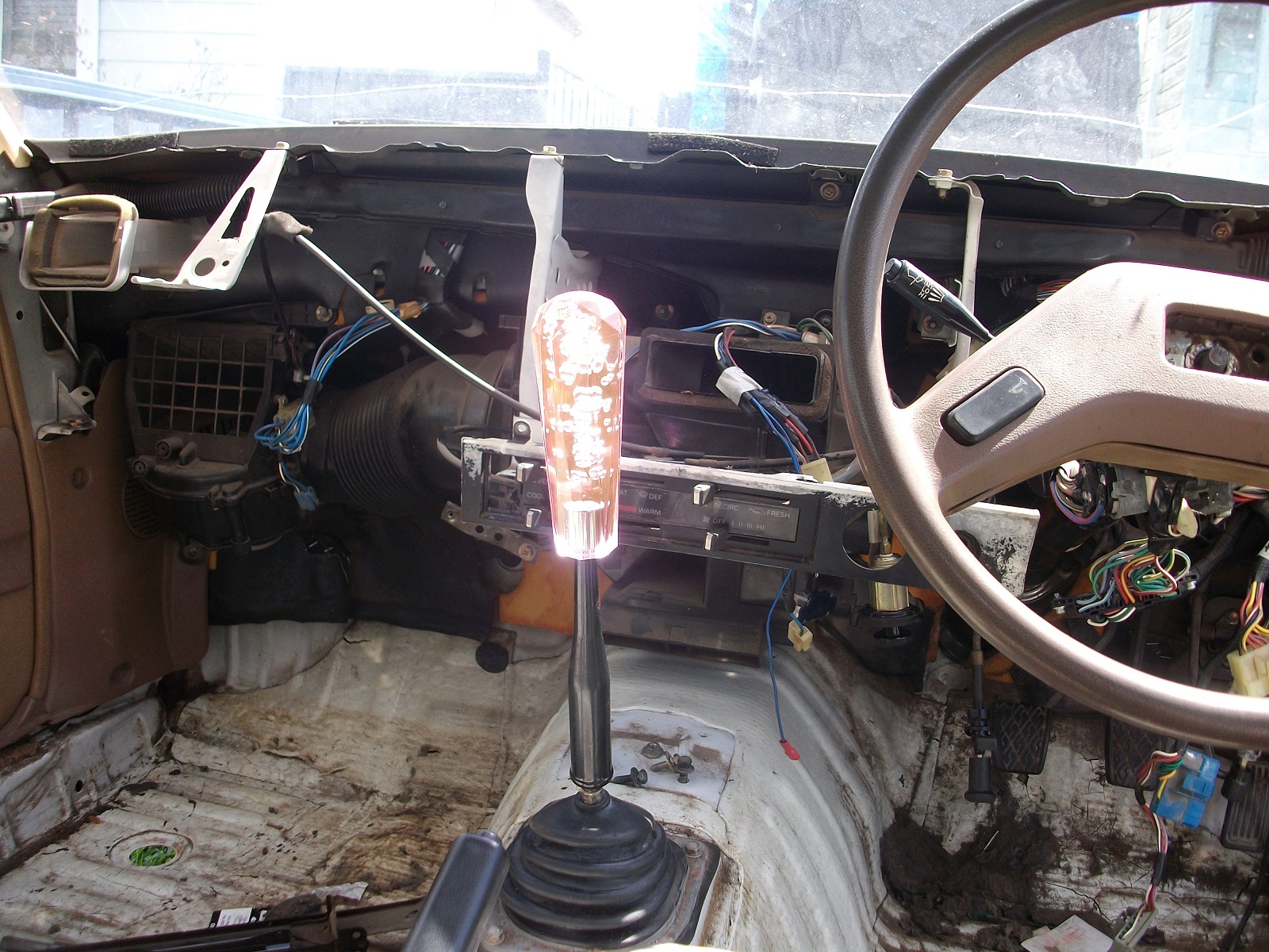

i got a new shifter today

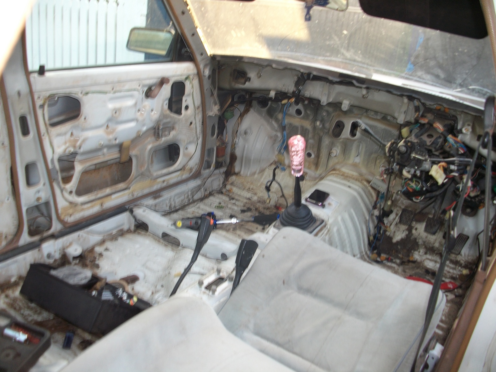

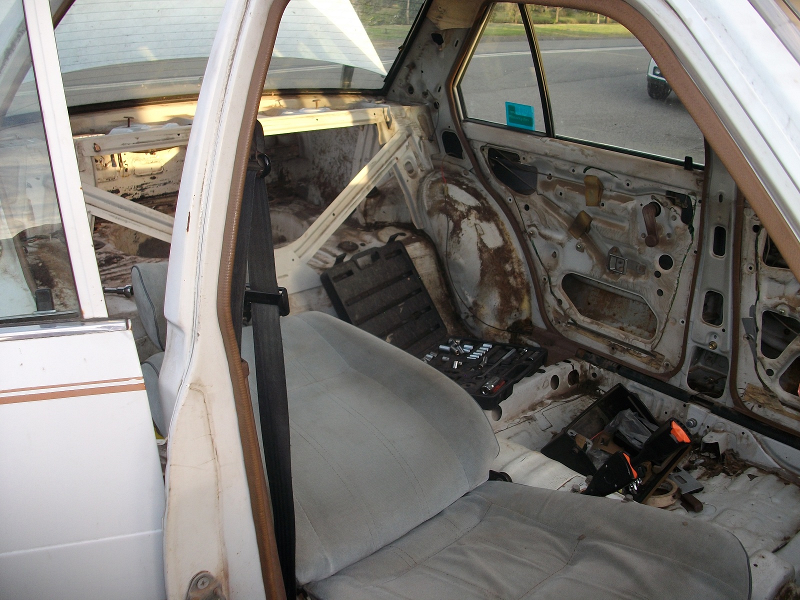

besides i just finished putting it on a diet

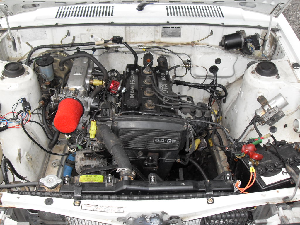

4age conversion is very easy,i did mine over easter last year. first motor wasn't so good but got another front cut for $400. i think japparts in lambton had a couple of fwd 4age corollas there. mine ended up costing me about $3000-4000 to convert. would love to turbo mine but funds aren't there at the moment. if ya need any help just send send me a message,am in newy too.
this is my engine.
this is my engine.
thanks will check out japparts lambton will most deff need help with the conversion
