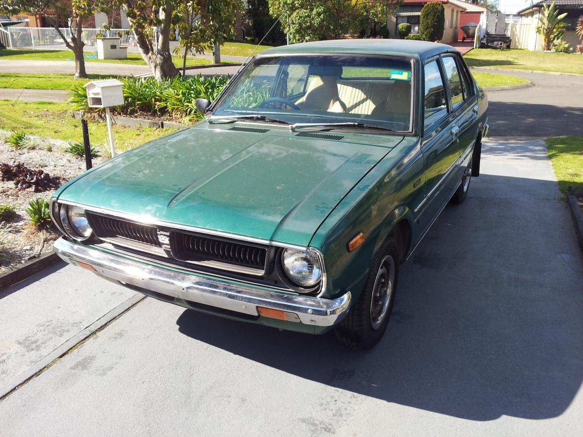

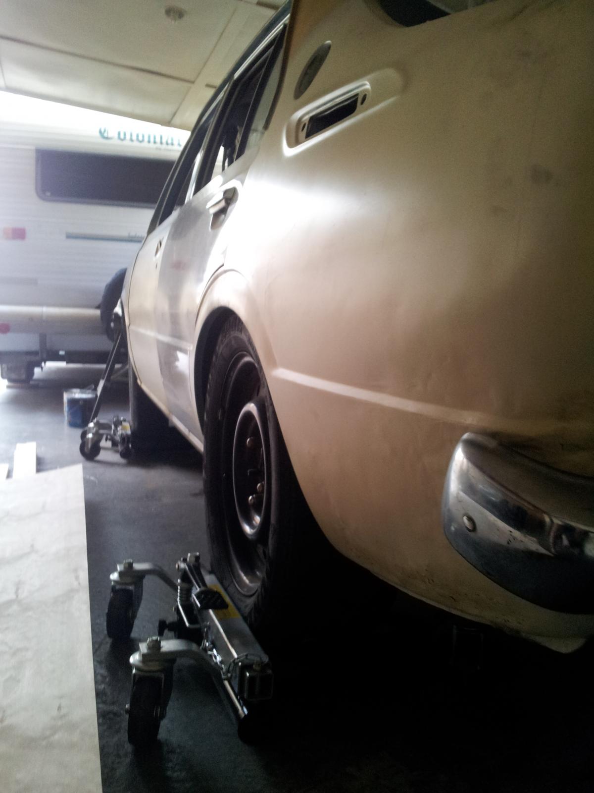

Hello all. Just new here but this forum has helped me plenty over last few months in sourcing parts.
Car is still rough but is getting there.

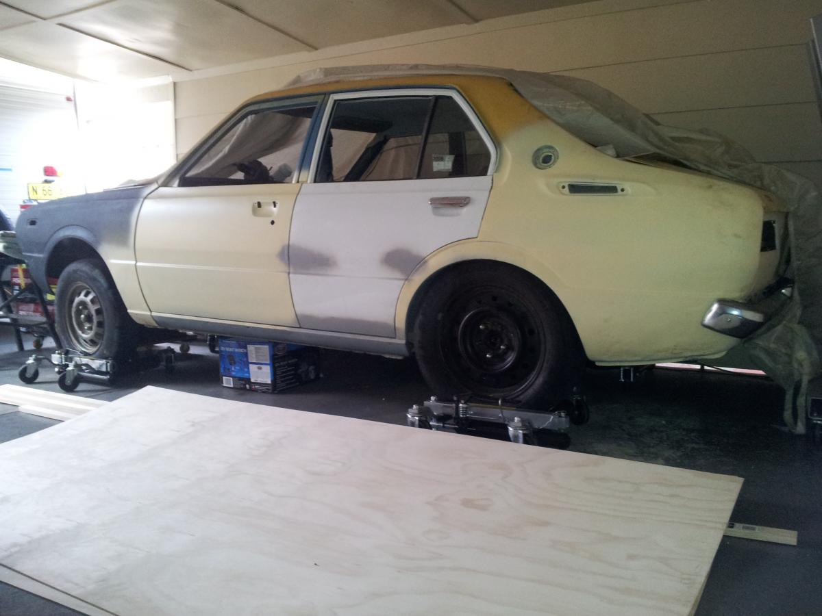

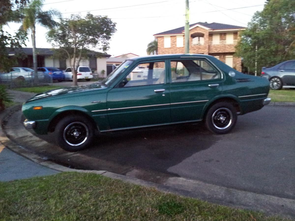

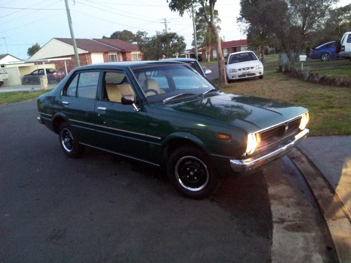

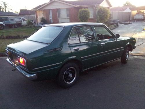

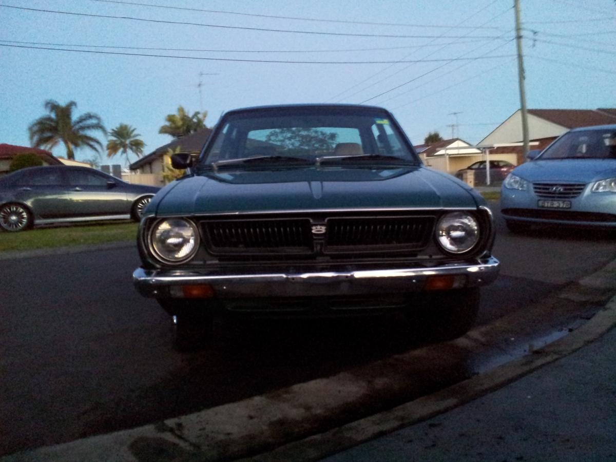

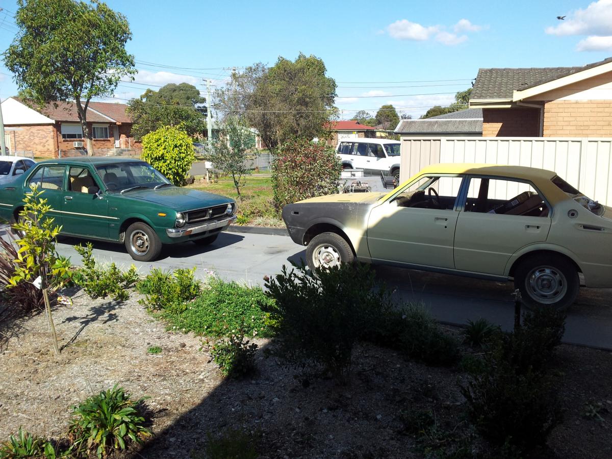

The green car ended up turning out better then i though with a quick clean, some paint and a service...... So now I think ill have to keep them both going ;-p

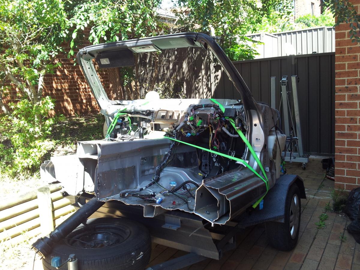

Sorry I haven't been on for soooooo long. Havent been able to get on here lately. But I have made some decent progress.

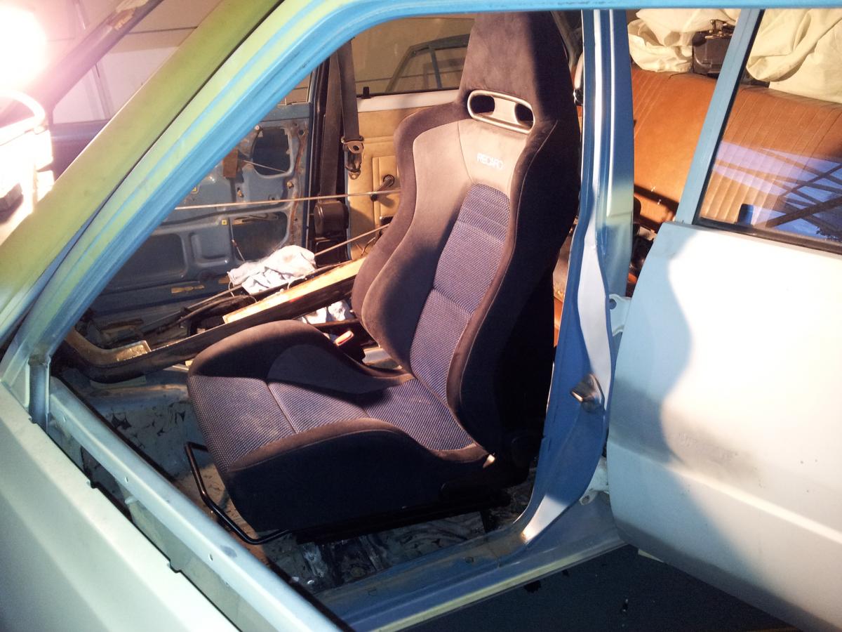

First up are my evo 7 Recaros

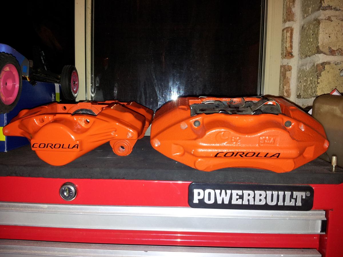

Next are the brakes. Fronts are 2005 Hilux and rears R32 GTR. Front very heavy and massive.

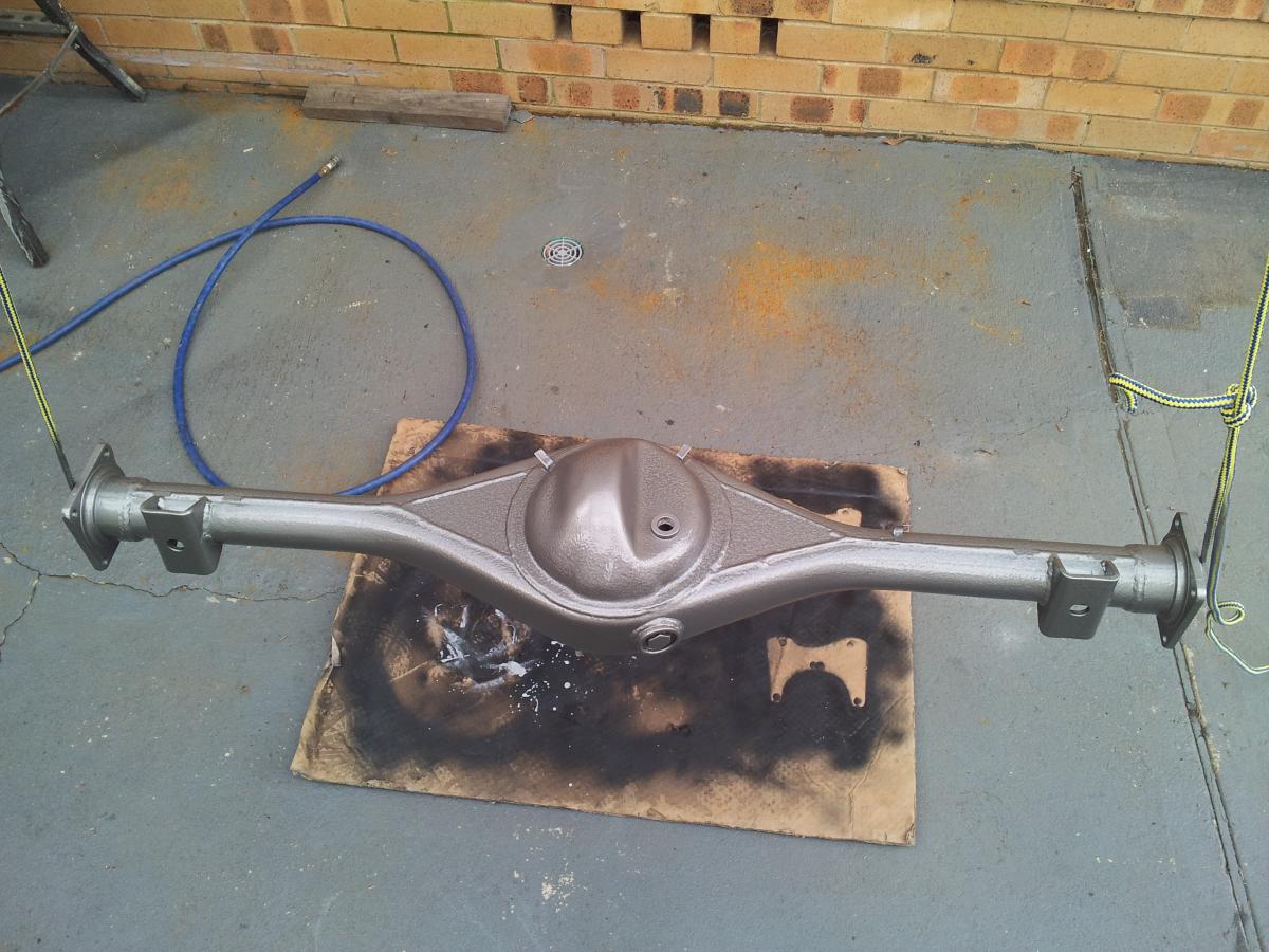

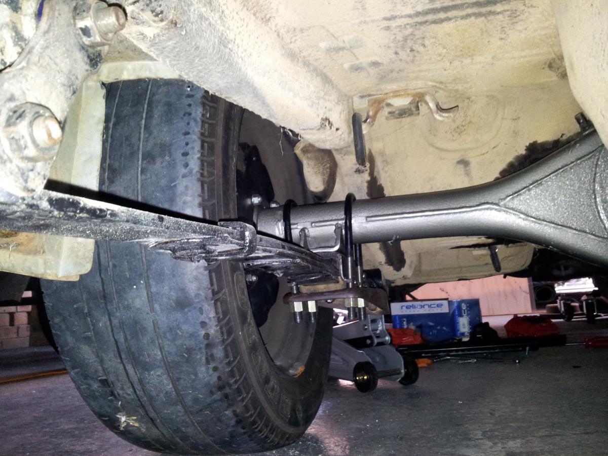

Rear diff completed and in car. Has supra disc and handbrake systems mounted and mounted to reset 2.5 inch lower springs with extra leaf for extra stiffness. Car still dirty underneath but will be painted soon.
Now falcon 16 inch wheels. Offset looks ok.
And the S2000 half cut. Running but I'm lazy so still in half cut.
Will post more as I complete more.
And hopefully will get done quicker now I have all the parts I have been searching for :-)

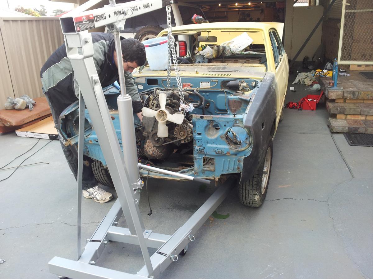

All good mate, will be good to see another rolla running the f20c motor. If you have any questions I'm happy to help i took heaps of pics of my conversion along the way. Also good to see you bought a front cut as i used heaps of the honda bits. Standard s2k booster and master cylinder bolt in with a little help from a hammer. Thats 1inch bore to suit your brakes better and i also used s2k accelerator pedal assebley and cable.
thanks. Your pics have been plenty of help working out engine placement.
Ill be using the booster but have a pajero master cylinder.
Who built your manifold? That is a trick bit of gear :-)
I'm also running standard ecu and wiring loom, but from your pics I assume you are running a motec or similar. Your harness looks much neater and better planned out then what I have.
The extractors are made from the original but heavily modifird to fit around the steering box and clear eveything else. They are now 4 into 1 instead of original 4:2:1 and from there its 2 1/2 inch system. One of the guys in my club made them and the whole exhust system including a few other bits also. I'm running standard computer with standatd engine harness just lenghtend in a few areas so i could route it a different way and neaten it up, I'm even using the s2k harness rubber gromet that sits in the firewall
