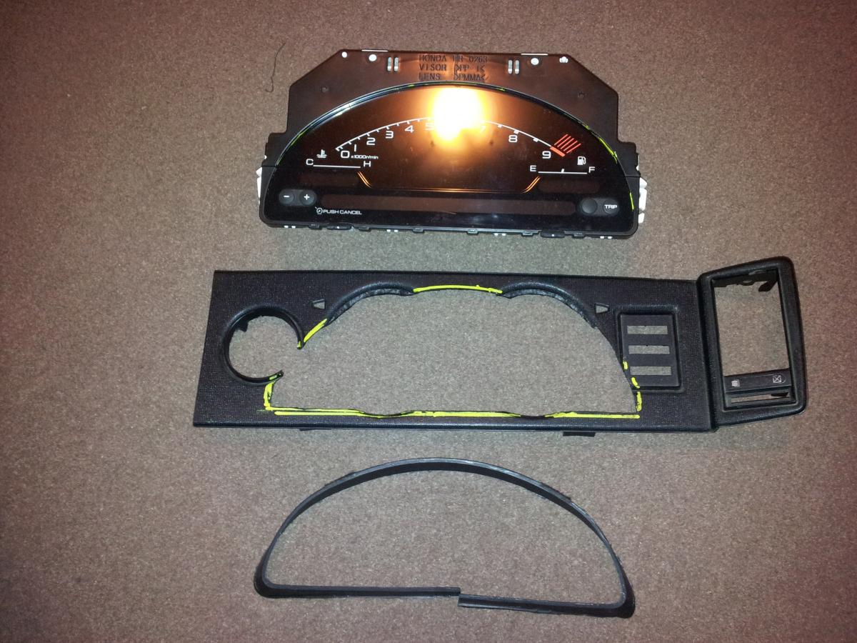

Have now finished cutting out dash to fit the s2000 cluster. I cut a piece of the Honda cluster surround out to use so I can neatly recess the cluster and so it have a bit of shade from the sun. These dashes are a nightmare to see in sun light. The f20c will not start without a standard s2000 cluster...

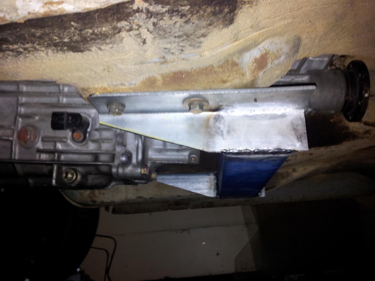

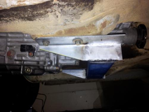

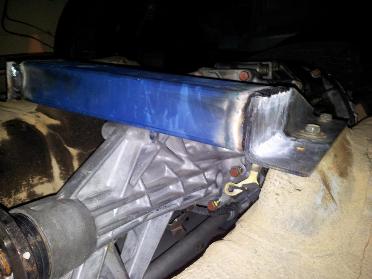

Have also purchased some steel to fabricate my transmission and engine mounts.
I will be using 26mm suspension bushes in my trans mounts and 45mm suspension bushes in my engine mounts.

Gearbox mount half done. Hopefully finish next weekend along with engine mounts.

Hey mate. Just so u know. F20c will run without the cluster. Just might need to wire a couple of the power wires up. I've used the cluster in my f20 swap but a mate hasn't in his f20 datto and runs sweet.
Just easier to use the cluster :-). I'm running the whole s2000 wiring harness, all the air conditioning gear and all its controls.

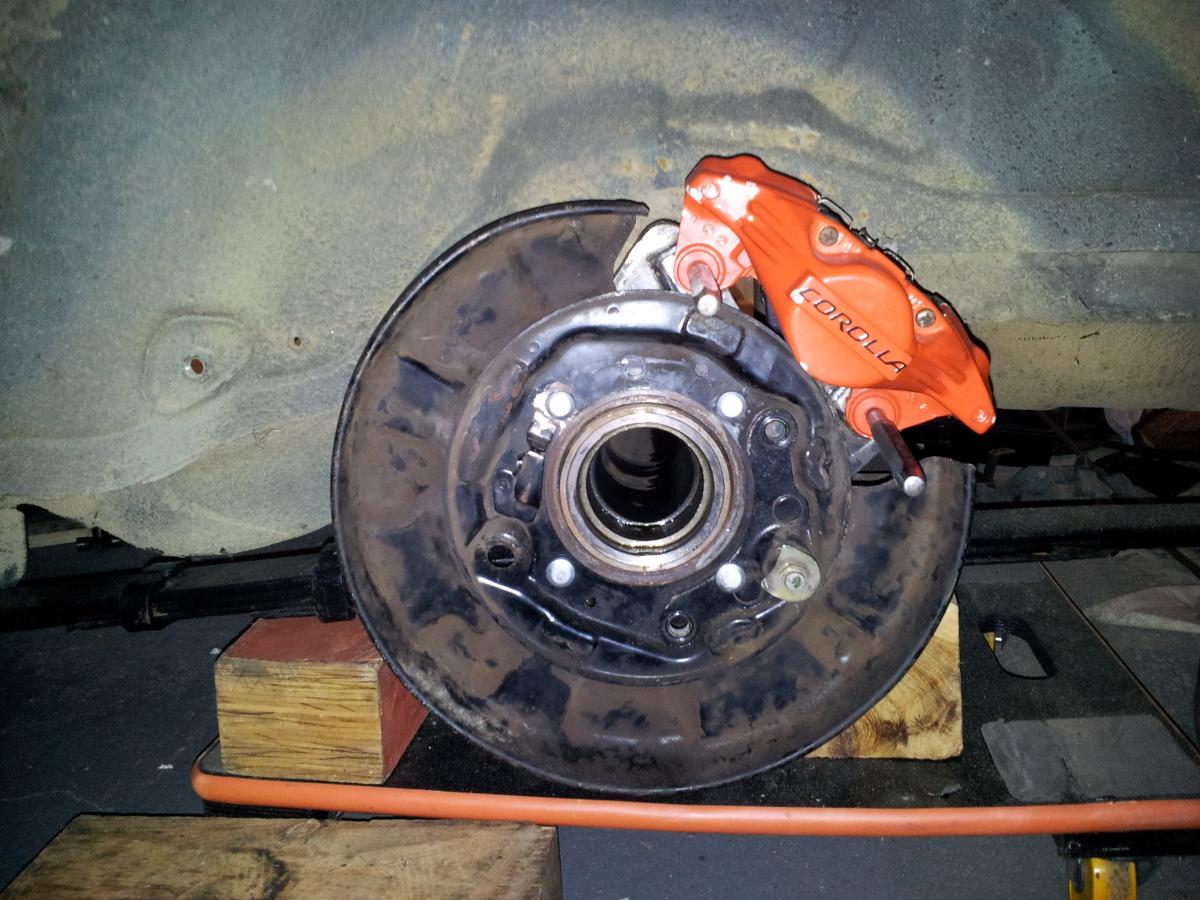

I have sourced some S13WB hilux calipers and they are being refurbished and they will be mated to the xt130 coilvers with a ford transit front brake rotor.

I think the clusters look awesome too. I didn't bother with the ac or anything tho. I was going to then decided against it, mainly because I couldn't be bothered making it all fit lol
Yeah mate. Its a pain in the arse to fit. But as I have welded the s2000 trans tunnel into the corolla i thought id use as much honda as possible.
I have the full wiring harness going in, lengthened and shortened in different places to fit the four door body. I'm installing the s2000 dash controls and the indicator and washer stalks. All the door locks are honda as is the fuel pump. The s2k pedals, booster and master cylinder are also in there.

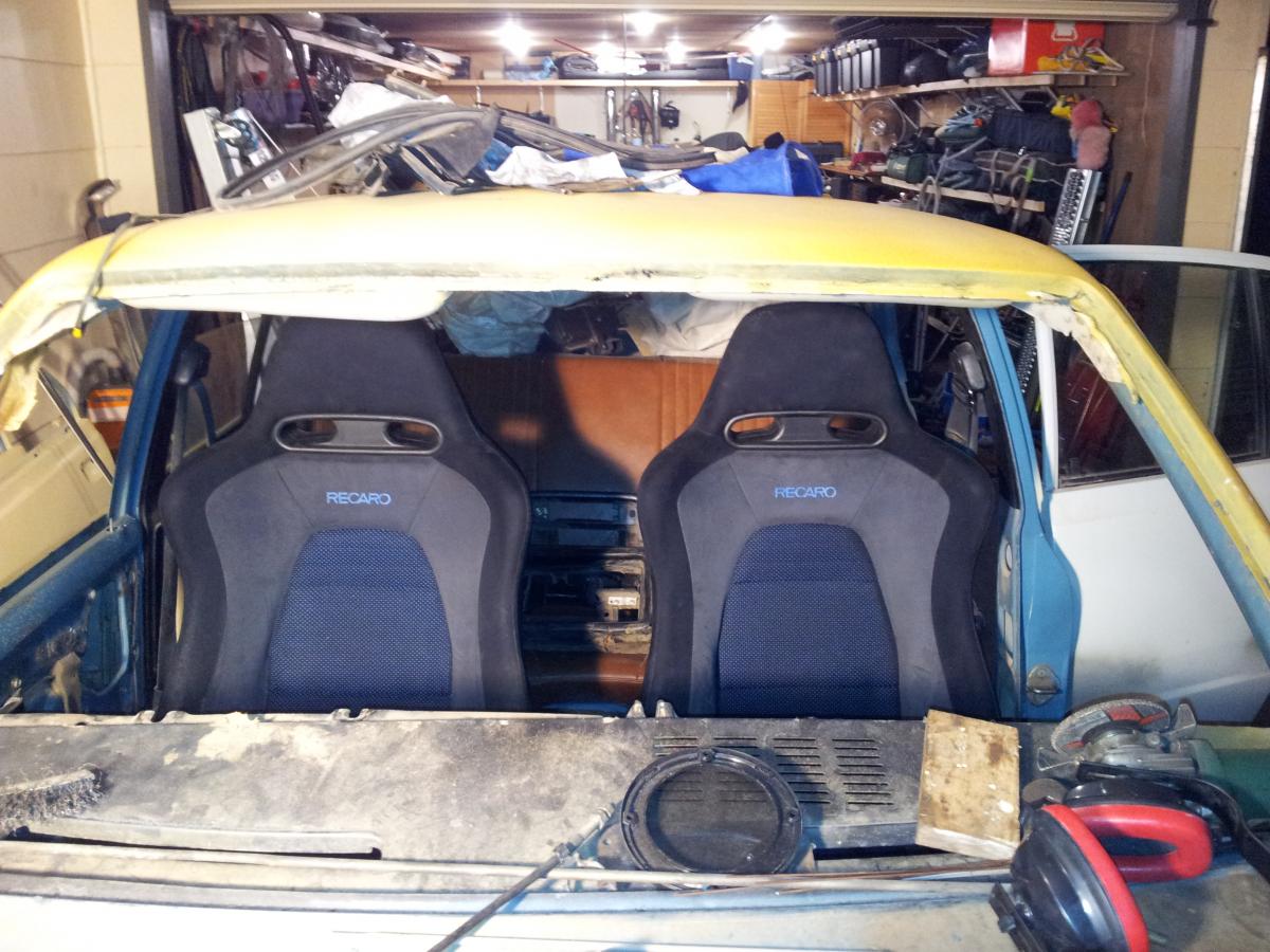

Ive gone down the path of putting the S2k transmission tunnel into the corolla and It will be extended right back underneath the rear EVO seats.
I had to sell my new WRX to enable my build so i want it to be as modern as possible. With the S2K tunnel and ke30 dash together in the car there is only about an in ch of space between then. There also isnt much room for the front seats, as recaro seats are built for skinny people, but for some reason the seats are extremely wide.

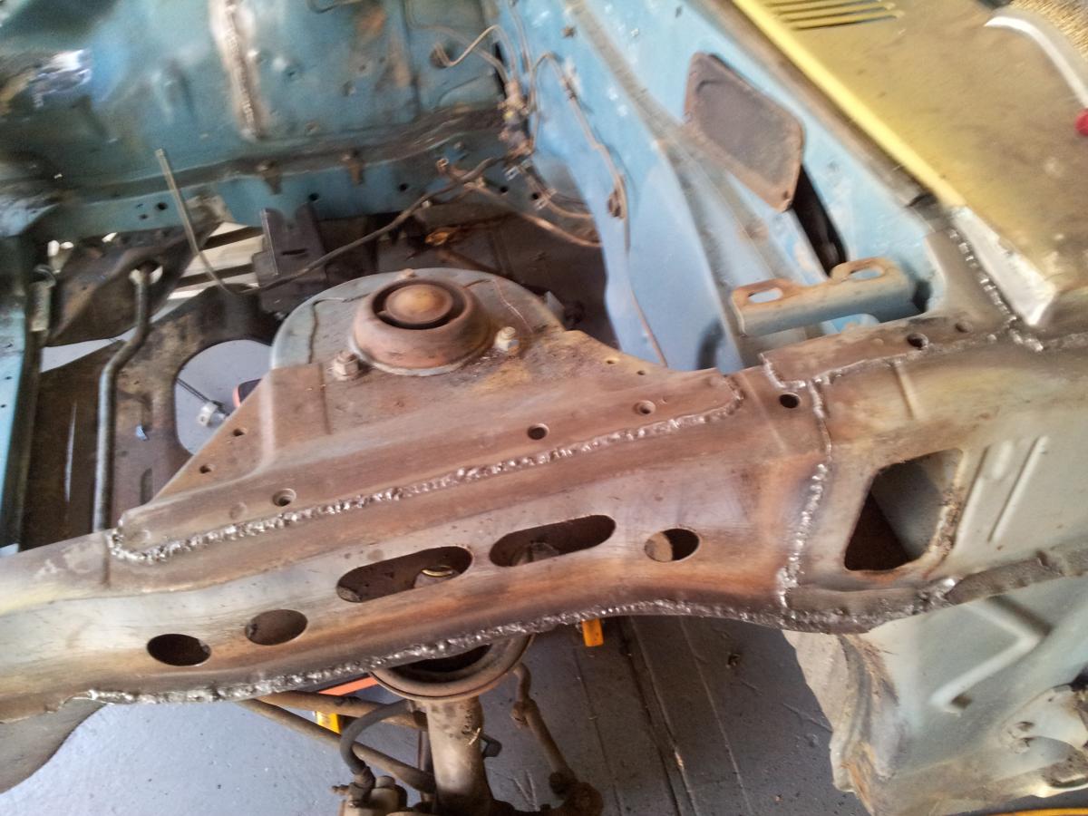

When the new welder turns up I will finish the crossmember.

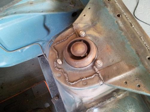

Pics of your car have been very helpful in pointing me in the right direction. Instead of attaching checkerplate to the bottom of the cross member though, I will be welding some three mm sheet to plate where I have cut and will be welding six mm plate under the engine mounts. As I am only a beginner welder, I need tgo make the job as easy as possible for myself.

I mounted both the seats in the car and they only just clear the door trims..... I want to keep the s2k trans tunnel as it came from the honda for the strength.. Ill probably end up cutting the whole trans tunnel out of car so there will be much more room when the honda one is in there.
Was also trying to achieve an impossible dream by doing panel work with a gasless mig.... not good. So my new CIG weld mig will arrived this week some time so i can start to clean up my own mess!!!! NEVER GASLESS MIG A CAR BODY... DISASTER.... The perils of learning i guess
Edited by maccat01
Crappy welding? Let me irtroduce you to Mr Grinder! Many an abysmal weld has been made to look great by the application of time, elctricity and grinding discs.. sometimes even cutting discs! Besides, a lot of those welds will not be seen!
However, there is no solution like gas with Mig, it is well worth the many dollars it costs!
