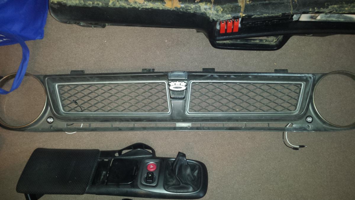

Ive decided to put the front indicators in the grill so purchased these little 3 LED waterproof clearance lights. My front parker will be an angel eye in my headlights and I will be putting a rectangle fog light into the space in the front bumper where the indicator and parker used to be

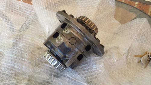

Kun25 hilux lsd arrived today. Wasnt gunna run an lsd but we had heaps of rain recently and even the old 3k wouldnt drive up a slope as it kept single legging. Haha
