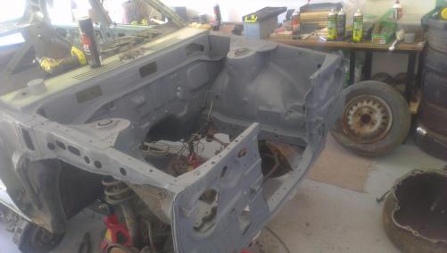

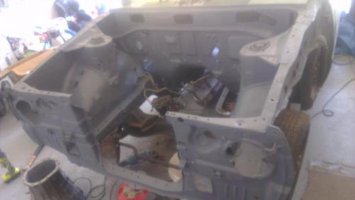

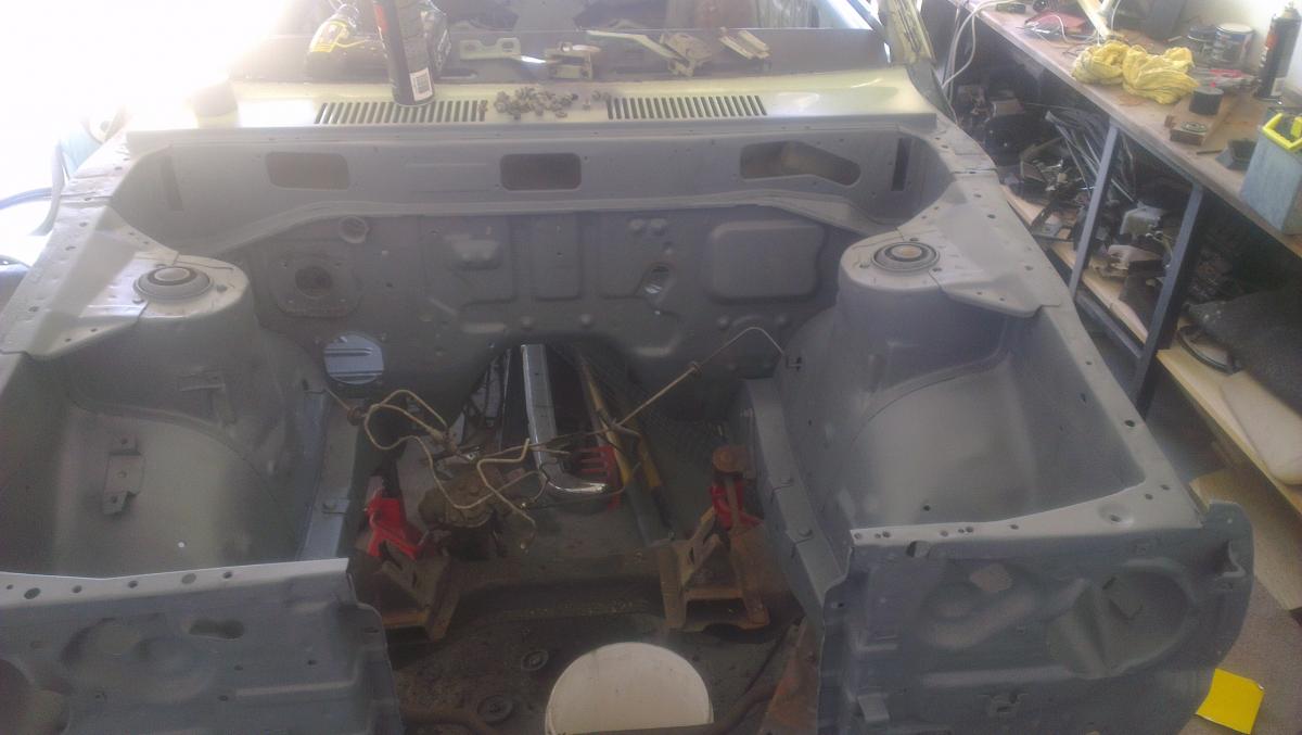

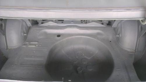

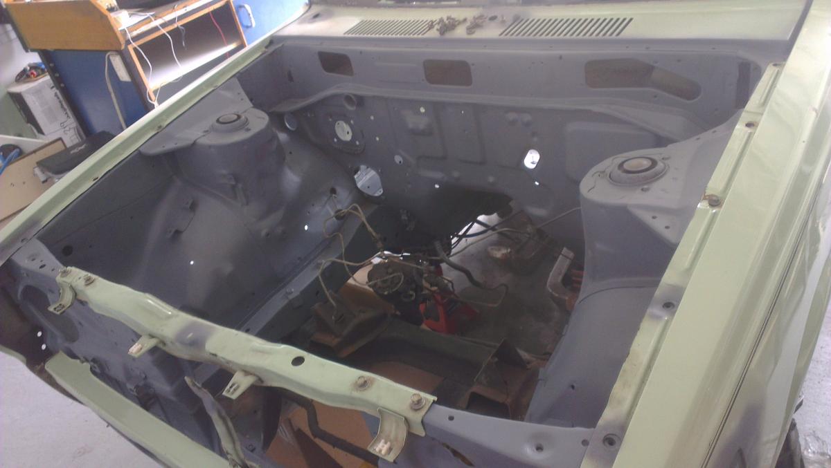

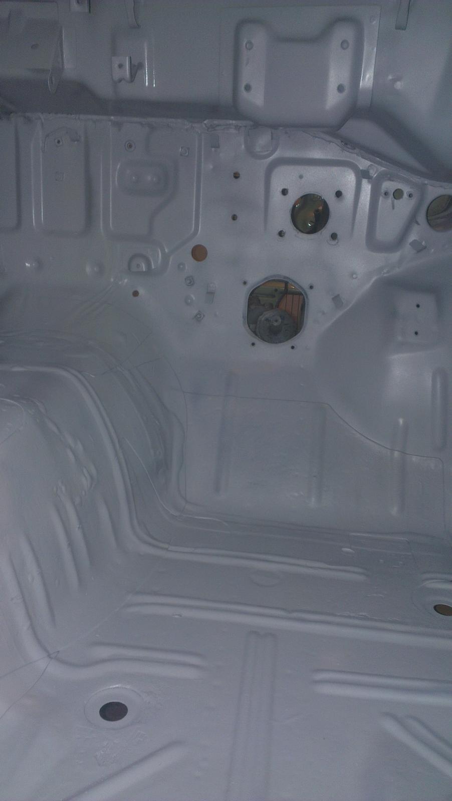

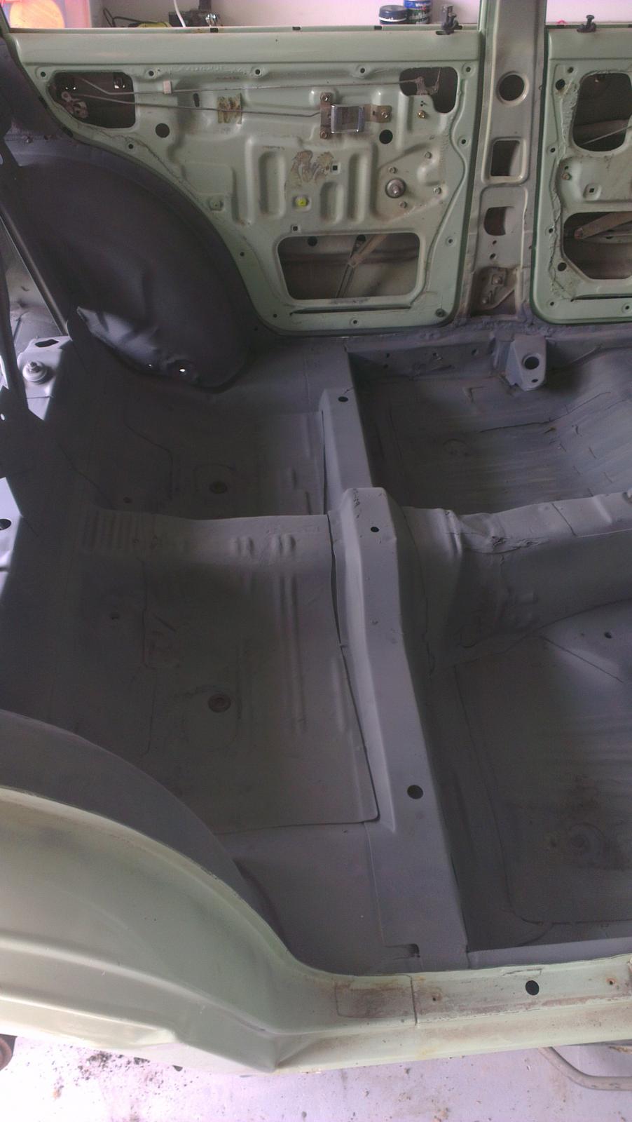

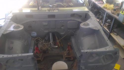

  7. Got a couple of hours today so I finished cleaning up the inside floor and primed the rest. Got to try out the new spray gun. Worked well and is so much quicker than using spray packs. As well as the boot area. And here is another pic of the engine bay.

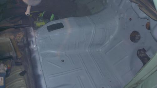

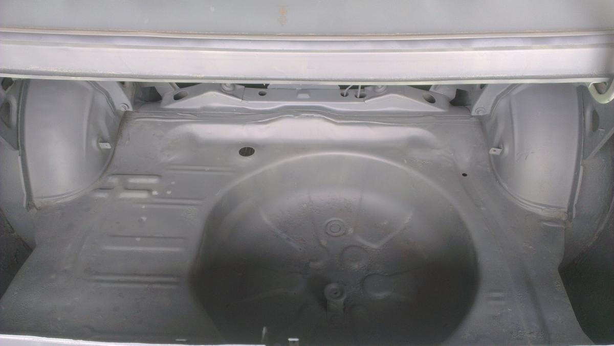

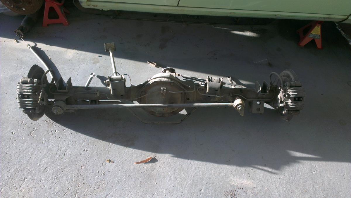

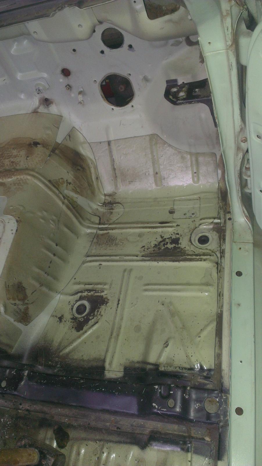

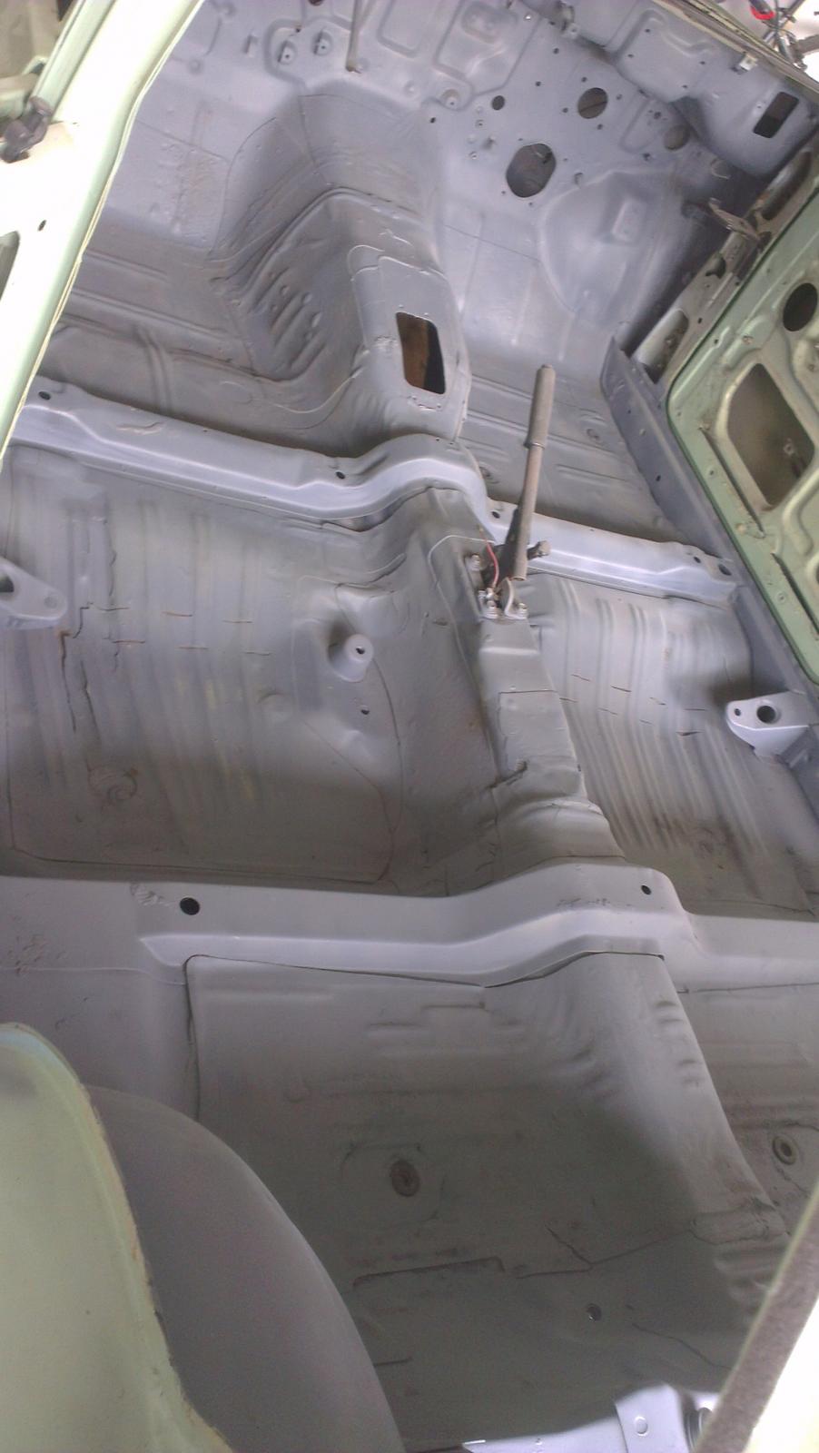

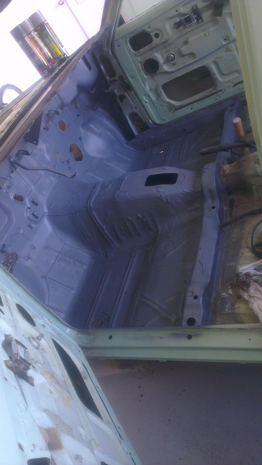

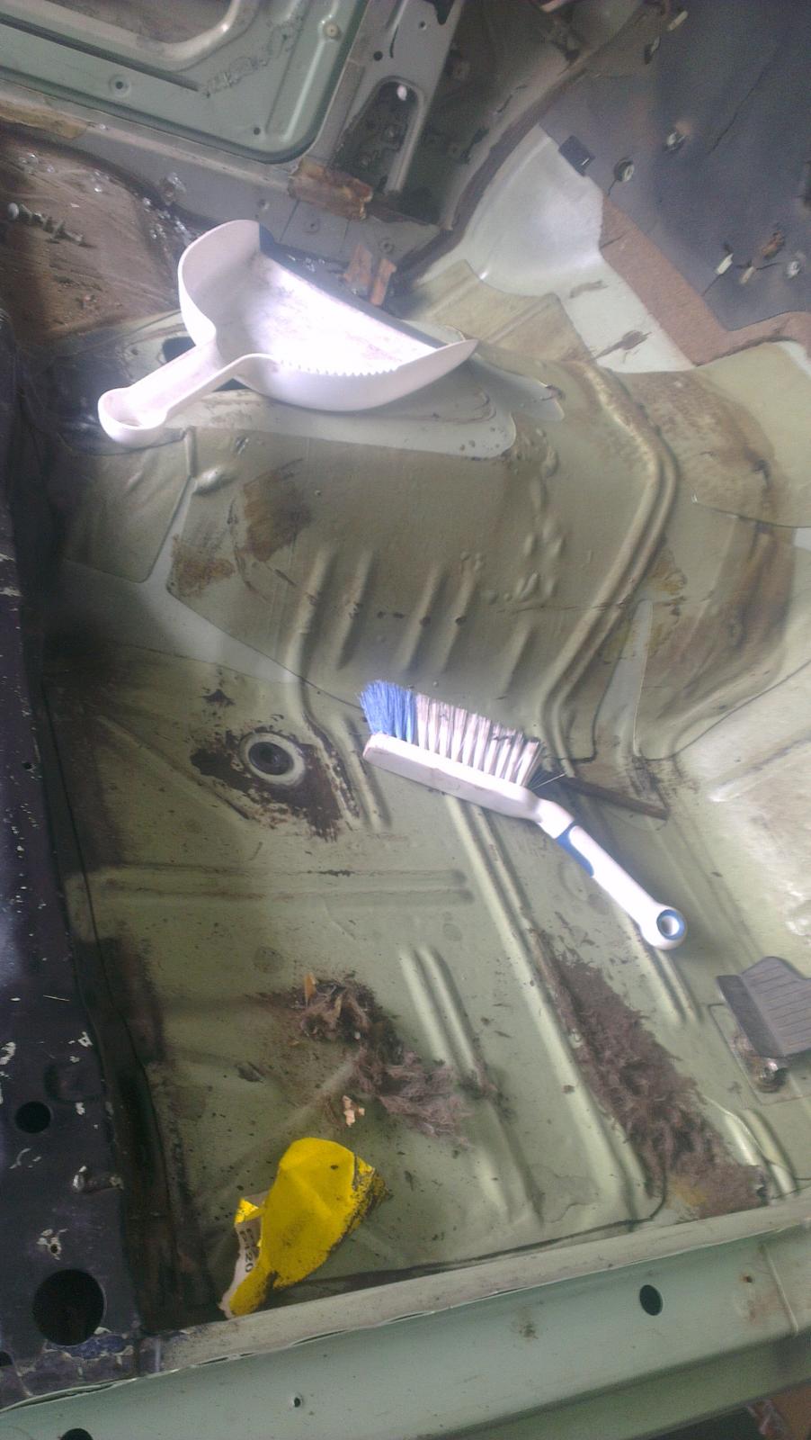

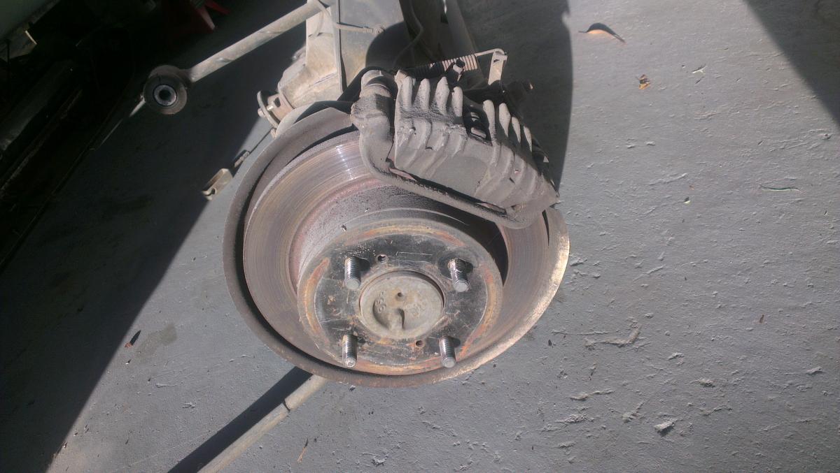

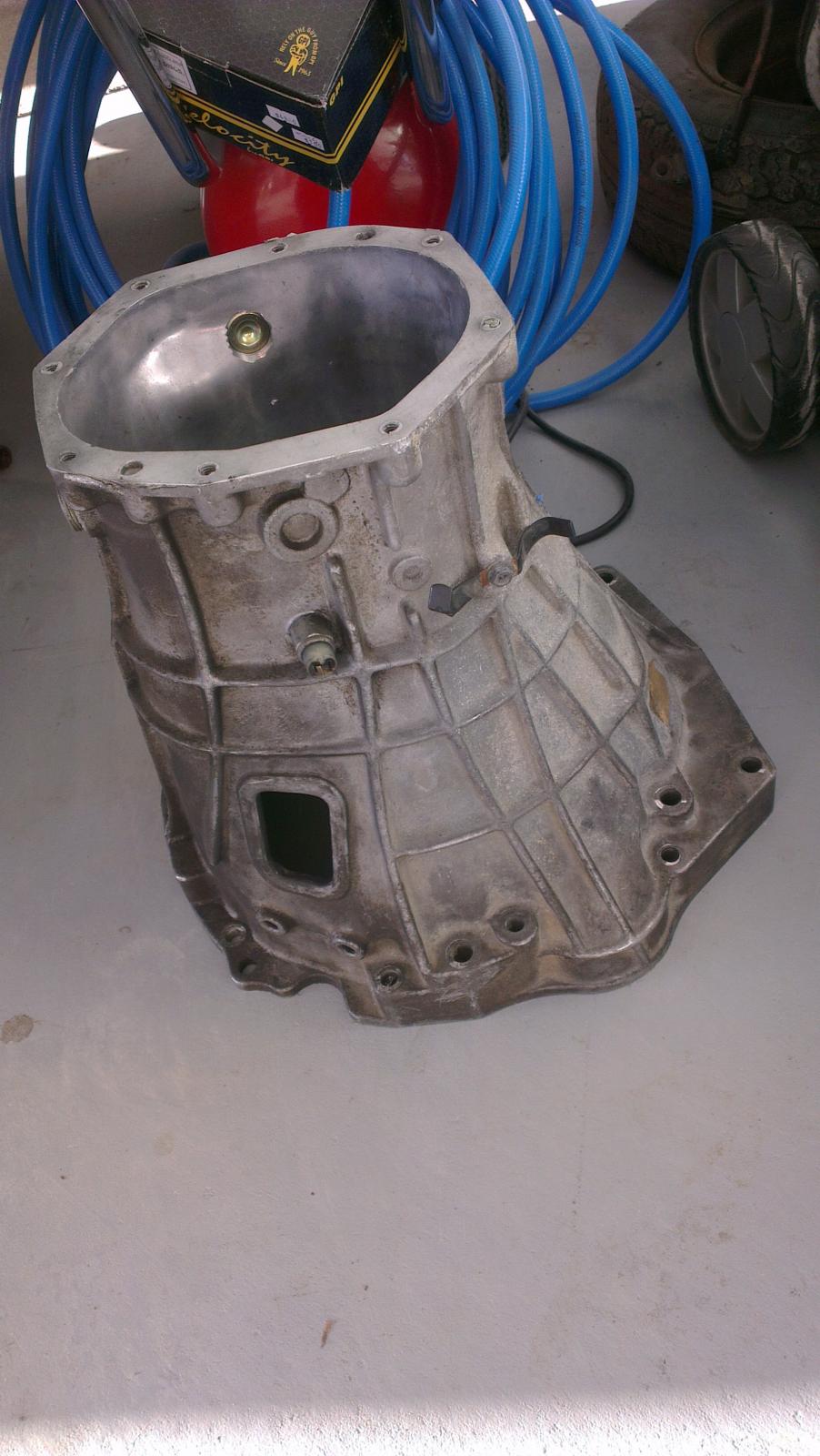

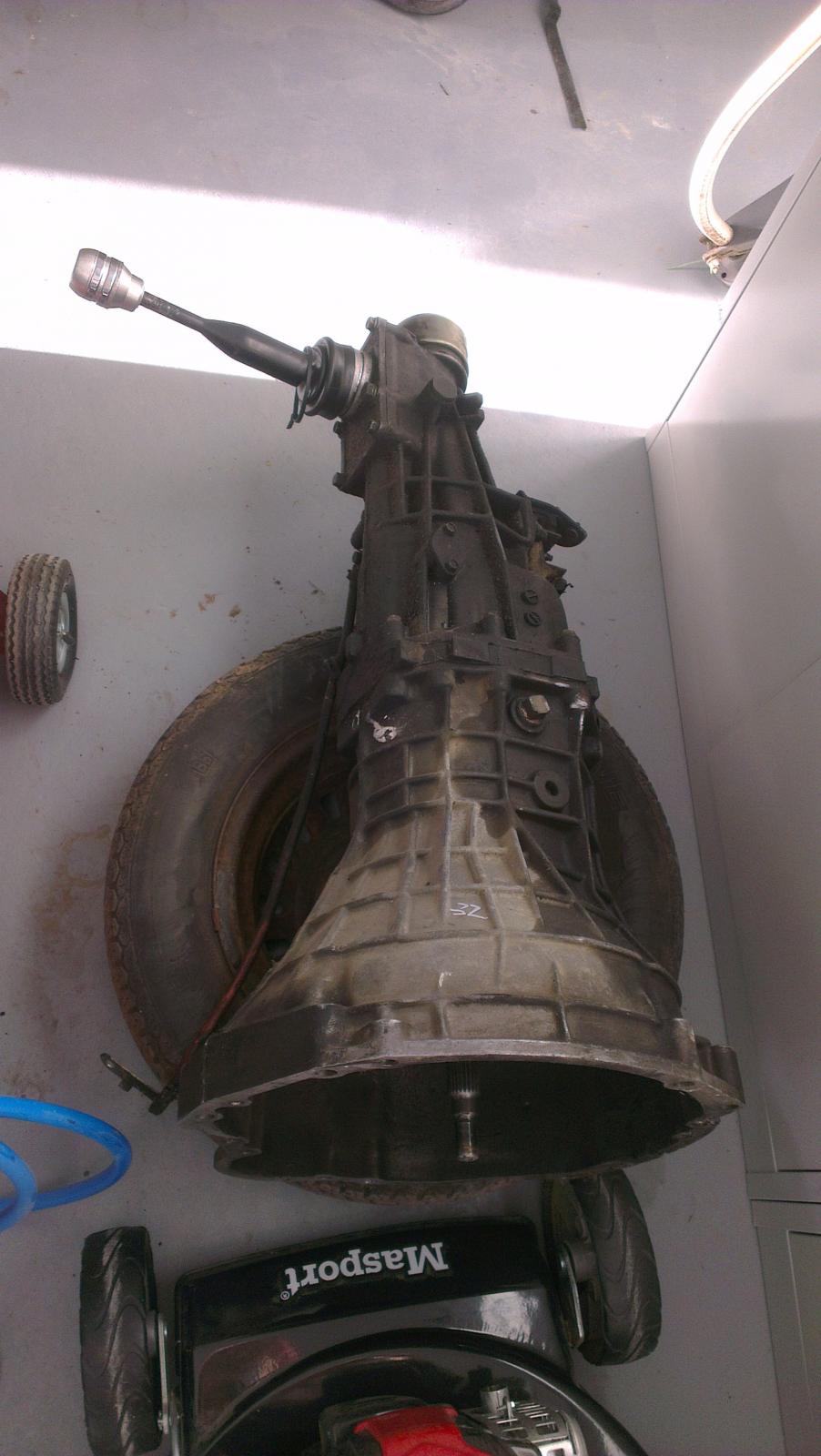

  12. Build Update Hey Guys and Gals, It has been a while since I have had time to get out in the garage and do some work on Betsy, but today I was finally able to get out there for the day. There are a couple of other Items that I have obtained and filed away for later use as well. Item No. 1: The R31 Diff that I managed to pick up from a friend of a friend for $100. This will be shortened with a 4.11 Borgy and LSD. As well as this it came complete so it also has R31 discs/calipers (Rear brake upgrade), panard bar (that may be able to be modified to suit, & handbrake cable. Item No. 2: RB20 gearbox. This will be coupled with the SR20 Bellhousing to bring the shift position around 50mm closer to the engine bay. Item No 3: SR20 Bellhousing, to be used with the above item. Now all I need is the engine to go with these items. :bash: Today I decided to begin the cleanup of the aftermath that was the front windscreen, LOL, yes it has been sitting there for that long. As can be seen from the photos I had a couple of cans of Rust Converter and Super Etch Primer lying round so I utilized these and cleaned up the engine bay as well as the front interior and rear seat foot wells before I ran out of the Etch Primer. If it is any indication about the lengths I am going to go on the rest of this build I dare say it is going to be very very clean, lol. I say this for as can be seen in the photos ....... I even cleaned up the rubber plugs that go into the front driver side floor, but I must say under all that dirt and grime they were in surprisingly fantastic condition. Will be more to come so stay tuned.
  13. I'll be running a cut down R31 diff with 4.11 Borgy and LSD. Haven't had it cut down yet, but if my calculations for the offset are correct I will just make it the same size as the original diff. Brakes (Rear) will be the R31 discs and calipers etc. (Front) will be a Hopper Stoppers kit, 290 or 300mm. I am not sure if I have to yet. I'm running a SR20DET with a RB20 gearbox (brings the shifter 50mm further towards the engine bay). The calculations are on page 2 and the start of page 3. Feel free to check them for this is my first time working out offsets so it would be good for a second opinion. Nope, no flares. I am hoping to fit everything within the original guards. I have no objection to rolling and lipping the guards, however I would like them to look as stock as possible. Love your build by the way Dave and always value your feedback. I always have the option to run 15x7 (+12) at all four corners (which I have been told from a few people gives a good flush look) but would love for some fatter rubber at the business end.
