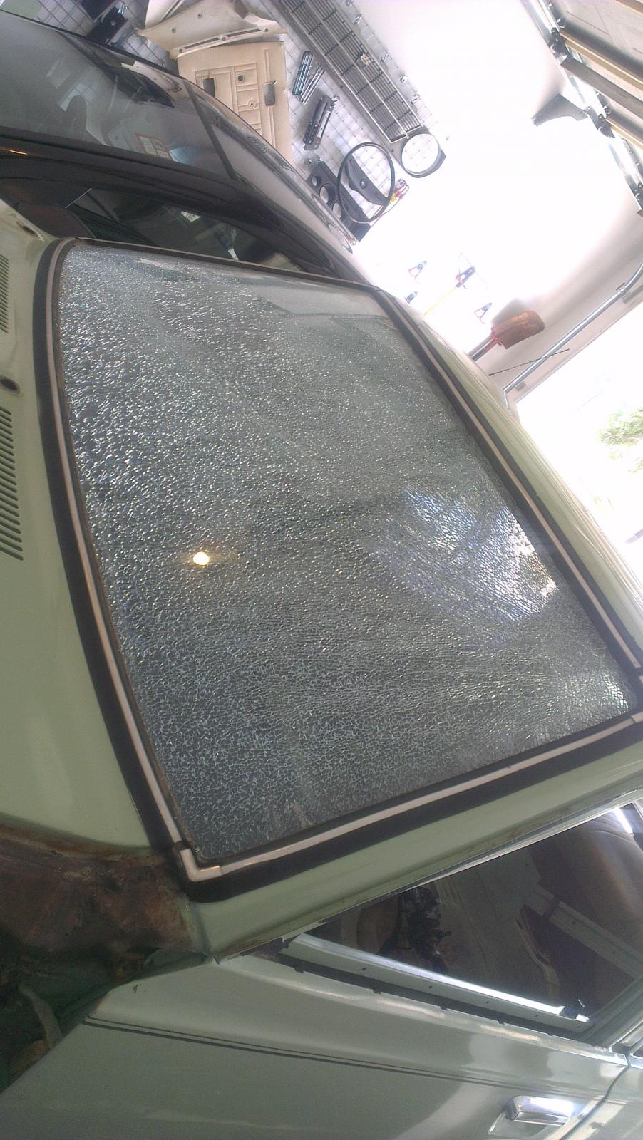

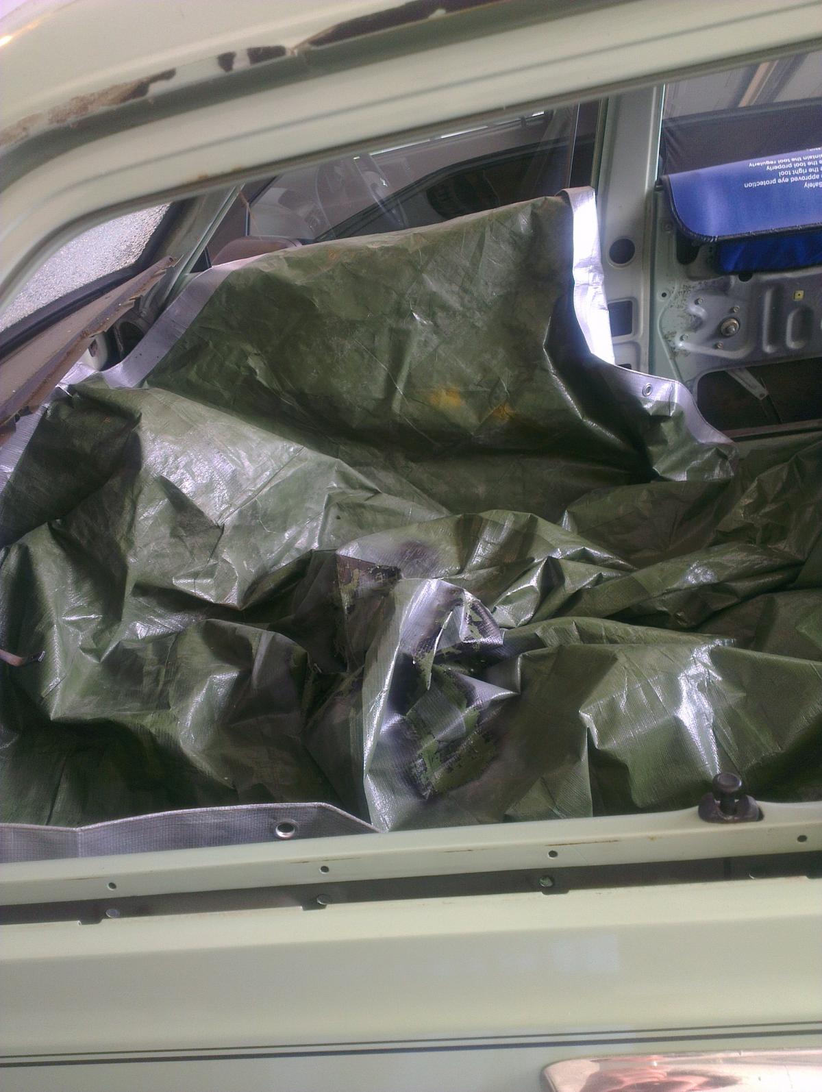

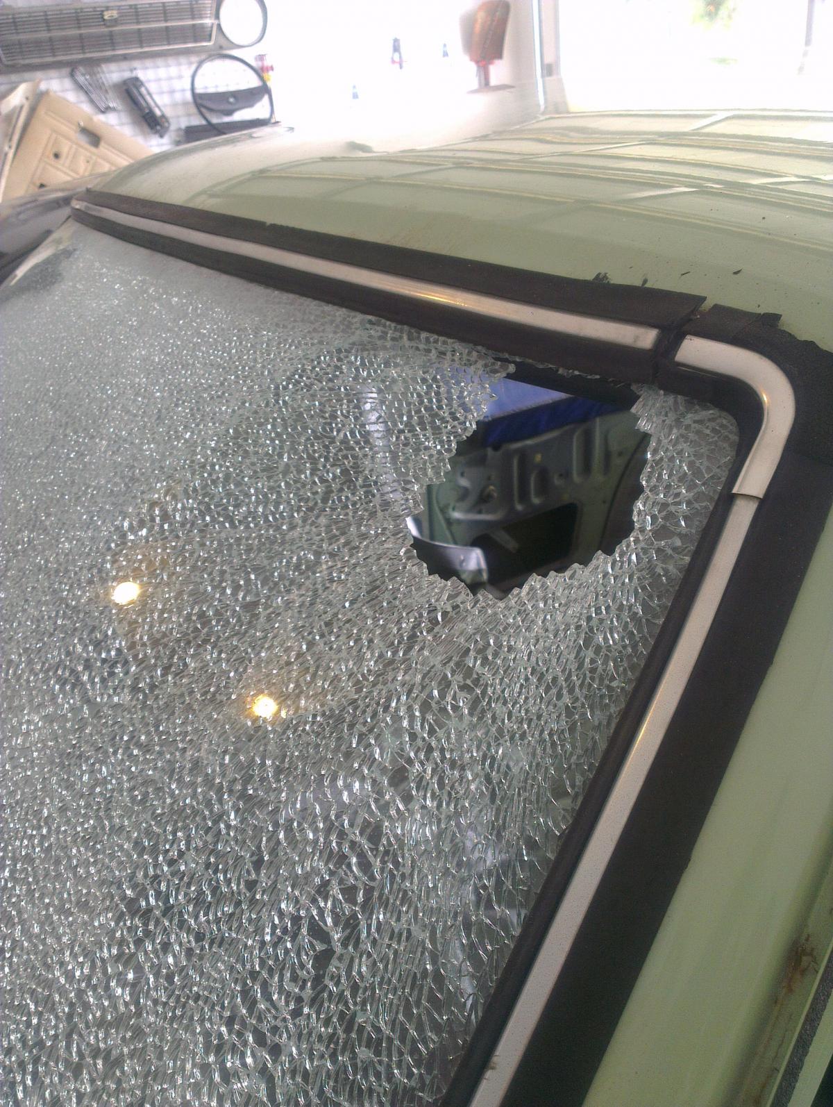

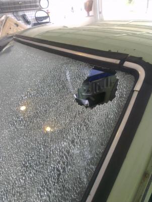

  6. Thanks for that Stuart, because I will be replacing all the seals in the whole car I actually cut the inside of the seal with a Stanley Knife, so that it was only the horrible tar like gunk that they use holding it in. Next time i know not to start at the corner of the windscreen for the weight and lack of flex in it was what made it go POP!!! And thanks for the vote of confidence in the build.

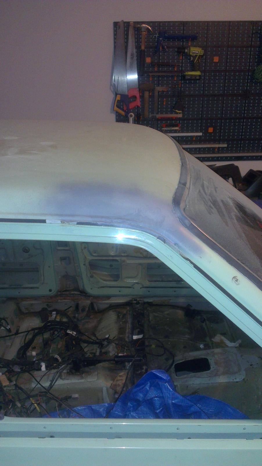

  7. Small update on Betsy. As you guys and gals are most likely aware, I had a small moment of insanity and put Betsy for sale both on here and on eBay. This was due to me doubting if it was even possible for me to continue let alone complete this build. This lapse was (I think) due to the new bubs being almost here, working unheard of hours at work, and then coming home to work on the house. However after talking tonight with another mate I soon received the reassurance I required. Now all glass but the rear window is out. I tried to get the front window out in one piece but as you can see from the pictures I failed and the loud POP of the window made me jump. So I tarped the inside and out came the hammer of Thor to knock it in.

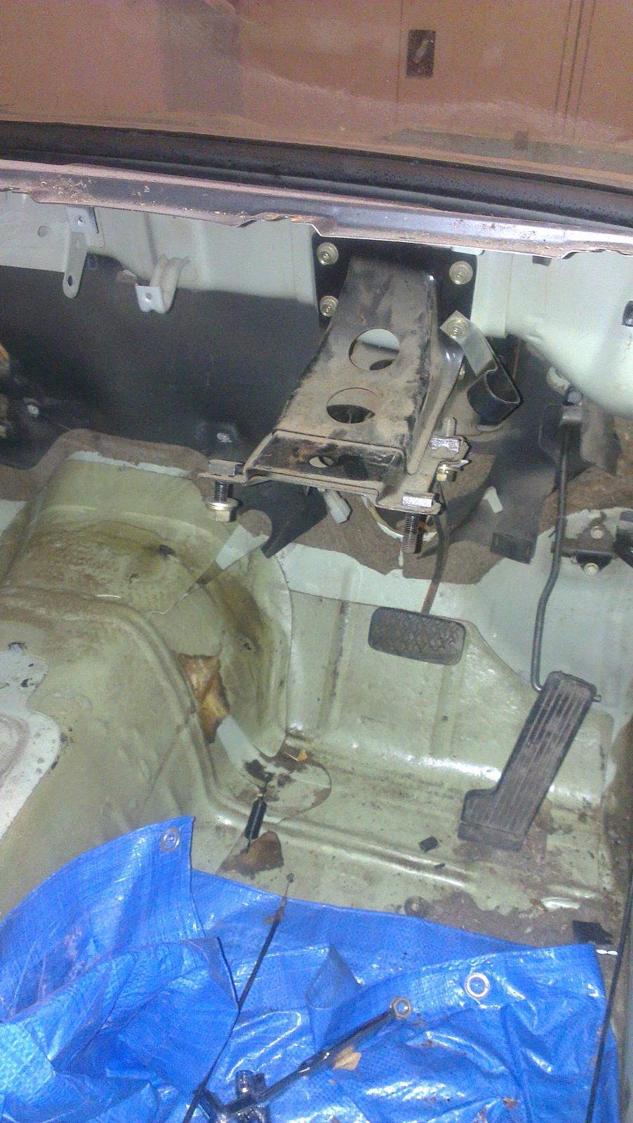

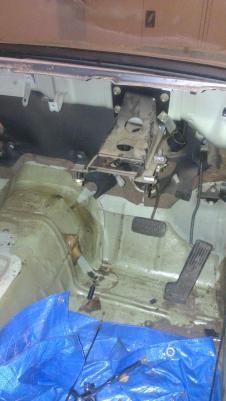

  11. Wow Craig mate you are amazing! and you can definitely tell this is not your first creation. I am only early in my build of a Street KE30 4 door, but I think I may incorporate some of your amazing ideas and use the motivation that I have gained from reading this thread to really hit 'Betsy' hard in the new year. I especially like the pedal box and the reservoir placement. Thanks mate, can't wait to see the finished product.

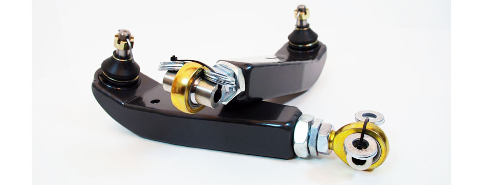

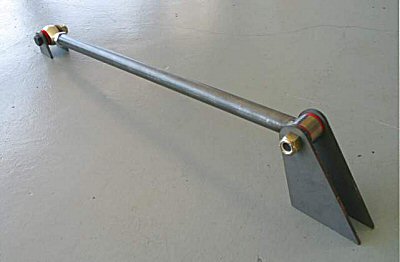

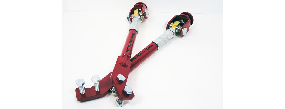

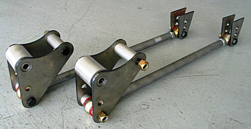

  14. Thanks for the feedback, I am pretty much sold on trying these coilovers out. :thumbsup: As for the entire setup here is a rundown of the bits and pieces I will be looking at including in the suspension. - Fortune Auto 500 v4 coilovers in the front with 8k or 10k springs + radial bearing mounts - T3 Front Lower Control Arms - T3 Tension Control Rods - T3 Negative Camber Roll Center Adjusters - McDonald Bros Track (Tramp) Rods - McDonald Bros Panhard Bars - Nolothane Bushes all round - Most likely a custom sway bar. That will start us off and then it will be a matter of getting the setup correct through testing. :yes: Any thoughts??? Do you guys and gals think this will be a good starting point??

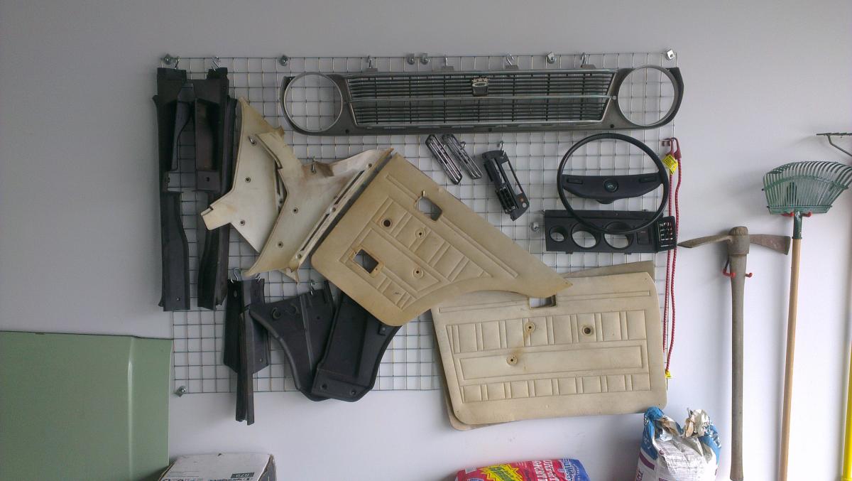

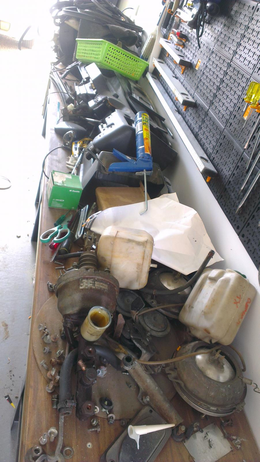

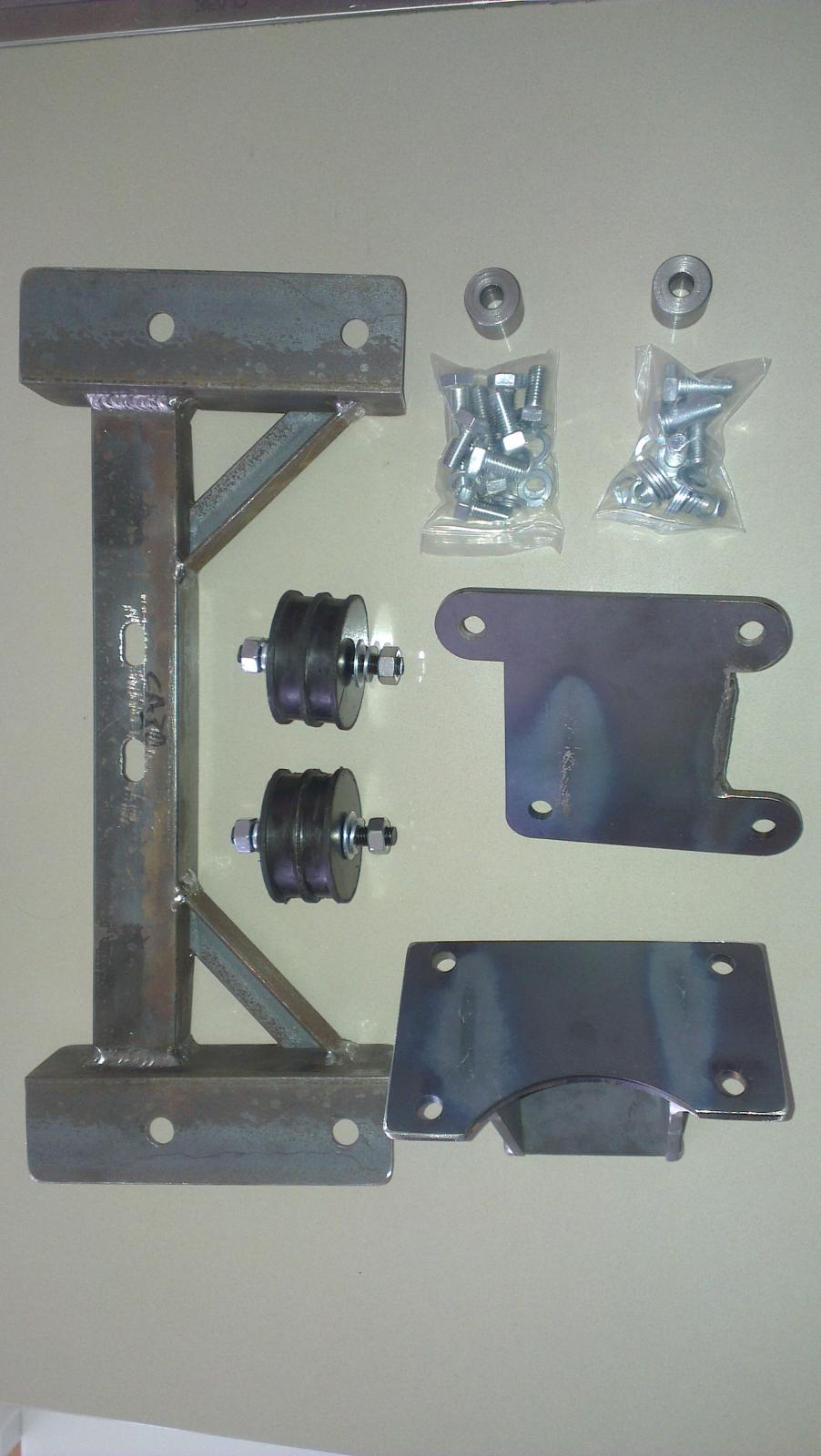

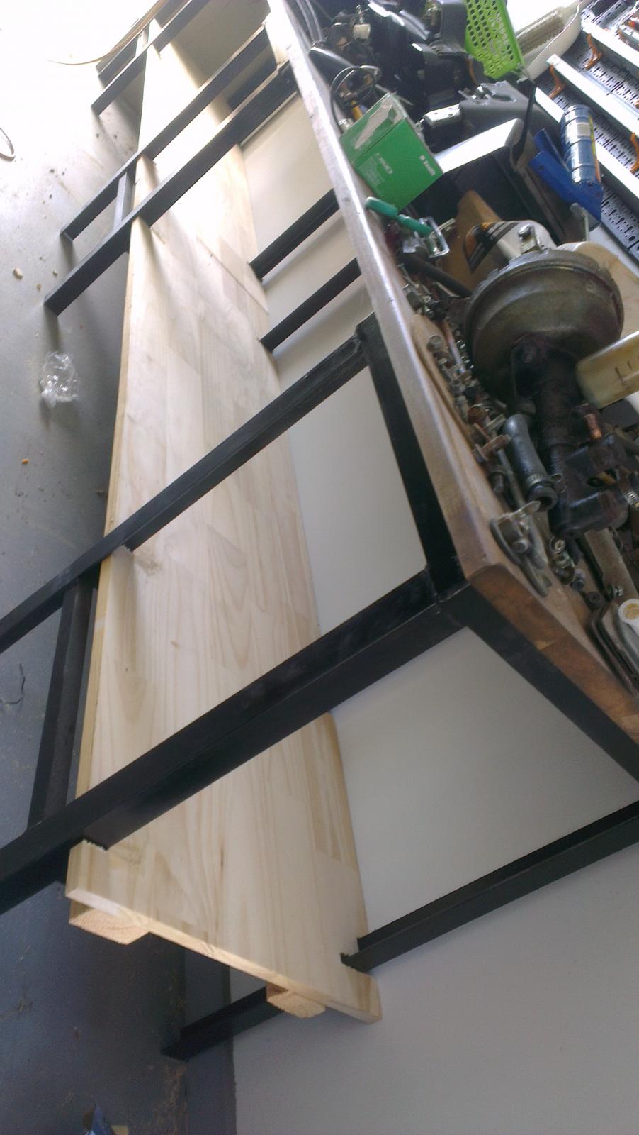

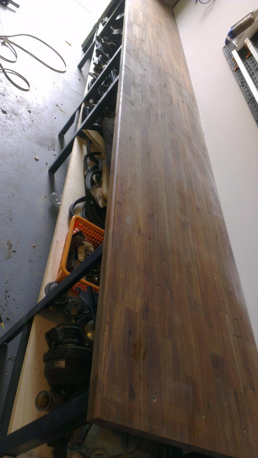

  22. Hey guys and gals, Not so much a Betsy update but more of an organizational update. Got some more of the Garage organised so as I have more room to work. As can be seen from the photos, new shelving under the bench, a hanging board to get things up and out of the way & finally I got my engine mounts from Jordan, cheers mate they look awesome. More to cone soon.

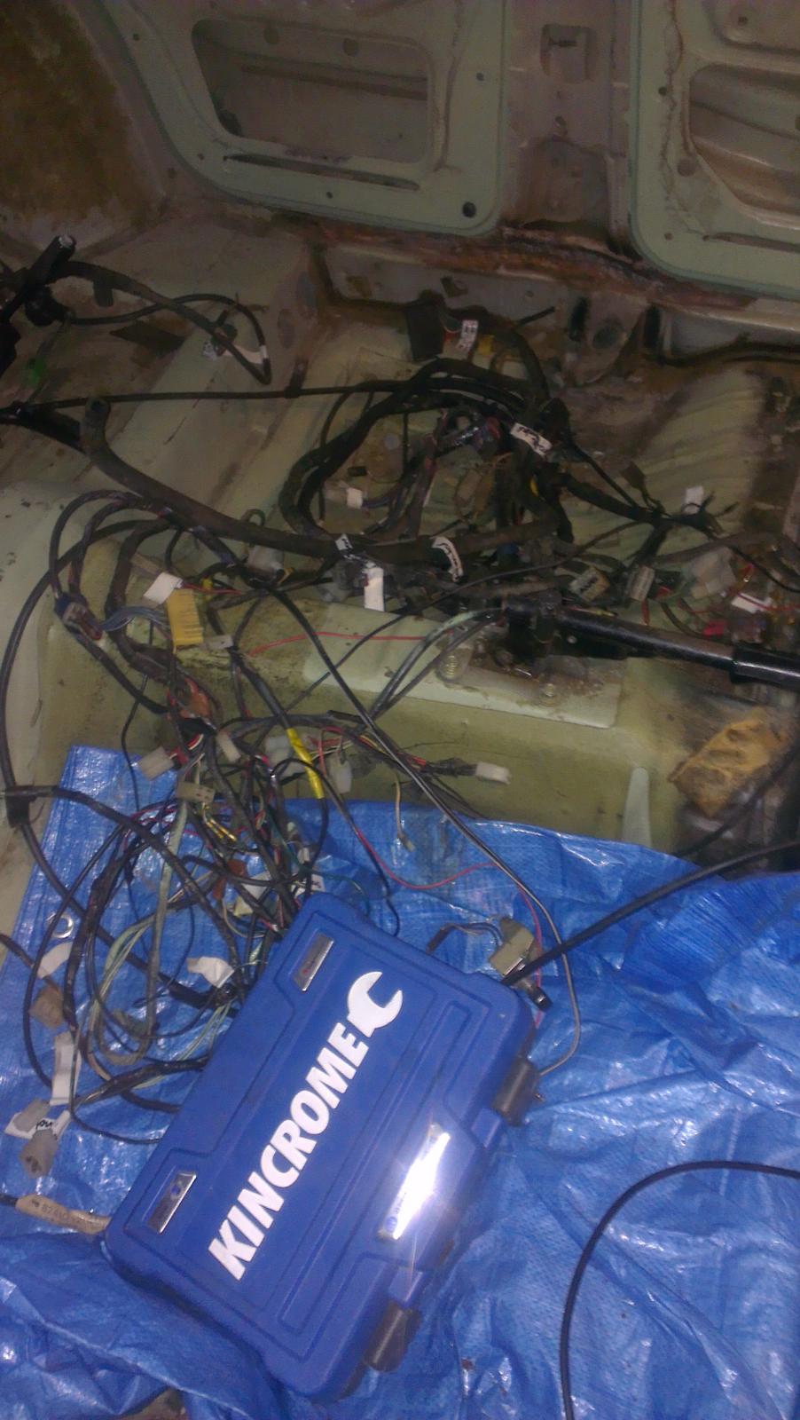

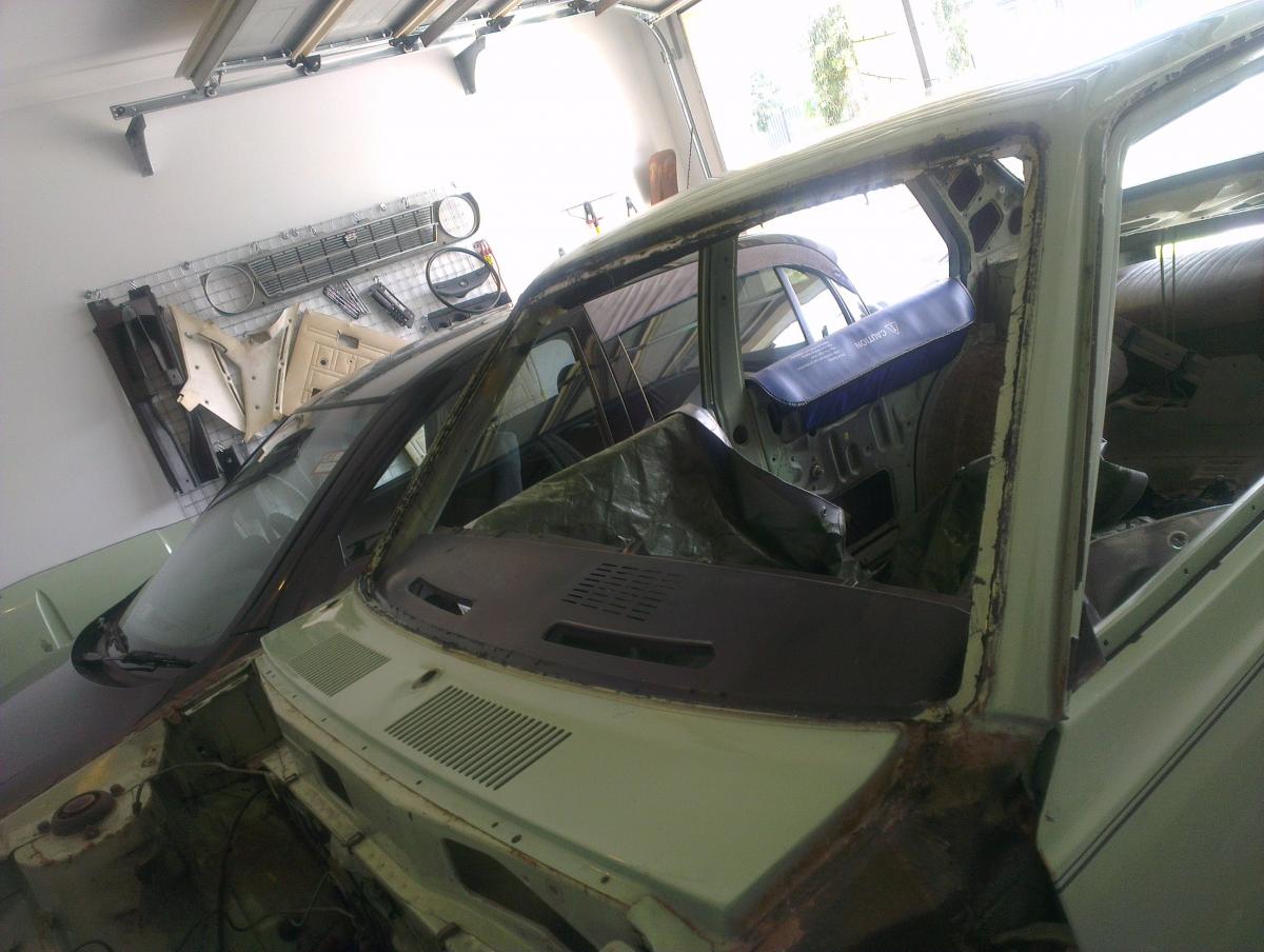

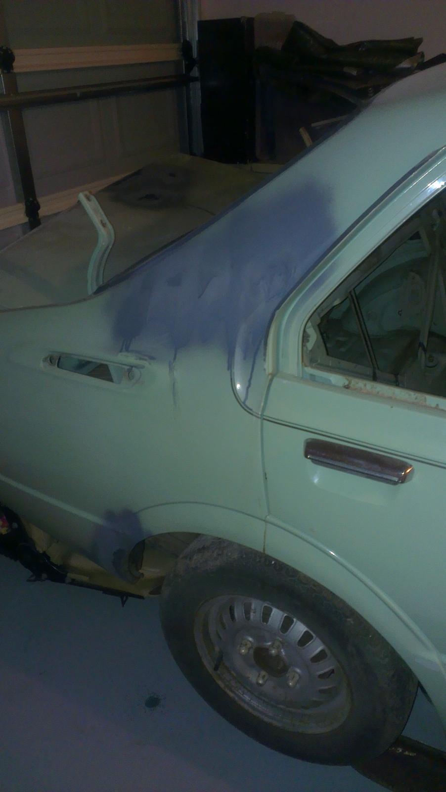

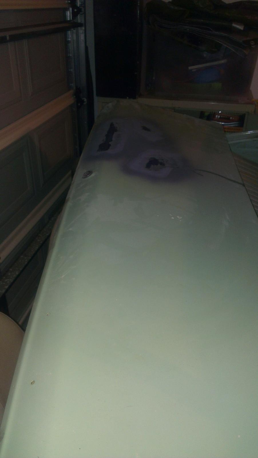

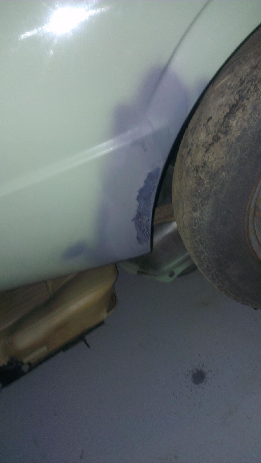

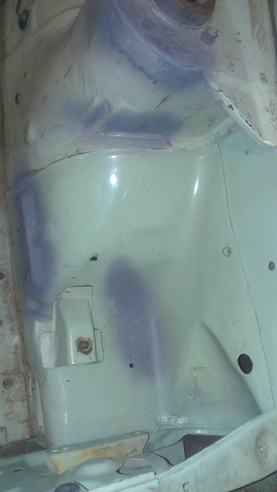

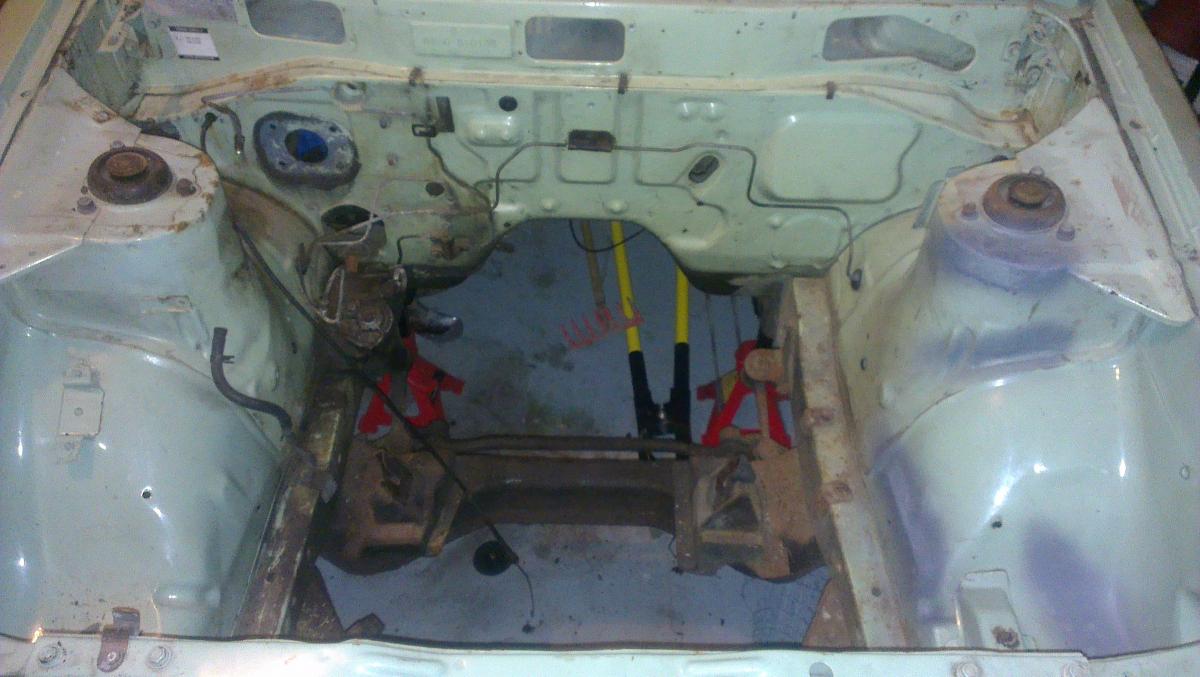

  23. Hey Guys and Gals, Not much has been happening with Betsy lately, I have finished removing the wiring loom, YAAAAAY!!! As well as the engine bay is now completely stripped, and the steering column has been removed. Oh and I started on some small rust repairs. I have only taken a few spots back with the wire brush (pretty rough at the moment) plans to use the orbital sander on them later, sprayed them with the rust converter to stop the spread of any specs i may have missed and then put a coat of primer over them, just to safe guard. I have also ordered my block mounts, rubber mounts, gearbox cross member & complete bolt kit for the SR20DET through Jordanrolla. Heard a lot of positive things about his conversion kits, as well as it takes a lot of the messing around out of it (my thoughts). Can't wait to get them and see how we go.
  24. Hey guys and gals, I have been browsing your rigs and they are all very unique and very cool. I have just recently started a KE30 build of my own. I have just finished the strip down and now we are moving onto the bodywork. Eventually it will be home for an SR20DET (S15 model). If you are interested you can follow my build blog at http://www.rollaclub.com/board/topic/67373-betsy-the-little-ke30-that-knew-she-could/ I would much appreciate the support and insite into this construction. :lmao: Cheers.

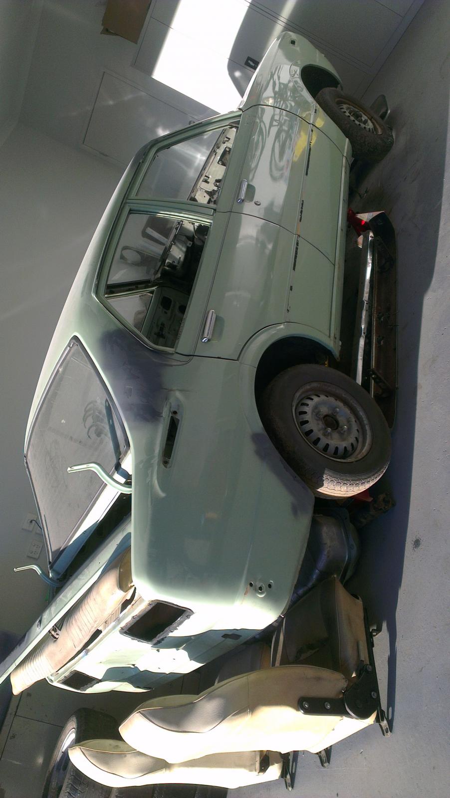

  25. Getting prepared to spend a day in the garage with Betsy on Wednesday (if everything goes to plan). I have my daily booked in for a service so the mechanic will drop me off at home then pick me up in the arvo when they have finished, door to door service. So I will be without transport. However I have today gone and gotten supplies so that the clean up / rust repair / rust removal can begin. I will post more pics after Wednesday.
