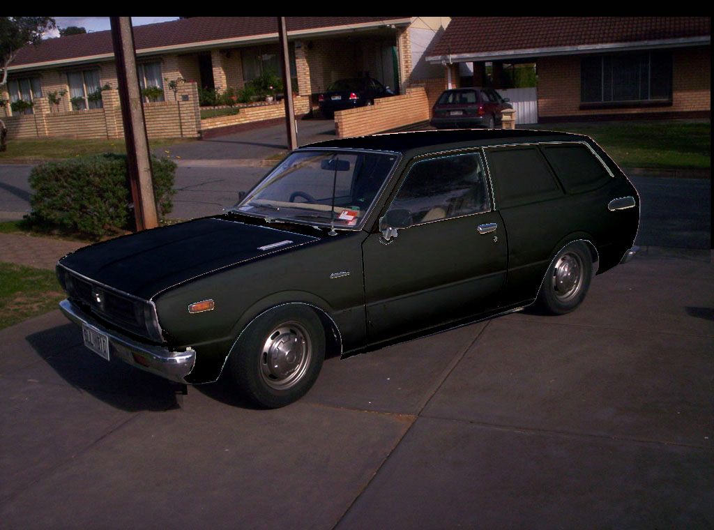

Ok, so that gearbox is no good. But I've been getting idea's on painting it up.....
Might have to crack out a heap of pressure packs and spray it once the rust is cut out and dents are fixed....
