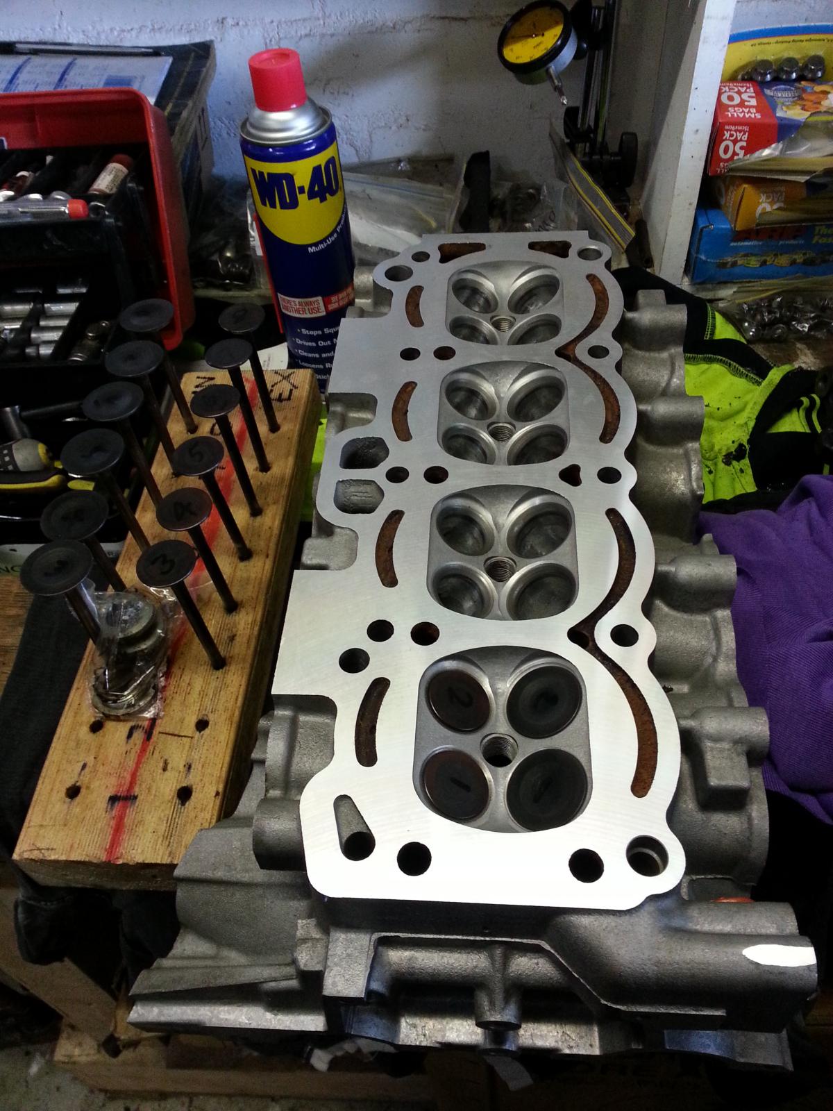

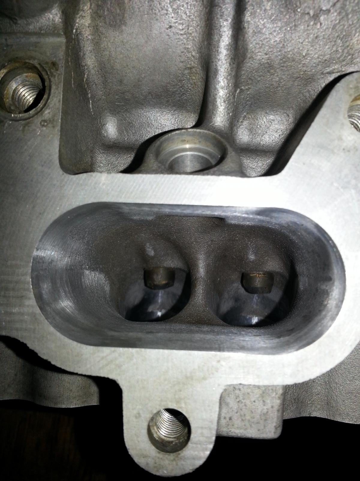

Everyone loves photos! She got a light skim, 0.25mm taken off & the intake ports received a little love.
post-5437-0-57208200-1372995284_thumb.jpg post-5437-0-00249200-1372995308_thumb.jpg

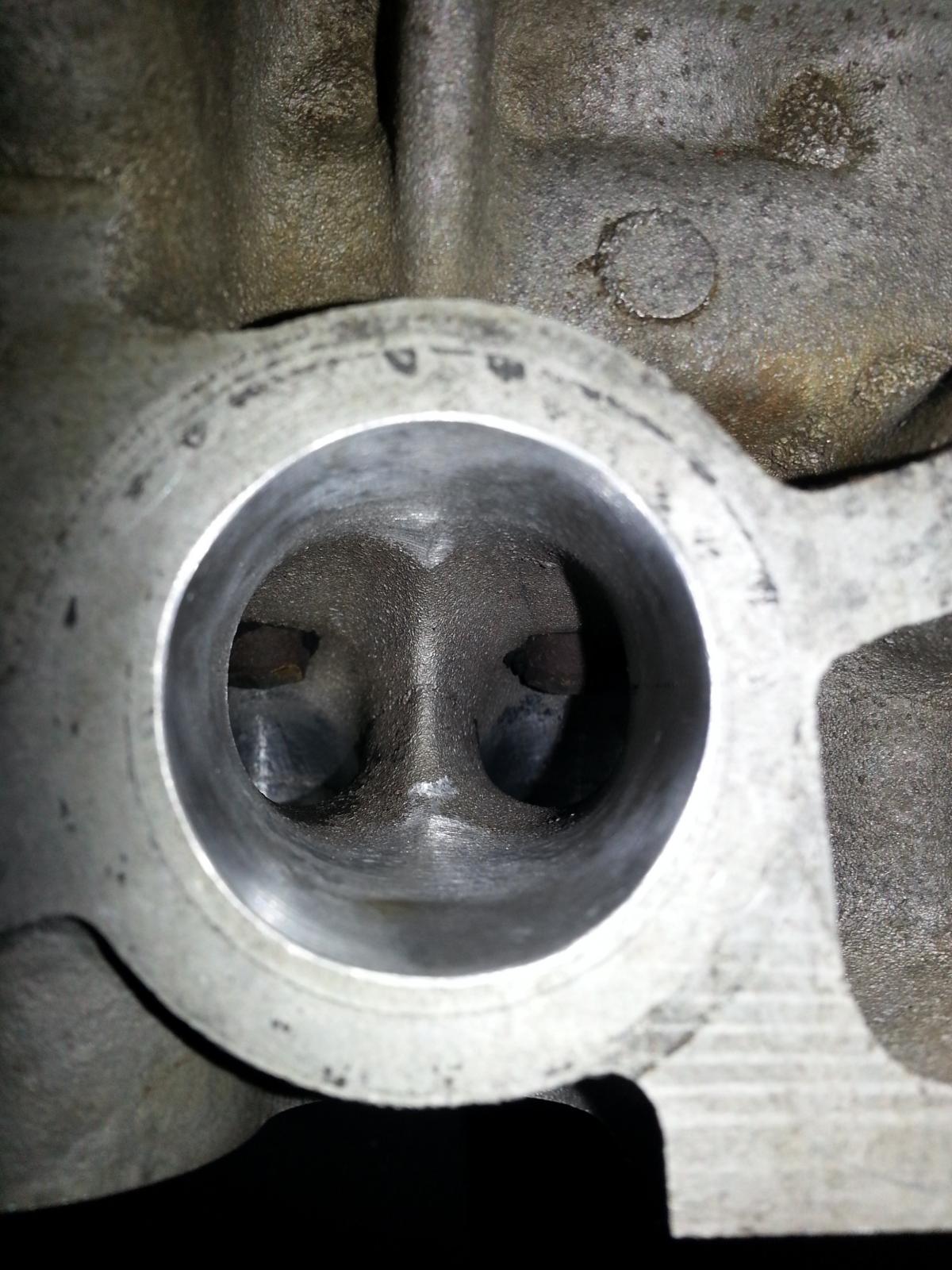

As did the exhaust ports, being opened up to match the gasket/manifold, now all clean & ready for reassembly!
post-5437-0-23151700-1372995331_thumb.jpg post-5437-0-61871200-1372995356_thumb.jpg

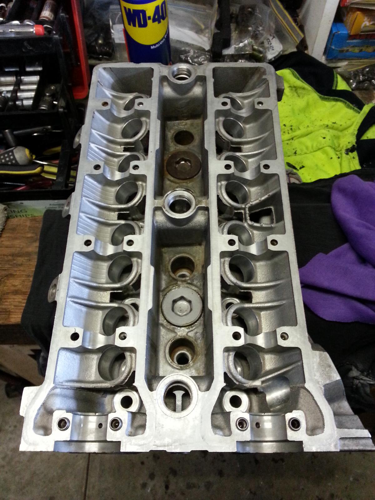

A bit of a bad news, good news update. The bad news is I started assembling the head last night, got up to the fourth valve & realised that I'd been a bit eager to get started & hadn't washed the head properly/blown out with compressed air. I also noticed that I had been so keen, I'd also neglected to put the valve stem seals on. So it was strip it all apart & wash it again, by the time that was done it was bed-time & I was back at square one. Slightly demoralising to have made no progress, but lesson learnt & better than realising after it's all together.
The good news is that I picked up my intake manifold flange from SamQ & also, installed the 20kw power upgrade sticker on the back window. I give no $h1ts what colour it is. ;)
Managed to get halfway through re-installing the valves etc in the head, when I dropped a valve stem seal & in the process of trying to catch it/not stand on it, I managed to stand on it & crush it. :bash:
Called up the shop where I had the head work done, explained the situation & asked if he had a spare laying around. Drove across to the other side of the city & back in afternoon traffic, but worth it. He had not just one but two of the exact same type I already have. Saved my clumsy ass big time!
