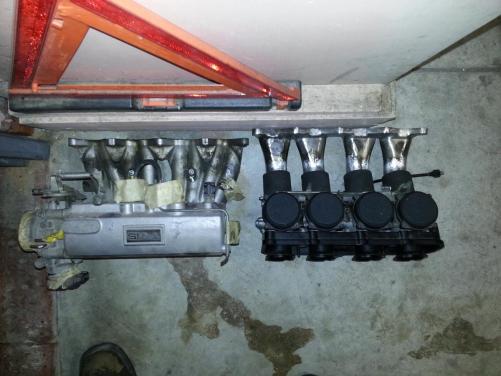

I'm going with that yes, based off how they are set up on the bike & other peoples experience with them, it seems the way to go. Also, I pulled the fuel bowl off & had a look at the float, I'm no expert (as if that wasn't obvious), but it might not function properly the way it was. Overall horizontal length from cylinder head is the same as before. :)

Clearances look good all around, any recommendations for vacuum line sizes? 6mm diameter enough to go from the runners to the distribution chamber, or should I go 8mm?

I reckon the fuel bowl seam should be level..

The fuel bowl seam being level made perfect sense (not only from what you were saying a while back, but the factory bike setup), until yesterday when I took a closer look at a friends 2009 Kawasaki Ninja 250. I'm not sure if the carbs on it are the same model/size as mine, but their seams are not level. The front wheels would have to be off the ground for them to be, then again a bike accelerates pretty hard, the angle could suit.... :hmm: Maybe there was something to the urban myth I came across that later models didn't have to be level, so easy to become confused when you know as little for certain as I do! :blinks:
Seeing as mine are 10 years older than his, sticking to the current plan.

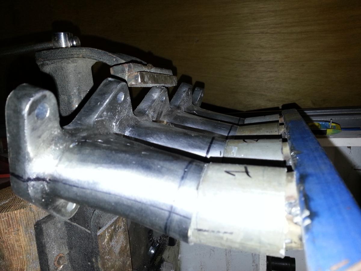

I had some 'touch up' welding to do to fill a few holes, I think I've gotten them all now. Also added some metal to allow for the drilling/tapping of holes for vacuum ports on the runners. The brushes in my angle grinder gave out about halfway through grinding the welds back, so the rest was shaped by hand & finished with a wire brush on a power drill.

Still some work to do on the inside, but could be worse.
