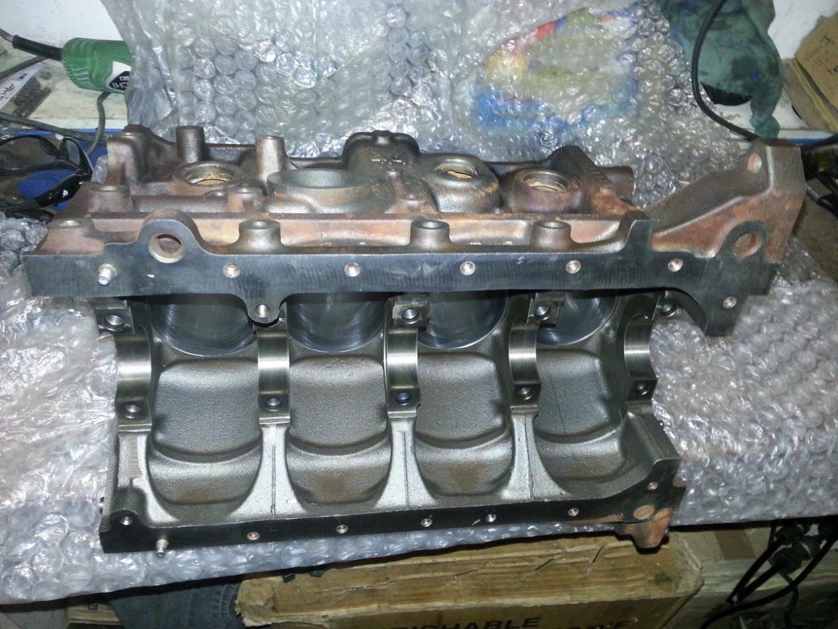

carbonboy Posted August 16, 2013 Author Report Posted August 16, 2013 (edited) May the progress recommence! Forgot to order piston rings, but sorting those next week. Machinists were literally moving the workshop to their new location (mostly with forklift/truck) when I picked the block up, so will give them some time. Could get them from Repco etc, but the machinists can get them for me even cheaper so why bother? ;) 0.010"/0.25mm deck skim & probably not even that much with a cylinder honing, paid a third of what I was semi-quoted/expecting so no complaints here! :) Edited August 16, 2013 by carbonboy Quote
coln72 Posted August 16, 2013 Report Posted August 16, 2013 Nice, but need to squirt some color on it ;) Quote
carbonboy Posted August 16, 2013 Author Report Posted August 16, 2013 (edited) True, I was thinking that those bores would look great in yellow. Edit: Playing with filters/effects while bored at the laundromat last night, turned out okay for a phone camera. Edited August 16, 2013 by carbonboy Quote
