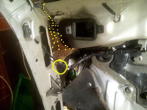

satisfyingcrunch Posted June 12, 2013 Report Share Posted June 12, 2013 Hey guys, i've just got myself a Ke70, and there is quite a bit of rust that i wasn't able to see until i stripped the car down. I'm quite new to this and really this is my first time working on a car, so i'm not too aware of how to fix all rusted situations. So far I've removed some surface rust and minor rust here and there, but this rusted area was actually behind the left hand side fender. I saw that it was rusted from behind, so went and stripped the interior to investigate and found this. Its quite a tricky spot and i really don't know how to go about this. Any help would be greatly appreciated Quote Link to comment Share on other sites More sharing options...

altezzaclub Posted June 13, 2013 Report Share Posted June 13, 2013 Sorry i'm not sure what you mean by leak When it rains. If water gets into the car at the corner of the windscreen it can follow the path shown down that area. It may have leaked for a year or two in the past and then had the leak fixed. The water that goes into the ventilation grille in front of the windscreen when it rains may also find its way inside. There seems to be a water trail where I've drawn the circle. It is easy to see in your other photo. Quote Link to comment Share on other sites More sharing options...
satisfyingcrunch Posted June 13, 2013 Author Report Share Posted June 13, 2013 @Japlish Thanks man. I was actually thinking of hacking away panels around the rust to get better access to it earlier, but being a first timer i wasn't sure if my methods were correct. @Altezza Thanks man, i'll go sort out the leak. Quote Link to comment Share on other sites More sharing options...
