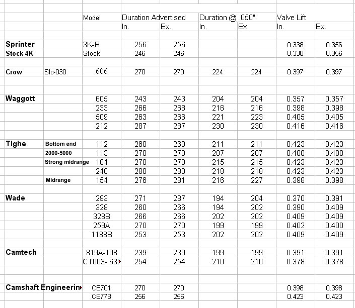

Have a look through the cam specs at Crow, Tighe, Camtech, Waggott, Wade & Camshaft Engineering. I think Crow and Tighe do most of Rollaclub's cams, but they will all have cams in similar ranges. I picked a miild cam for high altitude, a 270deg, the Crow 606. You could easily run a 280-285deg since you're not in traffic... The stock springs work up to 0.4" lift, although guys on here have gone higher. After that you need new springs.
Visit www.performancetrends.com and d'load cam analyser3.2 and have a play.
These are the mild cams I researched a few years back, I didn't list the hotter cams from each company-

EDIT: looking at your cam thingy i can't find any with 280 dur and 0.4" lift or under...
but the Crow cam looks intresting , the Wade 259A is alsmost identical, but it got lower duration at 0.50"...so its milder?

Those cams were just the ones I considered, and I only wanted a 270deg cam. I bought the Crow for its fast lift before 50thou lift is more important at 2500ft than at sea level. I can take a look for hotter cams on those websites.

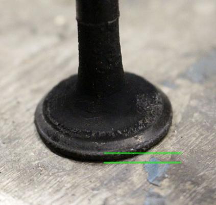

You're right, no valve stem seal on that one. Exhausts don't need them as they are under pressure when the valve is open, the inlets are under slight suction so they tend to suck oil down the stem and into the cylinder. I can't see which that one was.
That valve looks good, just needs a cleanup. The thickness of the ridge around the bottom shows it still has plenty of life left. You can send it off to a head shop or do it yourself. You just spin the valve in a drill mounted in a vice and hold sandpaper against the dirty bits. Start off with about #100 grit and then use about #240 wet & dry paper with a spray of WD40 or CRC 556 or whatever light penetrating oil. That will bring the metal up clean and shiny, but don't sand the seating surface or the shiny stem.
Then you grind the valves in with hand-grinding tool and some fine paste, just like they did for the first 75years of automobile engines.

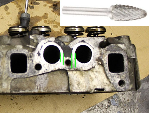

The ports get a cleanup with a flapper wheel on a drill, it just cleans the carbon out and maybe tidies up the casting marks. If I were you I would buy a porting tool ( a cutting burr for alloy) and grind the ports out to match the one-piece gasket sold for K motors first. Just let that diameter blend back into the normal throat size further in. It will match the aftermarket inlet manifolds for carbs like Webers and SUs and probably help inlet flow on the stock carb.

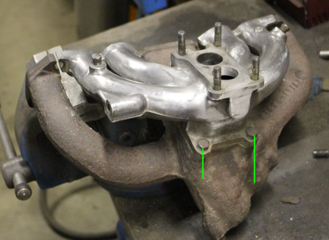

Also- put a straightedge along the manifold faces where they touch the head. If they're not lined up well, try to loosen the 4 bolts holding them together, using lots of "bolt-loosening oil". Don't try too much torque or they will snap, but I have had some come loose and some stay frozen.
If you can bolt the manifold up with them slightly loose the two manifolds will align correctly, then you do up the four bolts. If they are not straight on the head you get the well-known exhaust gasket failure in the middle.
Best idea is to buy extractors and throw the cast ones out, although they usually need some alignment work too!

i took a quick look at the manifold, it looked stright but ill find something 100% stright and test, i'v seen a few of those twisted ones :P my brother got that problem in his Crown...
