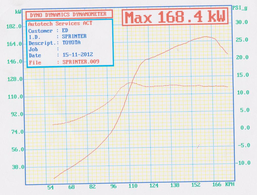

:hammer: Probably should have mentioned that I had all this in an AE86 that I have put into storage for a while. It seemed like a waste letting it sit given the money that has gone into it all so I thought I should use it. ZE block, Ross racing pistons, linished ZE rods, ARP bolts, T28, Denso 590cc injectors and E85. With a T25g and 12 psi it made 168rwkw. It should go over 200 with the bigger turbo and some more boost.

Ok been driving this around for a couple of weeks so put it back on the dyno this arvo to make sure the tune was still happy with a little more boost and the T28 instead of the T25G. The thing did 168kw on the old tune @ 12-13 psi. Today it did 189kw @15-16psi. We didn't bother playing with the ignition or any more boost as it kind of seems pointless given that I use the thing for track not drift. It had a big boost spike when it was coming onto boost at around 3500rpm which resulted in massive loss of traction even in 3rd. I had the back end step out a couple of times when giving it a boot full at around 80km/h which was not fun so I have toned that right down as well. Boost builds slower now to around 15psi by about 3750 and sits steadyish out to redline.
Once I get the in gear boost and traction/launch control sorted I will probably throw in some ID750 injectors and wind up the boost to see how it goes but at the moment it is not bad fun for a 1600.
