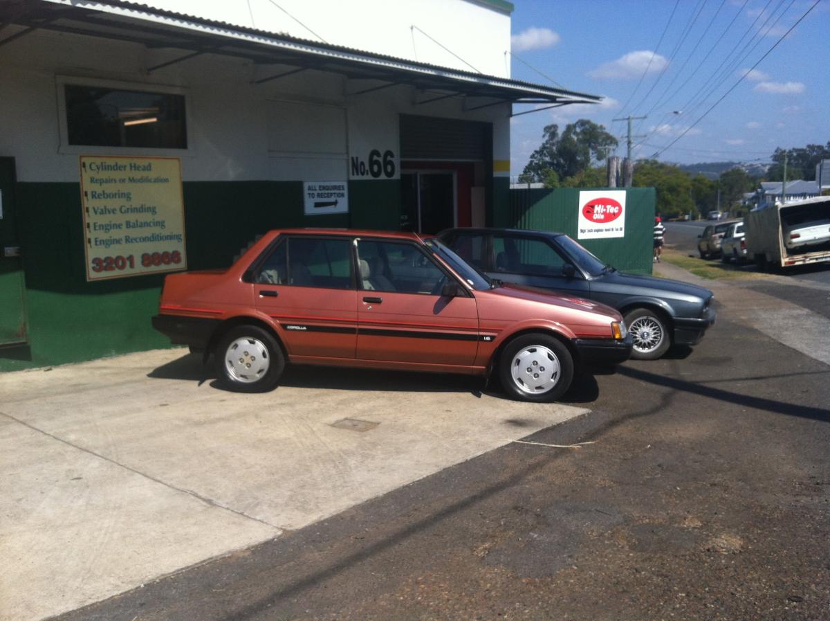

We decided to buy yet another 82, this one being very very tidy for its age.
The rundown:
85 model CSX.
Auto, air, steer.
237000ks.
Engine rebuilt at 18****ks - 10 years ago.

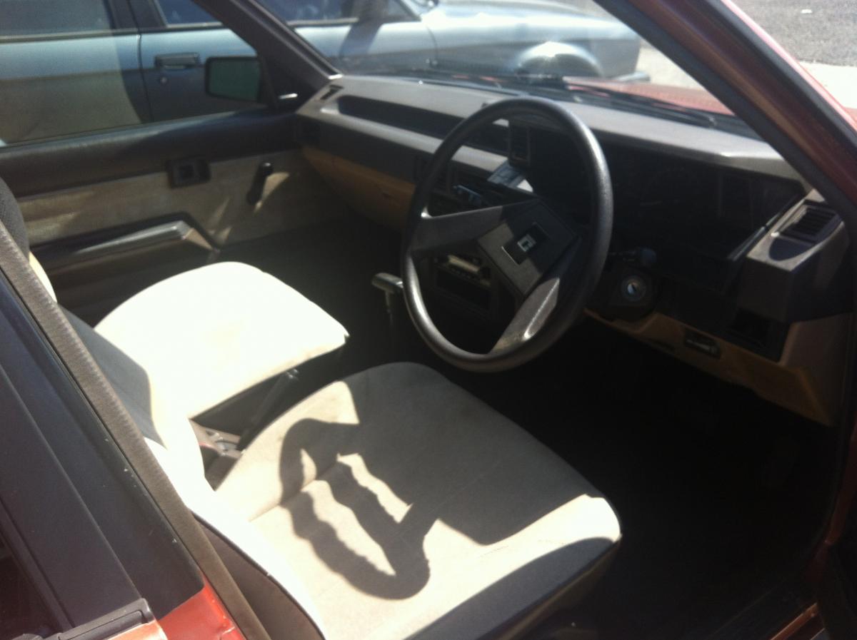

Very clean interior.
New suspension.
New cv shafts.
New rear muffler.
New starter.
New rear wheel cylinders etc.

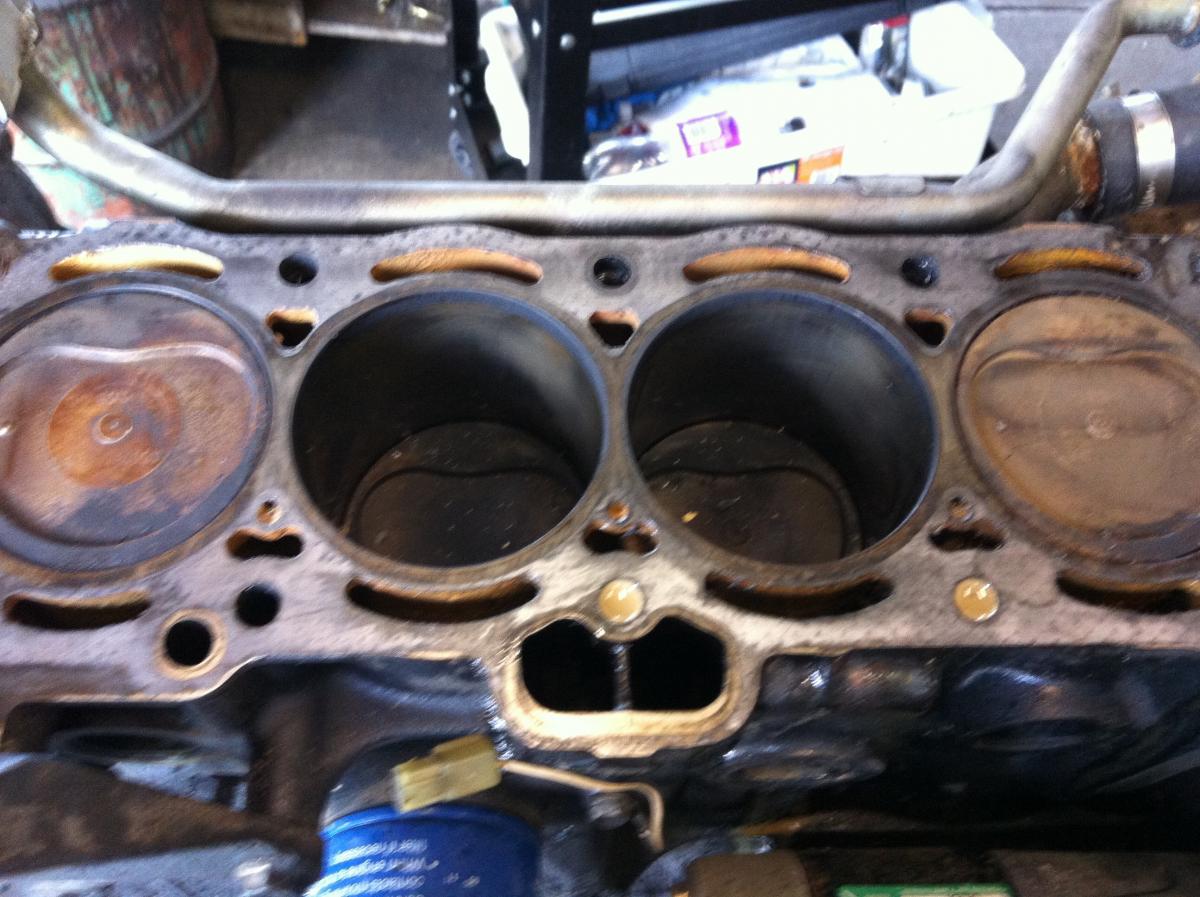

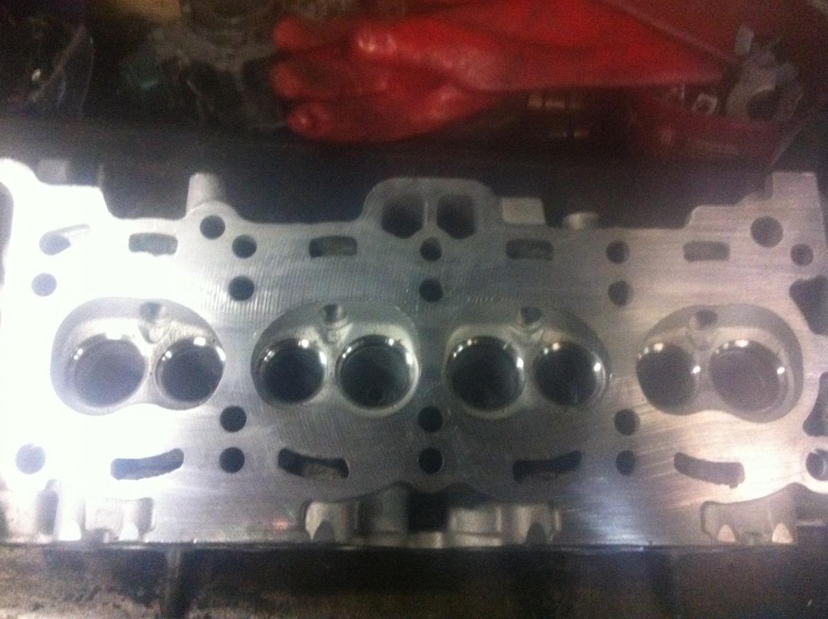

I got it with a blown head gasket and found that the cause is a corroded head that overlapped the firing ring on the cylinder, I have another head here at work so it will be cleaned up and put on.
The pistons are .5 (.020) oversize and the bores and exceptional.

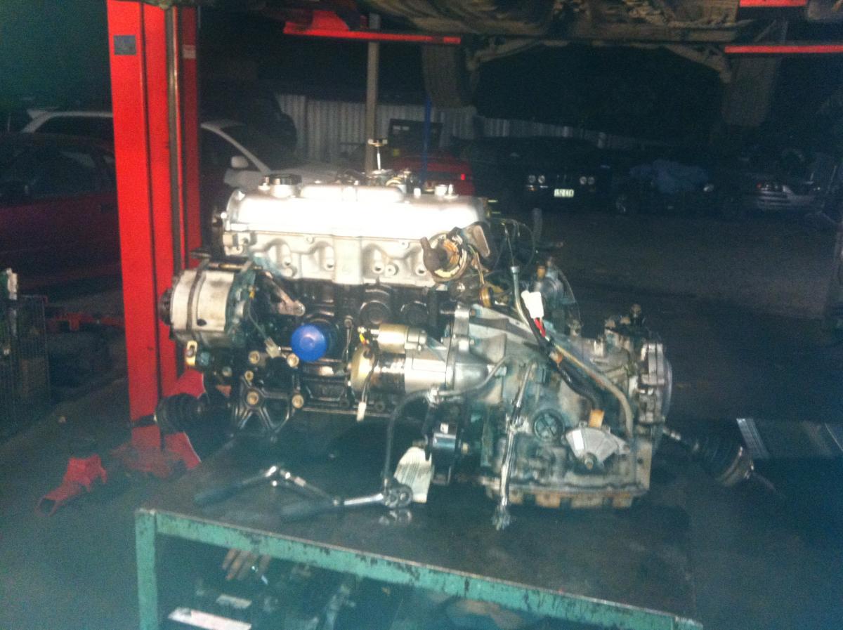

I got all the engine external parts cleaned up and repainted and also flushed out the rad and heater core.
The other head vacuumed up good on all bar 2 valves so I will take them all out and clean them up.
Some more pics.

Did you buy this from Redcliffe by any chance mate?
When i first saw your pic i thought it looked very familiar.....
Yeah I did, you know it?

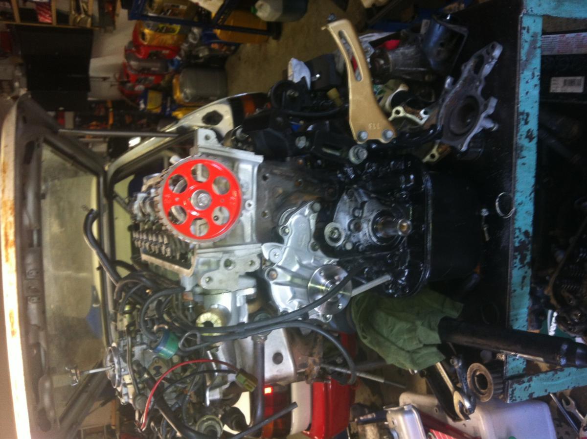

Seats have been cut and the valves faced, now the head just has to be faced.
Yeah mate i just missed out on it at the Scrapyard...:-( Very tidy for its age (very first 5/85 model if i remember correctly) :)
Edited by PHATKE20S
Yeah the guy I got it off said he saved it from the scrap yard as it was too good to go through.

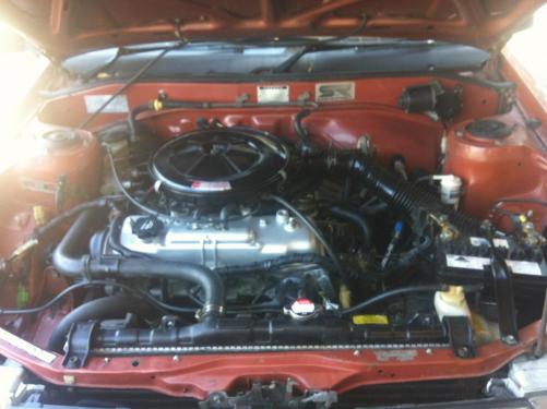

The engine is now in and running, all that is left are tyres and a bar lens and it will have a ready.
