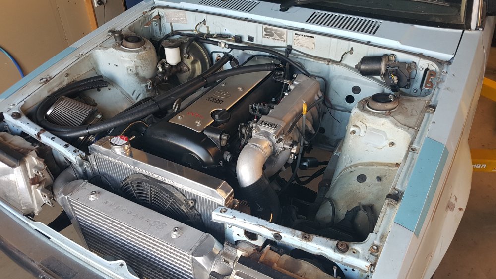

So today i got a chance to strip down the 1jz to get it ready for install and mount making
Also happened to have the scaffolding next to it so i took a birds eye view of it sitting in the bay, really shows you what a monster of an engine it is. My engine crane really struggles with it to.
Edited by Jordanrolla
yeah that was many moons ago, oh the memories indeed.

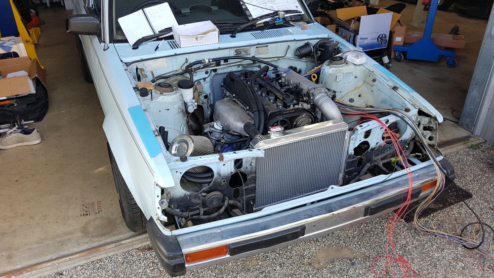

So todays effort,
I wanted to get this bad boy as far back as possible and the tunnel was stopping me. Also the intake being on the opposite side means ill have to make up some custom fuel lines that come out on the other side. This left me with only 1 line left, the brake line. Because I'm going so far back the bellhousing hits nearly all of the start of the tunnel so i had to simply re-bend the brake line to a lower position for when it exits the tunnel. Also did some choppy choppy.
So now i can get all of the engine in the engine bay. Enough room at the back of the engine for water pipes, heater hoses etc.
Now this is one long, heavy ass engine but it is also very low height wise. Managed to fit it without crossmember spacers and i could park a small car in between the strut brace and cam covers!
