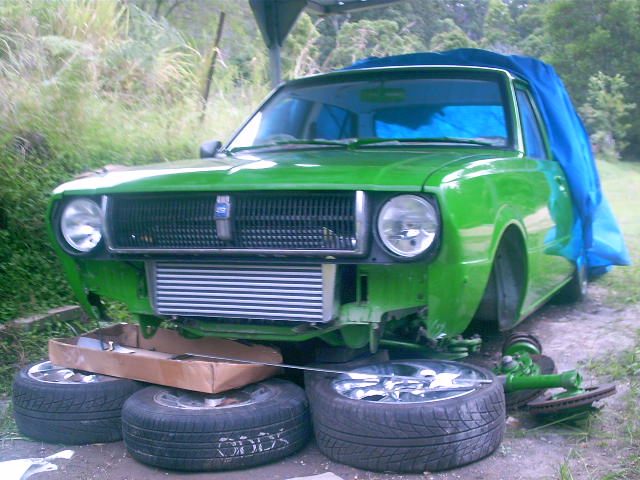

Jus thought id do an update of the progress of the rola,

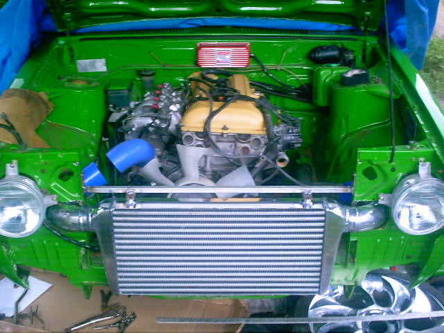

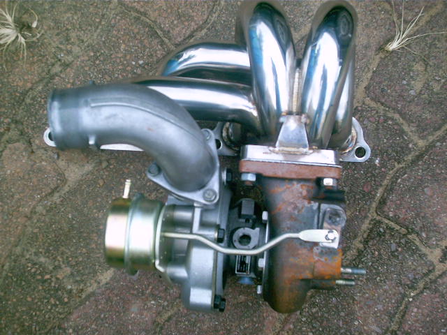

I'm halfway through putting a GT28RS on the non turbo motor, this is a temporary arrangemeny while i do a proper build of the S15 motor i have.
I have all of the pipework finished,ive just gotta get some of it chromed. I also have a set of SARD 550cc injectors that i still have to make a fuel rail for (cosa theyre top feed).Other than that its nearly there, hopefully it will be goin within a month! whoohooo! :D

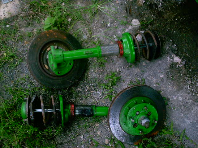

These are my struts with the commodore 300mm rotors and twim piston calipers.

Nice :D that things going to hammer

i agree with Jason - that thing is gonna haul. ass. i mean really haul ass ... 'specially with an s14 sr20det under the hood ... you'll have little competition on the road...
I'm still stickin with the n/a ... I'm pretty keen on goin s14 sr20de ... the turbo would be great, but then there's I/C piping ... and i like my fuel economy for now ...

Thanks guys! I know it is a bit of a risky setup, but what the hell! If she blows i hope i get a bit of fun first, i will keep the boost to about 8 and keep a close watch on the tune, who knows maybe it'll last a year or so.
Good tuning, not huge amounts of boost, driven reasonably well, it should last

VERY intimidating front end on that Midori Motorsport vehicle of yours ;)
The other thing the SR20DEs don't have is oil squirters. So your pistons cook if youre running high-ish boost. Id be limiting myself to 12psi absolute TOPS...but thats just me.
My advice with the S14 SR20DET is... ditch it and get a red top SR20. Not trying to be biased or anything (if they honestly made more power, Id use one) The manifolds (and to an extent the ports) on the later motors are shit and the low mount, high port setup of the redtops flow better. I do know of a guy making 546 WHEEL horsepower with the stock redtop manifold. They flow that good!! The VCT can be troublesome too. There was a problem with oil pressure not getting up to the actuator quick enough and a rattling noise developing. Nissan have a fix for it, but thats more money. The extra power S14 motors make standard is simply a larger turbo (T28 vs T25G) and a bit of VCT.
Should go like hell.... *runs off to strip 200kg from the silvia*

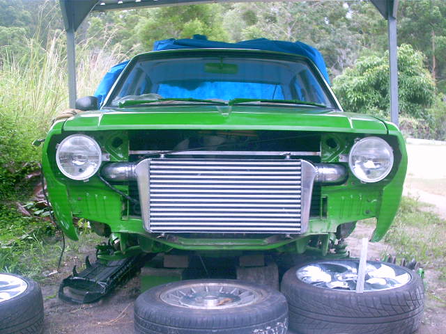

it will fun for you watching everyone do a double take in their rear view mirror when you come up behind them. front end looks very cool with the cooler and grill over the top!

is that a ke55 grill by any chance ?? looks like it to me ...
Dyzza
It's definately a KE55 grill, and it's yucky...and as Nick would say, KE55 grills in KE30s make baby jesus cry
I think Ive got one of those style, but KE30, grilles under the house. Needs a bit of glue...but not in any visable areas from memory.
