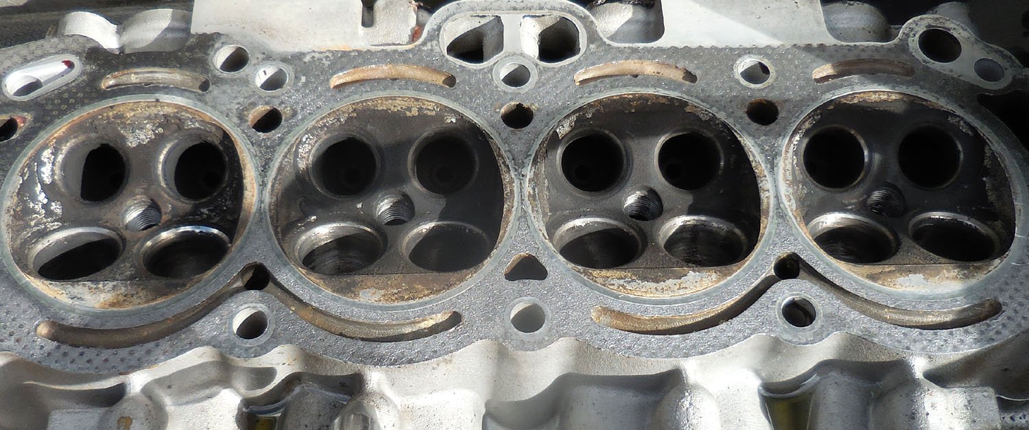

I'd been working on the blue car on and off when I got time, the lack of compression meant a full head job, and it only got assembled completely two days back... and didn't run! Don't talk to me about 4AGE igniters, I'm quite allergic to them just now!  I'll update The Girls KE70 after this.

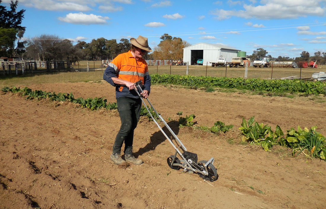

Anyway, another new toy was a seeding machine. The old ones have a horizontal disc full of various sized holes so you can select the hole for a vege seed and a rotating brush slides the seeds over the hole. this put out the seeds too close together, so Steve ponied up over $300 for a better system. I haven't got a photo of it before I extended the handles so it could be used by an adult.
The handles only join the chassis through two miserable rivets, and it was flexing all over the place until I put a couple of diagonals in down to the back wheel.  It has a vertical disc with cups that pick up a seed and drops it out through the wall to be planted, and you can tape over some holes to sort out the distance between plants. There are 6 discs for different sized seeds.
Then we found as you push the force goes through the back wheel and lifts the front wheel off, so more mods were needed-
Now it seems fine, and it planted a few thousand peas and beetroot yesterday.

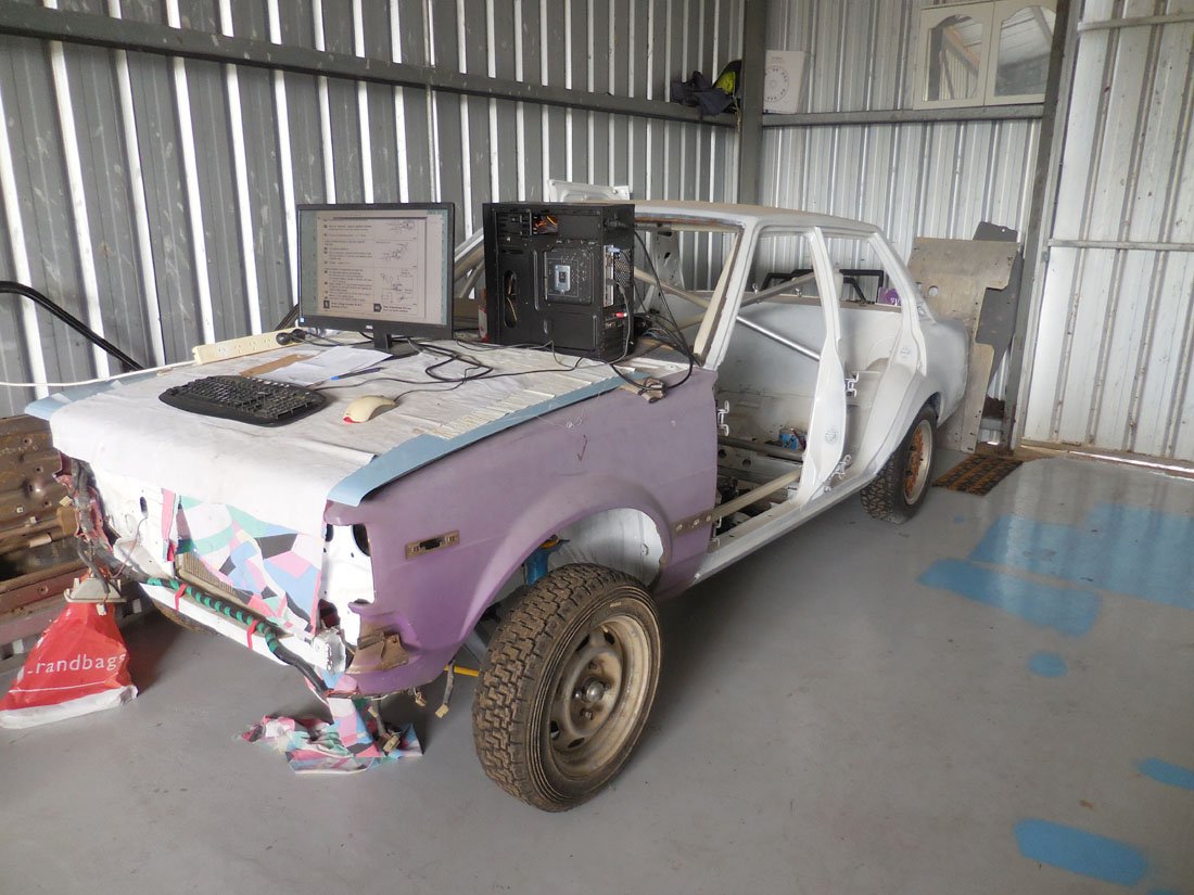

"A rally car" you ask?  Ah, a desk for my desktop computer so I can read Parrots 4AGE manual while fixing the Girls KE70 in the workshop!  Next trip!! I promise!
