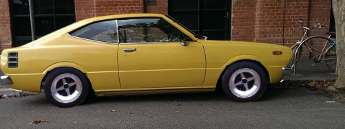

Really, they fit spencers car without spacers with pretty much the same calipers I'm pretty sure. Ebay for spacers, I got 8mm ones delivered for $25.
