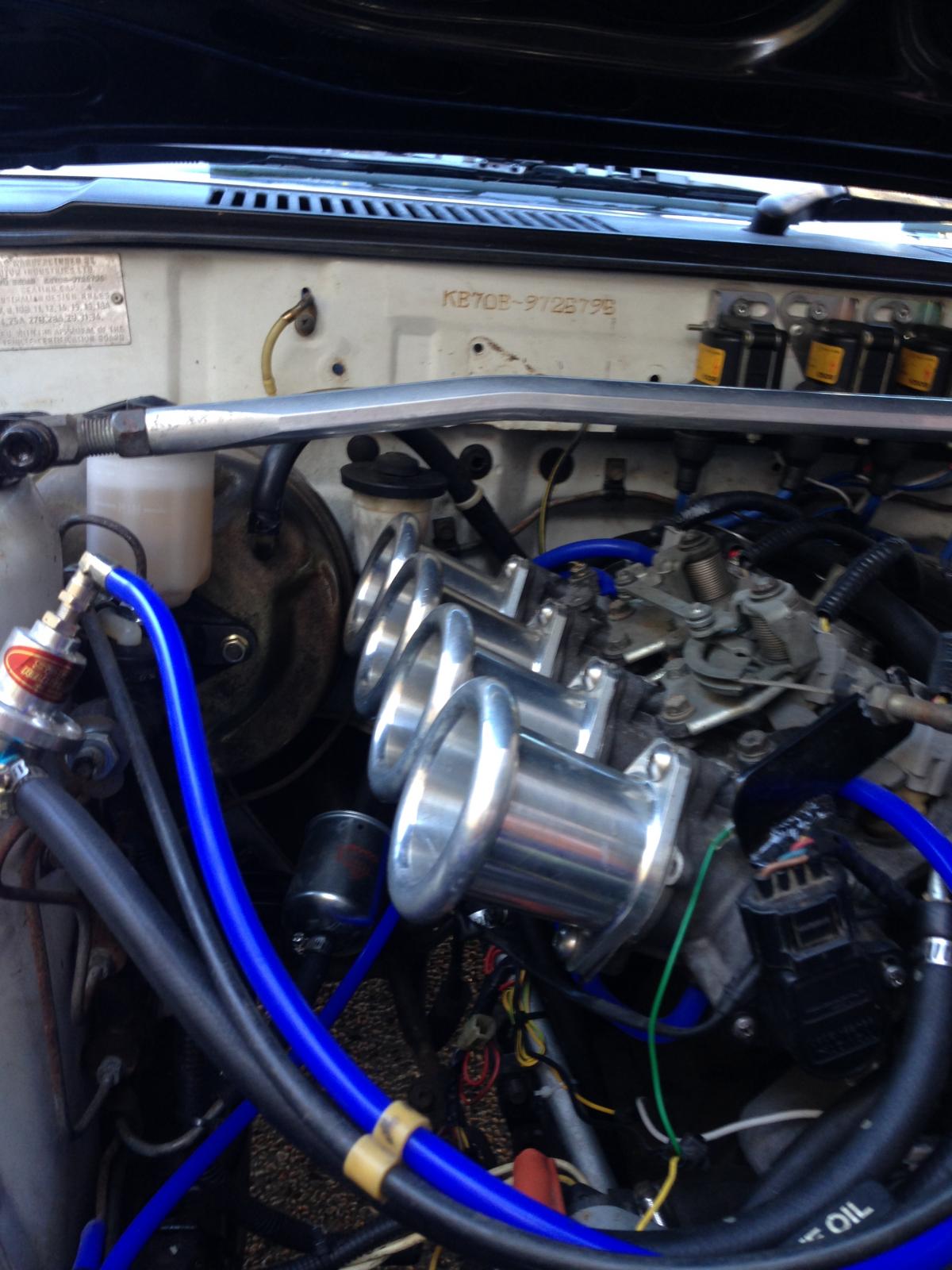

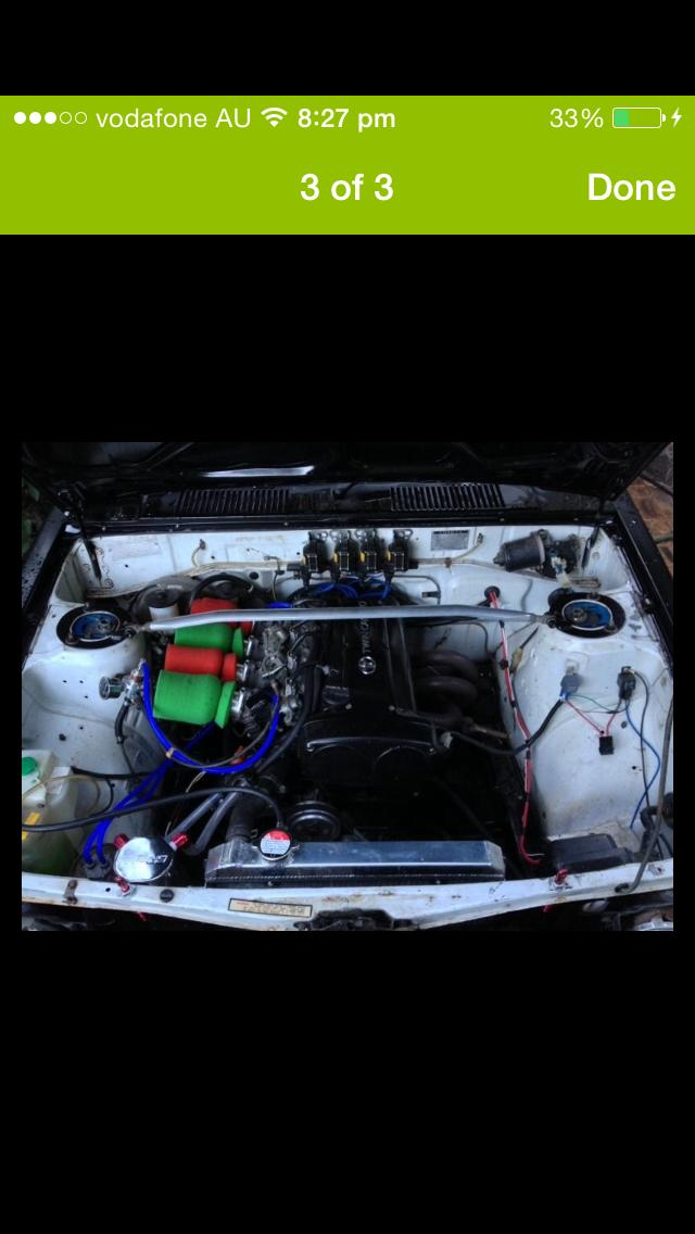

Hi there people my name is Dustin (Dskew3) i have just bought a 1982 Ke70 with a 4AGE 20V conversion. at the moment i am booked in to get a tune and a roadworthy so it should be on the road very soon. here's a list of what it has got
4AGE 20v
quad throttle body's
sard fuel regulator
extractors
2 1/2 exhaust with cat and a cannon (soon to be removed as i don't like cannons)
micro tech LT10-S ecu with hand control
Bosch coil packs
T50 gearbox with short shifter and HD exceedy clutch
front strut brace
AE86 front and rear conversion JDM disc brake in the rear with a 2 way LSD
front coil overs with camber toppers
lowered rear springs and new shocks
3 core alloy radiator with thermo fan
15x8 steelies
huge front sway bar
battery in the boot

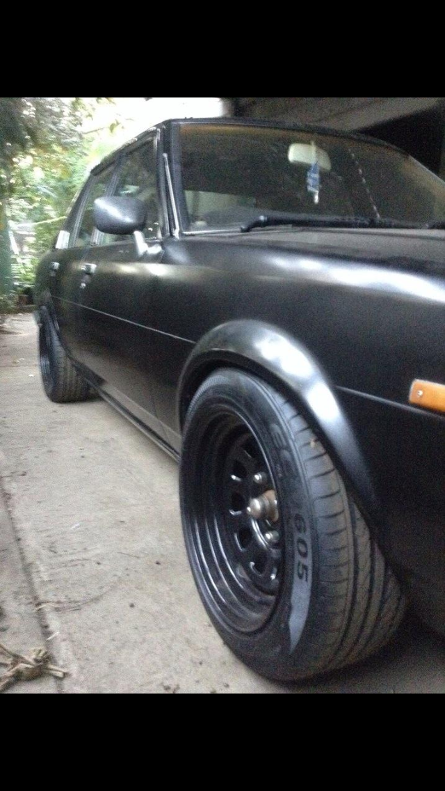

hay all the readers out there bit of an update got the roadworthy all done just had to replace the front brake hoses, there not cheap cost about $200 for all the hoses as its a AE86 front-end there is 2 hoses to each side. Also had to put on some shitty 13's for it to pass cause the 15,s where to big and scrubbing but other then that all was good. it needed a tune as well its making 97.5HP at the rear wheels not sure what standard silver top 4AGE 20V makes.

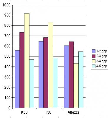

not sure how much you are investing in the transmission.... one solution(in use in my AE71)... a LEEN modified J160 6 speed... LEEN takes the Toyota J160 6 speeds from Altezza's, and Lexus IS200's, and makes an enclosing front adapter that will accept a T50 bellhousing...
here is the modified J160 with the front adapter mounted, and the relocated shifter to fit directly into the stock T50 shifter hole in the floor
In my car... I decided to modify the floor - extending the shifter opening rearward, and in so doing improve the shifter positioning...
^Cool piece of kit, pity you're restricted to clutch size with a T50 bell. Do they make them to suit W series bellhousings? Then you could run a Niteparts or similar bell with GZE clutch.
Pity????? Why a pity?? I'm running 212mm stock clutch w/blacktop flywheel on my 145whp(170hp@ the crank) smallport... and I don't have any clutch problems...... His Silvertop uses the same diameter flywheel. The original kit was developed for a 4AGZE powered AE86...... full artilce in link below photo
