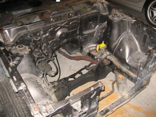

Got the engine/box and shaft out.
My mate could't fit his crane in his van so we lifted it out by hand - luckily he's a massive Samoan - SHOT TJ!! :thumbsup:

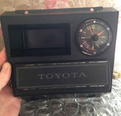

Currently in transit from Japan (Sorry to any Rollaclub members who may have been bidding on these)
SUPER RARE under grill and bonnet trim!! :party: and a Clock for my (still to be located) centre console!!
post-20590-0-13444100-1416016839_thumb.jpegpost-20590-0-90696300-1416016844_thumb.jpeg

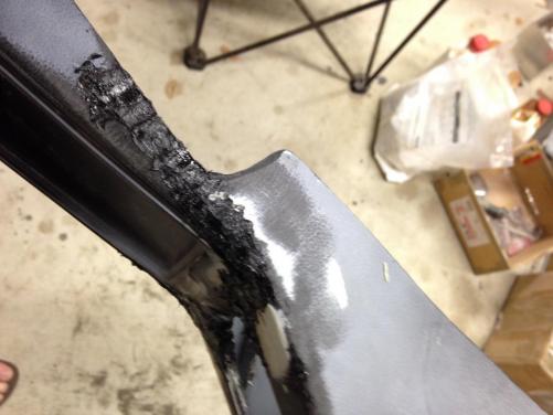

So I figured I'd have a go at plastic repairs over the holidays.
My centre console was completely cracked in two so I had nothing to lose with having a go.
I bevelled the edges, primed it and used a special glue to hold the back together, with the plan to then fill in the surface........but that didn't work, and the bonding failed......so I just used a soldering iron and some spare bits of plastic from other parts and 'welded' it together with that
Sanded it back and it look's really good.......will just fine fill it and paint it at a later date

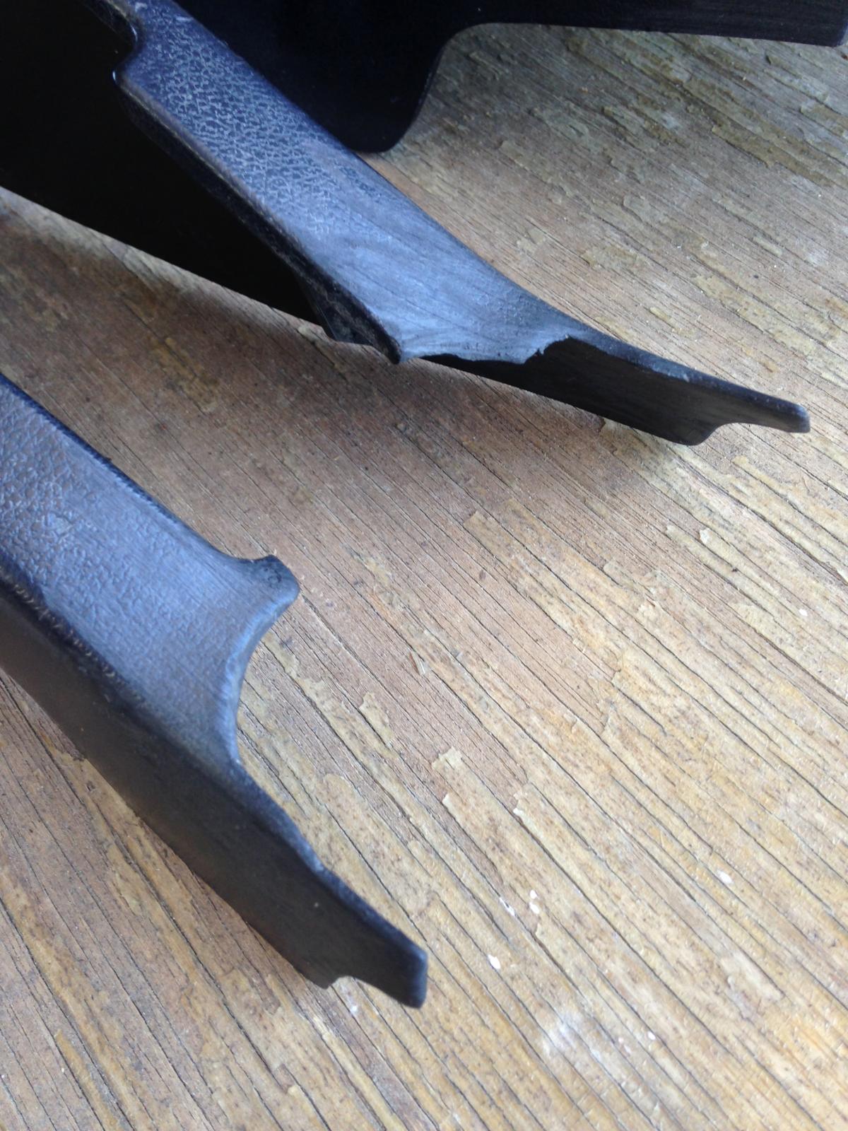

My TE27 centre console had the top tabs missing so I took a few of some other standard consoles I had, tacked them on with loctite, and then welded them up. All ready to go.
Same with the under dash console light. Cut a new bit to shape, welded it in and it's all sanded back and ready for paint one day,
post-20590-0-70108100-1421053281_thumb.jpgpost-20590-0-36109500-1421053310_thumb.jpgpost-20590-0-83949400-1421053332_thumb.jpg

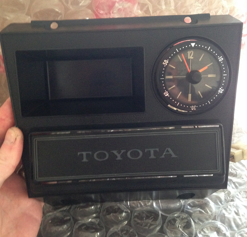

Centre console in great condition with original radio plate still in place has arrived...
