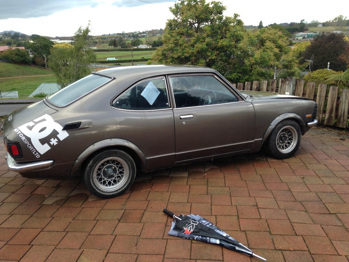

Finally, I have got a 1974 KE25 I found in Christchurch, NZ. I probably paid a bit too much for her, but I wasn't going to miss out on another so was happy to secure her without paying NZ $10k for one already done up.

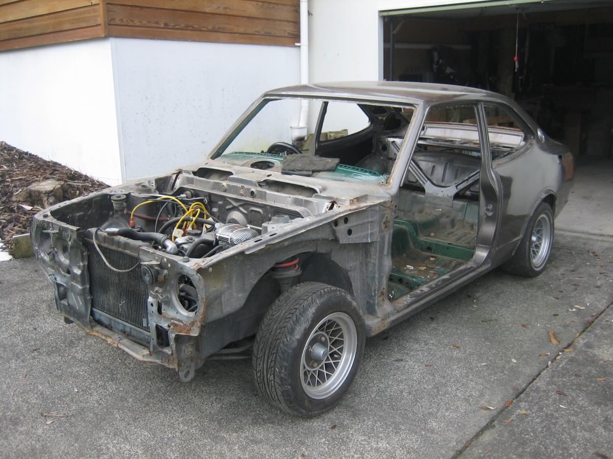

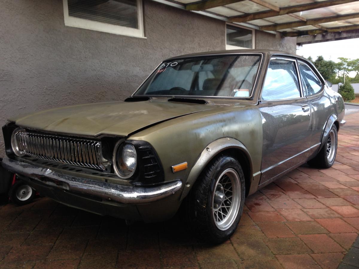

Here she is when I got her shipped to my folks house......
post-20590-0-78698100-1409467474_thumb.jpg post-20590-0-64723000-1409467497_thumb.jpg
She's 90% complete but needs a LOT of work.

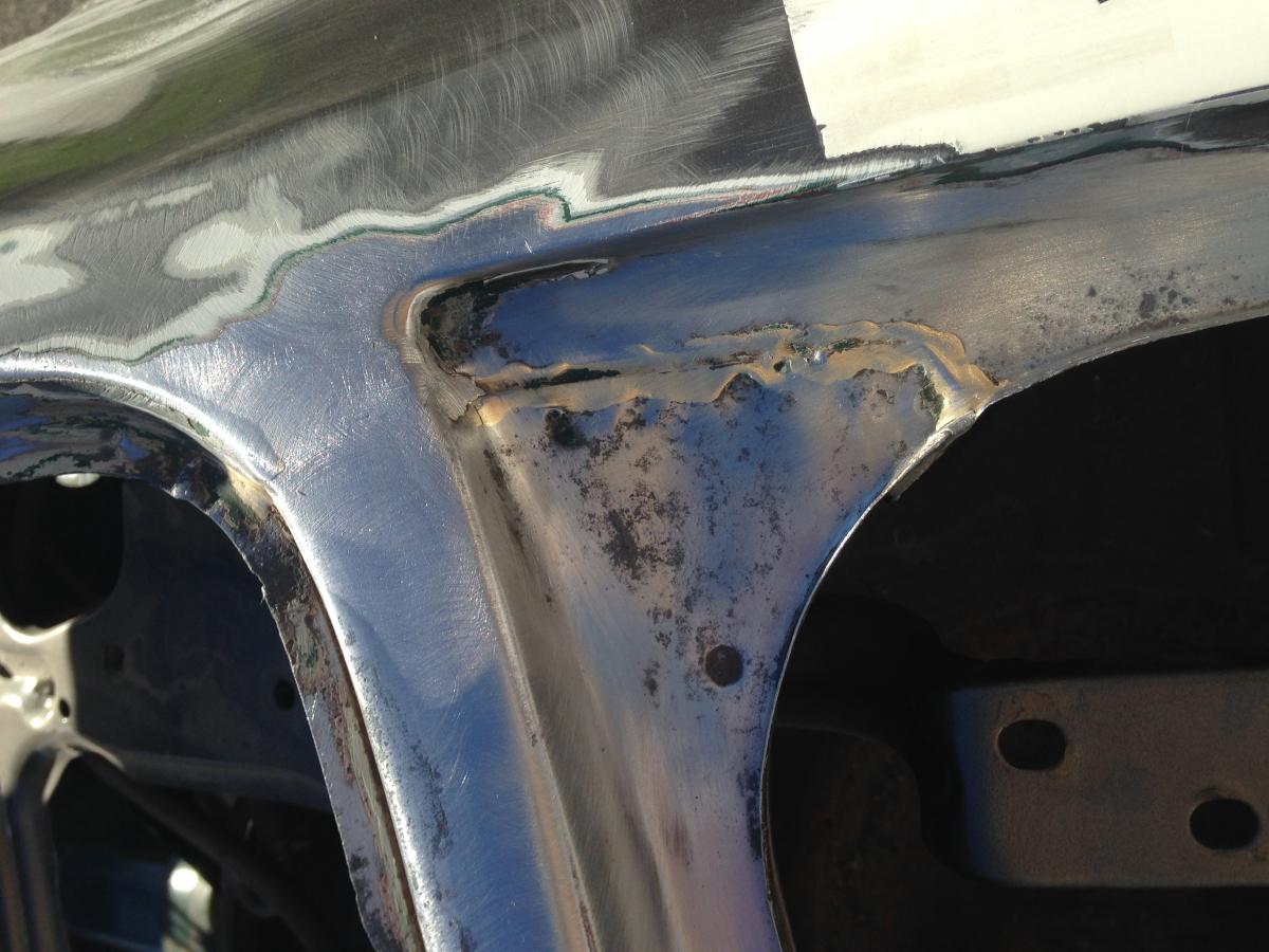

  • Long time no post.......2 business's and 2 small kids and buying the house will do that to your time and $$.....but....... KABLAM!!!!!! I've spent a bit of time working on my other Toyot
  • Few good updates.....My rear panel arrived and it looks like it's been a newish panel stitched on to a rustier car. It's been hacked off the back of the donor so thankfully all those rusty bits like t

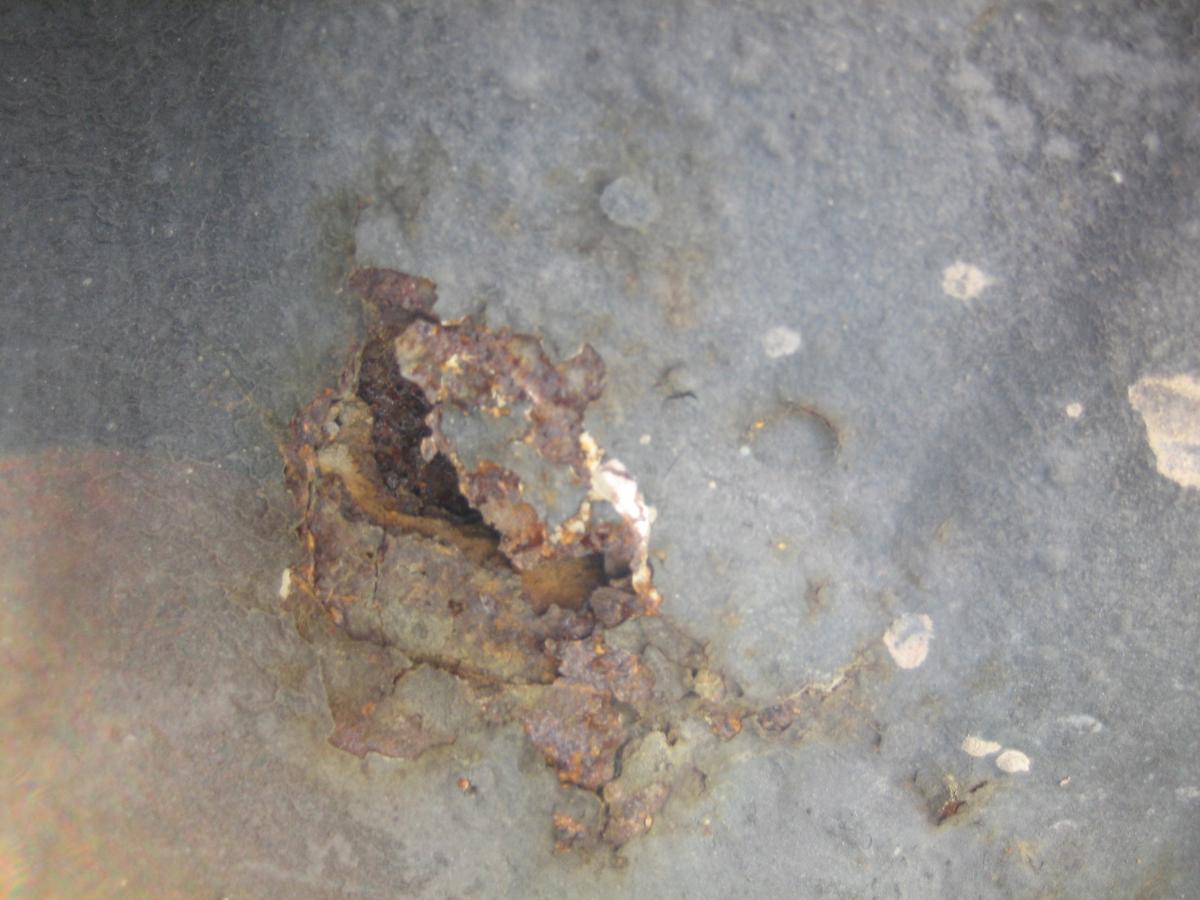

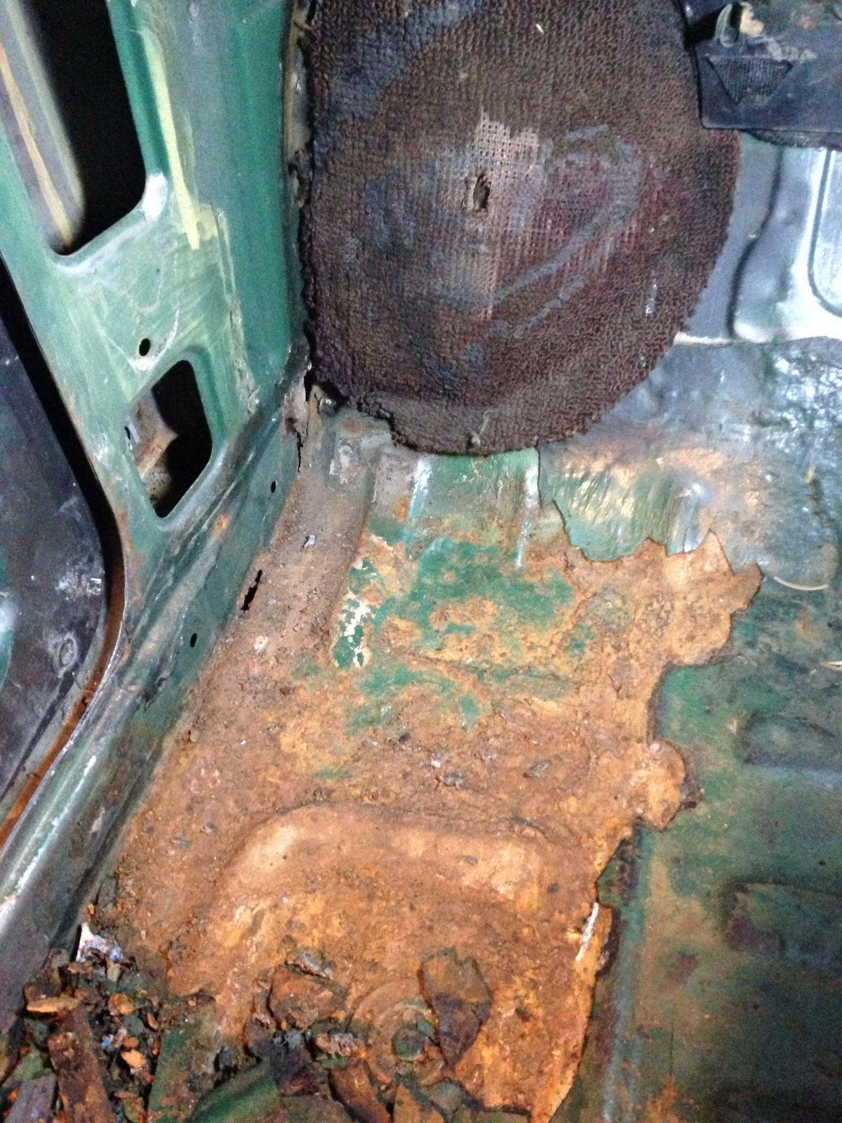

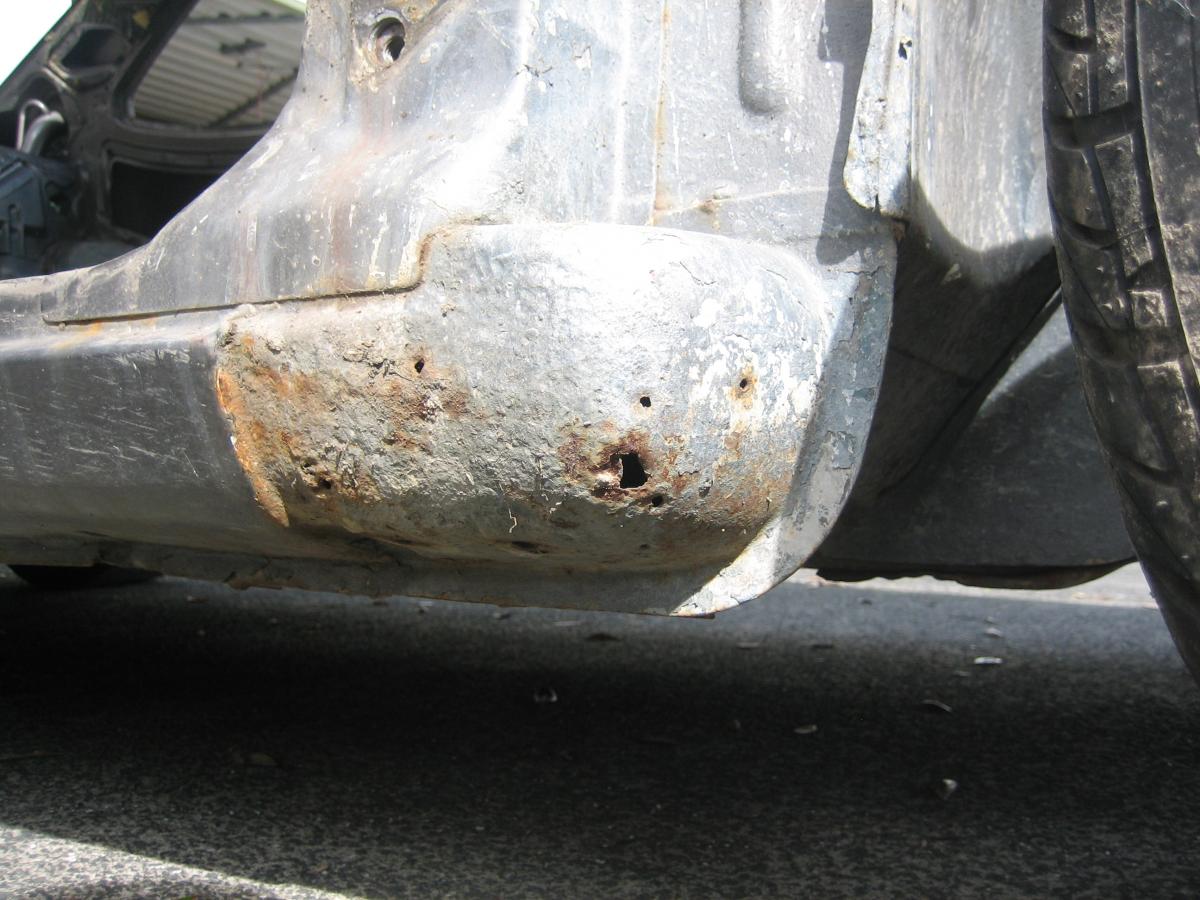

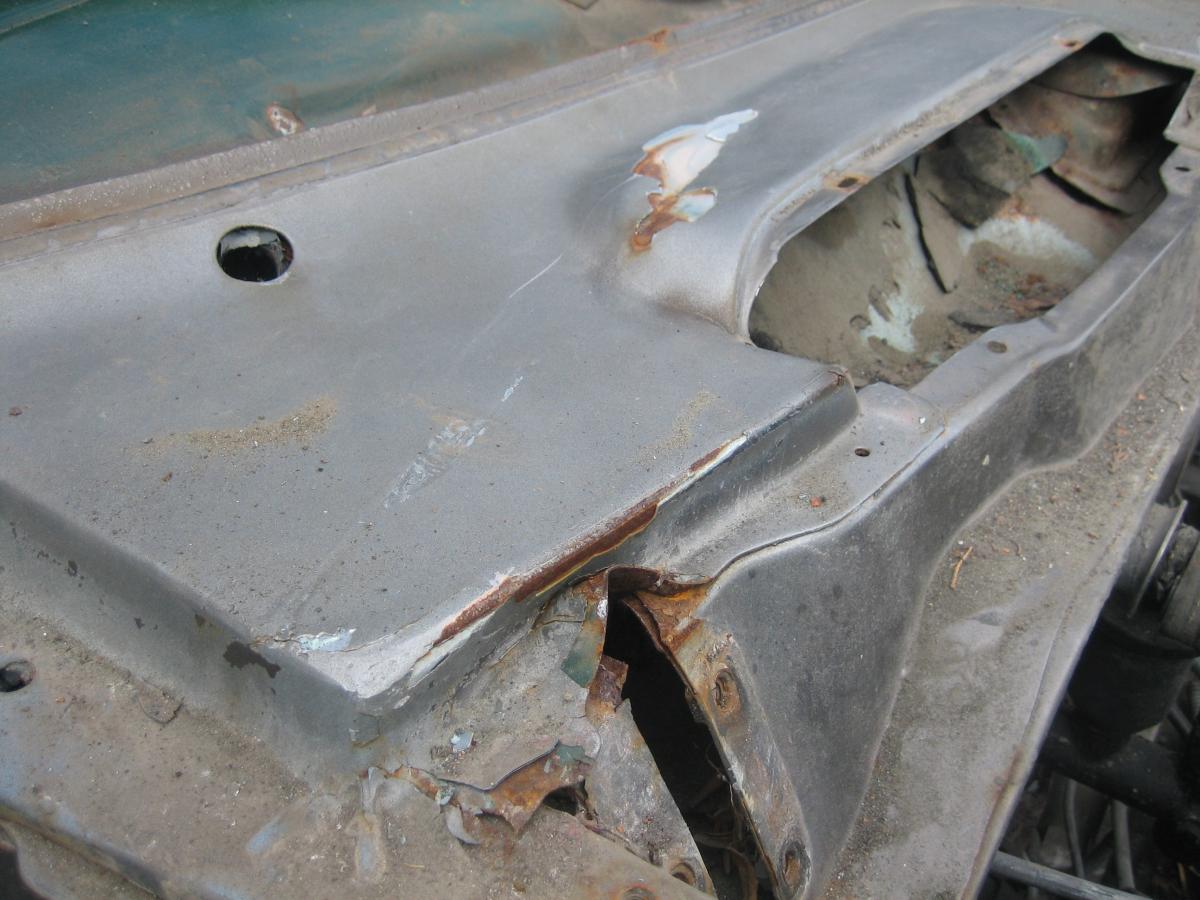

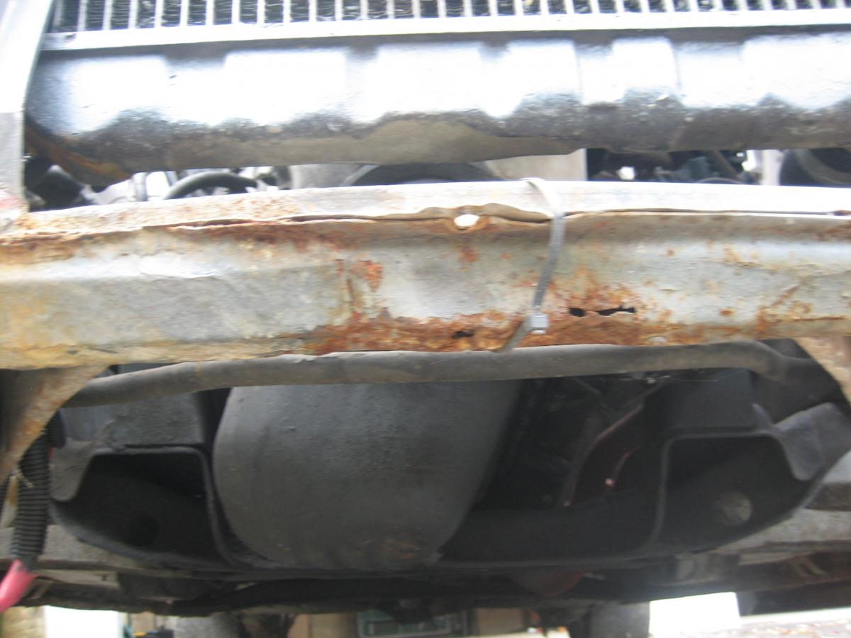

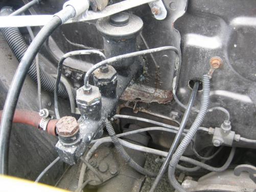

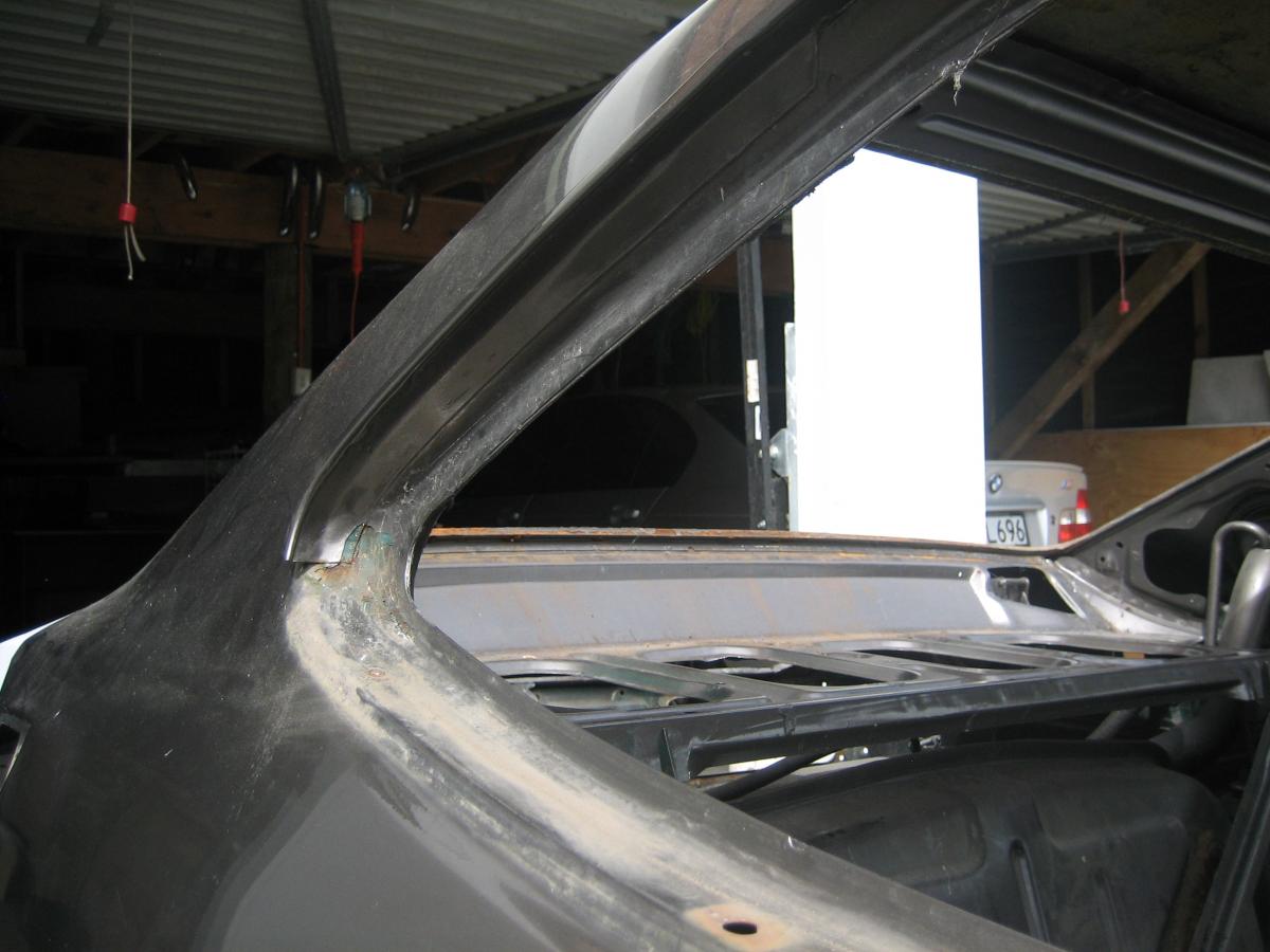

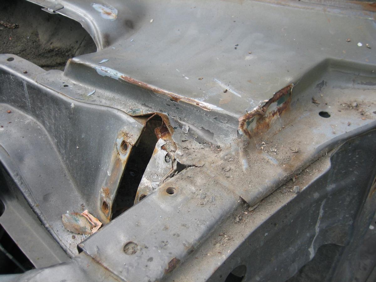

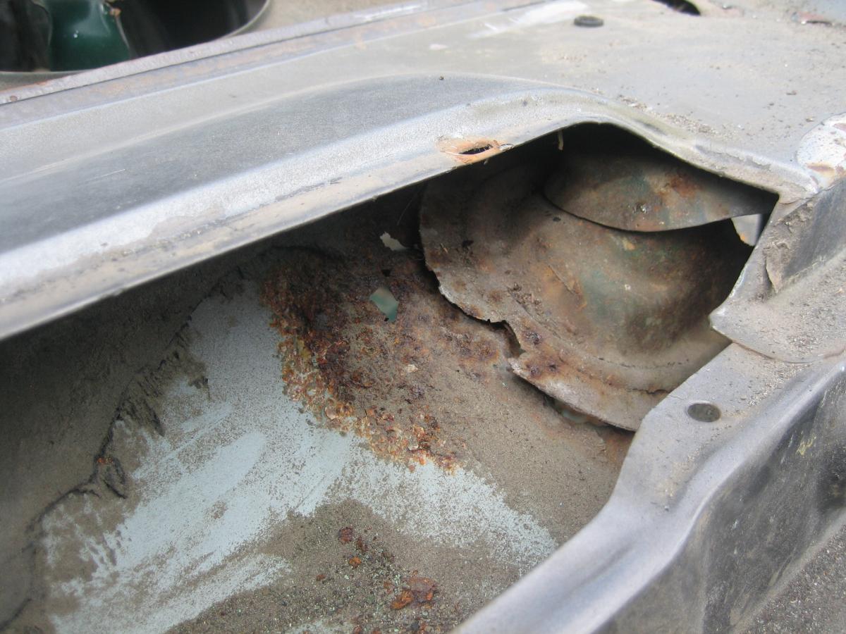

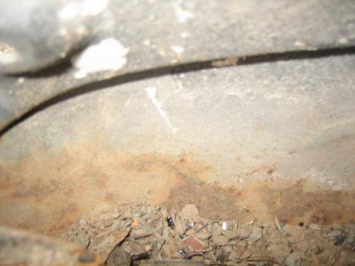

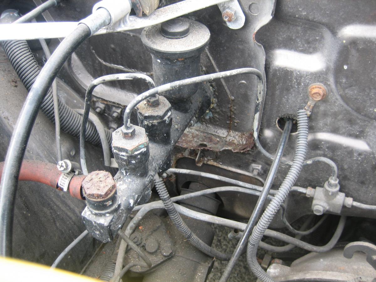

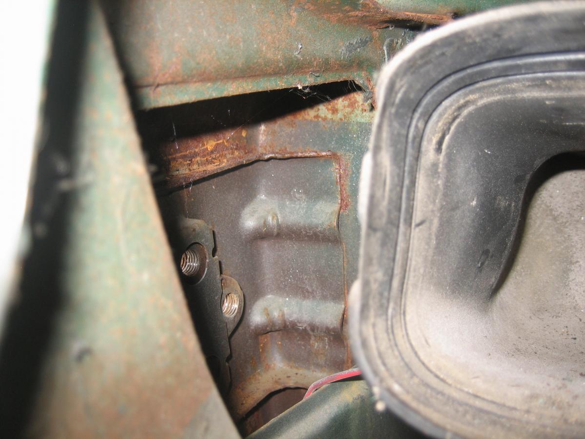

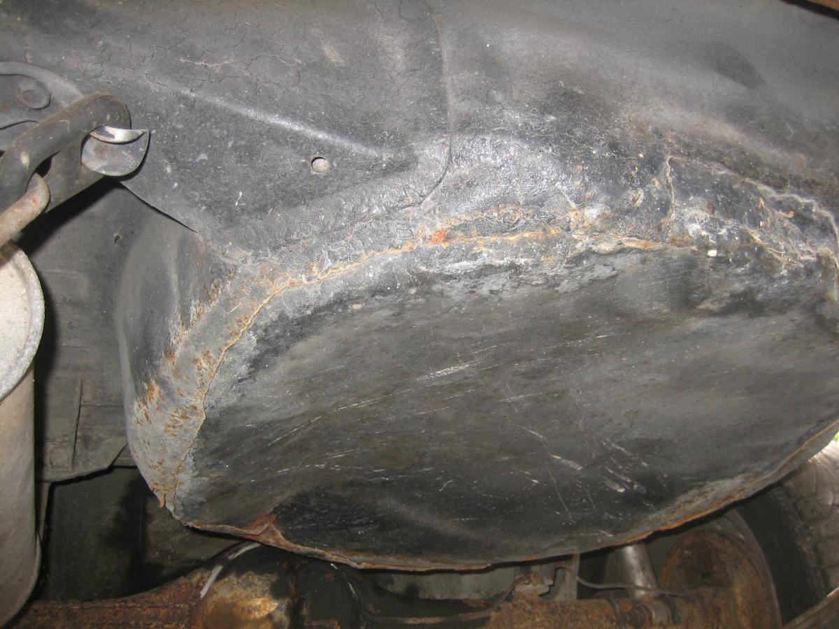

Well I've managed to strip her down a fair bit and have a closer look at what I have to deal with........

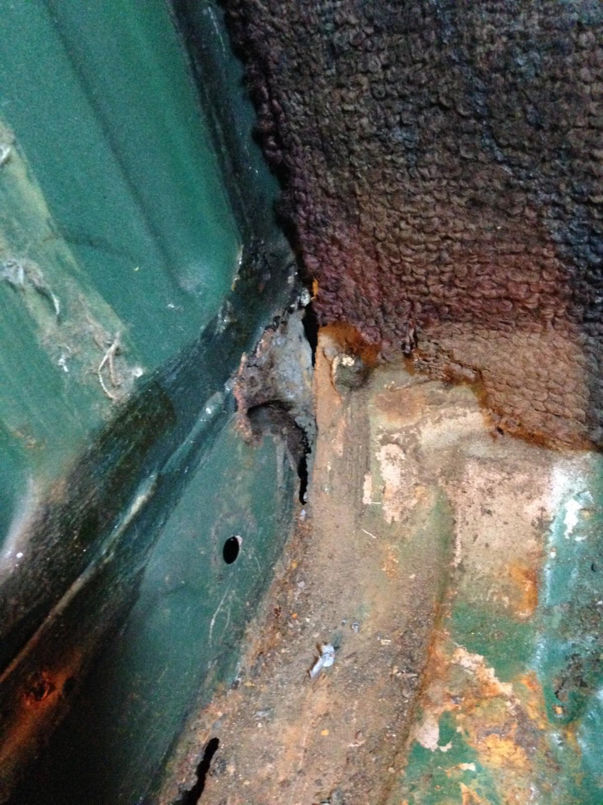

there's a fair bit of rust.....
and in some pretty hard to get to spots......
At some point the bonnet had flown up and munted the hinge brackets and the cowel panel......
there's surface rust down in the usual spots but no major holes
post-20590-0-79972800-1410081722_thumb.jpgpost-20590-0-51778100-1410081886_thumb.jpgpost-20590-0-65256100-1410083332_thumb.jpg

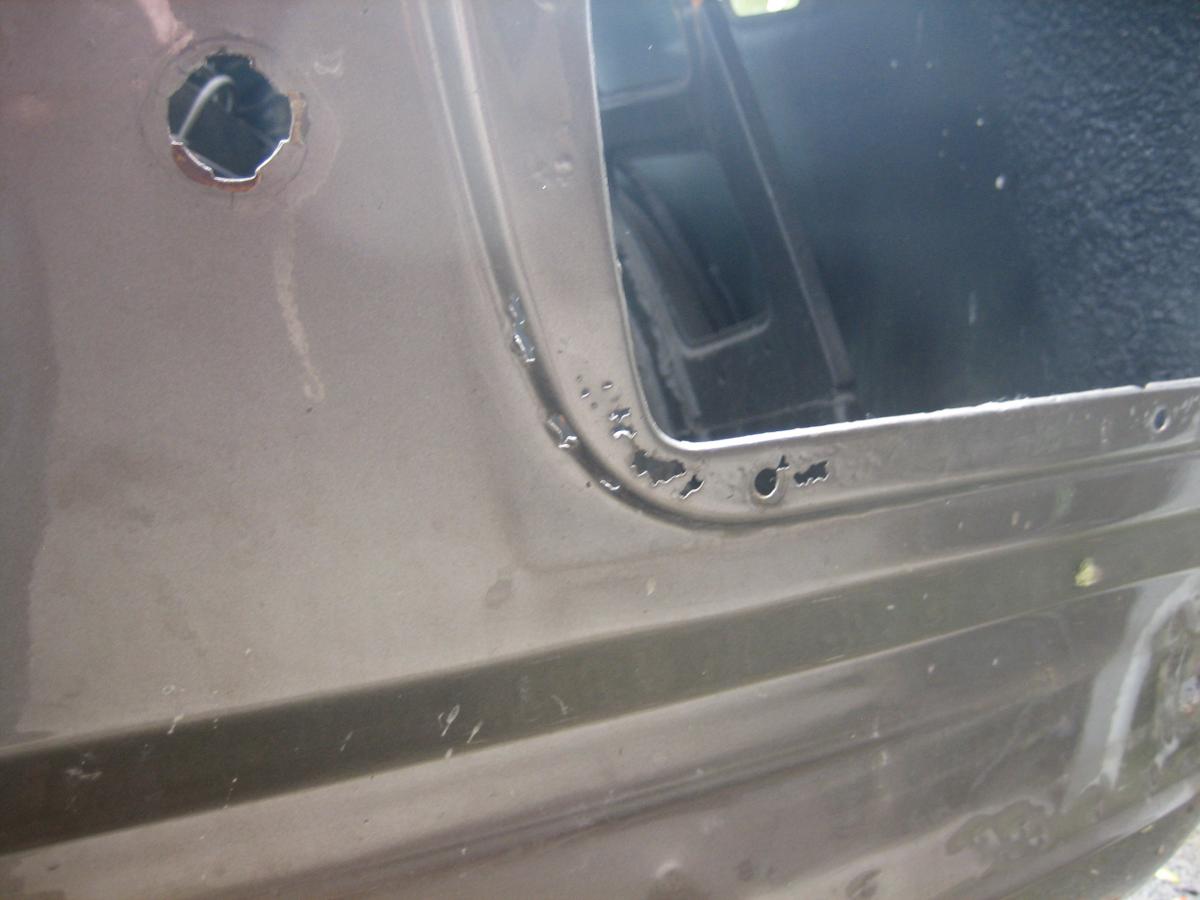

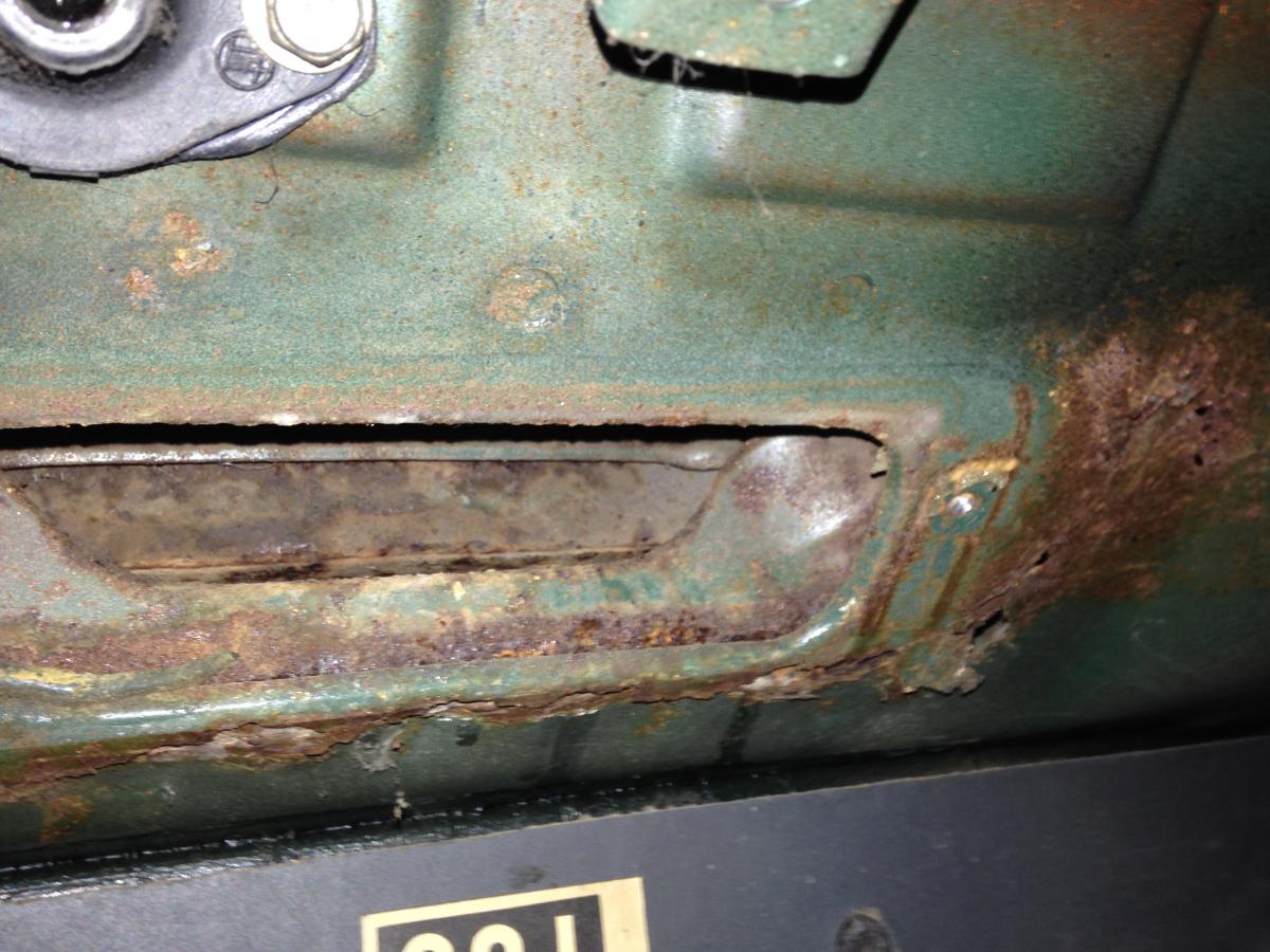

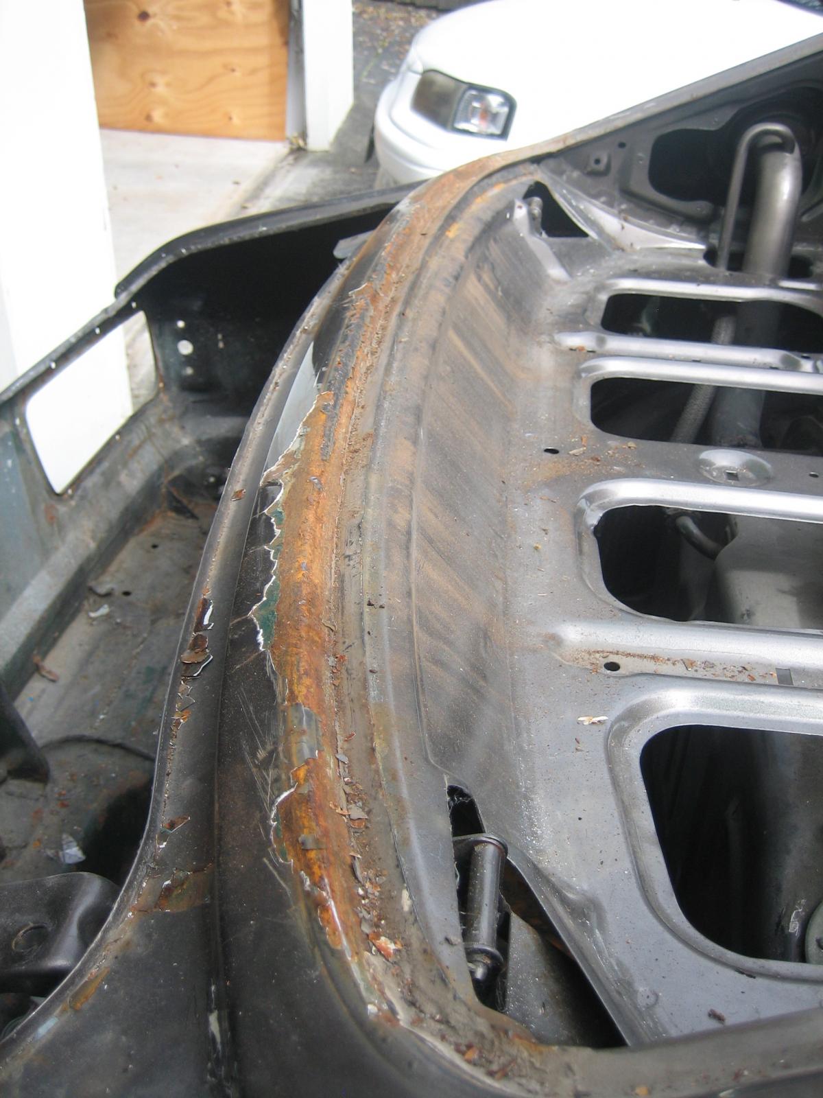

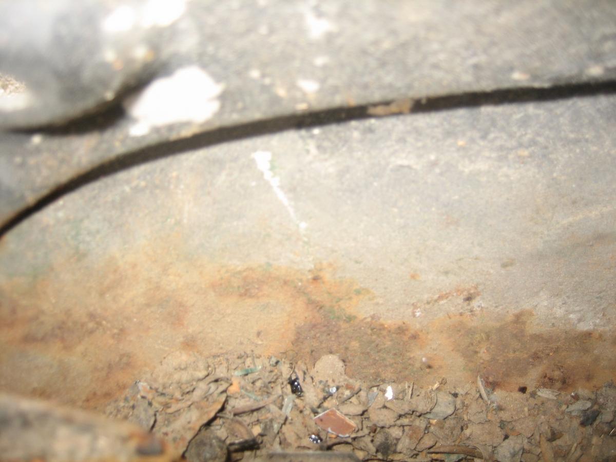

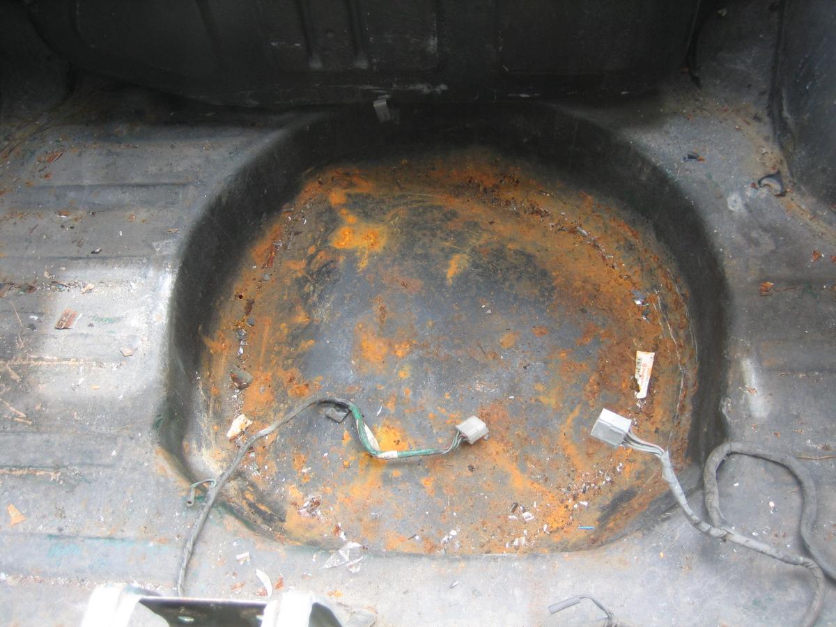

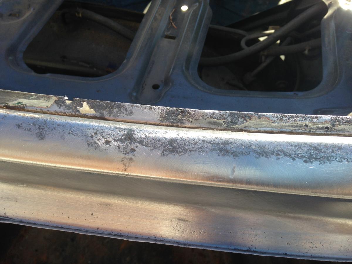

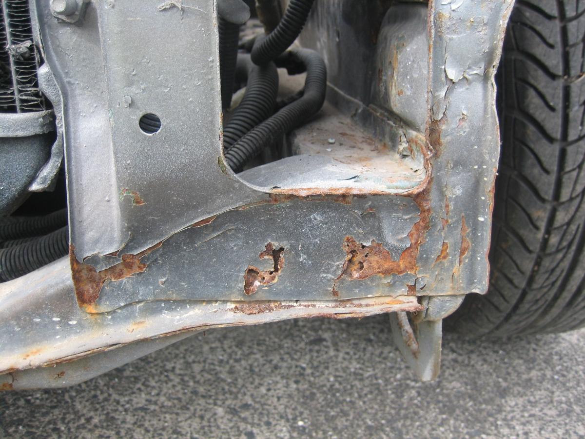

I stripped back above the boot and found some embedded rust.....and then quickly covered it up with primer till I can figure out what to do with it
post-20590-0-99512100-1410080963_thumb.jpgpost-20590-0-30710500-1410080988_thumb.jpgpost-20590-0-42091300-1410081014_thumb.jpgpost-20590-0-45372500-1410081044_thumb.jpg

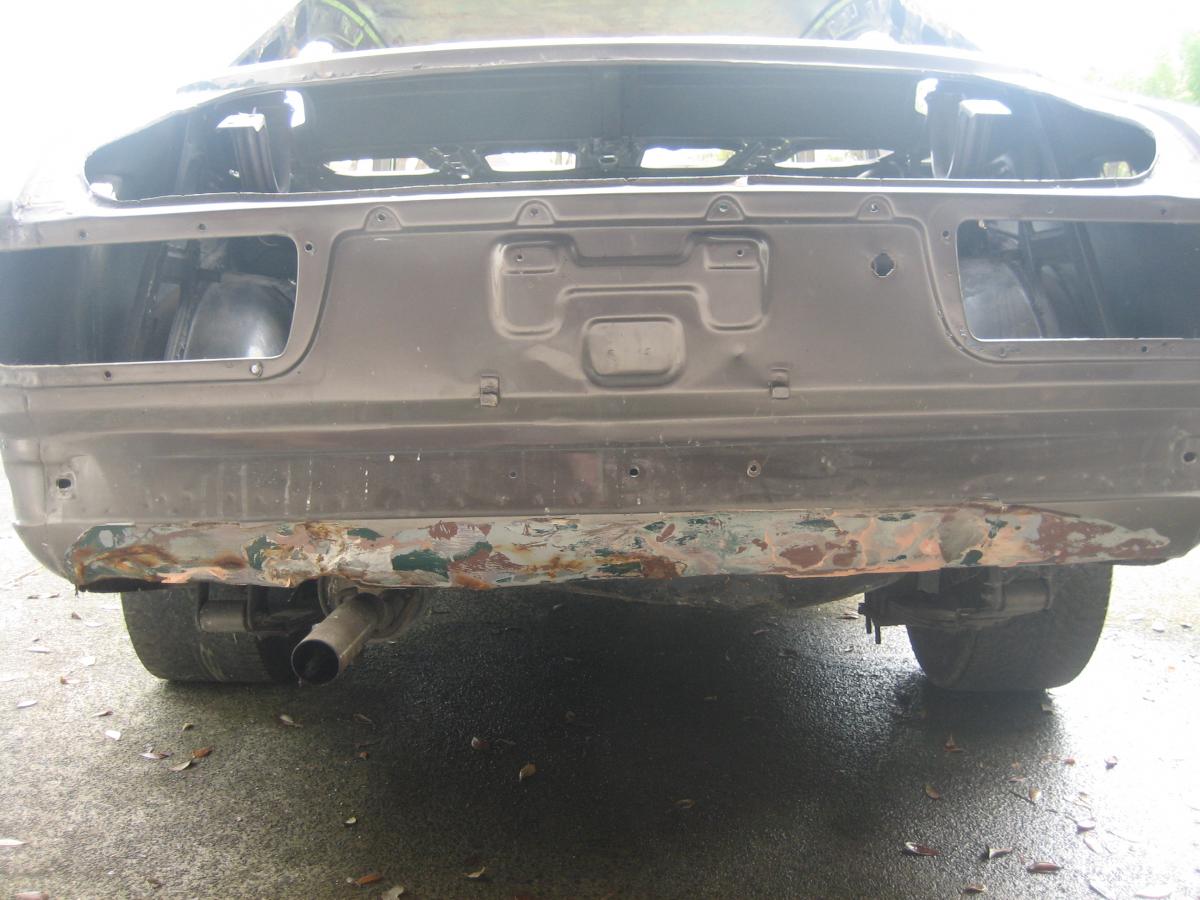

Thankfully my doors are in great condition, the boot has a few big holes, one fender is brand new (score), the other needs the bottom replaced, may need a new bonnet though.
It's a bit overwhelming for a noob like me to see all this rust, but I've seen worse repaired on some of the posts on the site so I am taking confidence from that :)

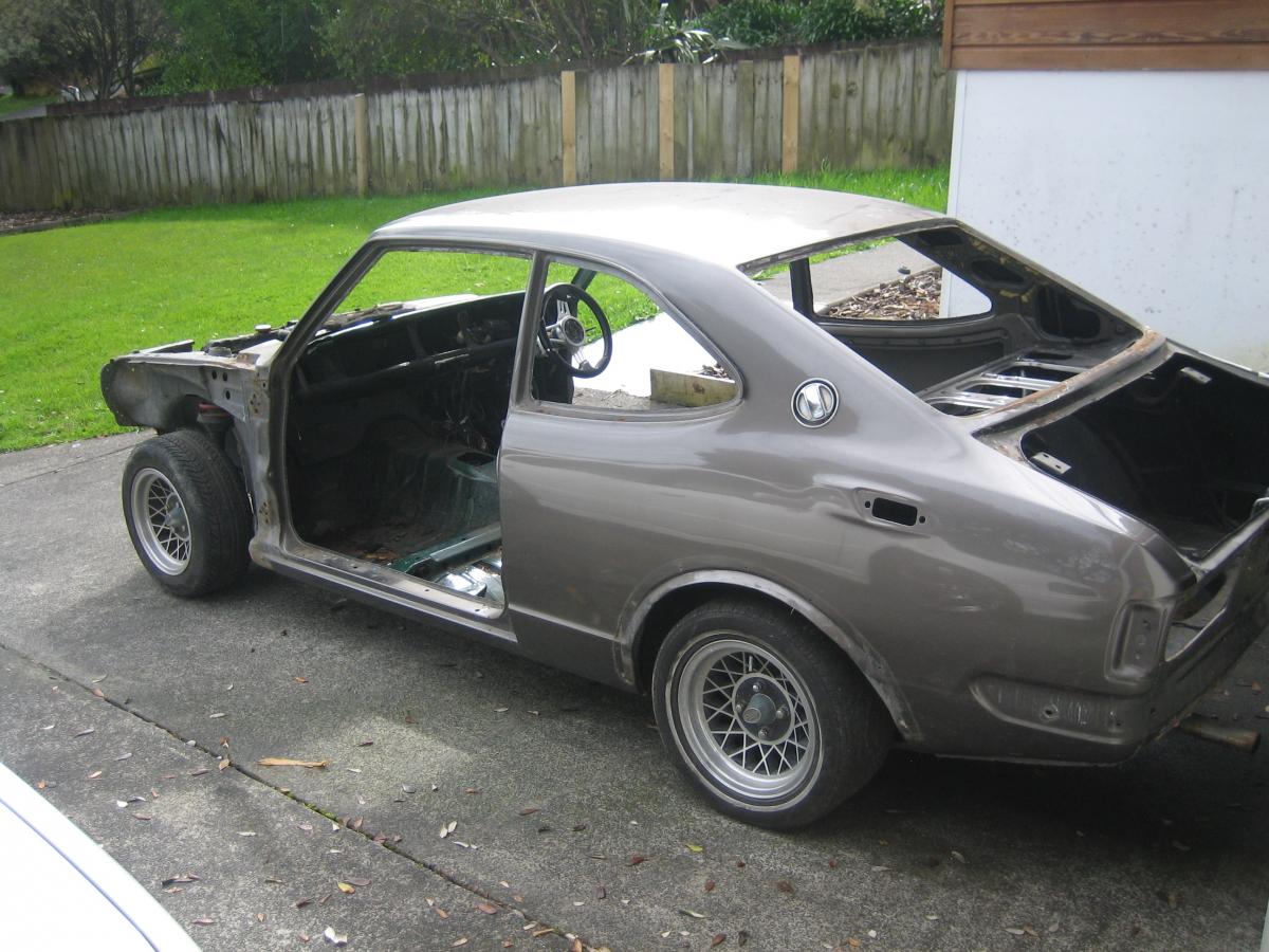

I work for Smith & Smith as an autoglazier and have met a good panelbeater who's into Corolla's who's going to come have a look at her and give me some help/advice......maybe teach me to weld. Once he's given me his diagnosis the plan is to remove the engine etc, hit it with paint stripper, find/make a rotisserie and get the rest of the body blasted and primed.
Not too much to report from the weekend......
Radiator, carb, few hoses, clutch, accelerator, gas tank and entire wiring loom all removed
Slow but steady progress so feeling good about that.
Getting the engine and box out this weekend thanks to a mate with a crane which will be good, and slowly but surely forming a plan of attack to strip the body with a combo of 'peel away' and blasting........getting excited about that :)
doesn't look to bad, but its good that you are find it all now so you can fix it before it gets worst
good luck with it will be keeping my eye on the thread as I'm doing pretty much the same build but a 4agte instead of 7age
Looks like a pretty good shell, floor rust is unusual but looks not too bad, cowl rust is a worry but hopefully as in the pics looks ok. The rest looks as good as you could possibly expect, pretty clean so far. I do wonder what the roof will reveal with that bonnet hinge damage...
Thanks Roo, yeah the sooner I can get the shell stripped and treated the better! I'd be keen to see your build thread when you get into it too.
yeah I think the rust/hole in the cowl has caused the water to sit in the passenger floor pan and rust that out. After seeing a bit of roof rust in some threads I have tapped around the roof and I don't think theres any bog in it at all thankfully.......but yes only the paint stripper will reveal the truth.....

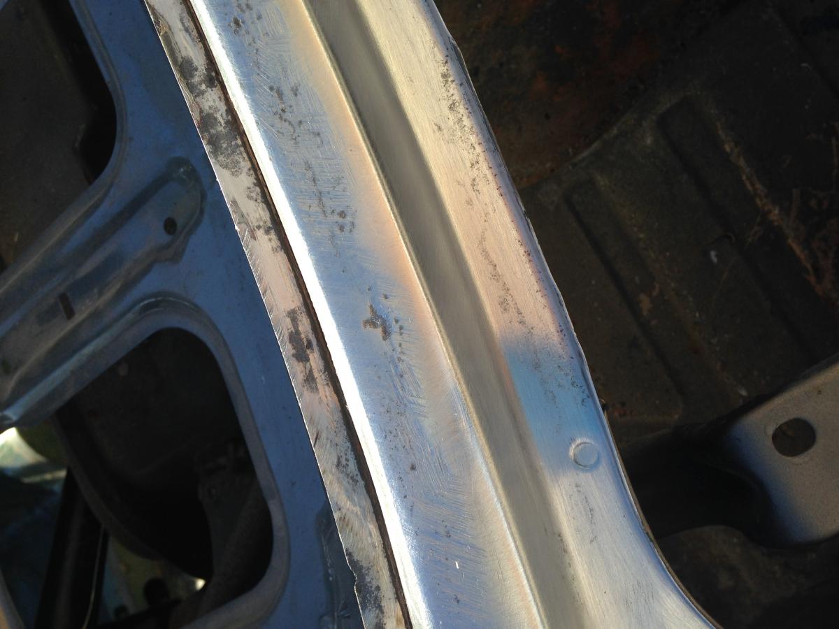

Use paint stripper for all of it mate, all the tight spots as well, just get all sorts of scraper shapes. Remember too that blasting does not remove tar, so get that off anywhere first. Fix the rust after the blasting is done, then you know exactly what needs to be fixed.
Hi at the moment i am doing mine exactly as yours. Basicaly i hand removed with the paint remover the delicate places were the sand blast can damage the body other wise its sand blast. I have found that a metal sponge (used to clean dishes) best for some tight corners.
Your just leave the paint remover to set more than 15 min and then just removed with it. I have exactly the same rust probs like you. I have removed the inside membrane with a blow torch and a scraper it was easy now tomorrow its going for blast. In my opinion blast is the best for some tight corner and round edges were its much more stronger so they can be sand blasted with out damaging metal. Mine at the moment

Nice to see your car coming along, and sitting on the rotisserie. I've been trying to track one down around here but no luck yet.
What for the rotisserie? It was done by me it and not expensive.
